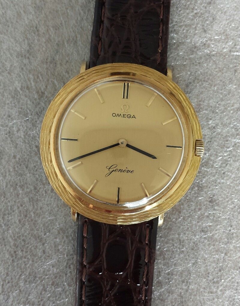

  15. bbl1998 Aug 30, 2017
    98
    41
    Thanks for the info. Would you mind being kind enough to look at this one please? Is this all original?
  16. JimInOz Melbourne Australia Aug 30, 2017
    15,471
    32,309
    Yes.
    Although it's becoming obvious that my taste in watches differs significantly to yours.

  18. gatorcpa ΩF InvestiGator Staff Member Aug 30, 2017
    12,194
    15,696
    Without pictures of the inside of the watch, it is impossible to tell.
