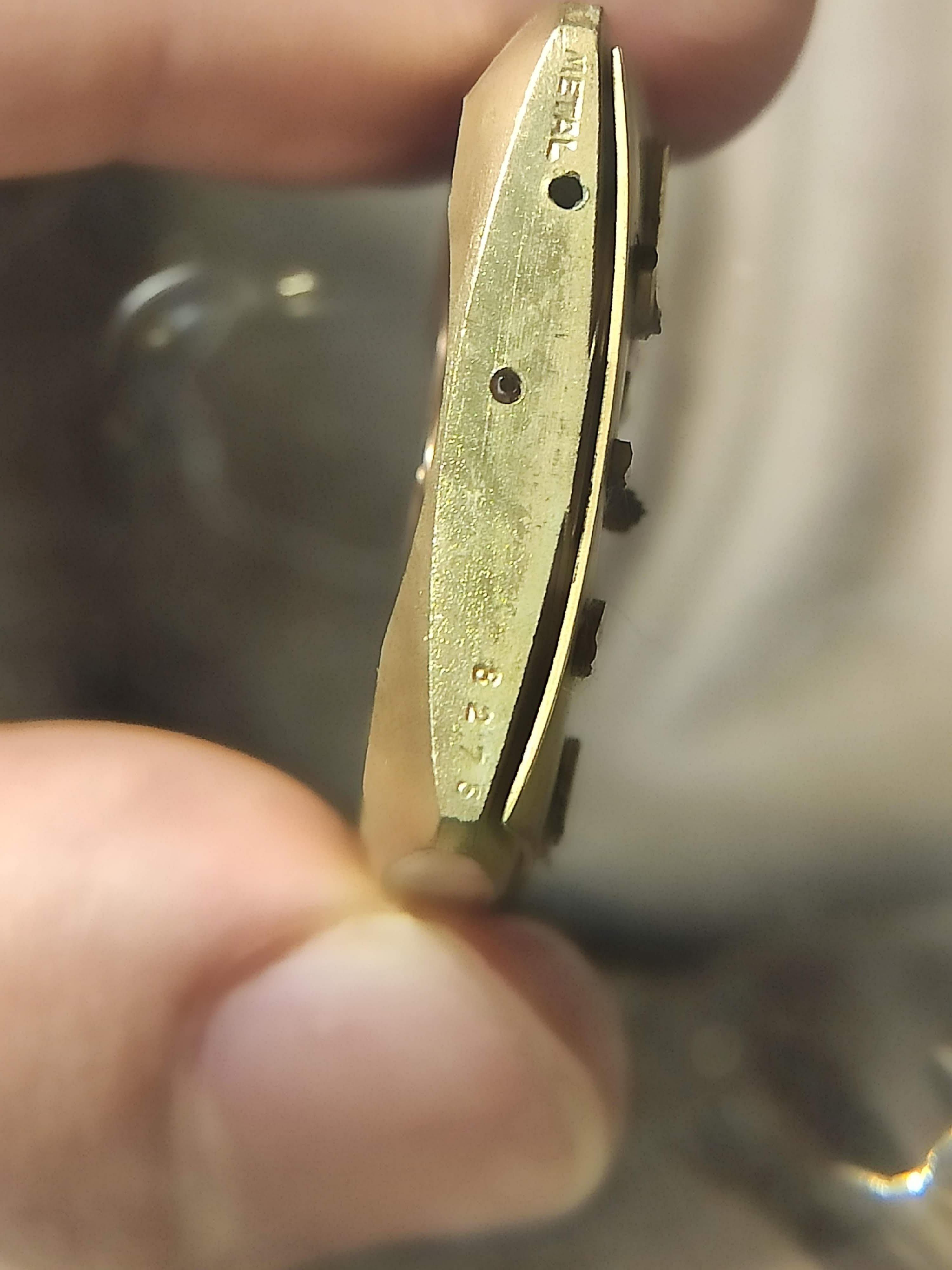

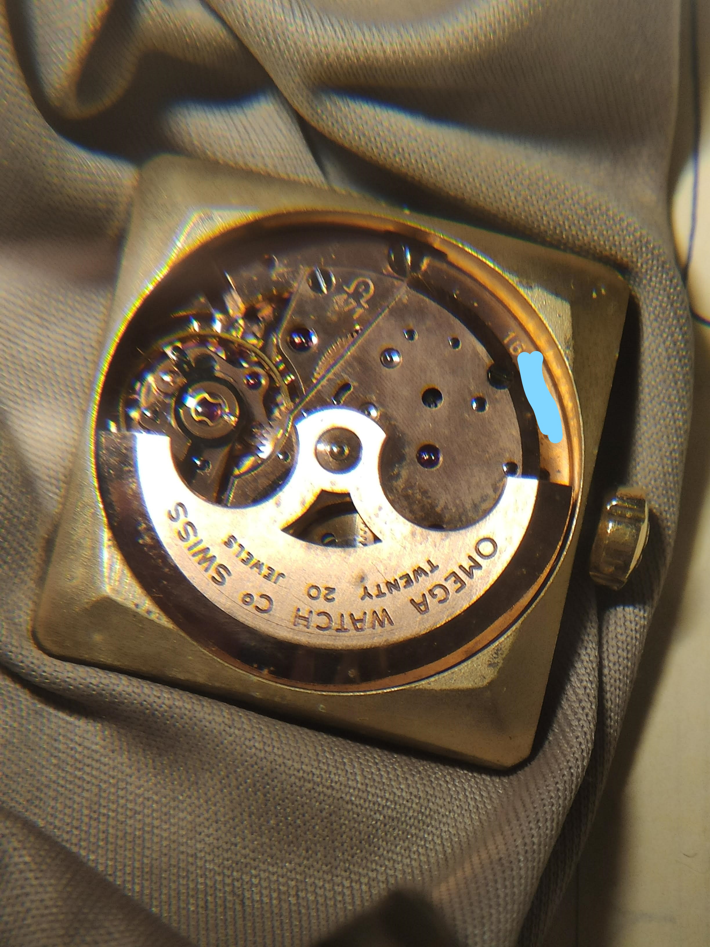

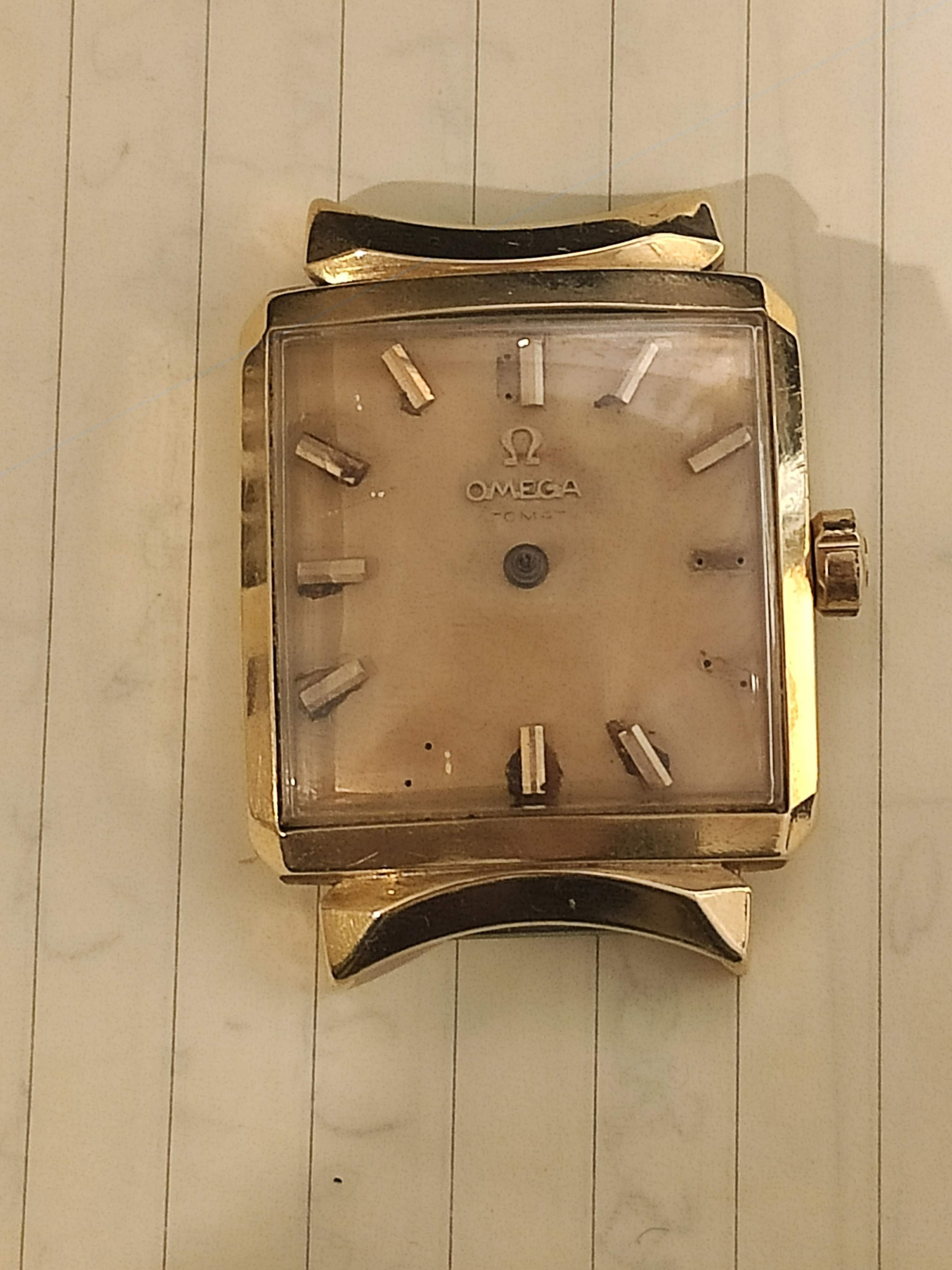

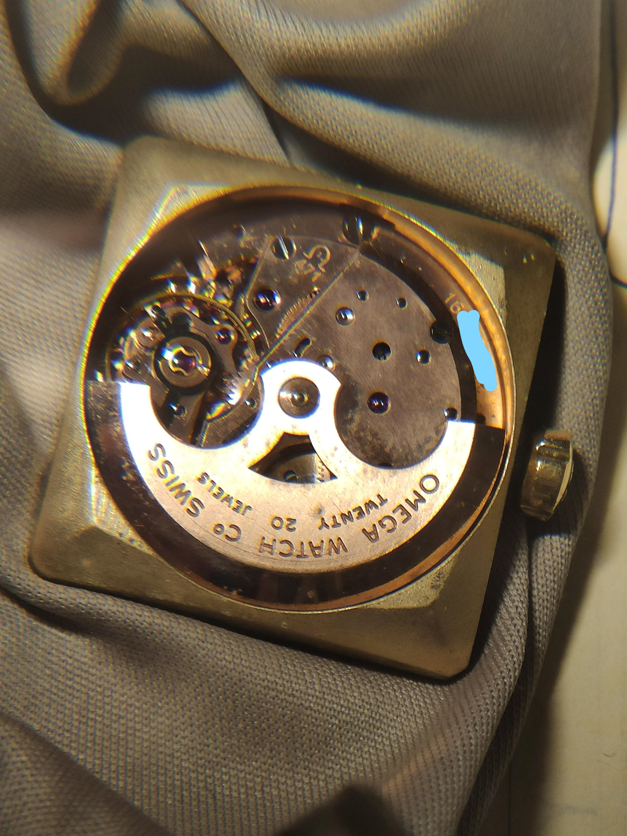

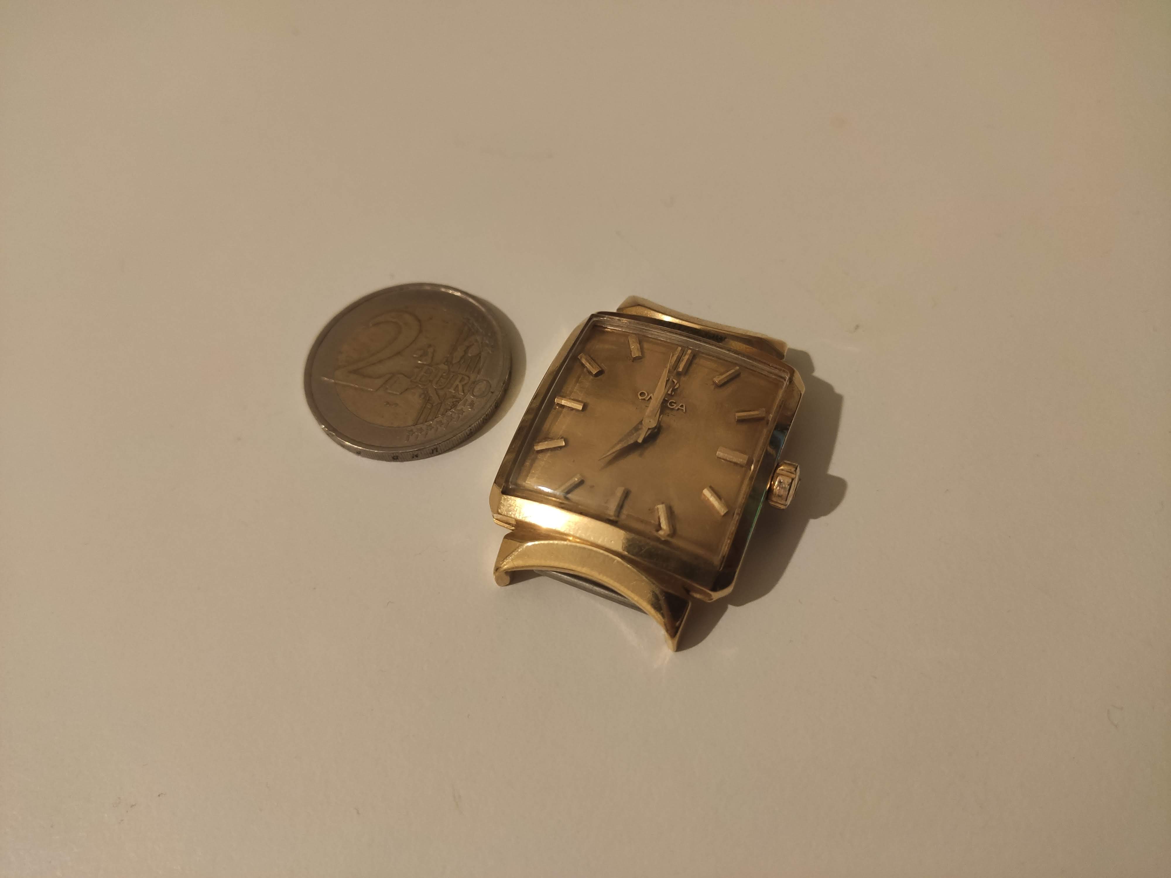

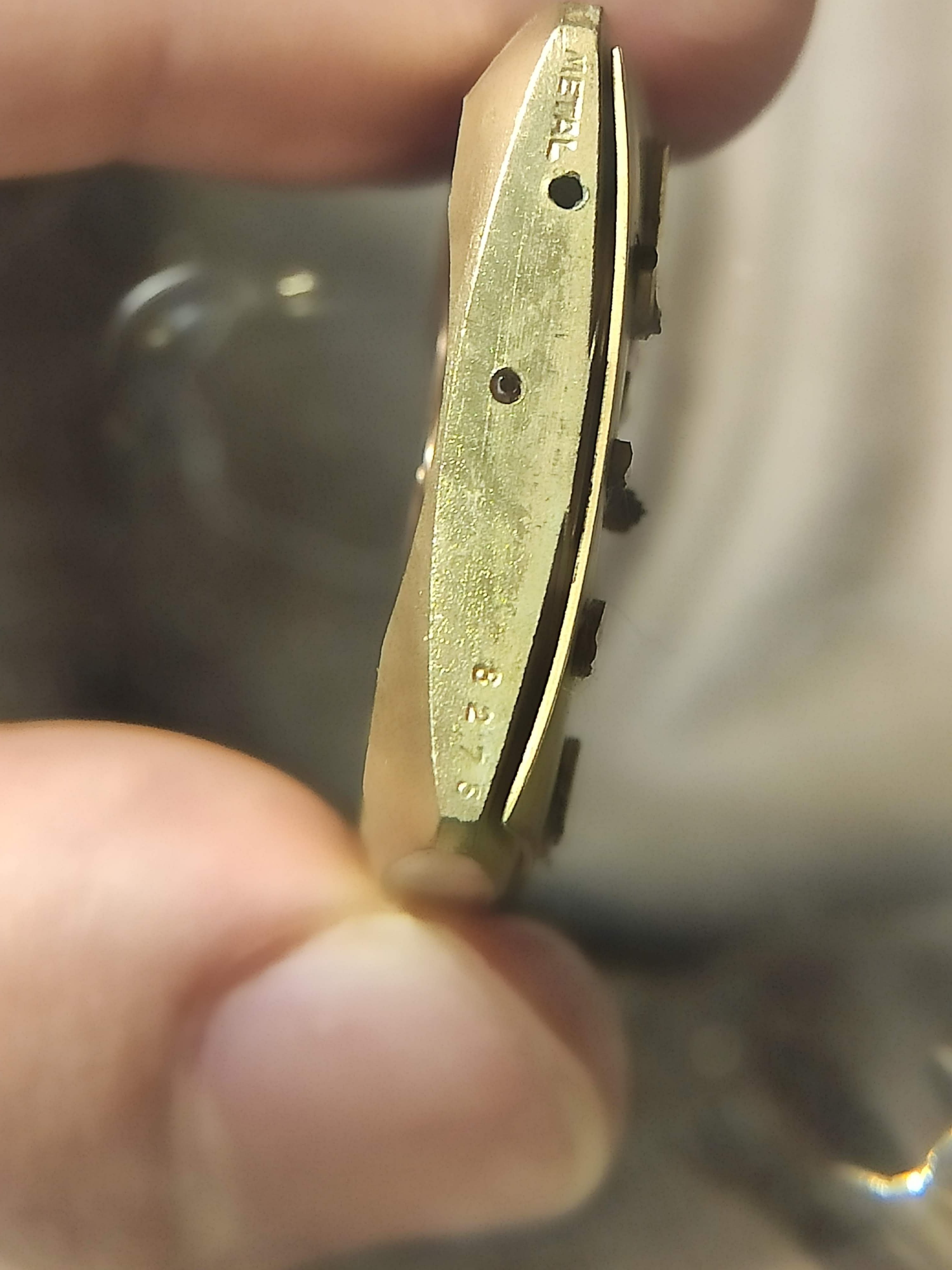

While organising his stuff, I've finally found it 😀 Very simply put, it's an Automatic ref 328275 3977 SC with cal 471 in18k solid gold case from late 1950s (serial 16xxxXXX). The part 328275 didn't get me anywhere so far and that's why I cut it short as 3977.

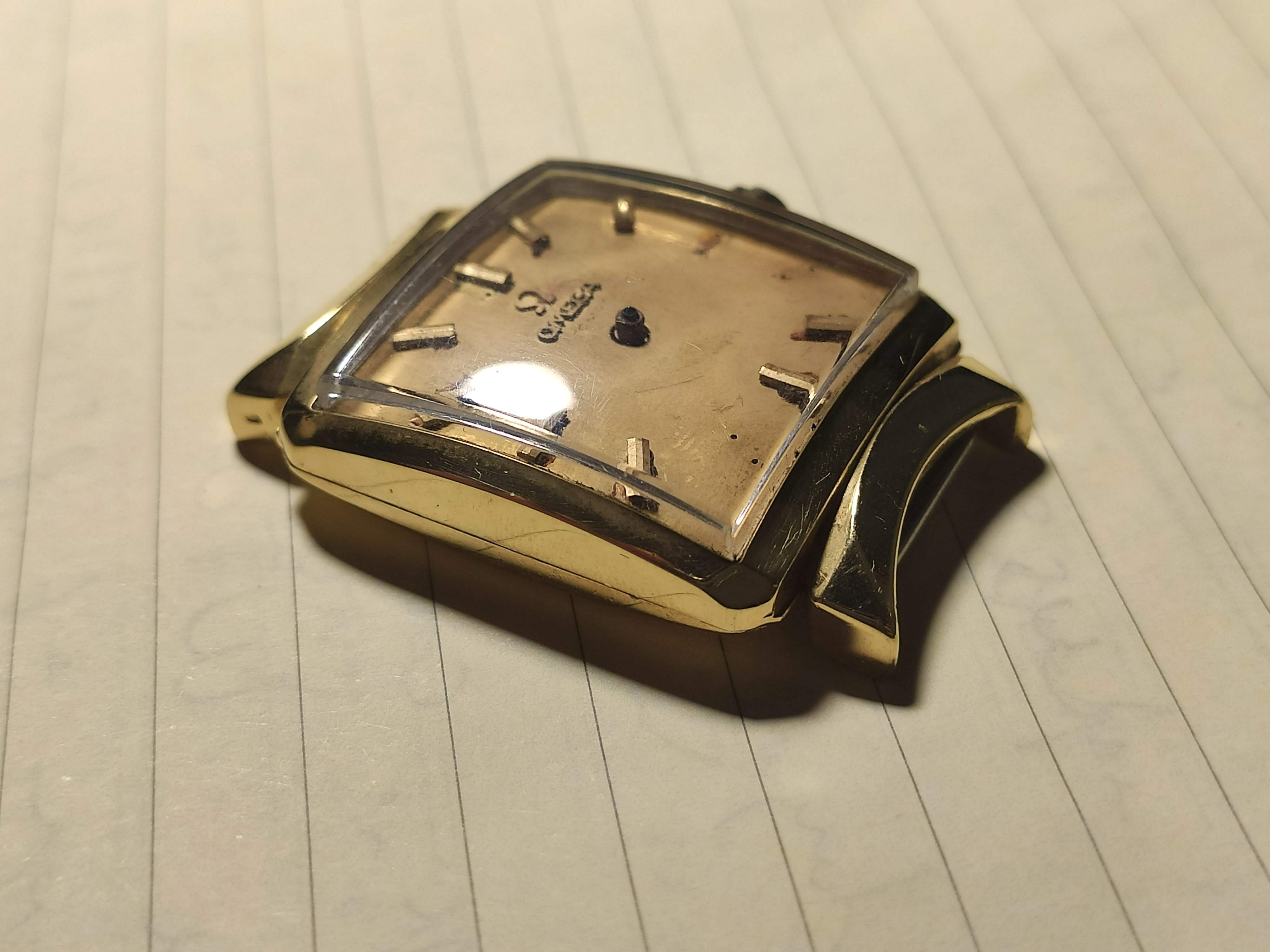

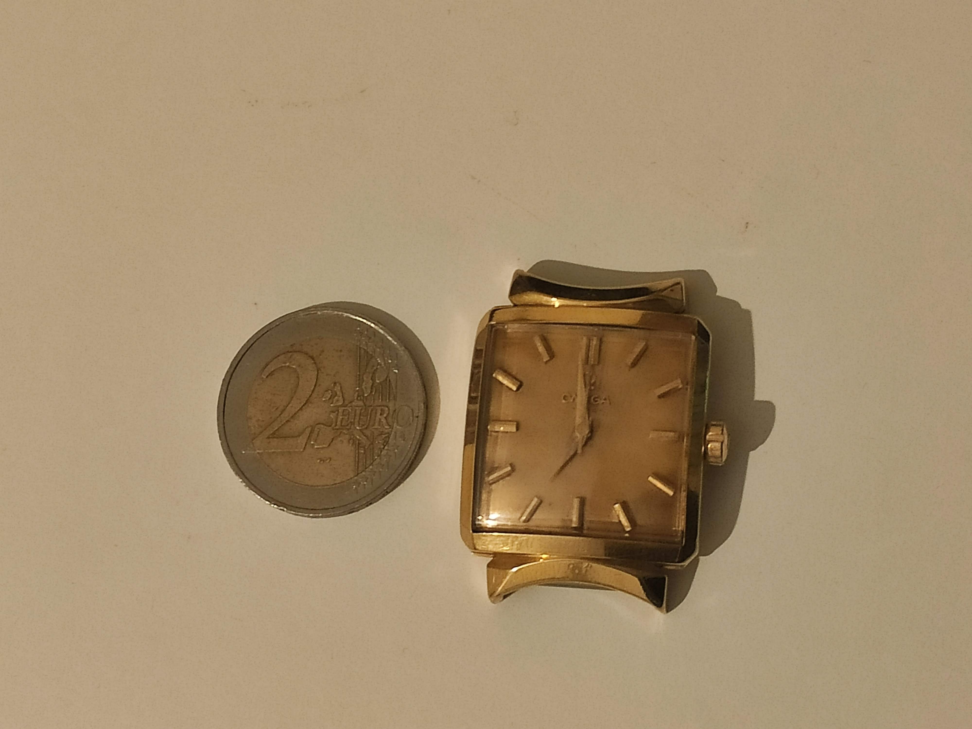

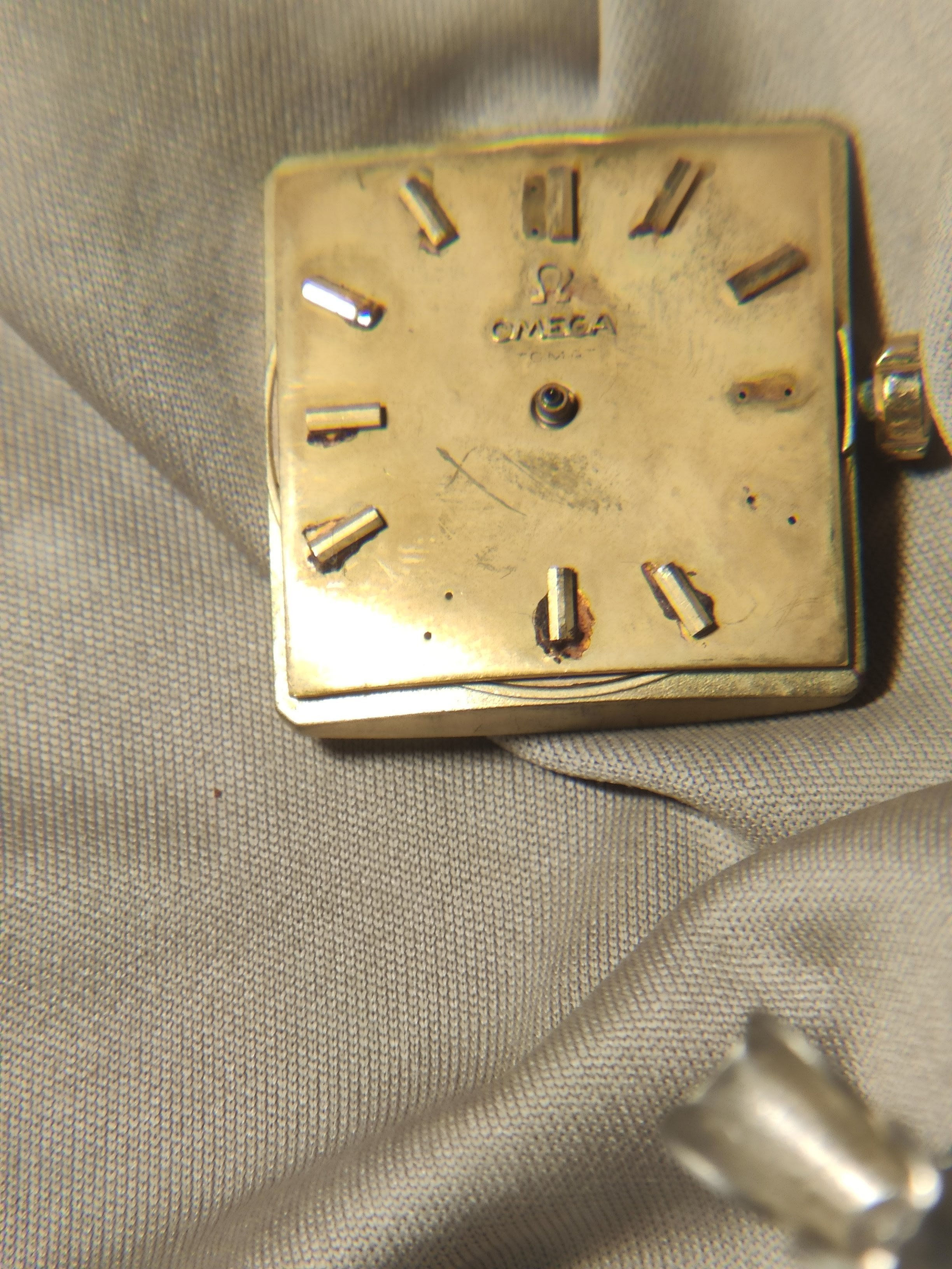

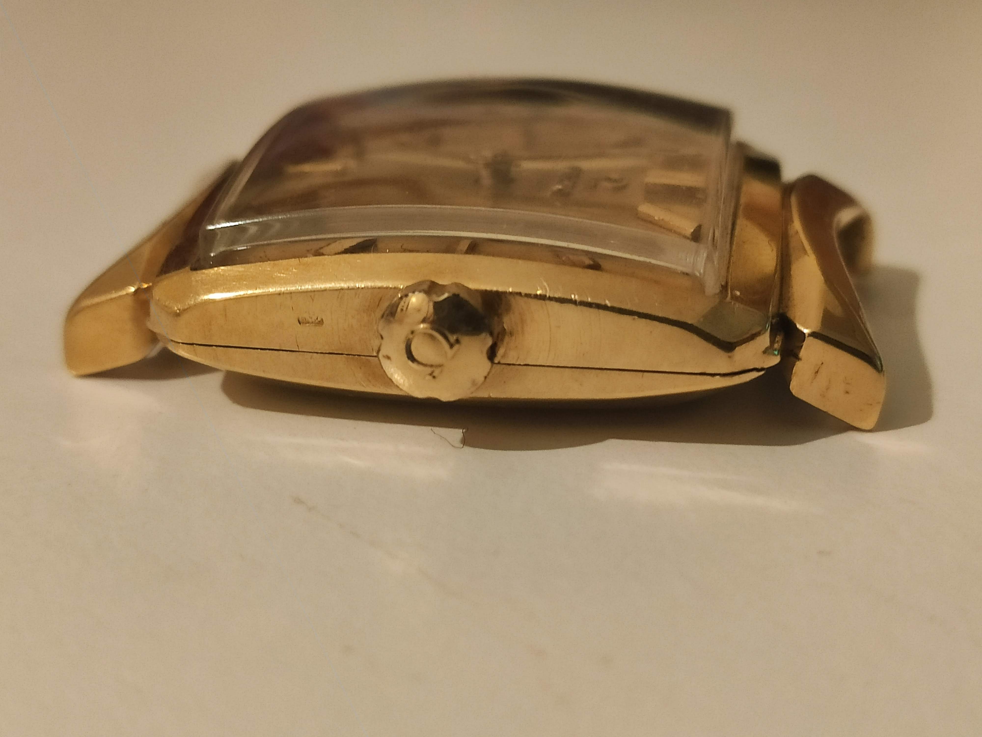

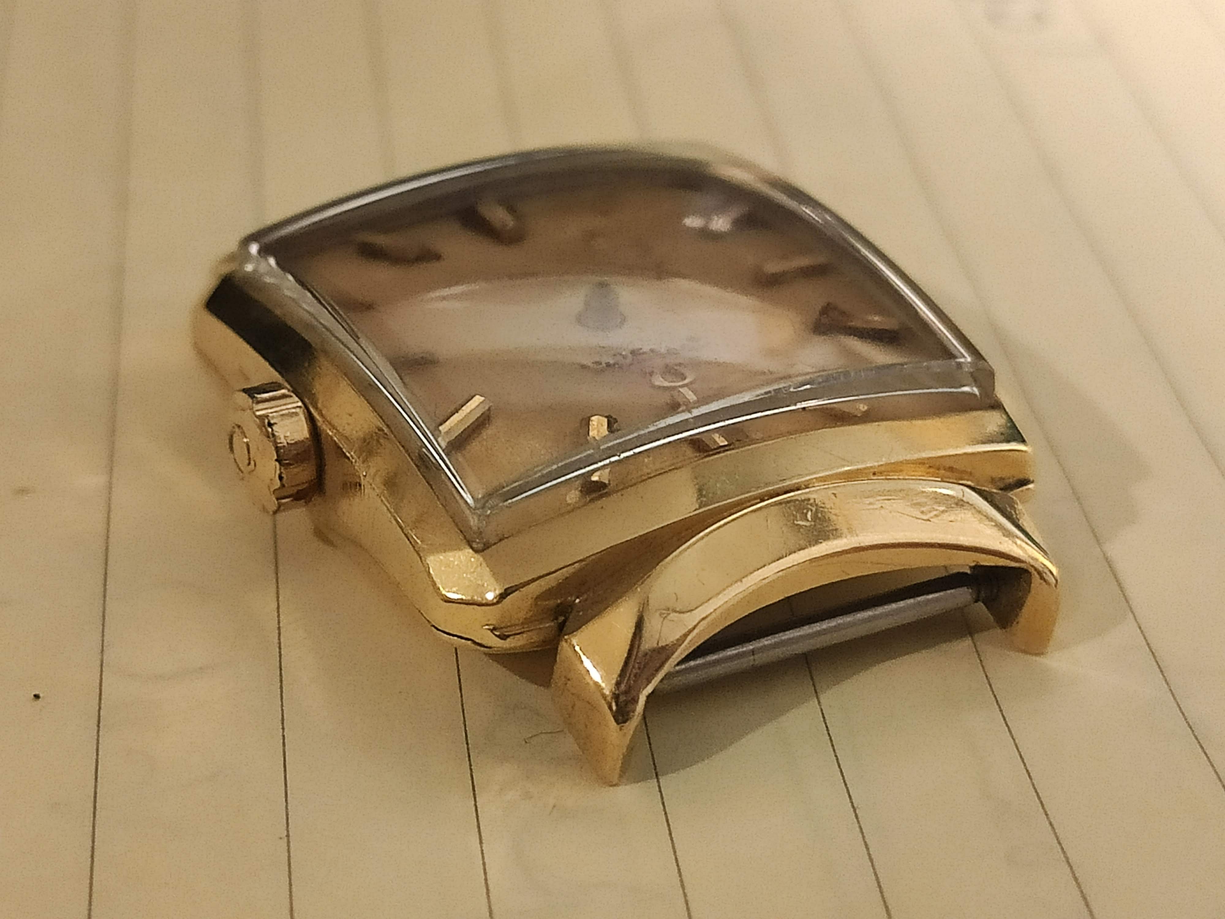

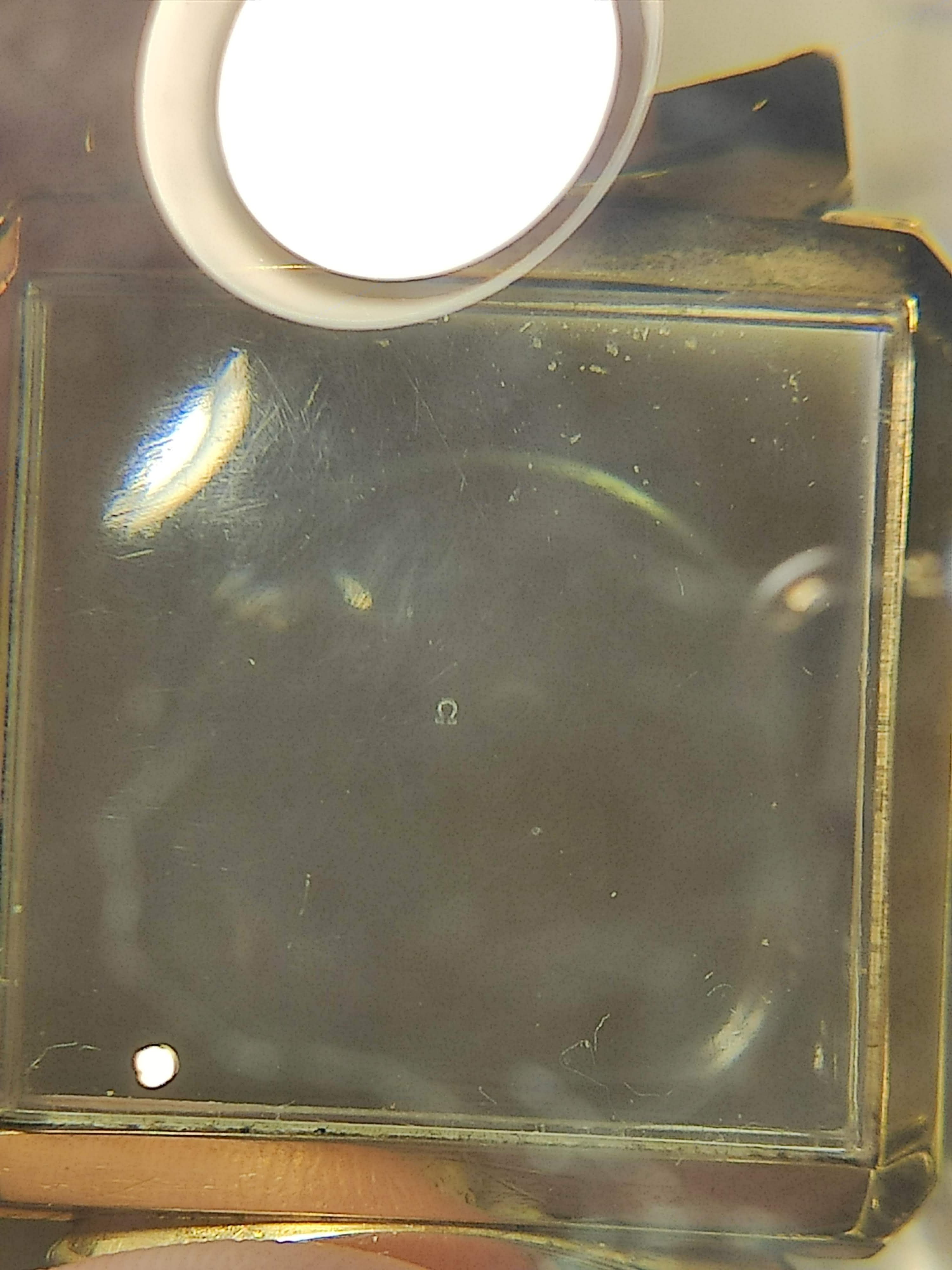

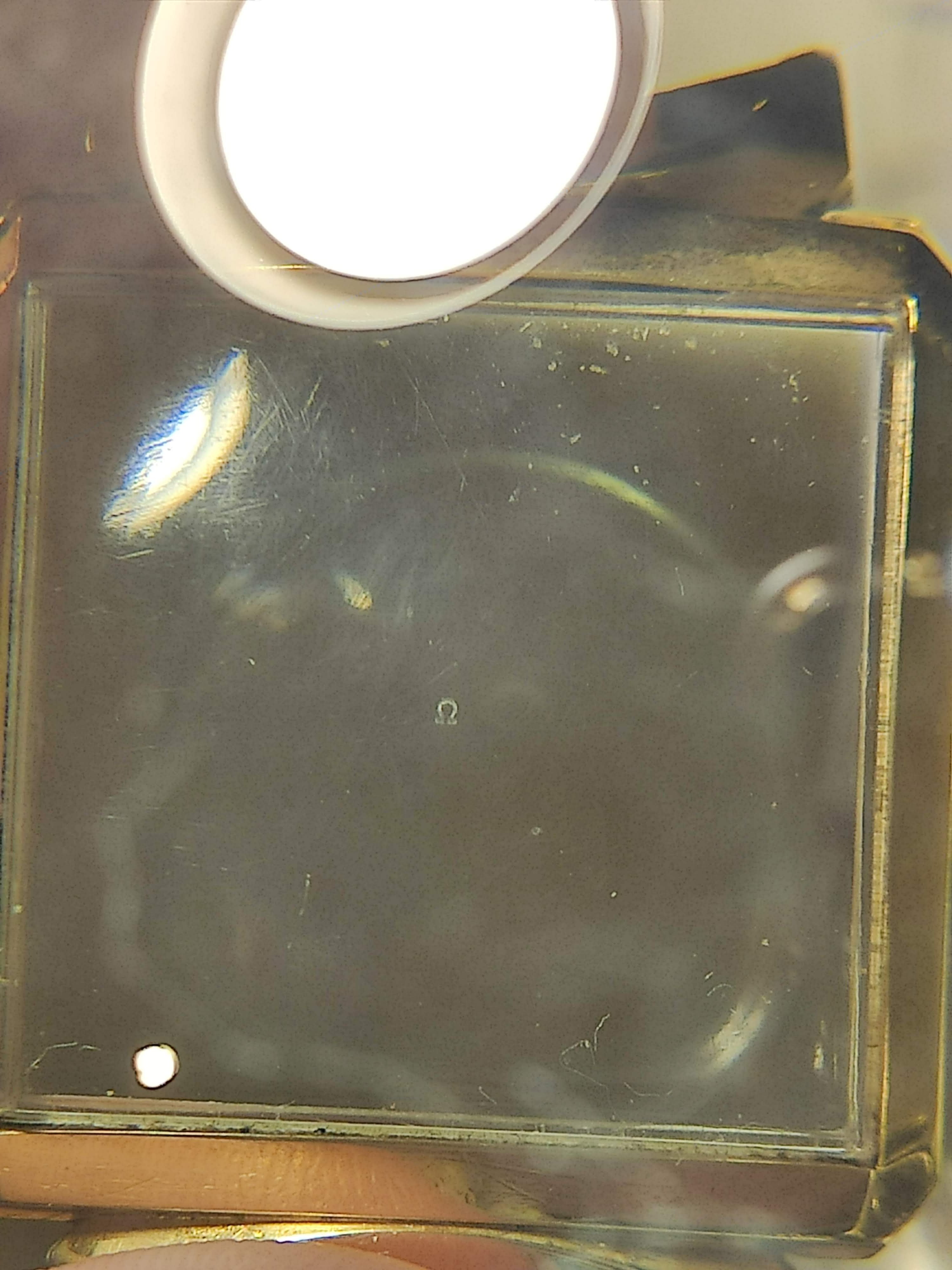

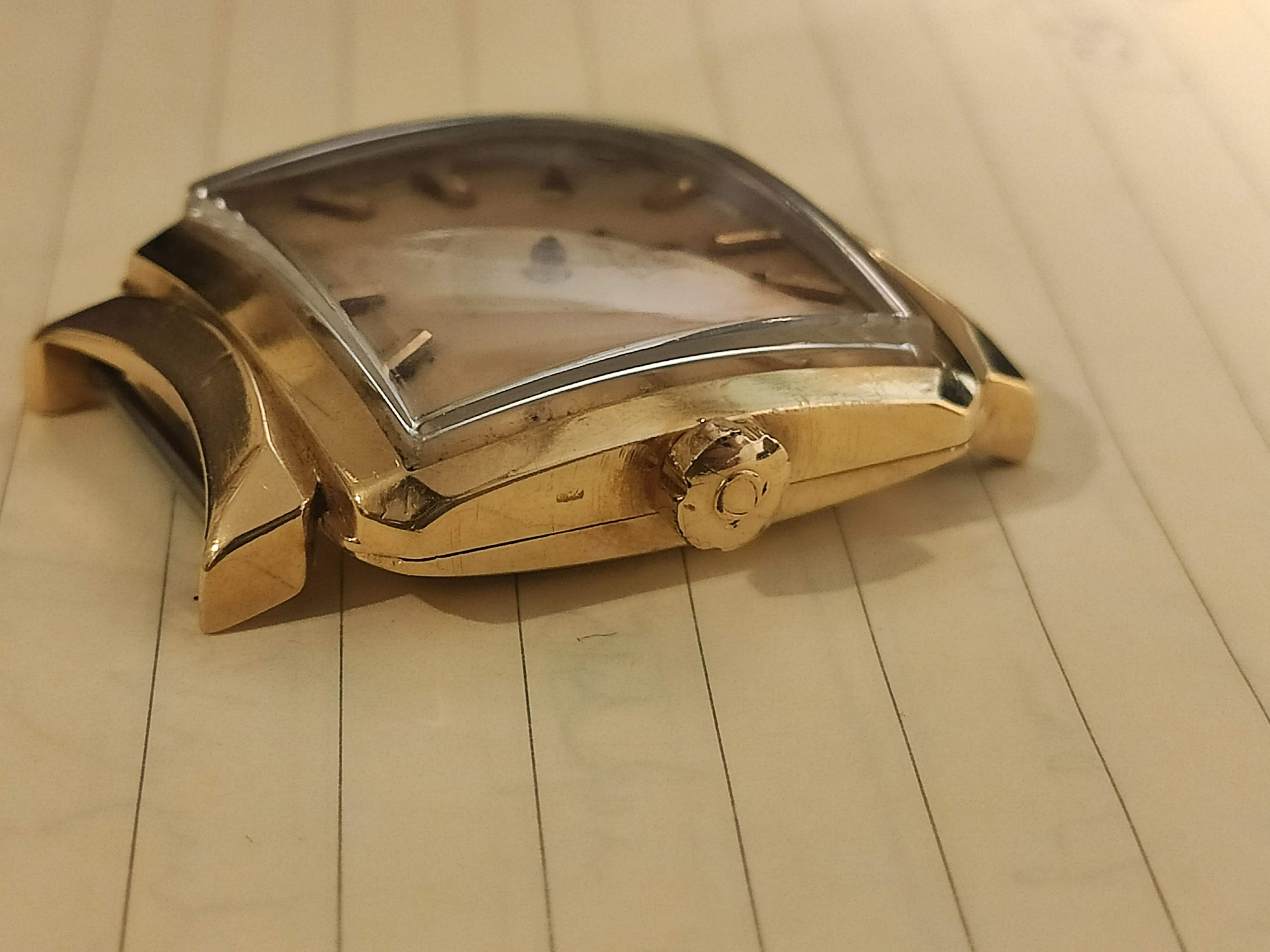

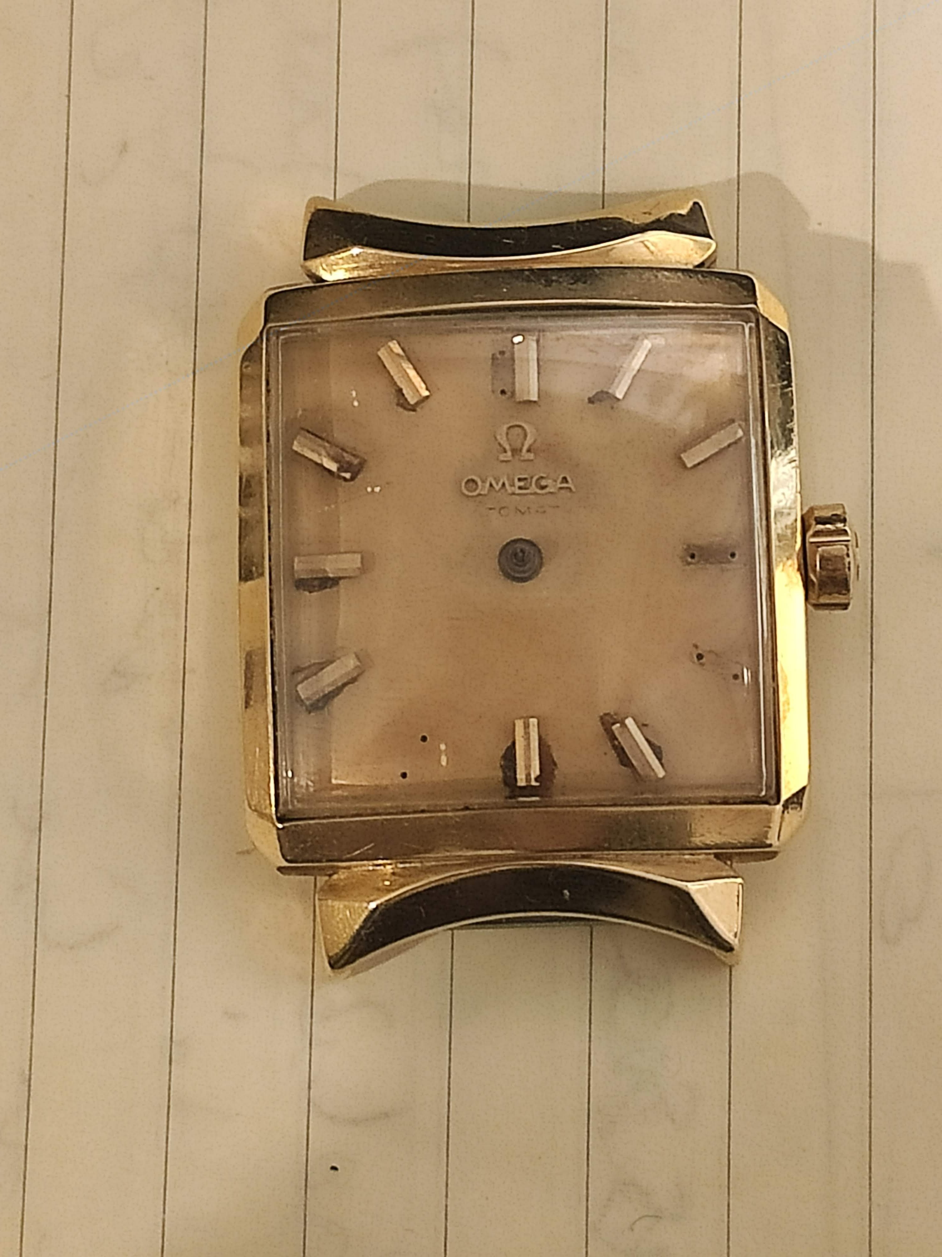

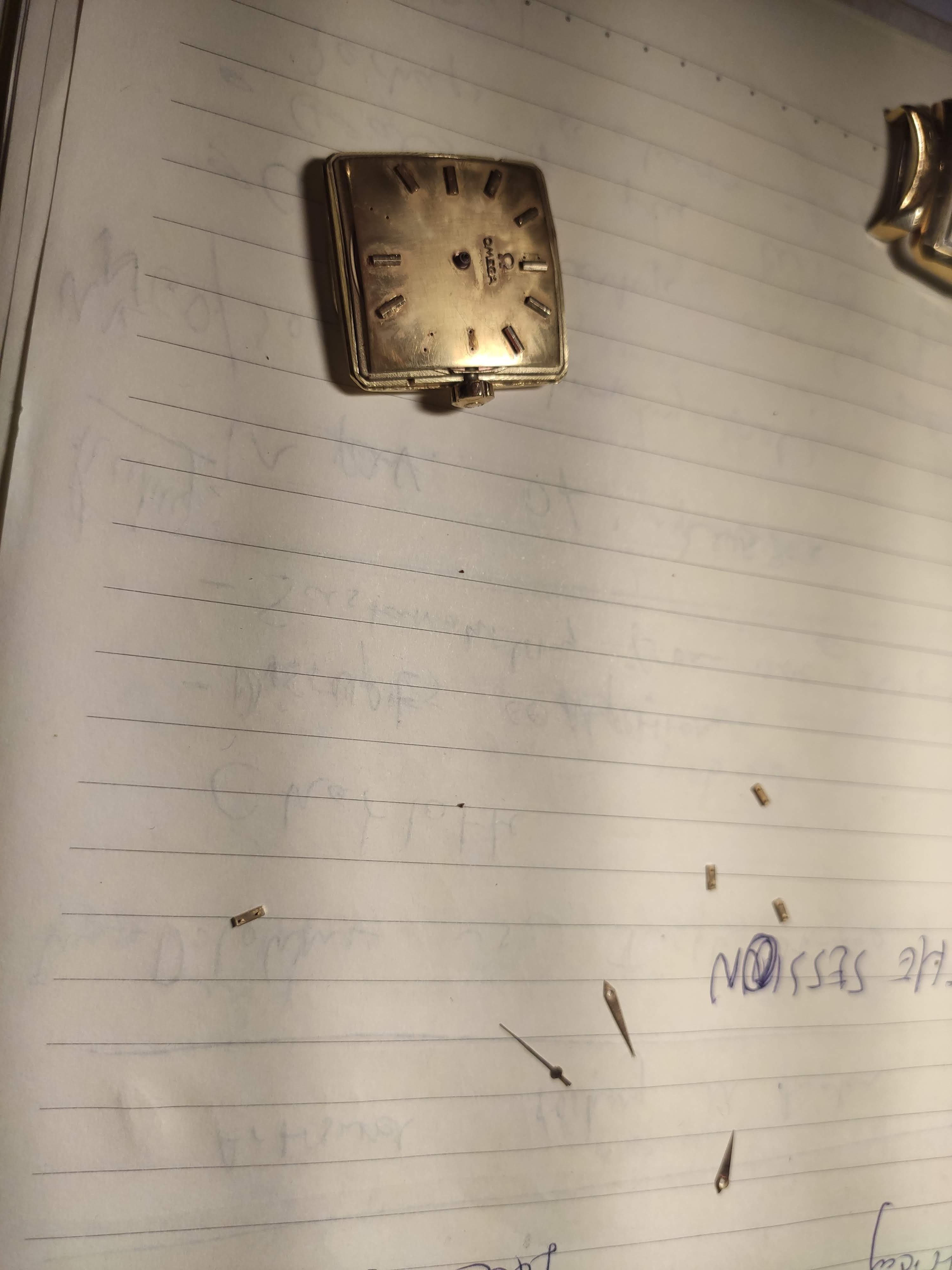

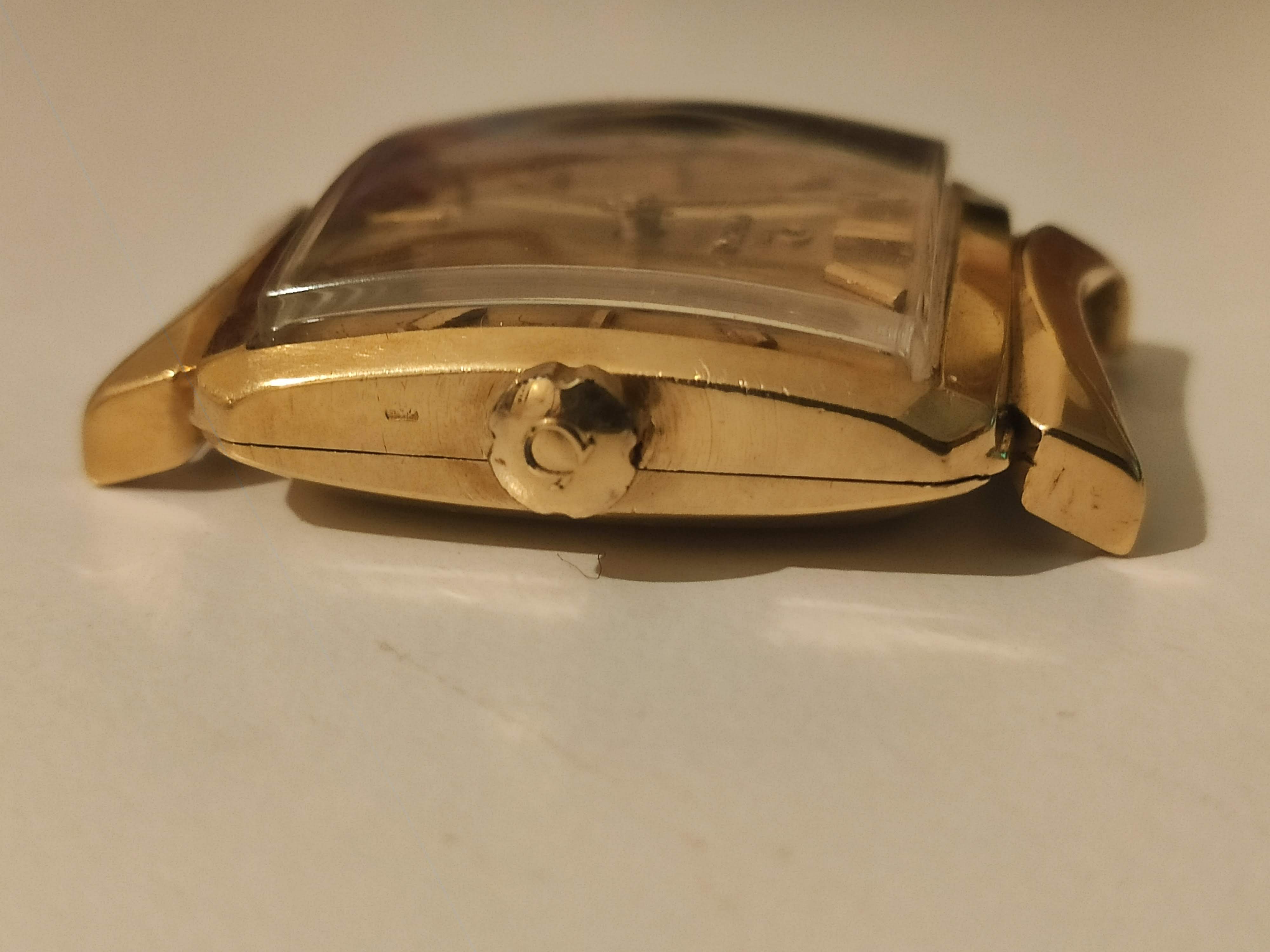

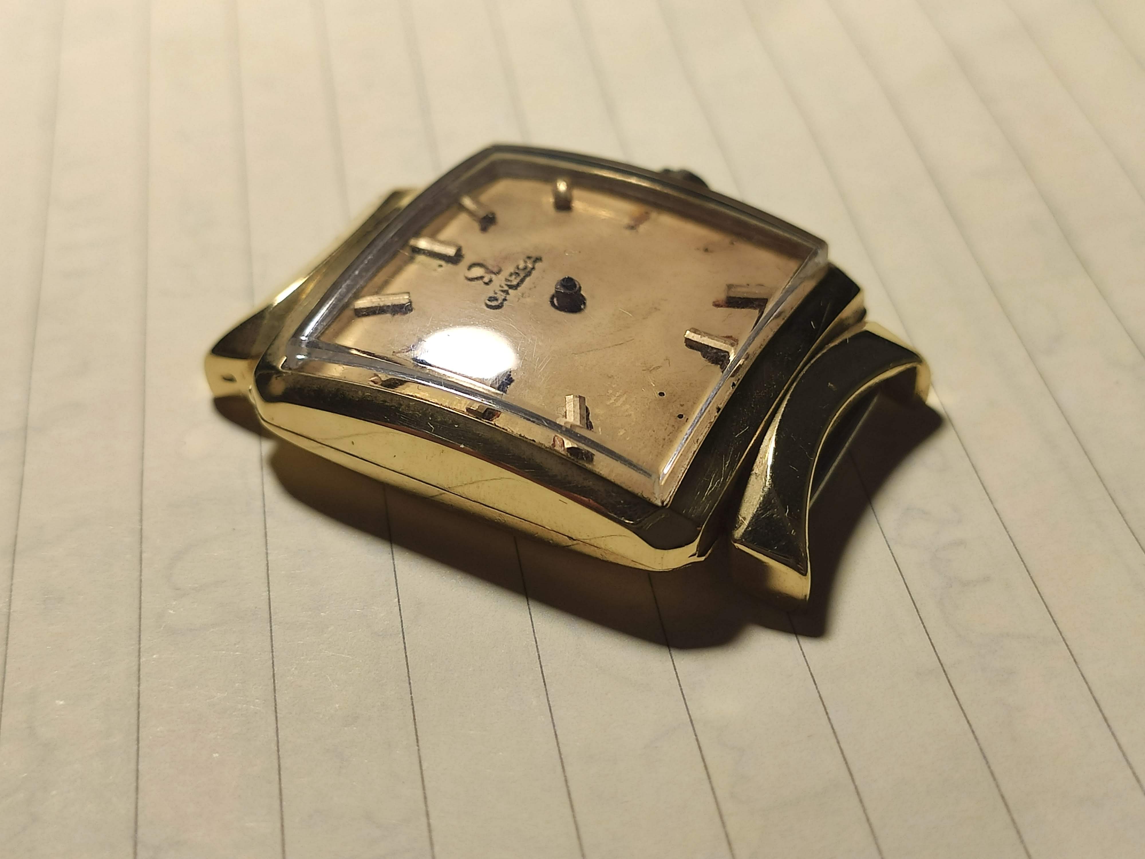

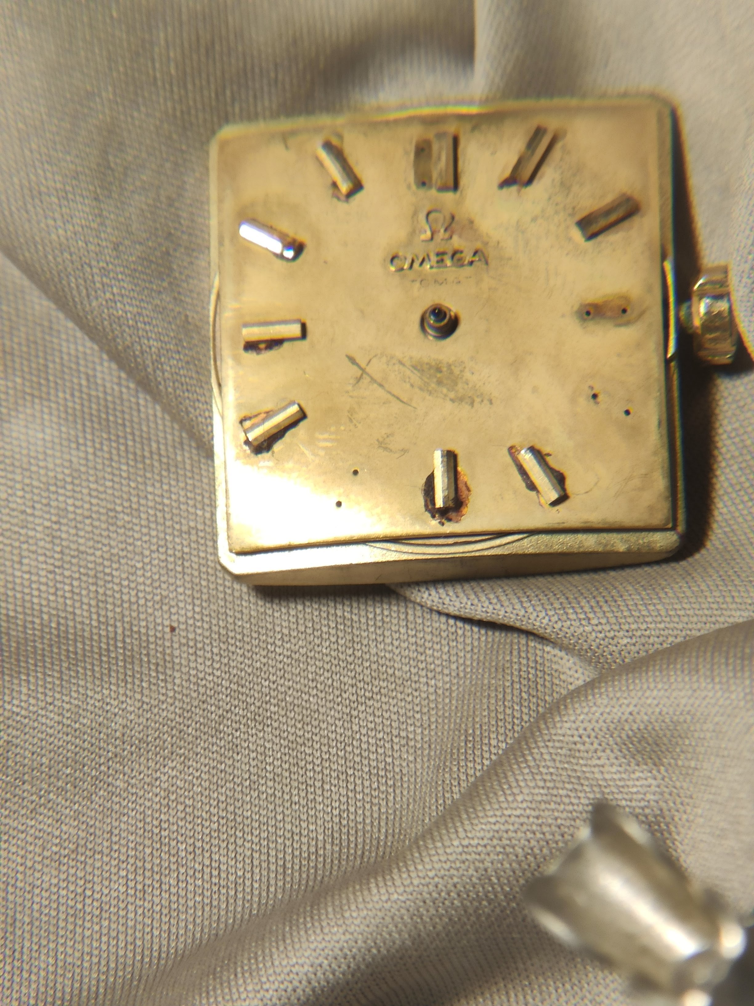

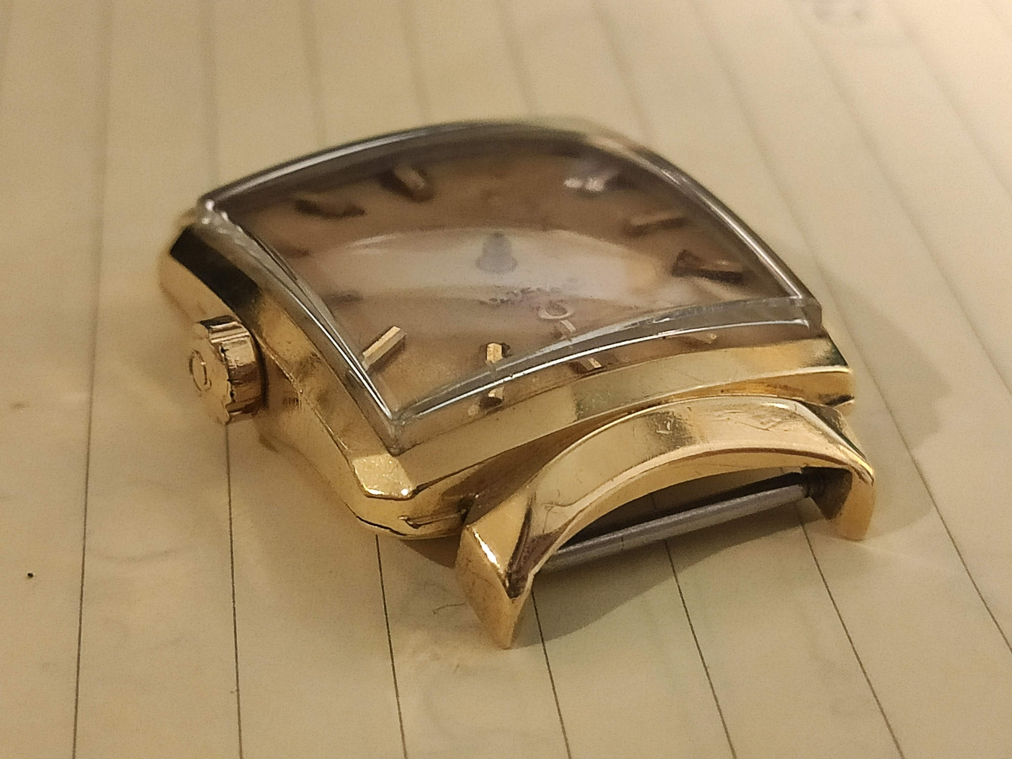

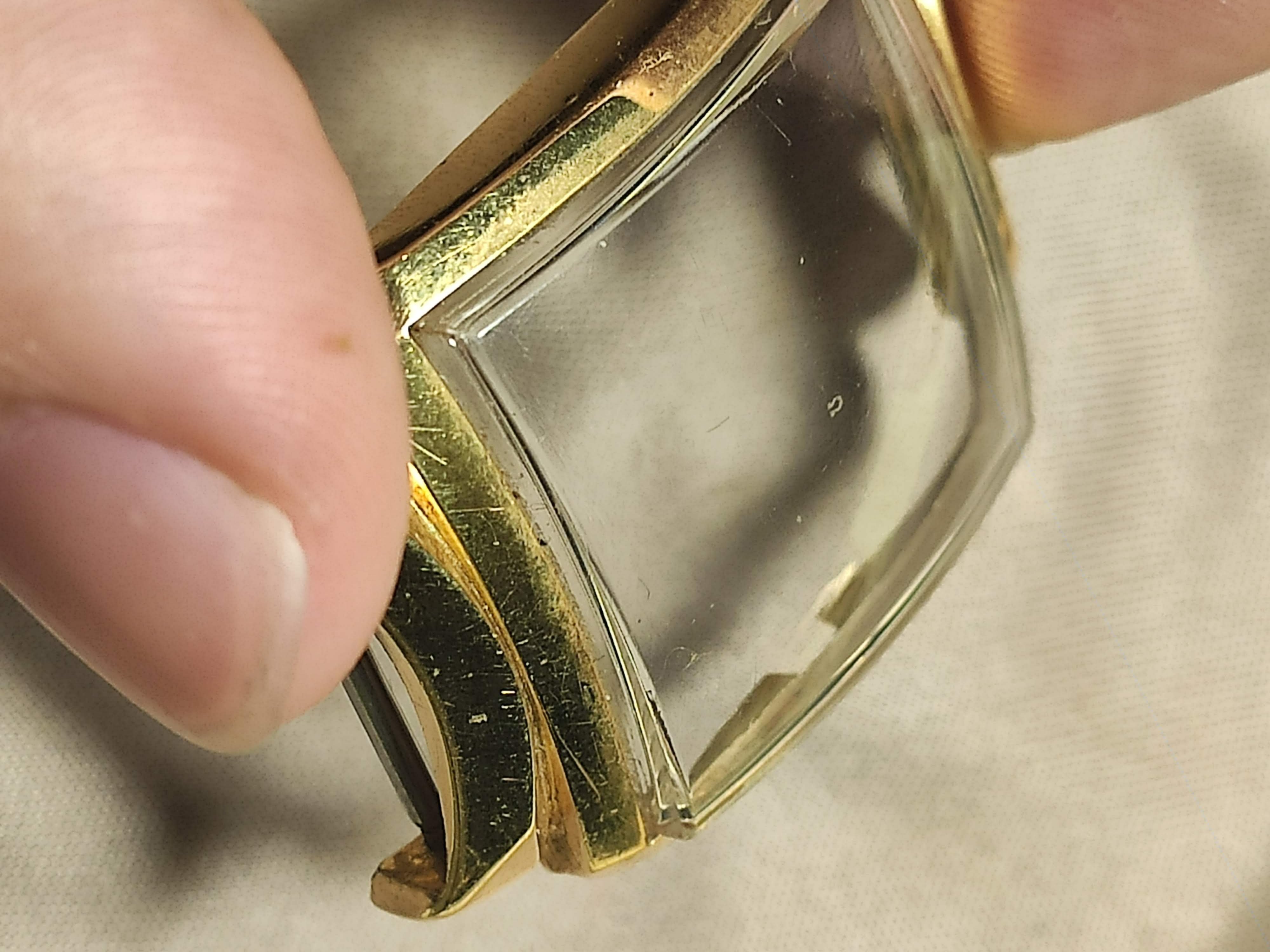

When I first held it, I noticed that the case was in beautiful shape with almost no polishing and still keeping its curves, so is the original signed glass and probably original crown (confirmation would be appreciated). However, the dial was in terrible condition with hands and some indexes removed and some "glued":

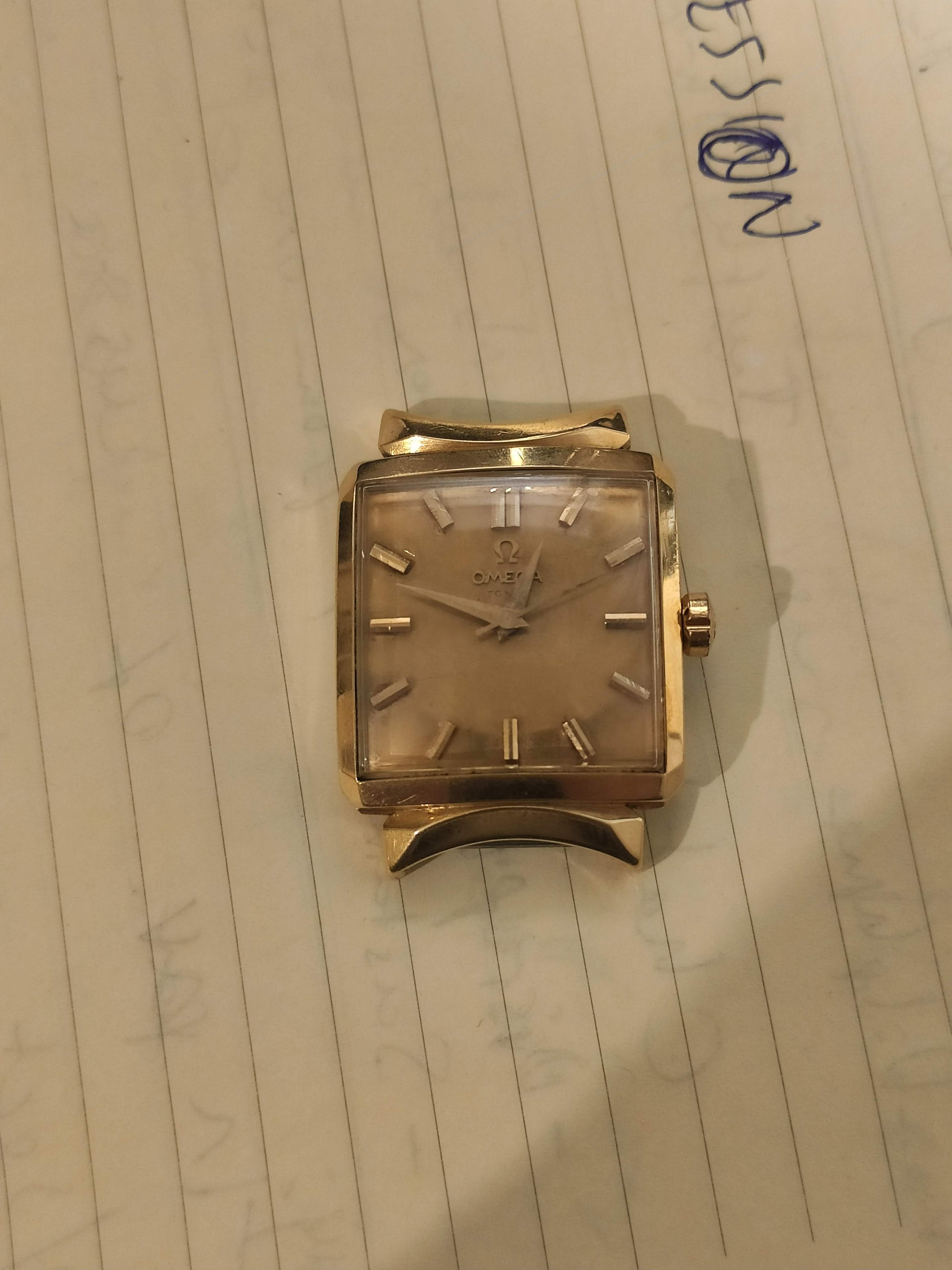

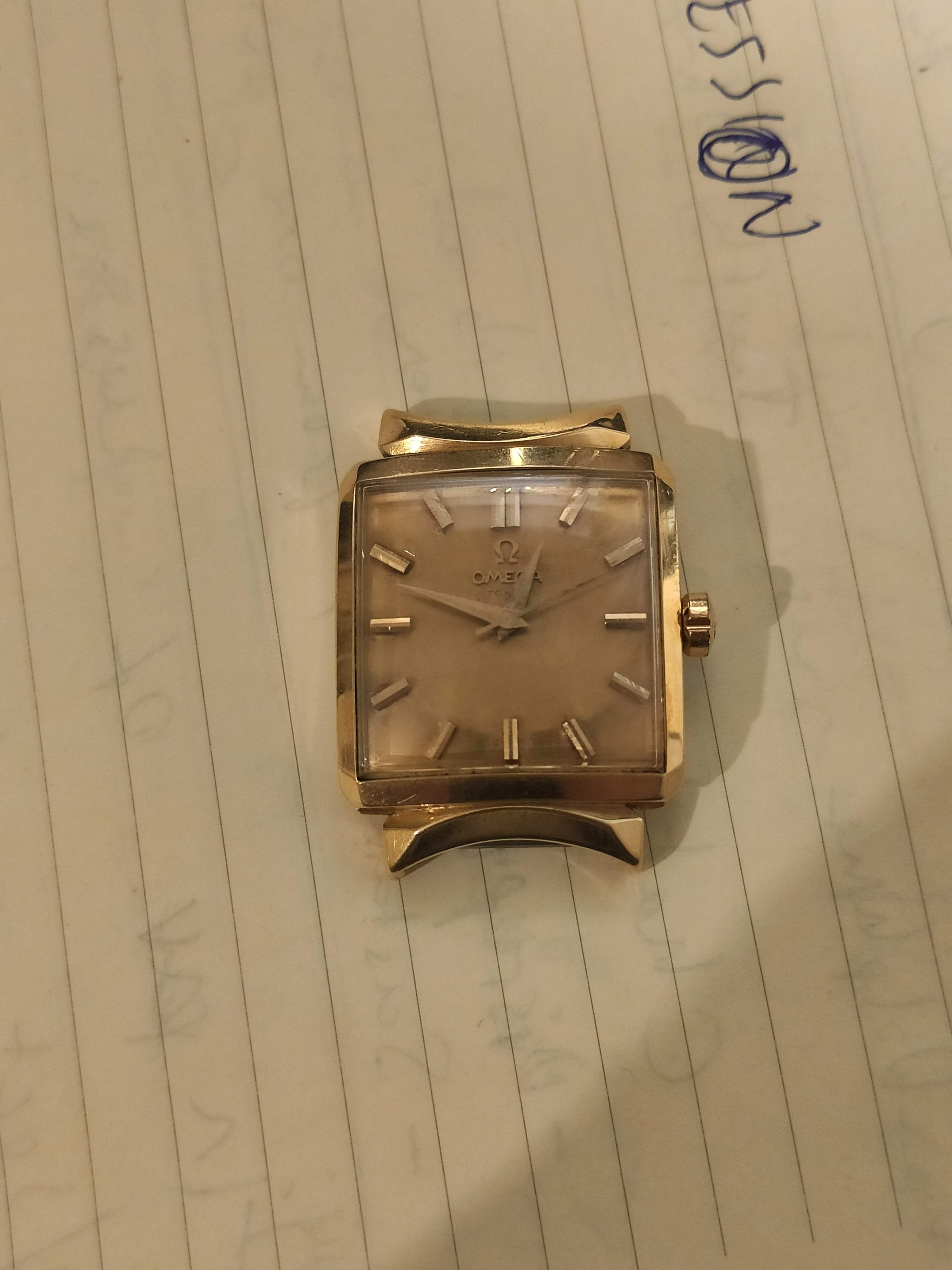

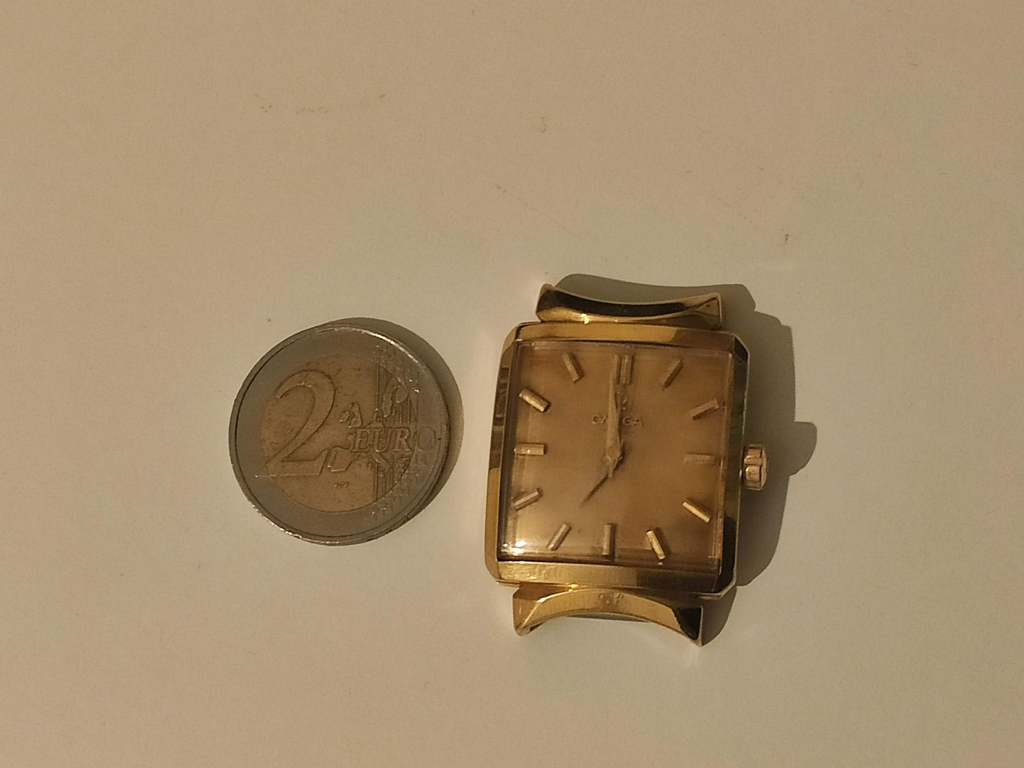

I've carefully installed the indexes and hands myself using my new watchmaker tools, curved the second hand which was touching the curved glass), cleaned up the terrible glue which was used to stick some indexes (I want to believe it wasn't my old man who would have done it to this piece 😁 ). Now it looks fairly better and is working, though keeping the time with significant error. The power reserve is still high, perhaps little less than its original 46h.
The photos and detailed reference no are all as in the pictures:
Could you be able to tell me more about the model and condition of this watch, as I've found very limited information on my Google and Omega catalogue searches?
It absolutely requires a service and, I'm afraid, re-dialing since I think the current colour (gold) of the dial is just the colour of the plate and not the original colour (also note the faded AUTOMATIC sign below Omega logo). What do you think about it?

Lovely looking piece and in clean condition! Concerning the redial part, since it is you father's piece i would keep it original unless it really disturbs you as it is. Tbh it still looks very nice to my eyes👍

Great heirloom.
328275, is the case serial number and 3977 is the model or reference number.
This would have had a low profile crown with regular serrations, the one on it currently is a Seamaster style crown and not appropriate for a dress model like this. Google the reference number and you should find examples with the correct style crown.
For me since the dial is in such poor condition a good refinish would be more desirable.

Good functional dial repair. I would leave it as-is. It will then be both your Father's and yours.

Thanks a million for your valuable opinion, much appreciated! In fact, I'm an "originalist" to the bone, i.e. don't even remotely think about polishing etc. let alone redialing/repainting/refinishing, no matter how bad the dial looks. But in this case, I'm inclined to @X350 XJR idea. The thing is, I'm suspected that the delicate polish of the dial, which gives the dial its colour, text and all the print etc., is so eroded that now what we see is directly the plate of the dial, which remains unprotected. A good refinishing may give it the handsome look and protection the plate needs. But again, this is just an assumption based on my very limited knowledge about the piece.

Amazing comment, thank you! Yes, the crown reminded me the design of a Seamaster which is why I was unsure. But somehow I think it makes a good match with the lugs and didn't seem too bad to me. With that being said, as a hardcore originalist, I will do my best to change it back to the original, if possible.

You put it in such a perspective that it's really hard to object the argument 😀 But seriously, thank you so much for your suggestion, really helps make up my mind. Do you think that this is the apt look of the dial or that it looks just fine as-is, i.e. the print entirely gone?

Heirloom status supersedes aesthetic considerations, in my humble opinion. If this were an eBay acquisition, my take would be different. But since it's Dad's, Hippocrates' advice prevails.

Awesome restoration to be honest, looks great

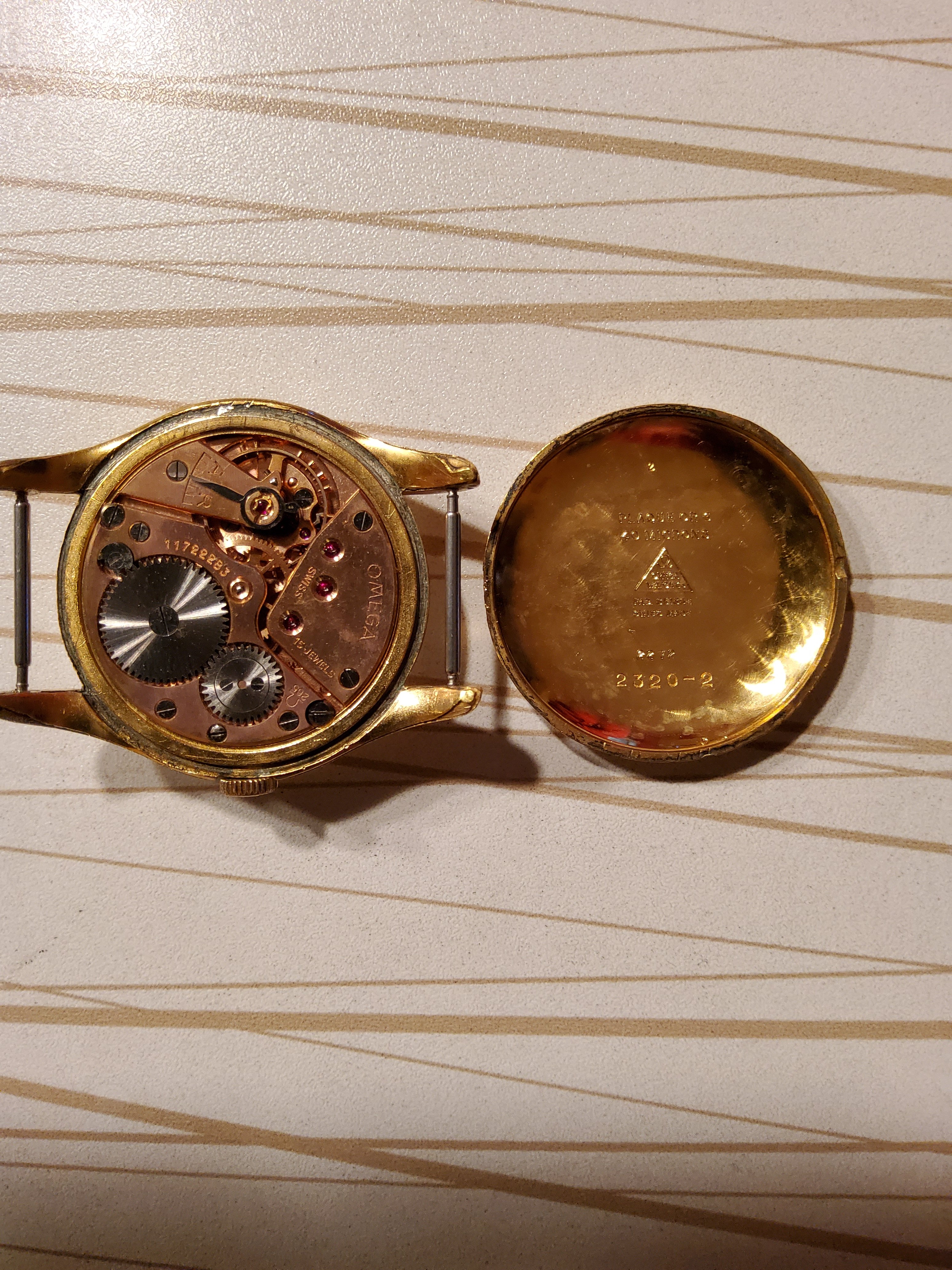

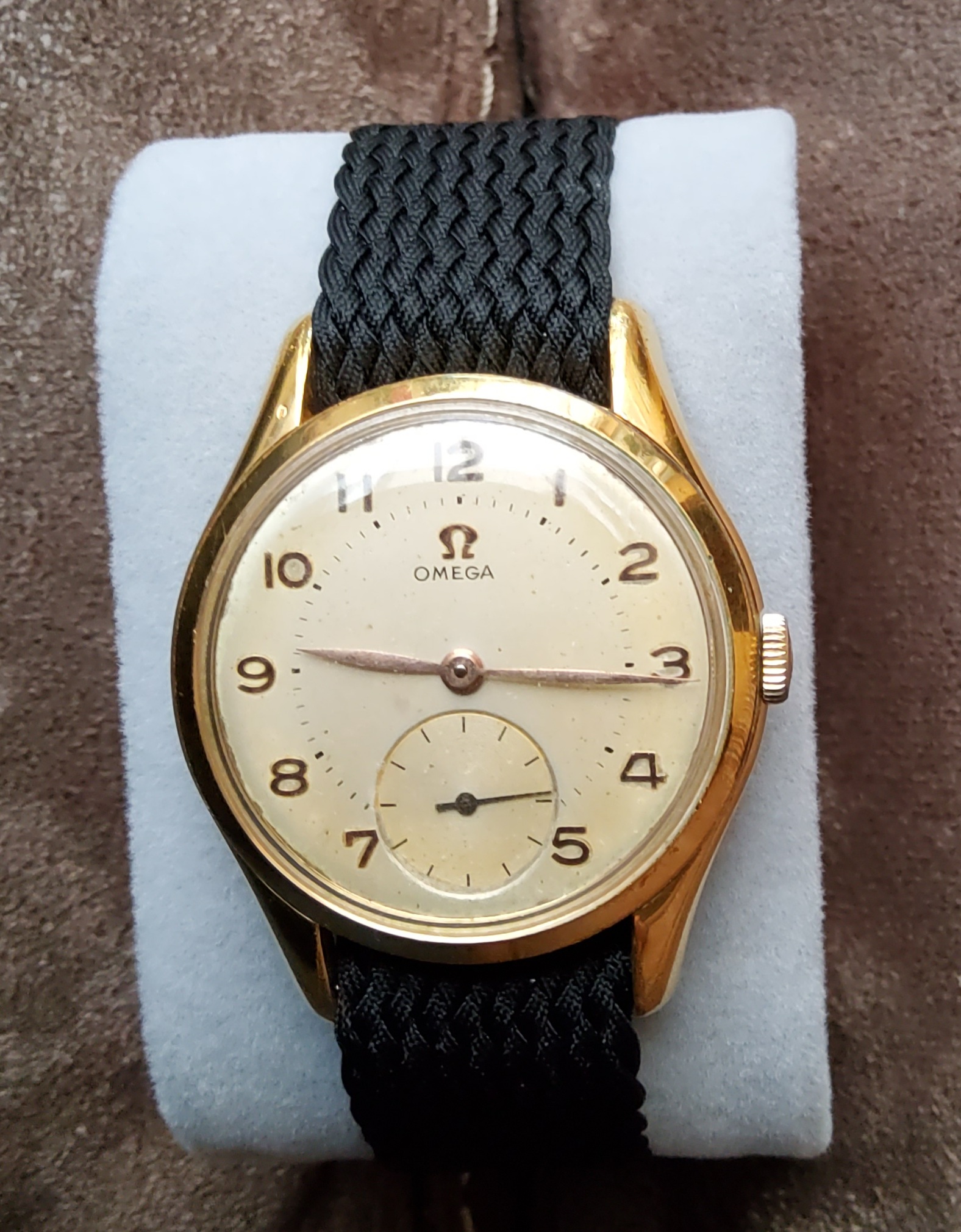

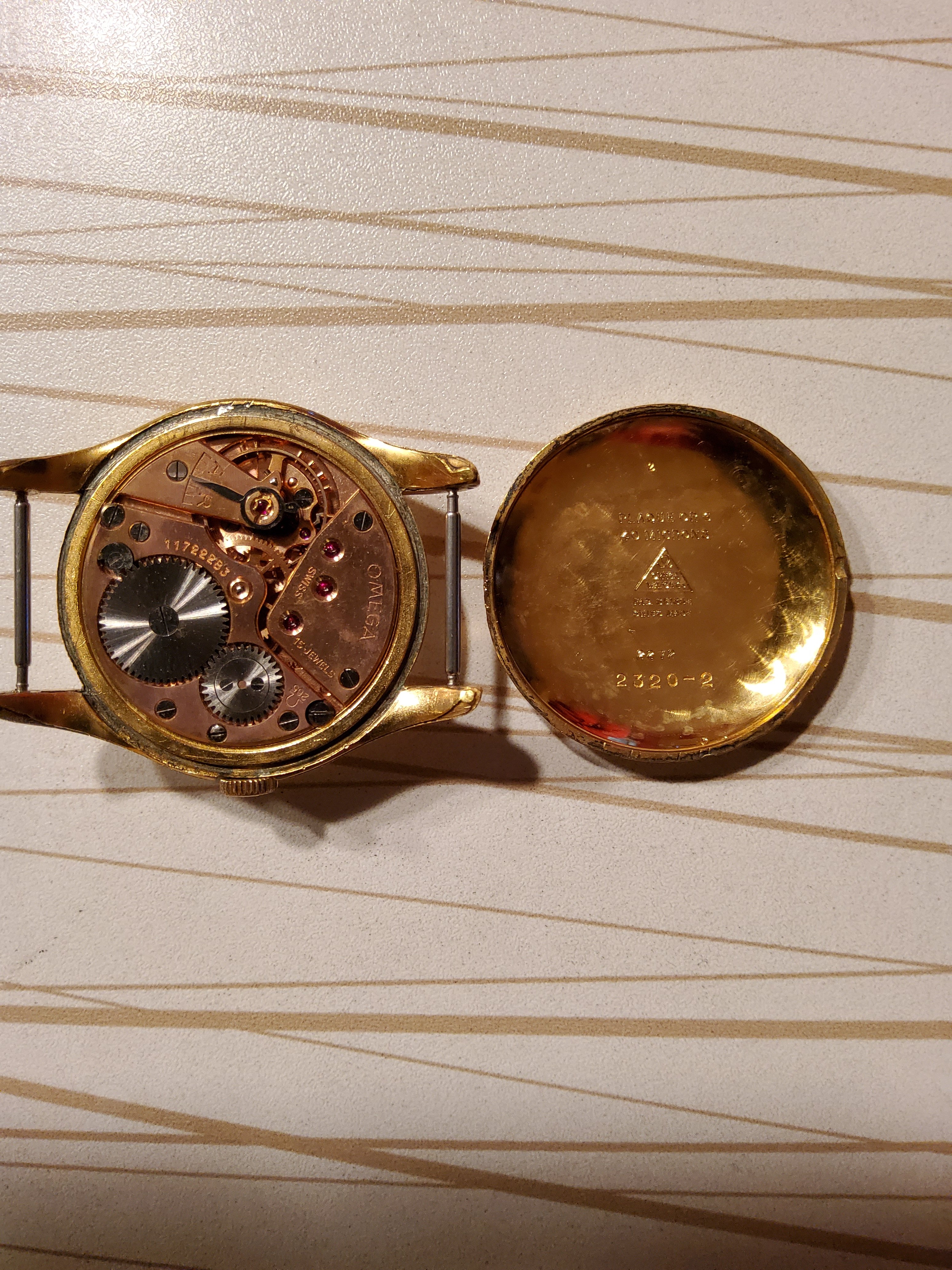

Good morning, sorry to crash like this but I need some help.
I just inherited an Omega vintage and I'm trying to get some information on it, like production year, model and market value (I do not intend to sell it).
The information on the internet is not clear.
Thanks in advanced for your time.

Hi pal, I think you may need to open a new thread for your question as members are requested to ask questions for every watch under different threads.

The trouble with redials is that they tend to look like redials. Personally I'd look for a replacement dial and keep the original separately, assuming it is possible for this model which I know nothing about.
