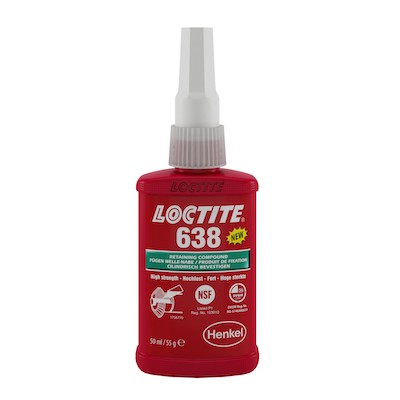

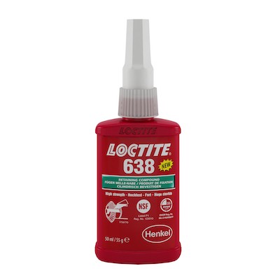

Sorry, I thought you had a press fit tube, didn't read it properly.
638 would still work, or if you want to be pedantic and use a thread locker on the threaded tube, Loctite 263 will give you a near permanent solution.
Not trying to be pedantic. Just trying to be sure I don’t do something totally incorrect. Hoping it will still be water tight.

Sorry, it wasn't a jibe, just light hearted play on words.
Many Loctite products fill the same gap (pun) so they can be used almost interchangeably for our purposes as long as you compare the specifications.
