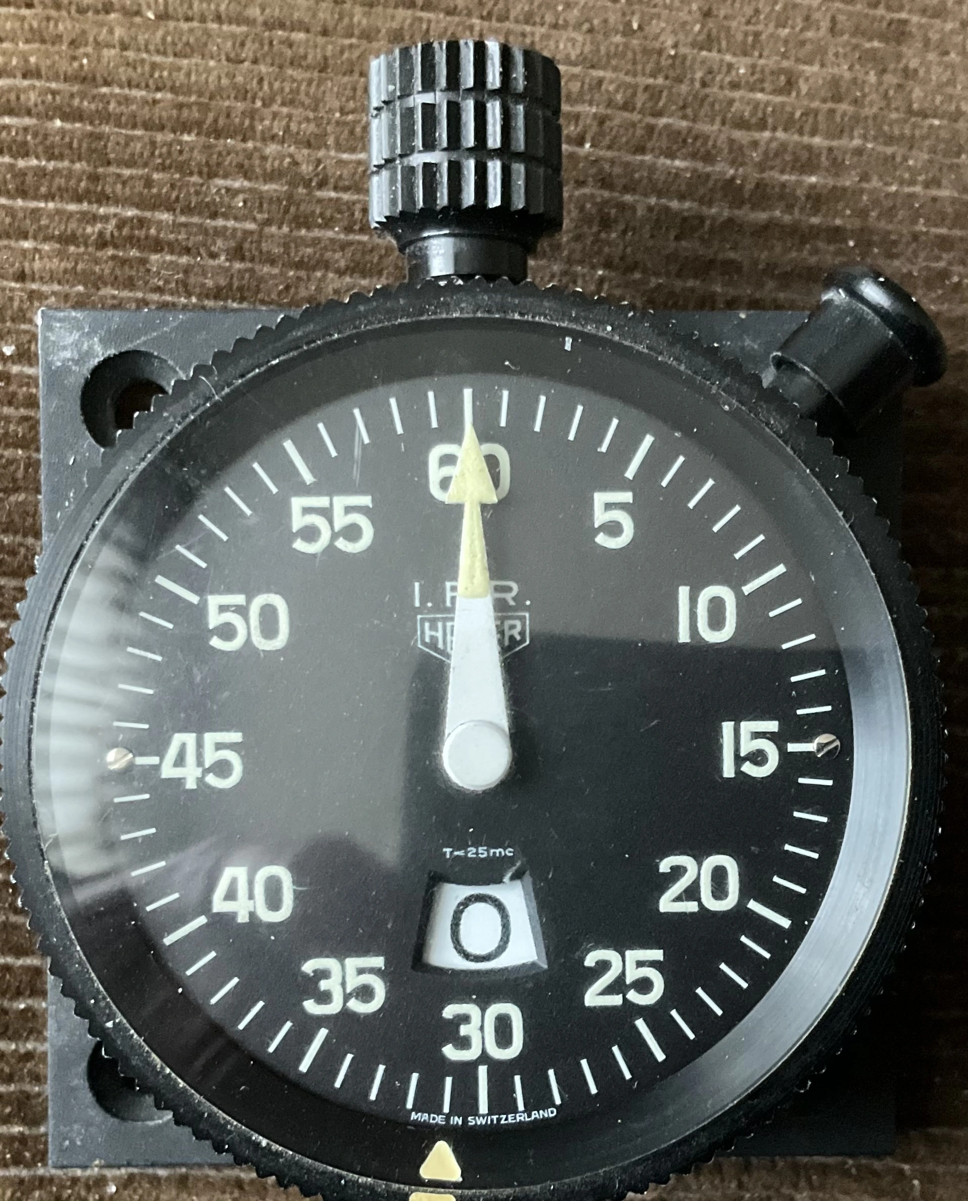

I discovered this in a box of scrap watches. It runs. It looks as though it might be intended as a military vehicle dash clock. The seconds hand traverses the dial in one minute, the dial at the 30 position recording indeterminate passing minutes, I’d call it sort of a “jitterbug” timer as the balance wheel operates at over 36,000 bph. The dial is marked I. F. R. Heuer T=25 MC. I’m curious. Does anyone know its purpose?

There are several of these available on line at present. They were apparently made during the 1970s and 1980s by Heuer, and they were apparently used as an aircraft instrument. The I F R referring to Instrument Flight Rules. What I don’t understand is how the readout refers to flying blind.

It's an aircraft timer. IFR is for Instrument Flight Rules. It's to help with navigation in low visibilty settings.
Hopefully one of our members who is a pilot can illuminate us on its practical use.

Flying under IFR is outside my experience (I was an I Follow Railroads pilot...) but I.F.R. means more than just "blind" flying. It includes taking instructions from Air Traffic Control. ATC will tell you which direction to fly, at what height, and sometimes at what speed. Often when arriving at a busy airport the aircraft may be told to "hold". This means flying at a constant height in a "race-track" pattern around a fixed point. The normal hold depends on flying four legs at a nominal one minute each, two legs are straight, two are 180 degree turns taken at a "standard rate" of 3 degrees/sec. Depending on wind direction and strength the legs may need to be lengthened or shortened to ensure that the "holding point" is passed each 4 minutes. Hence watching the large second hand is important. The minutes counter, well, I suppose it's mainly used for complaint to ATC that "We've been holding for 20 minutes and are short of fuel."

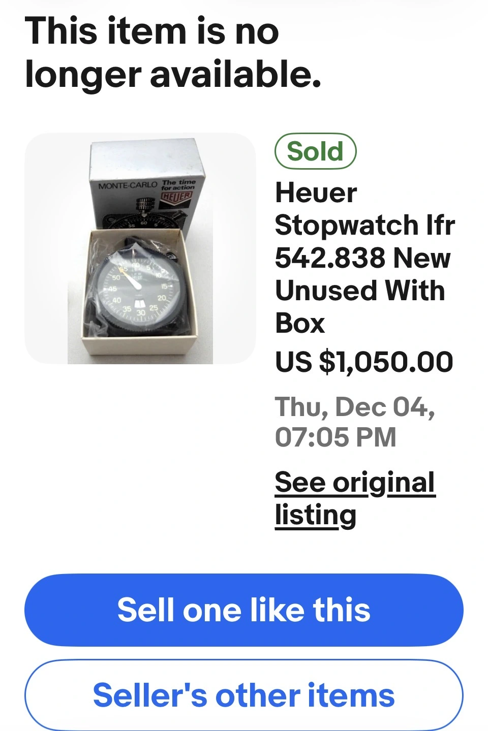

Makes perfect sense. Thanks for the explanation. I can’t believe the asking prices for these on the internet.

Glad I checked. Was gonna offer you $5000!

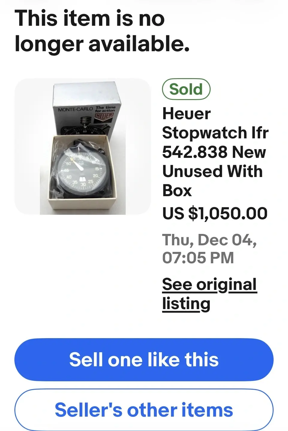

I’ve seen these for sale for around $500.00, but one duffus had one he offered for over $3,000.00! If this one sold for $1,050.00, I find that to be astonishing!
