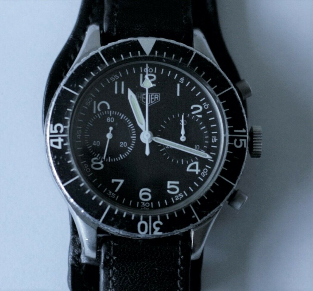

the sellers pics are terrible and i'm asking... has this dail been "washed " of its lume or is it just bad white balance on his part?
pic feels almost monochrome

You should be aware that the Heuer Bund is probably the most refurbished watch in history; a lot of them have their cases re-bead blasted, the hands and dials relumed, some with fake engravings, and often passed as "NOS". They are beautiful but do not pay a premium for them.
His dial looks like it's a light yellow/green with bad lighting, I would ask for a photo in the sun. Also, I was going to guess this was a Sinn refurb dial too, but the subdial fonts are different from the example in the brown snout article. It could be right? Lots of variants, but not 100% sure.
In this one the bezel and case actually look good and not restored. Do you have a pic of the back?

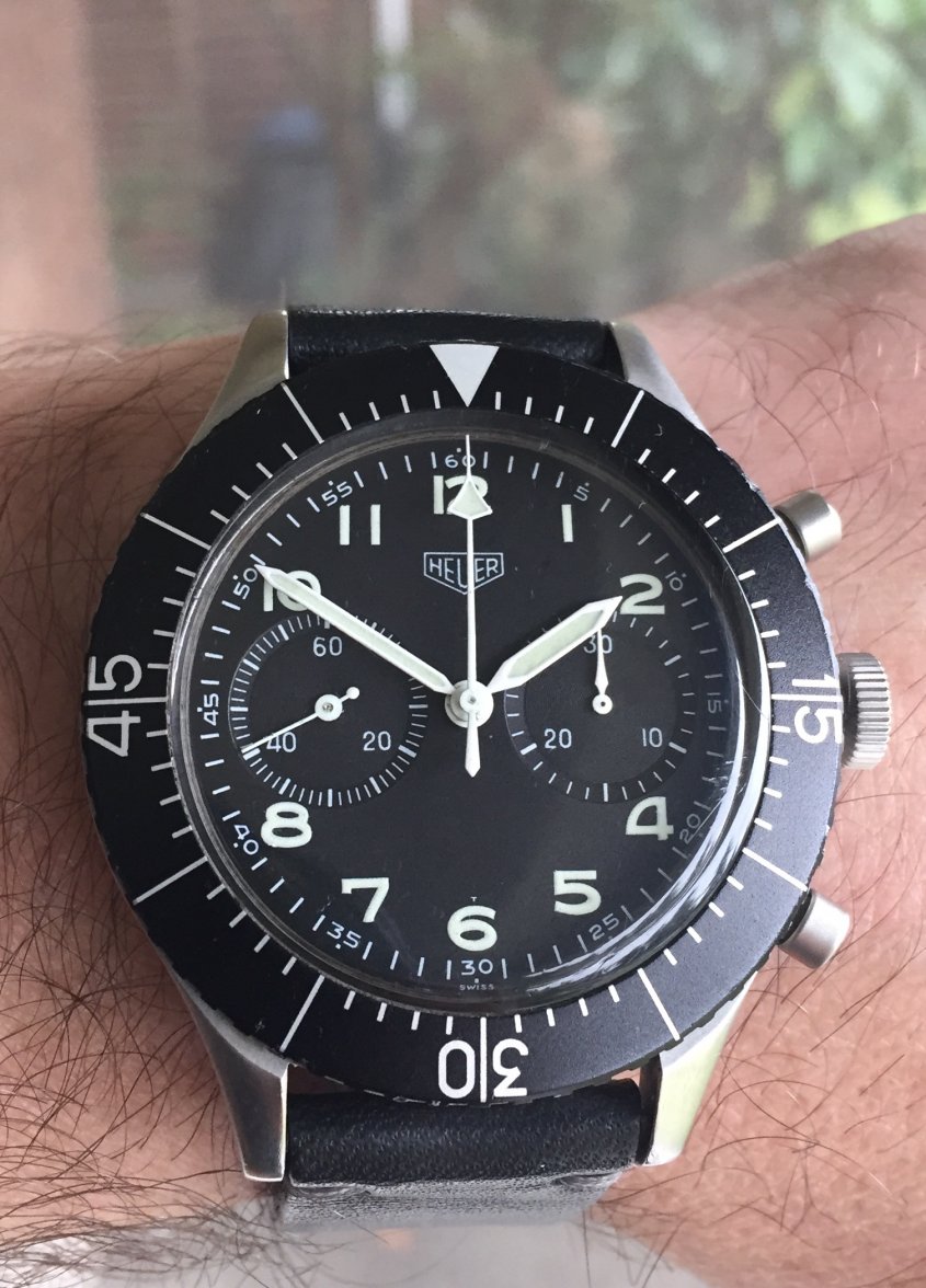

There is a lot of truth in that statement as, if authentic, these were all flown watches (F104 Starfighters in the late 60's and 70's) and they took a beating. Many were refurbished by the Bund and had any number of replacement dials, hands, parts and case refinishing done over the course of their service life. Some were refurbished earlier, and many later or even multiple times, which is why there are different versions of the 3H dial styles, Heuer symbols, no 3H dials - both in tritium (small "T", like mine below) and and even later without - all of that was prior to Sinn taking over the design and servicing!
I posted mine in other places here today, so here it is again:

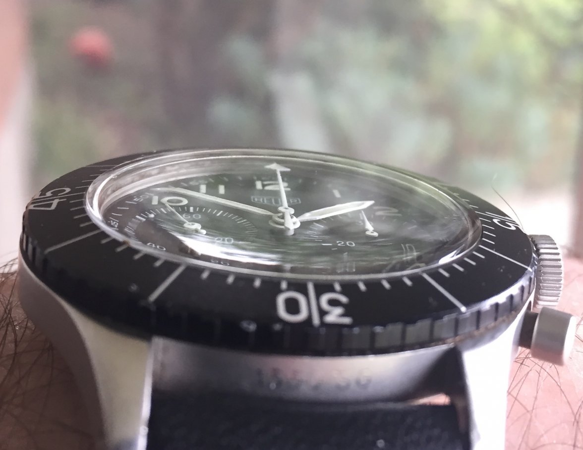

You can find a good to great example without over extending if you are patient and keep doing some research. Given the fact that these are bead blasted, I think you can get a sense of how much refurbishment has been done based on how clean the case lines are and if you can see the reference number (between the bottom lugs - pic below) or the watch number (between the top lugs).
Blurry, but you get the gist...
My Bund was purchased from an established and current OF member, who in turn acquired it from a well-known seller on the Military Watch Resource forum and it has been in my possession since 2017.
