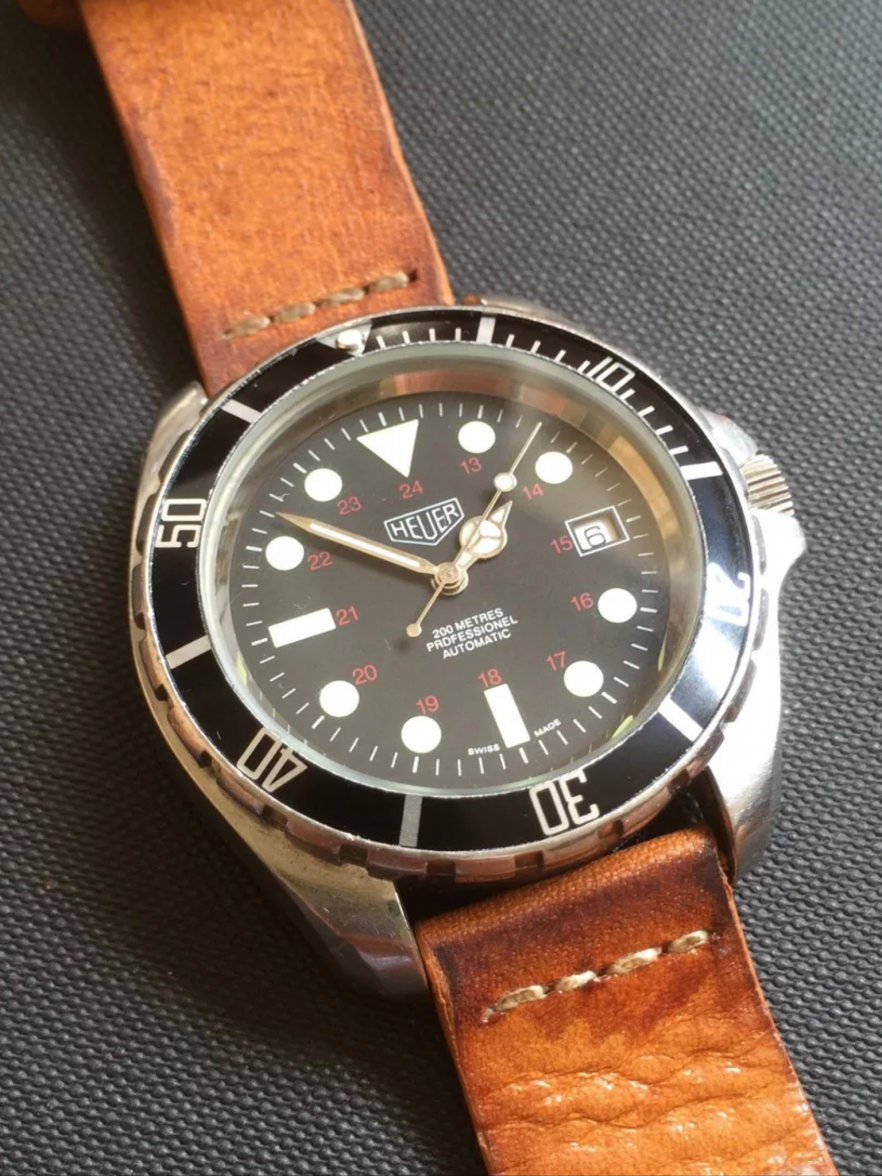

    I've got a keen interest in the watch below. From what I understand this model was made in France and, as such, should say so at the bottom of the dial.
    I know that production of later models was switched to Switzerland and 'Swiss Made' was added to the dial. I've been researching this watch for the last couple of hours and I cannot find this dial anywhere.
    The only examples I can find say 'Made in France'. I'm not too sure I'm explaining this very well but the 'Swiss Made' on this dial seems wrong and I don't want to throw my hard earned at something that isn't legit.
    Any help will be greatly appreciated.
  2. Uniqez May 7, 2016
    1,440
    3,710
    Is that me, or they've spelled professionnelle with D instead of O?

  3. Uniqez May 7, 2016
    1,440
    3,710
    Also, looks like the dial, hands and the crystal are brand new compare to the case.

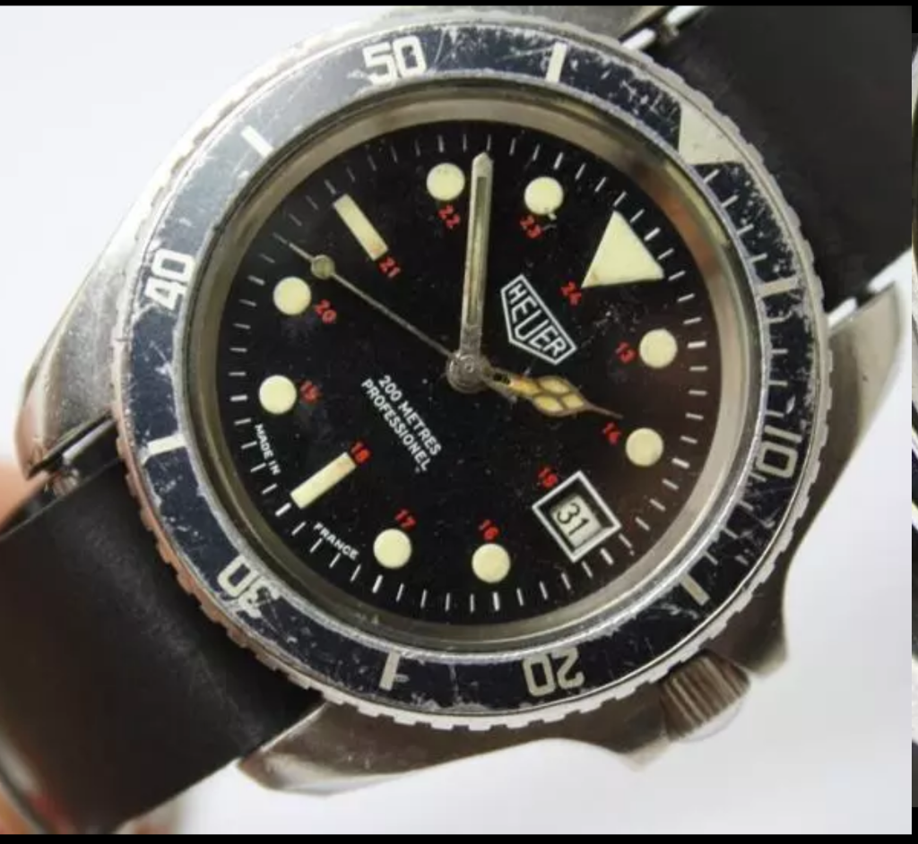

    Here is something to compare with...
    Almost doubled the price, of the one you found.

  6. Giff2577 Quick with the tools! May 7, 2016
    930
    3,717
    I would steer clear as it looks very odd. The Monnin dial should say made in France. The seller mentions the case is a Monnin yet they do not show the inside of the case back. The hands look new, the dial looks fake and new and The edge of the bezel looks wrong too. The lume looks white and flat or printed and not puffy and yellow. The case back also states Swiss Made. It looks like a regular 844 with a fake dial. That strap is something else. Did they take decals from a scale model racecar and applie them to it? Decal on the inside and strap keepers on backwards?

  7. bristnj May 7, 2016
    2,170
    31,992
    Fake. The 24 hour dial was only used by G.Monnin who made the Heuer 844 for one year in 1979. The "Professionel" is also correct, and is French. The movement should be an FE4611A. No "Monnin" Swiss dials. Plus everything is out of proportion. Sometime you do see the original 844 with Mercedes hands, but they have most likely been replaced as originals were cathedral. Not a deal breaker on an actual Monnin. The one you are showing is a Frankin and dial is not original.

  8. xgeryx May 8, 2016
    94
    74
    Yep it's a franken.
    It's very disappointing though that now we have frankens sold in Europe too. I thought it was an Asia thing.
