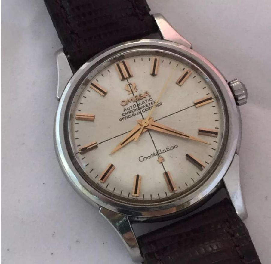

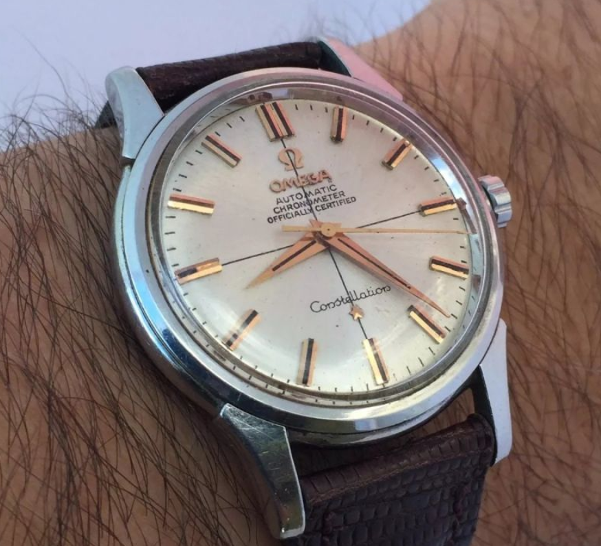

    Hi all, first time poster here. Only getting into the hobby over the last 6 months.
    I've found this vintage Constellation which looks great to me - but the seller doesn't know much about it -
    Would really appreciate some guidance from the nice folks on here - I'd be spending around $250 dollars on this.
    Thanks!!

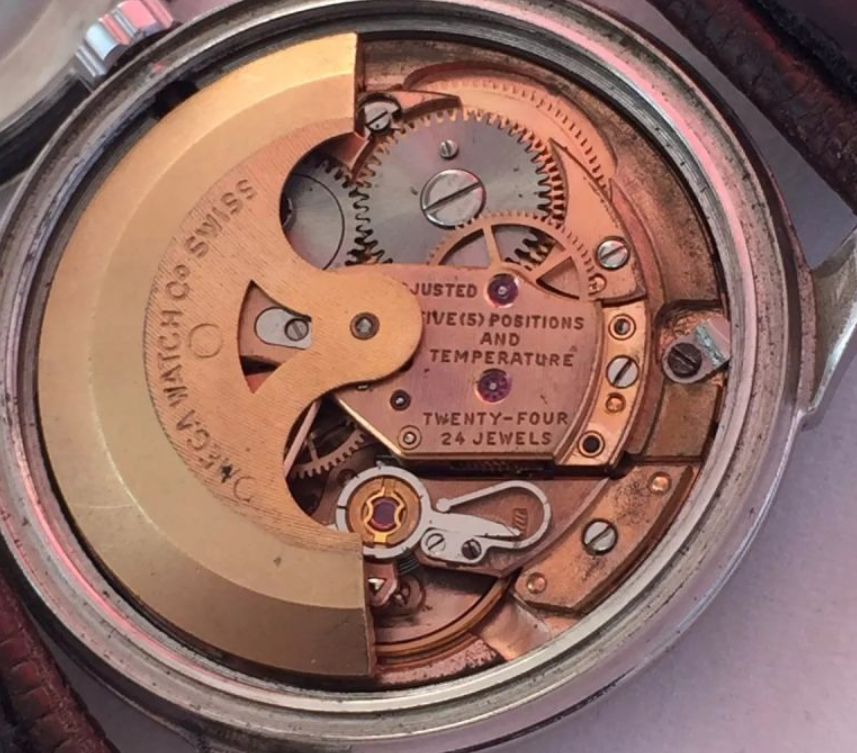

    It depends on what you want for your money.
    This one is a bit of a troubled Connie.
    Heavily done redial.
    Worn medallion.
    Incorrect Replacement crown.
    And the movement looks in poor condition.
    Hope that helps.
    Dan S, Noddyman and JMK89 like this.
  3. JMK89 Oct 17, 2018
    5
    That is exactly the kind of thing I was hoping to hear, I thought the dial looked redone but was assured it hadn't been and was all original etc.
    Every day is a school day!
    Thanks @Peemacgee

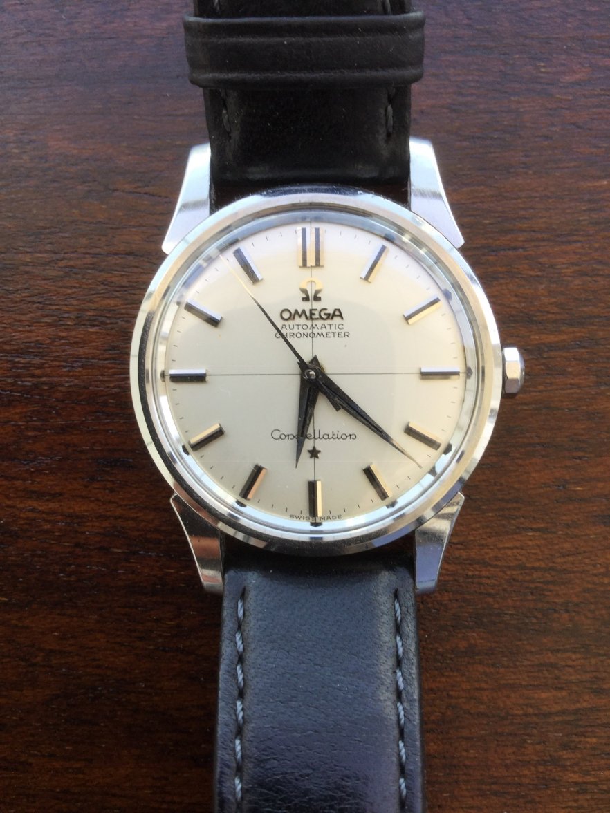

  4. Peemacgee Purrrr-veyor of luxury cat box loungers Oct 17, 2018
    5,127
    7,835
    The rotor has also been replaced -no biggy but I’d like to see the serial no.
    This is what the cross hair dial should look like 8E0E6386-EB09-464A-AC4D-D382805E9215.jpeg

  5. bimbim1207 Oct 17, 2018
    312
    908
    stay away from this kind of watches just by looking at the dial. Unless it were on offer for $100, take it for parts for future use.
    JMK89 likes this.
  6. Noddyman Oct 17, 2018
    1,116
    1,771
    Looks like somebody used a Sharpie pen on this one.
