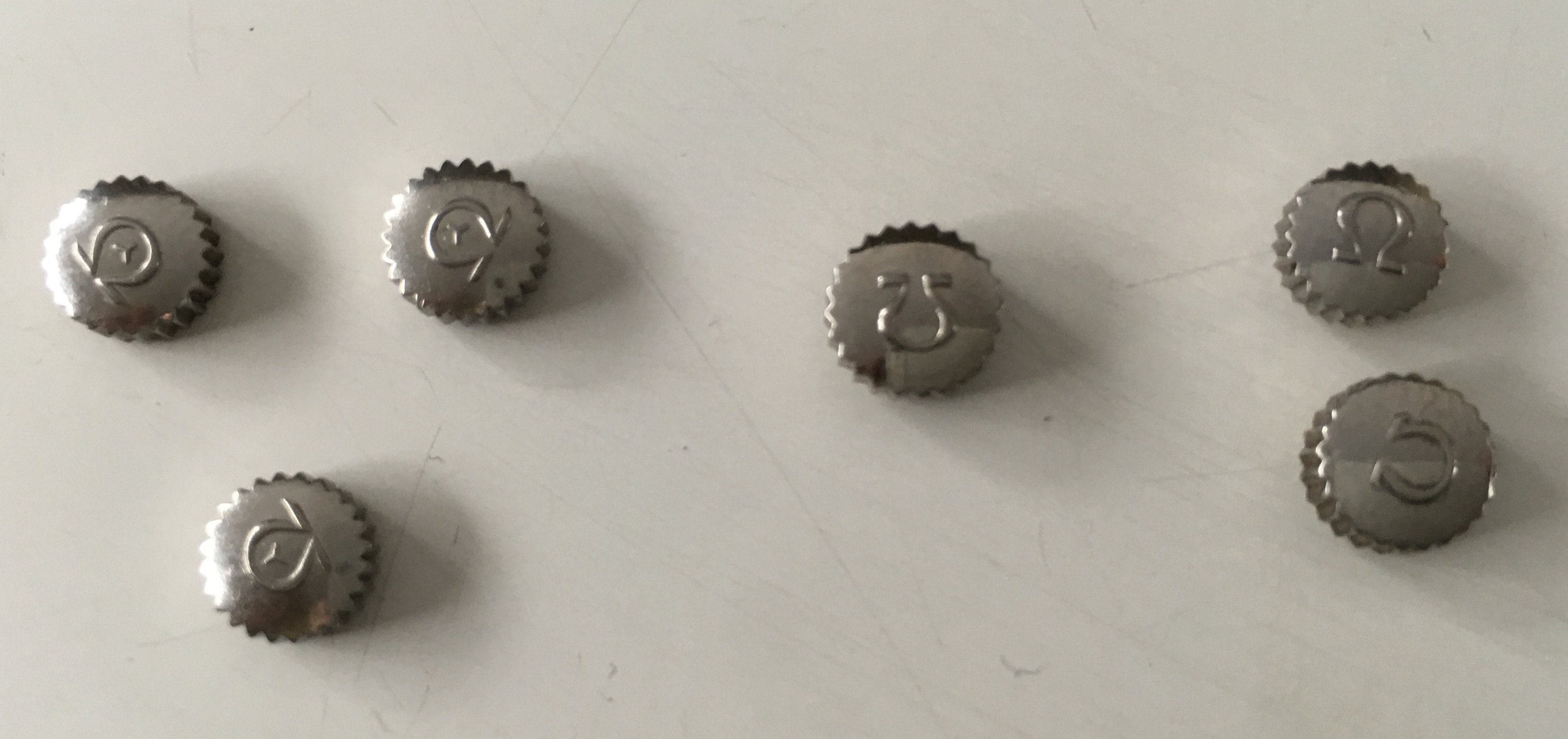

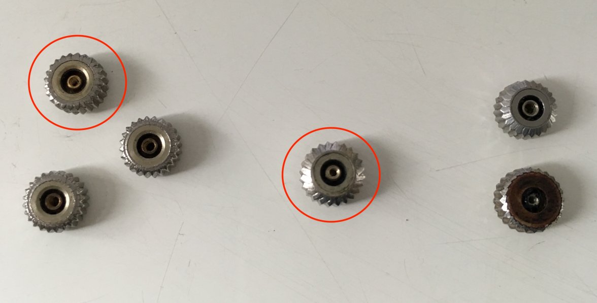

    The 2913 and early Seamaster's are Tap 9 (smaller ones circled)
    Speed Masters are Tap 1.0mm
    Im not sure which size the 2914 is, but they should be the two lower crowns on the left

    Edited May 7, 2017

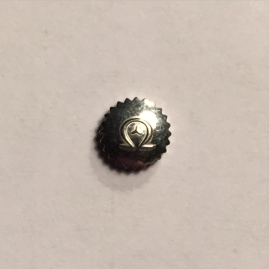

    Post a photo of both sides of yours
  4. kevin5 Jul 1, 2016
    19
    8
    Thank you for all the info! All I know is it was too small for my stem. My watchmaker thought I needed tap 9 but idk. Here are the pics...
  5. CajunTiger Cajuns and Gators can't read newspapers! Jul 1, 2016
    2,678
    9,741
    yes that looks like its for a 2913

    The 2913's crown tap size is 0.9mm, 2914 is 1.2mm and 2915 is 1.0mm. They also differ in their tube size as well.
