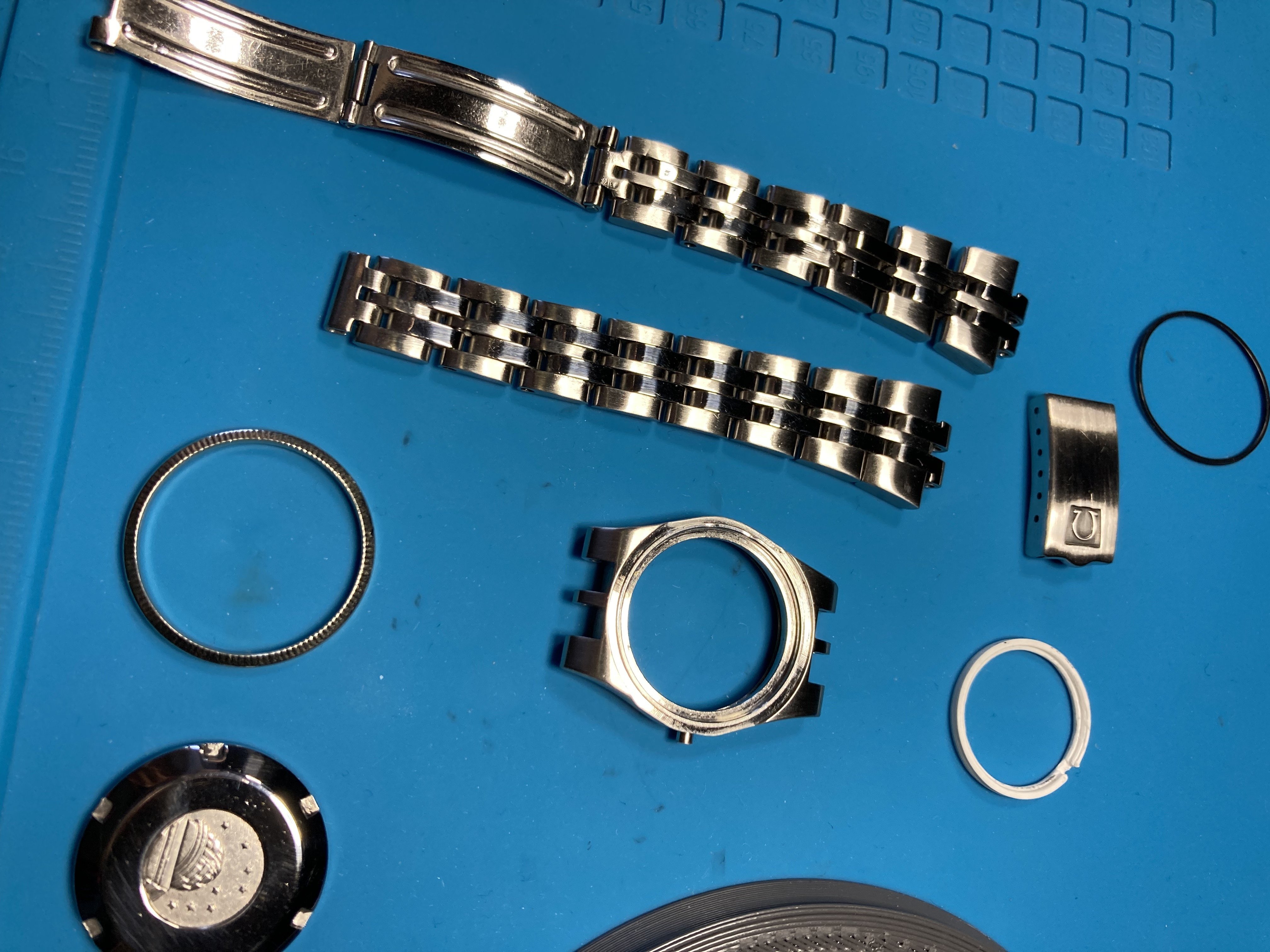

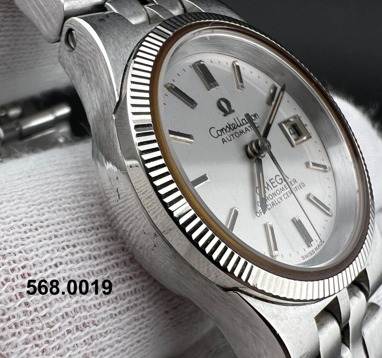

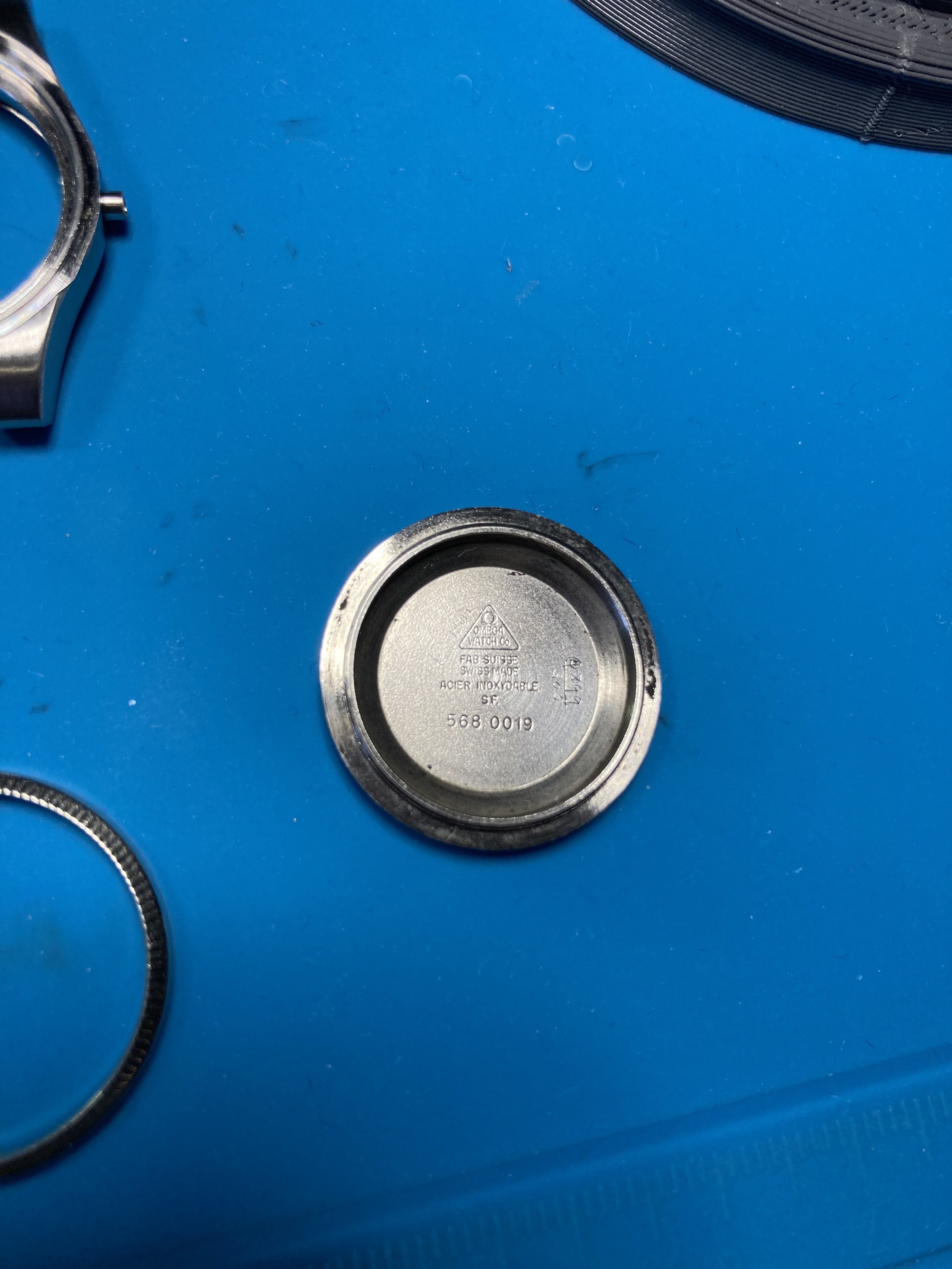

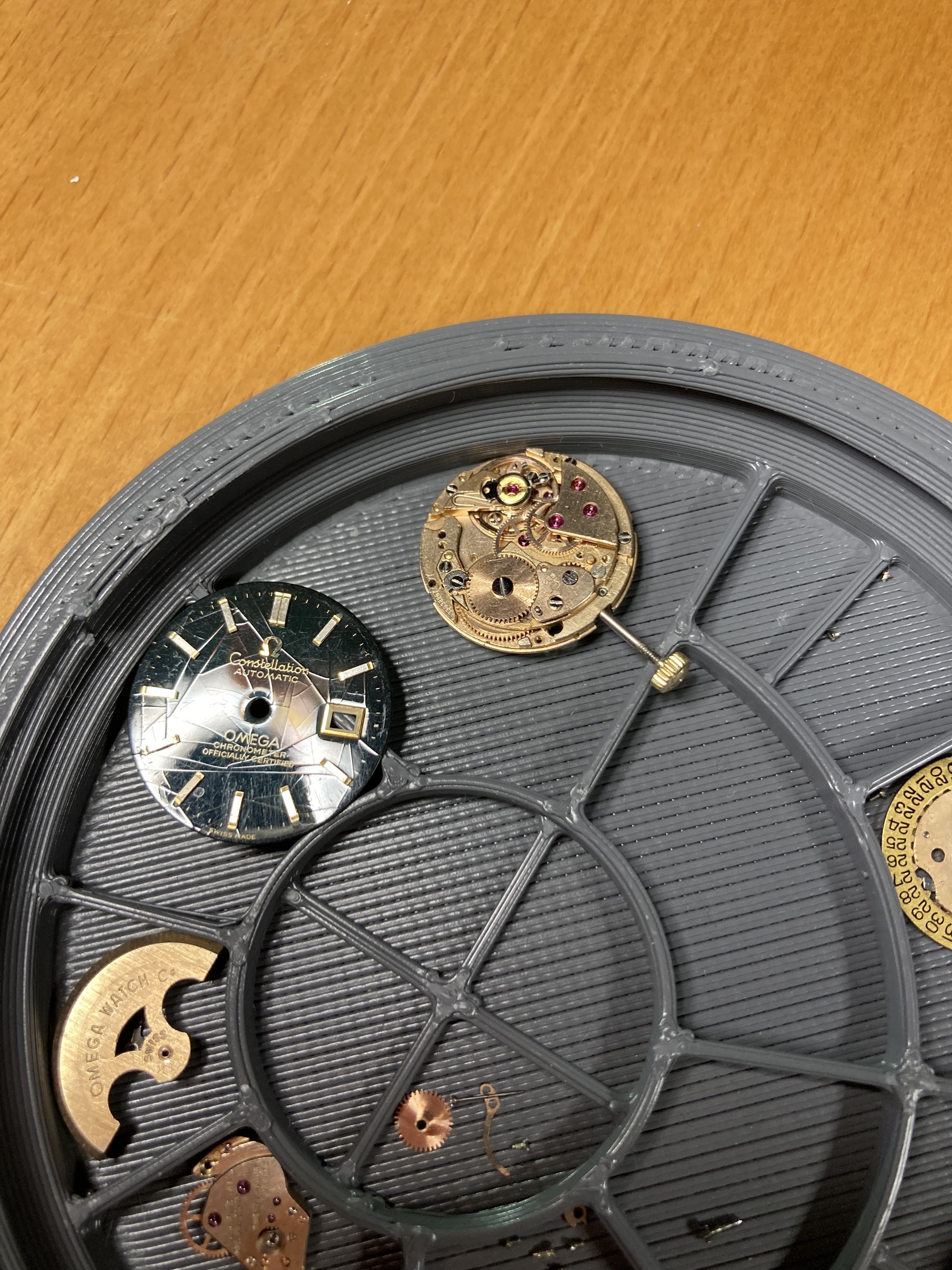

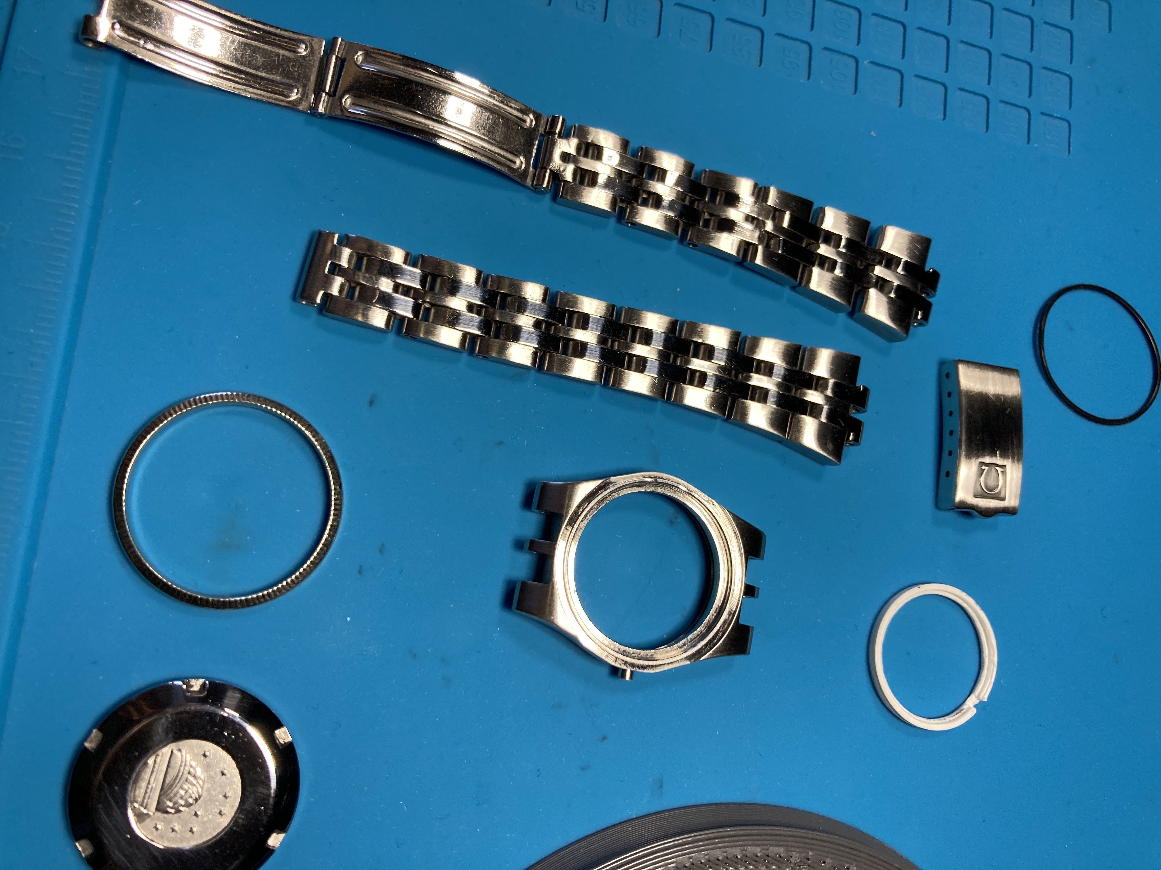

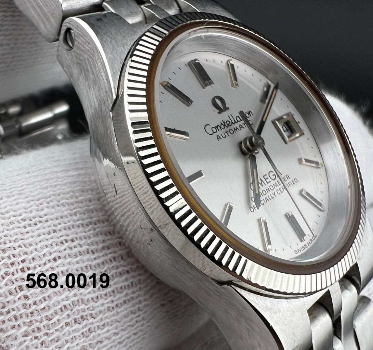

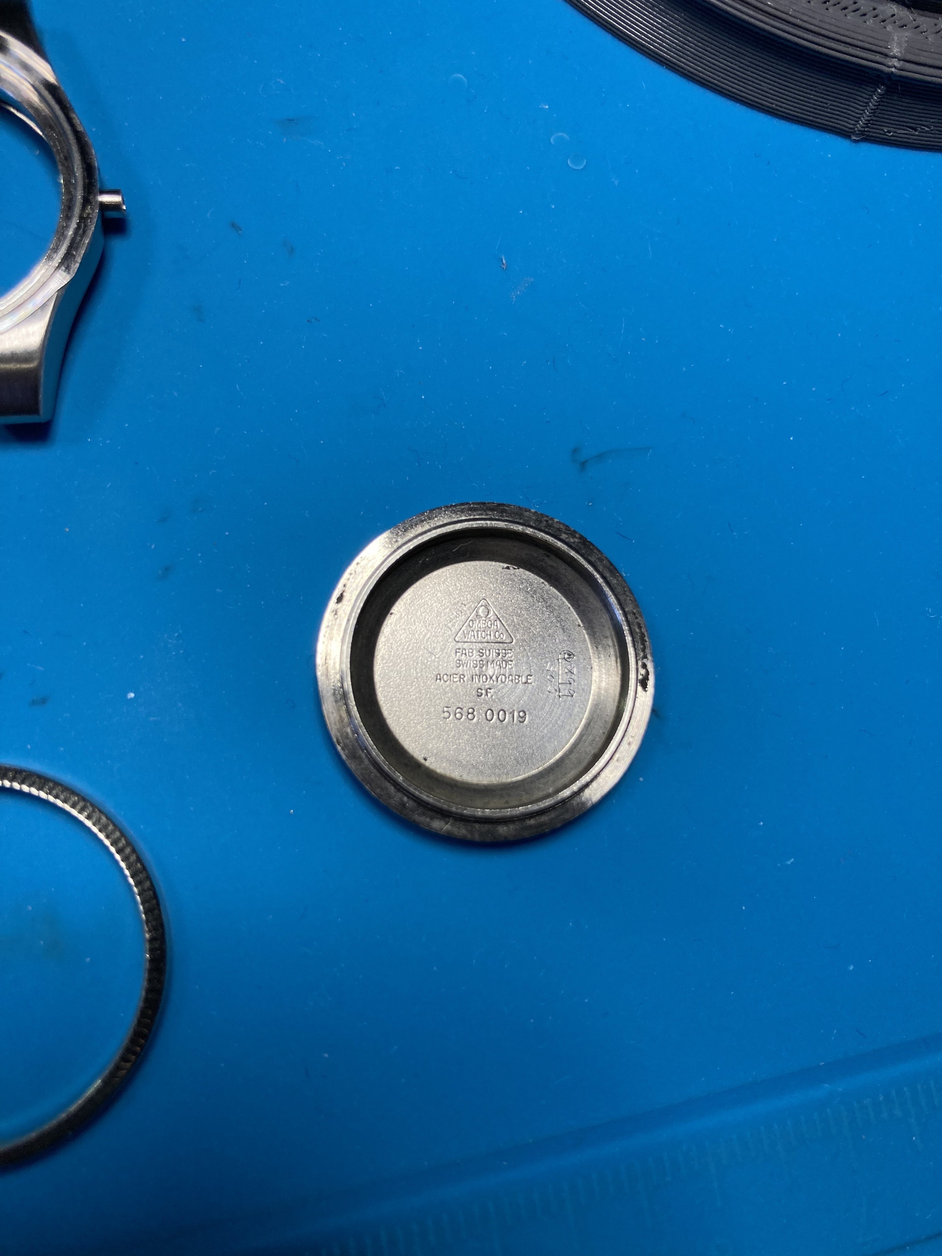

I found a nice case for a 568.0019 constellation ladies watch and then went and sourced the needed Cal. 685 and a fitting dial (At least I think so). I serviced the Movement and it is running very well.

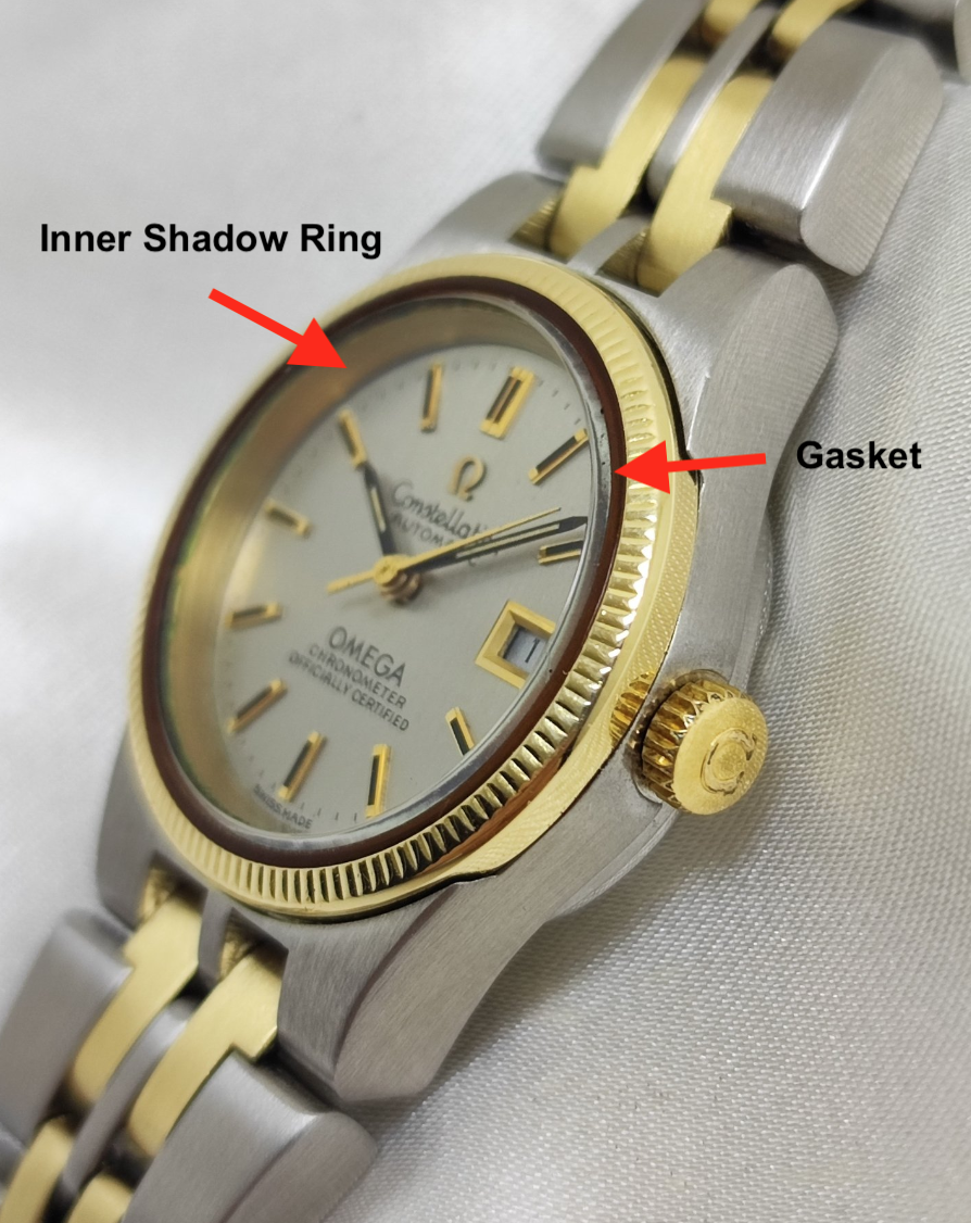

The problem is that I am missing the inner bezel (shadow ring, Lünette, Rehaut) and the crystal gasket (should be 22mm outer diameter). Would anyone be so kind and help me out with the part numbers on that? I am not able to find those at all. The watch over all seems pretty rare to see. Probably super hard to get the parts, but maybe they are used in other watches too and I can somehow get lucky finding them. Or at least I would be able to know the exact dimensions of the crystal gasket.

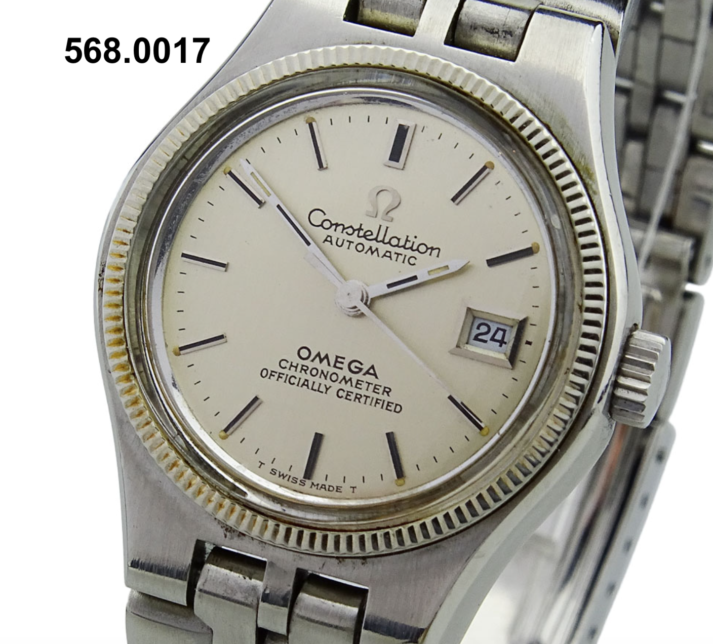

Here some pictures of what I got and one reference picture of what I need:

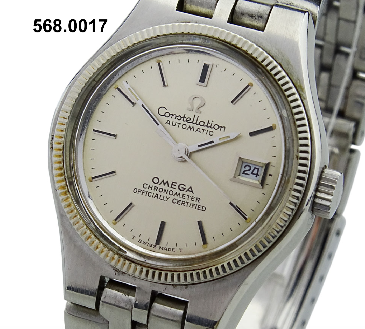

Could I have any luck with this:
Glass, Steel Ring, Omega PZ5189
It is for the 568.0017. Maybe this will solve my problem.

According to this from Cousins, you need a TN5215, which is a mineral glass. There is one on eBay at a reasonable price. What made you think that you need a PZ5189?

Thanks for clarifying. If I were you, I would try to fit a generic mineral crystal and gasket instead of an Omega acrylic that is made for a different case. The cases with the two references you posted above look quite similar, but the bezels look different to me.
