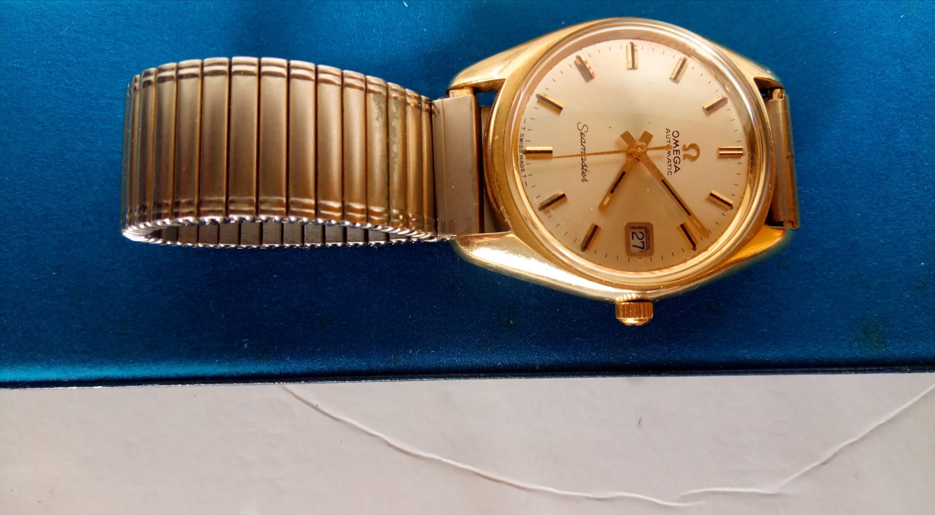

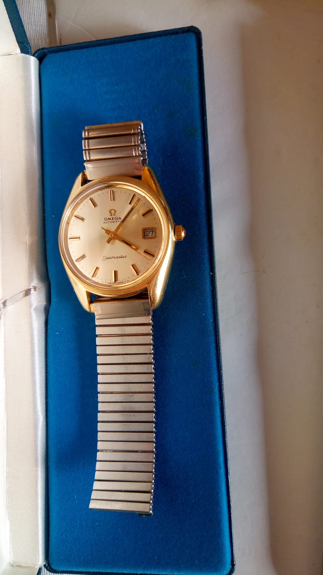

Hello,
I need help in finding the model of this watch. I know that it is a Omega Seamaster and it was offered to my grandfather in 1972 in Portugal but I can't seem to find the exact model to try to find out its current value.
I would appreciate if anyone can help me with this
Thanks
8,701
14,612
Exact model number (reference number) can be found inside the case back.
5,076
15,713
You will likely want to take this to a watchmaker to open it for you - resist the urge to open this with scissors, knives or sorcery. The watchmaker can also give you a quote for a much needed service. Folks here can make recommendations for a watchmaker with an Omega account.
Pro Tip: the person at the mall who changes watch batteries is not a watchmaker 😉
1,501
5,694
I think it's a Omega Ref.166067 with a Caliber 565. This Ref was for sale from 1969 to 1973 so the time would fit perfectly.
