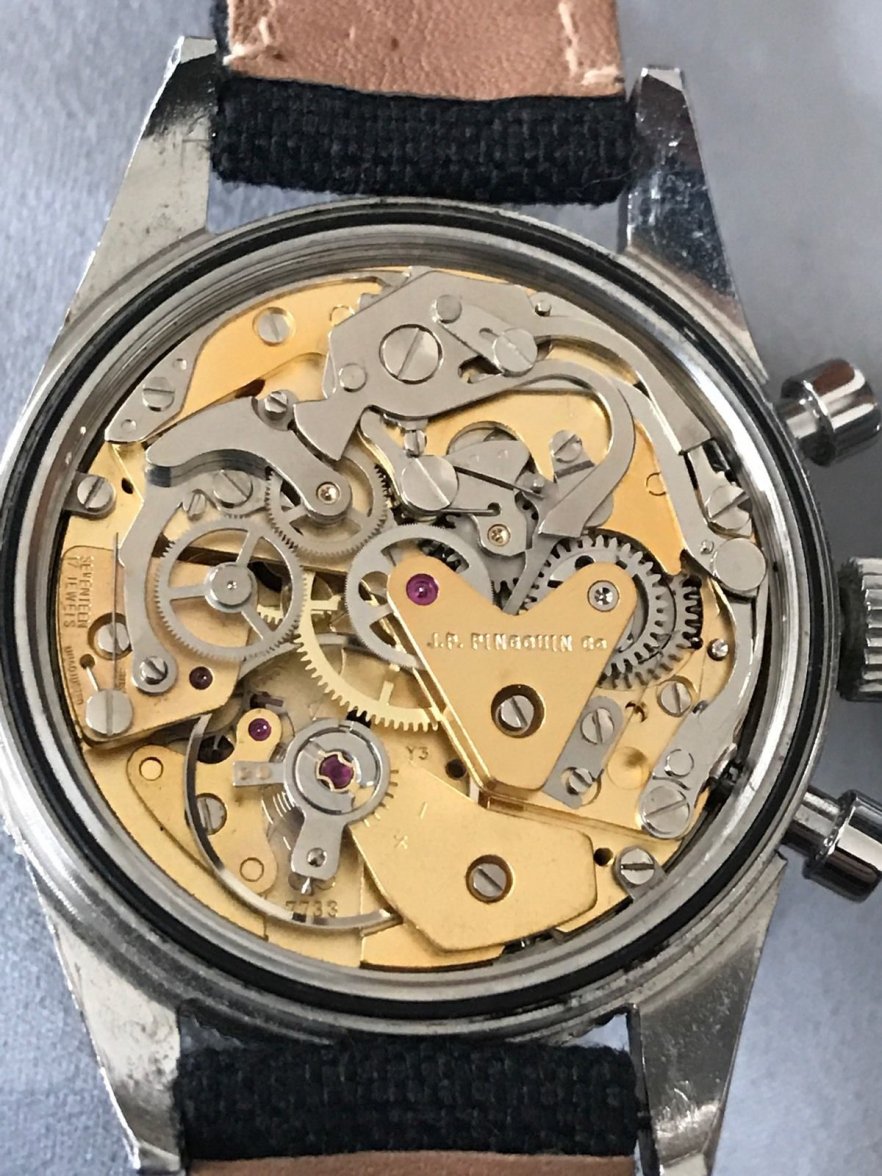

    hi
    i am interested in buying a 2-register LeJour, a "poor-man's autavia"
    can you help me determine if this movement is correct? a valjoux 7733? all original?
    -----watch i am looking into----

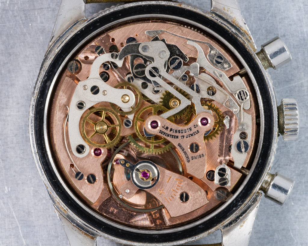

    ----posted model, i am comparing to----

    The second picture is a Landeron movement. The first picture does in fact look like a valjoux 7733

    yes. thank you, i see that.
    is that 'correct'?

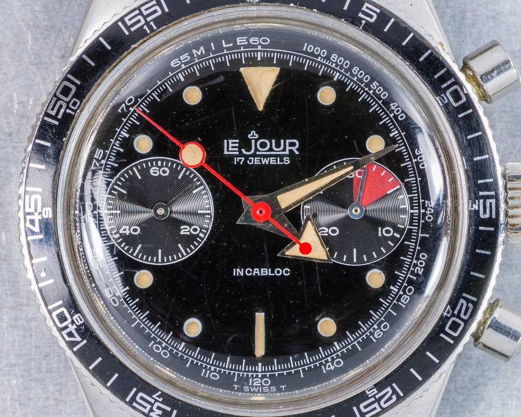

  4. luzer Dec 19, 2016
    289
    108
    pointed out MILES vs MILE on the dials
  5. BobXX Dec 19, 2016
    86
    137
    I think that's okay. There's always a lot of small dial variations with obscure vintage chronographs like these LeJours.
    The only things I notice are that 1) the lume is missing from the chrono sweep hand and 2) the pushers have been replaced recently. Can't really see the crown, but there's a decent chance that that's been replaced as well.
    The Valjoux 7733 is a more desirable movement than the Landeron.

  7. ncstate1201 Dec 19, 2016
    263
    194
    Looks more like a nivada/croton chrono than a poor man's autavia, may be good to compare to a few of those to see if there is any acceptable variation in crowns and pushers...
