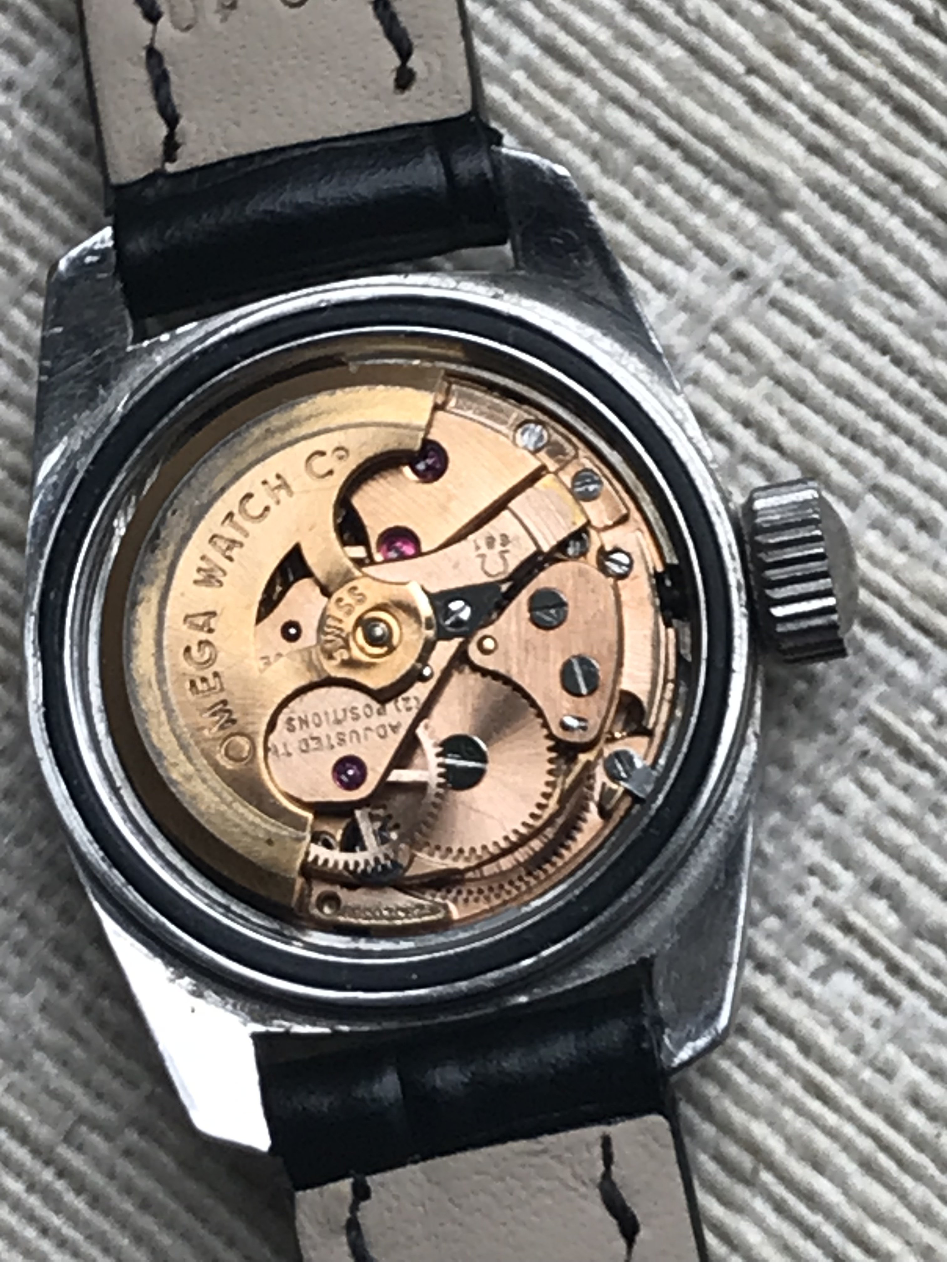

Hi all
Looking to remove the stem from this ladies Omega and need confirmation of which screw to loosen (or remove, if necessary). Hopefully someone out there has some experience with these movements
Thanks in anticipation

That movement needs a LOT of help! Of course, you are planning to give it the care it needs? And you have to ask how to remove the stem? 馃嵖

Right here...
Thanks Archer. Dies the screw have to come out completely, or just loosened?

Don't remove it. Just loosen it 1 to 1.5 turns, press down on it with the screwdriver, and see if the stem will come out. If it doesn't, then loosen another 1/4 turn and try again, and so on.

Thanks again. I鈥檒l give it a try later
