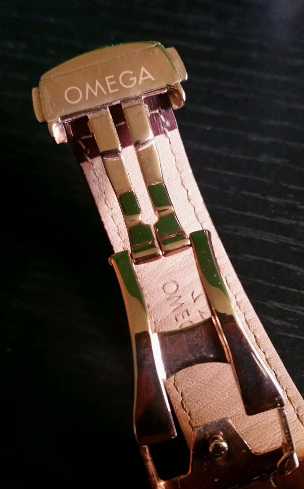

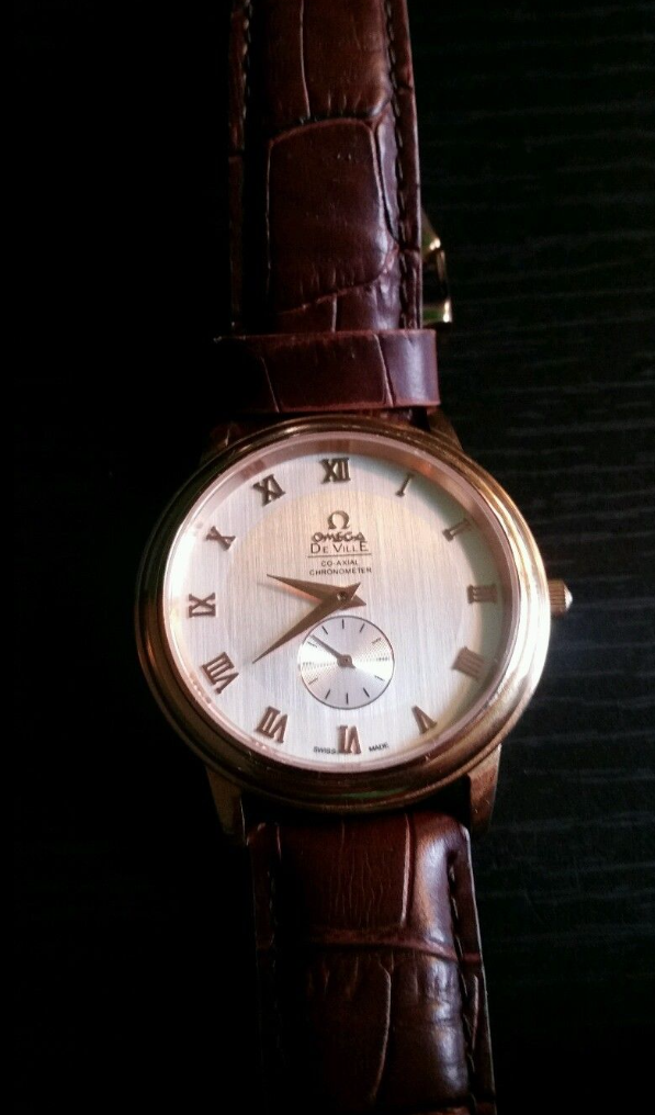

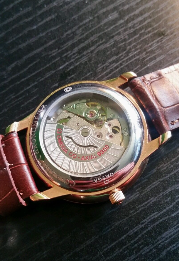

    I recently purchased an Omega on eBay for $200 and was wondering if anyone can help identify if it is authentic or not.
    The photos provided are the photos the seller provided; I have not received the watch yet.
    Any feedback would be appreciated. Thanks!
    Screen Shot 2015-07-01 at 10.58.59 PM.png Screen Shot 2015-07-01 at 10.59.04 PM.png Screen Shot 2015-07-01 at 10.59.10 PM.png

    Fake
    A cal 9300 looks like this
    [​IMG]
    And is a chronograph (stopwatch) movement, not a time only movement.
    Not a surprise for $200!

    That assumption is quite far from the truth; I actually did research the watch after I bought it (since I saw the deal and didn't want to lose it). My findings were not completely conclusive so I decided to go to a forum.
    The picture you provided is the back of a Seamaster, and they do not look like the back of DeVille's. If you research the back of Omega DeVille's, you will note that they do not look like the back of Seamasters but actually look more like the back of the watch I purchased.

    The back of a Cal 9300 is always the same whether Seamaster, Deville, or Speedmaster, the calibres don't vary depending on the watch they're in, if a special calibre is needed for a given watch it typically has a unique number like Cal 9301 for the gold rotor version that goes in gold case watches, however even that is the same between a gold Seamaster, Deville or Speedmaster.
    Omega did not go through a series of owners at all, for the last 32 years since 1983 it has been owned by Swatch Group. Prior to this it was owned by SSIH for over half a century.

    Interesting that the Omega Item number listed in the Ebay listing does not match the fake shown. The buyer should search that part number on Omega's site, and see that it should be a completely different watch (but still a DeVille) with an 8500 caliber movement.
