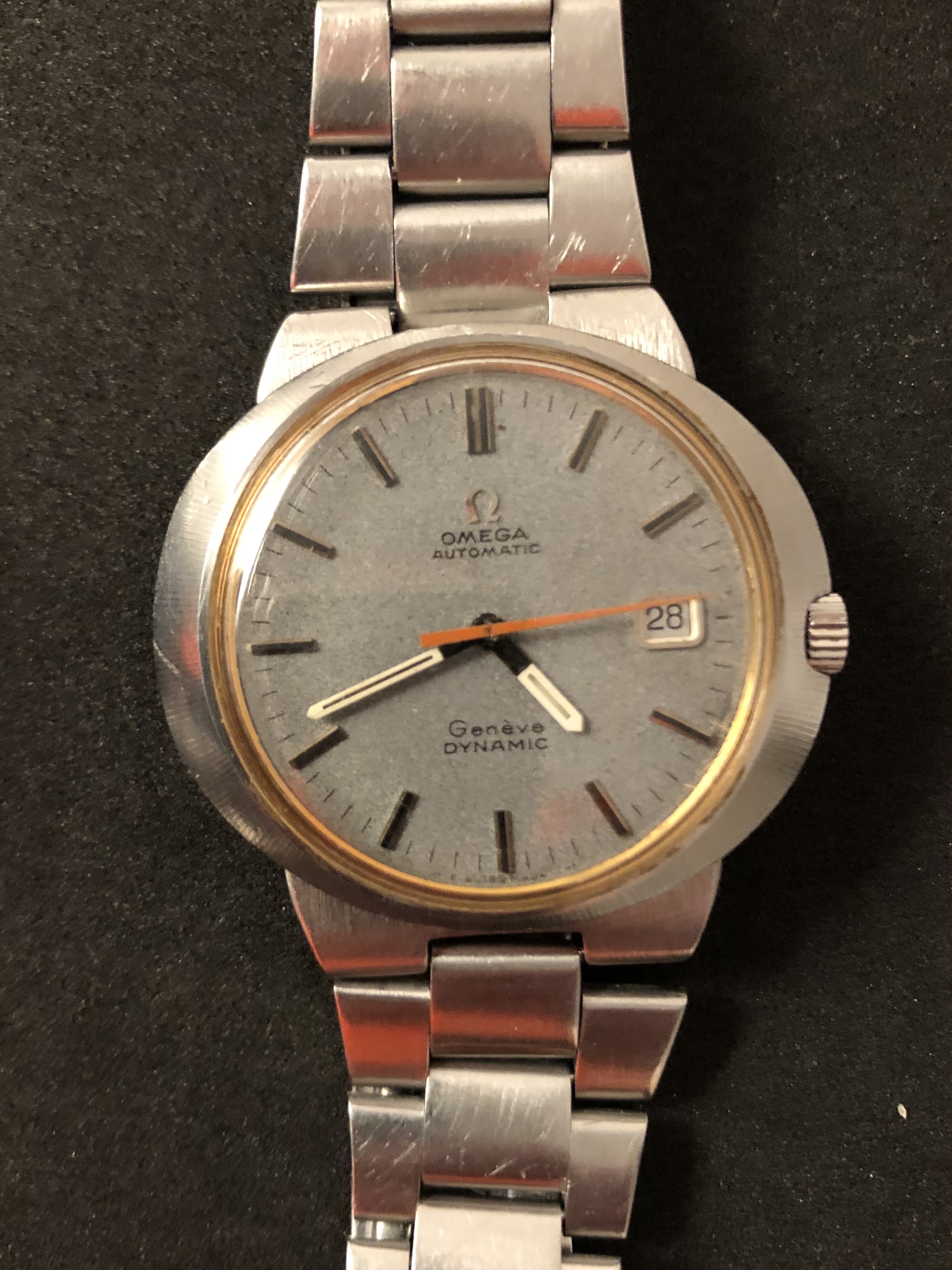

Hi
My watches split stem is not joining due to wear
I have unscrewed from crown so can I just purchase both parts of stem rather than crown too?
Also help with correct part would be much appreciated as it’s a minefield
Current female stem is 6mm including thread
Many thanks

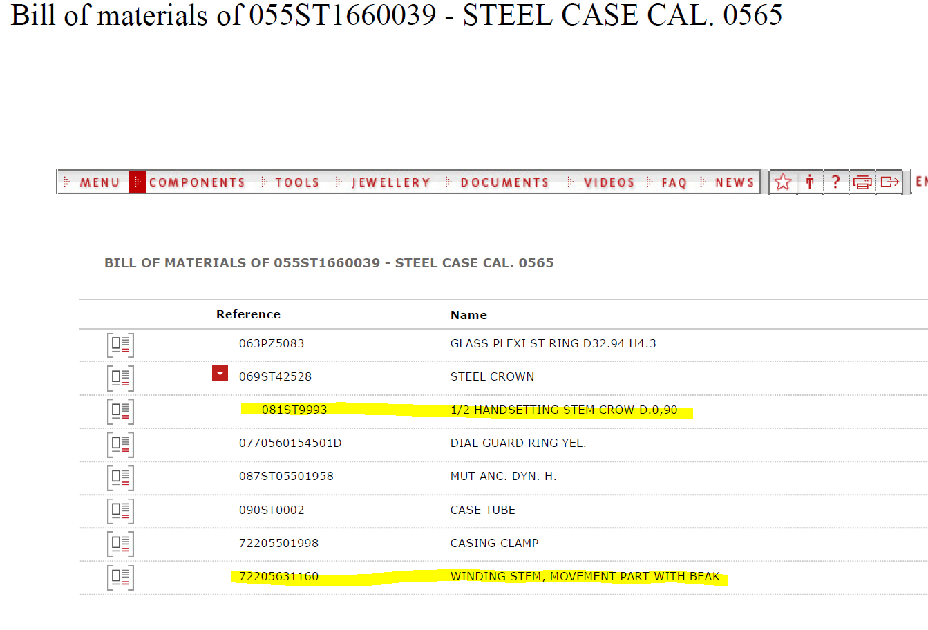

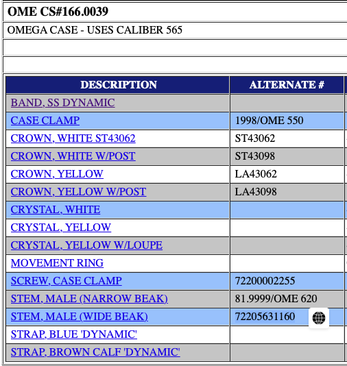

I've seen dynamic crowns that come with the standard post and some that come without. You can usually use/cut a generic female stem extender to use on the crown/female side. Are you sure the female stem is the part that requires replacing?
I've only ever had to replace the male stems. I see two options for the male stems. I'm not quite sure which one you'd need, but I'd guess it is the "wide beak." Hopefully somebody else with more info can chime in.

Okay, that's old! The Extranet hasn't looked like that for long time!
Correct part number for the female split stem is 081ST9992. The one you show is obsolete.
Cheers, Al
It is from https://www.cousinsuk.com where they can be downloaded I dont have acces to the Extranet 😀
If asking for parts numbers i guess OP is searching for new/older service parts, both numbers new and old are relevant then 😀
Yes, that's one issue with using the screen shots they downloaded before Omega closed their parts account - the information may be out of date, but it's better than nothing.
