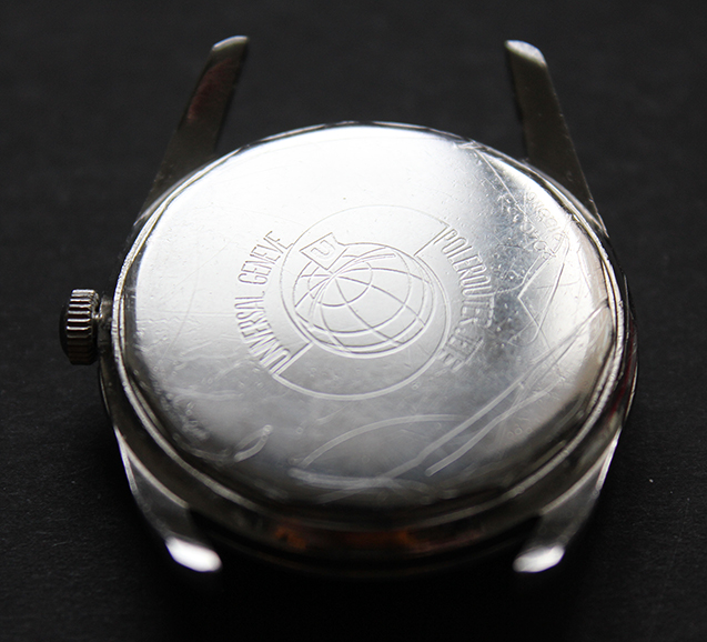

    Hi,
    Can someone recommend a good way to remove this caseback without damaging it? I'm trying not to add to the existing scratches.
    Thanks much,
    eustace

    95
    39
    Great, just ordered one on Amazon. I'll let you know if it works. Thank you!

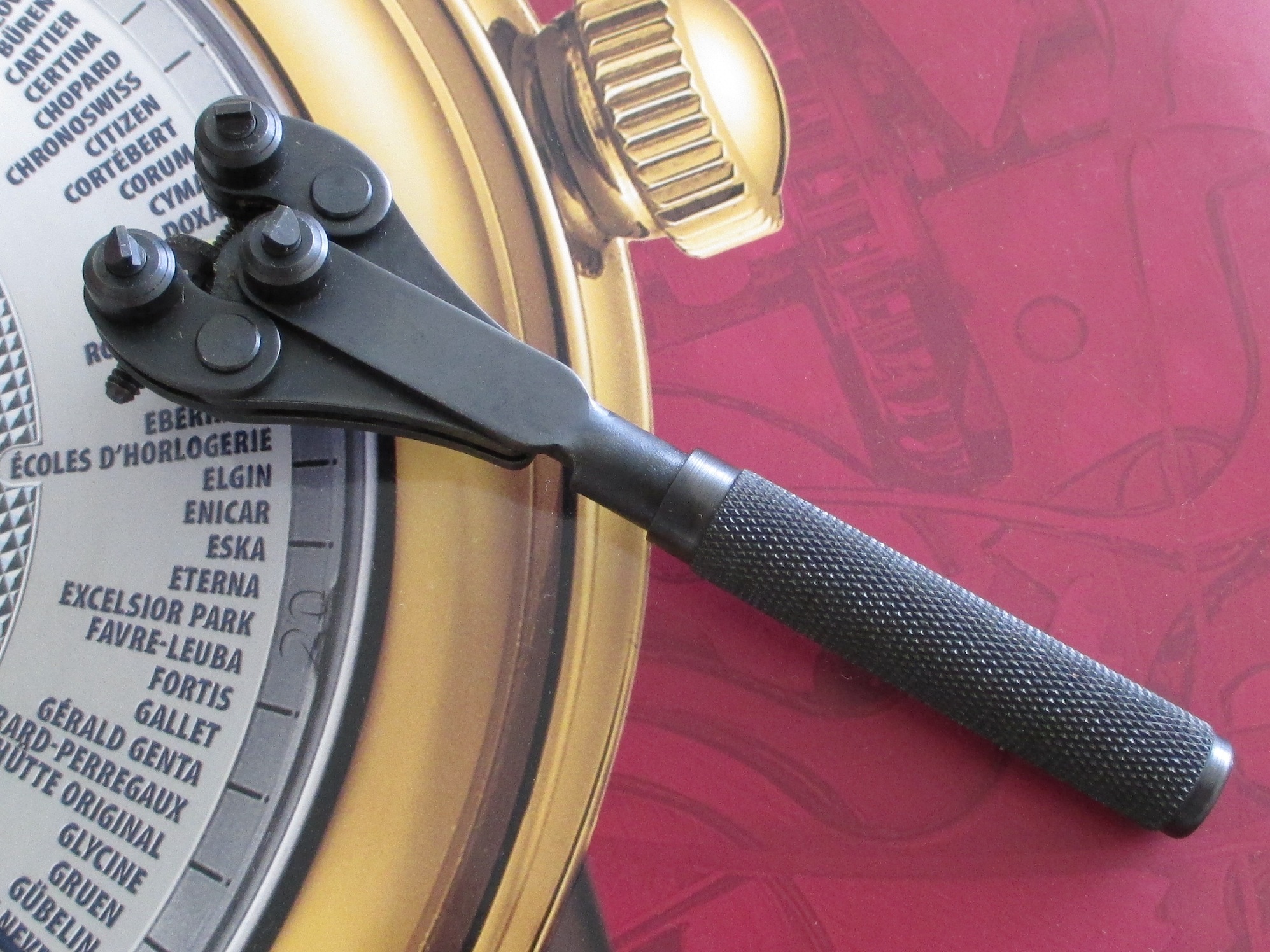

  4. X350 XJR Vintage Omega Aficionado Mar 19, 2014
    12,567
    29,785
    Really need something to grip the flat edges on the back.
    An adjustable three jaw case wrench like this LG or similar one by JAXA.

  6. woodwkr2 Mar 19, 2014
    1,366
    819
    See also: Where to buy watch tools
    Covering the caseback with low-adhesive painter's tape is a handy trick if you're using less than ideal tools and are worried that one slip may send metal bits skidding across your watch case.
    But the real answer is to expand your tool kit.
    FWIW, of the handheld wrenches, I like the LG ones (pictured above) better than the JAXA ones. Quality is good for a hand held, and can be found on the bay in vintage for ~$20-40. Make sure they come with three of each style bit.

  13. eustace Mar 26, 2014
    95
    39
    Well, I received my sticky ball in the mail today. I was a little skeptical but I gave it a try...
    Happy to report the caseback came off after the second try with just a little effort.
    Thanks all for the helpful tip.
