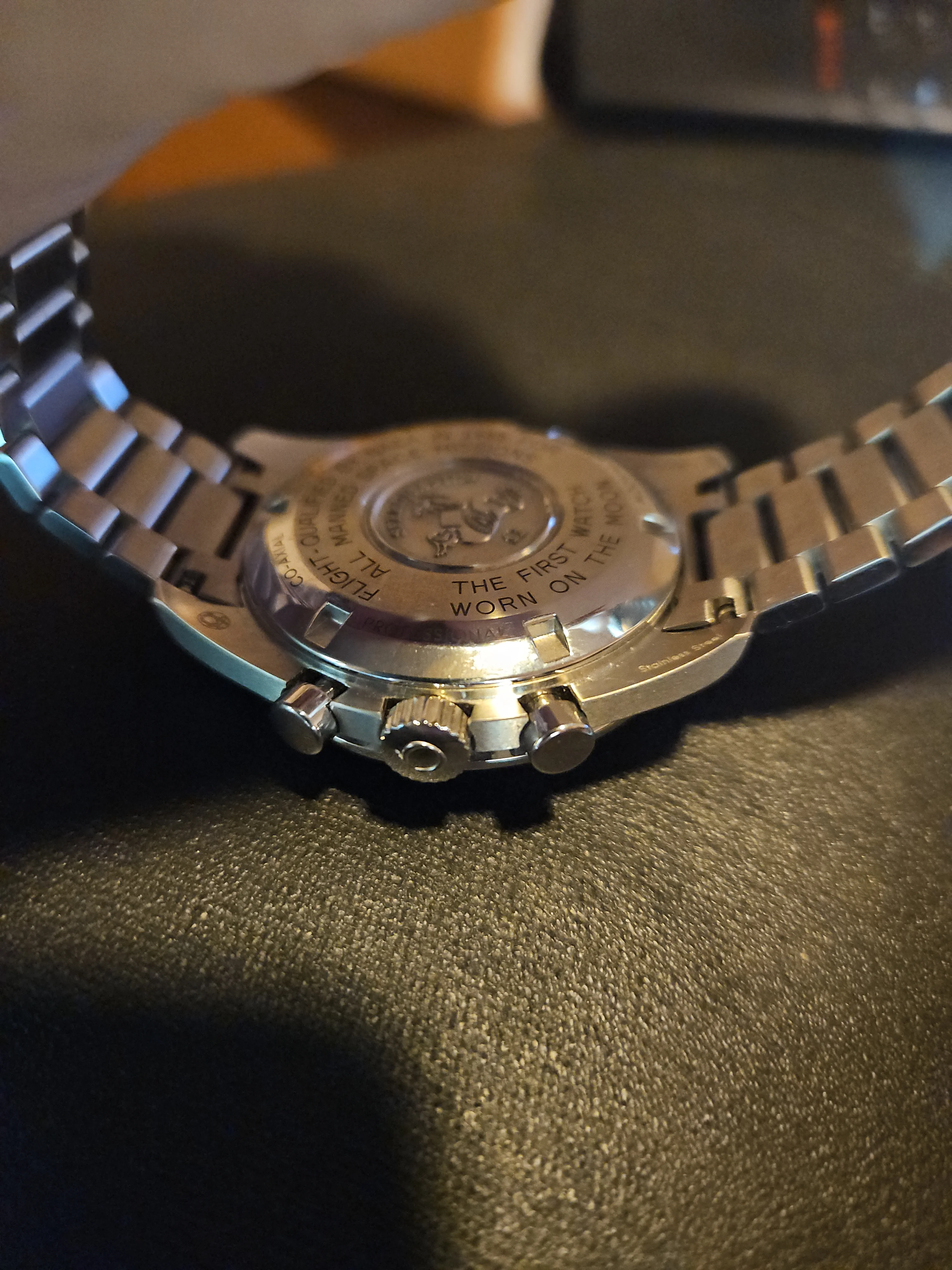

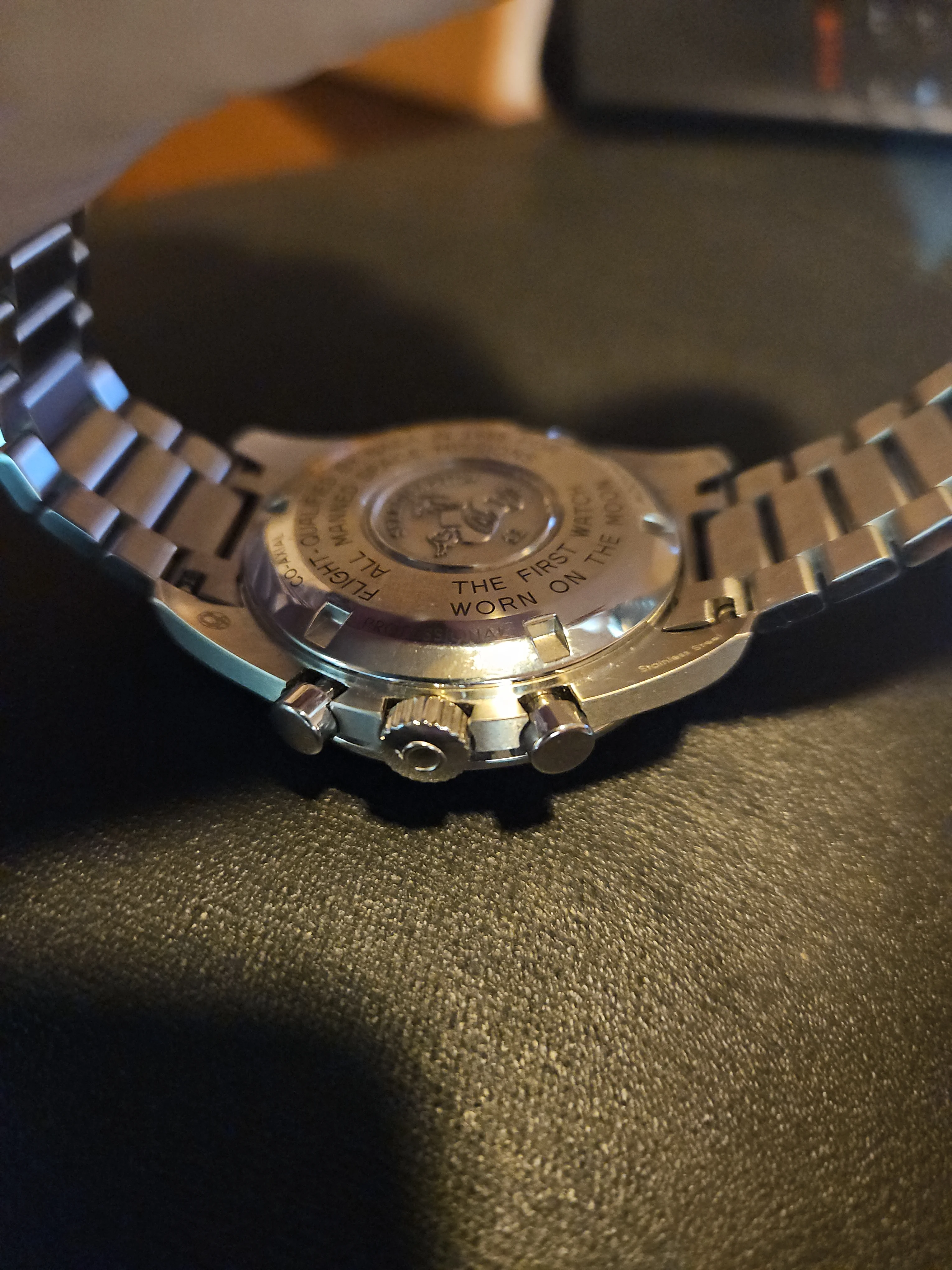

Don't know what to say, it fit with no modifications. I used the spring bars from the factory bracelet, though, if that makes a difference. Figured I'd keep the new springbars as new and unused.
5,980
28,597
The springbars should be the same. How does it look from the the bottom, no tilt?
1,479
3,000
Tight. Zero movement.
