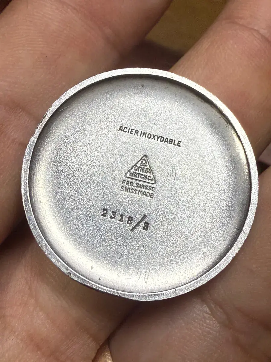

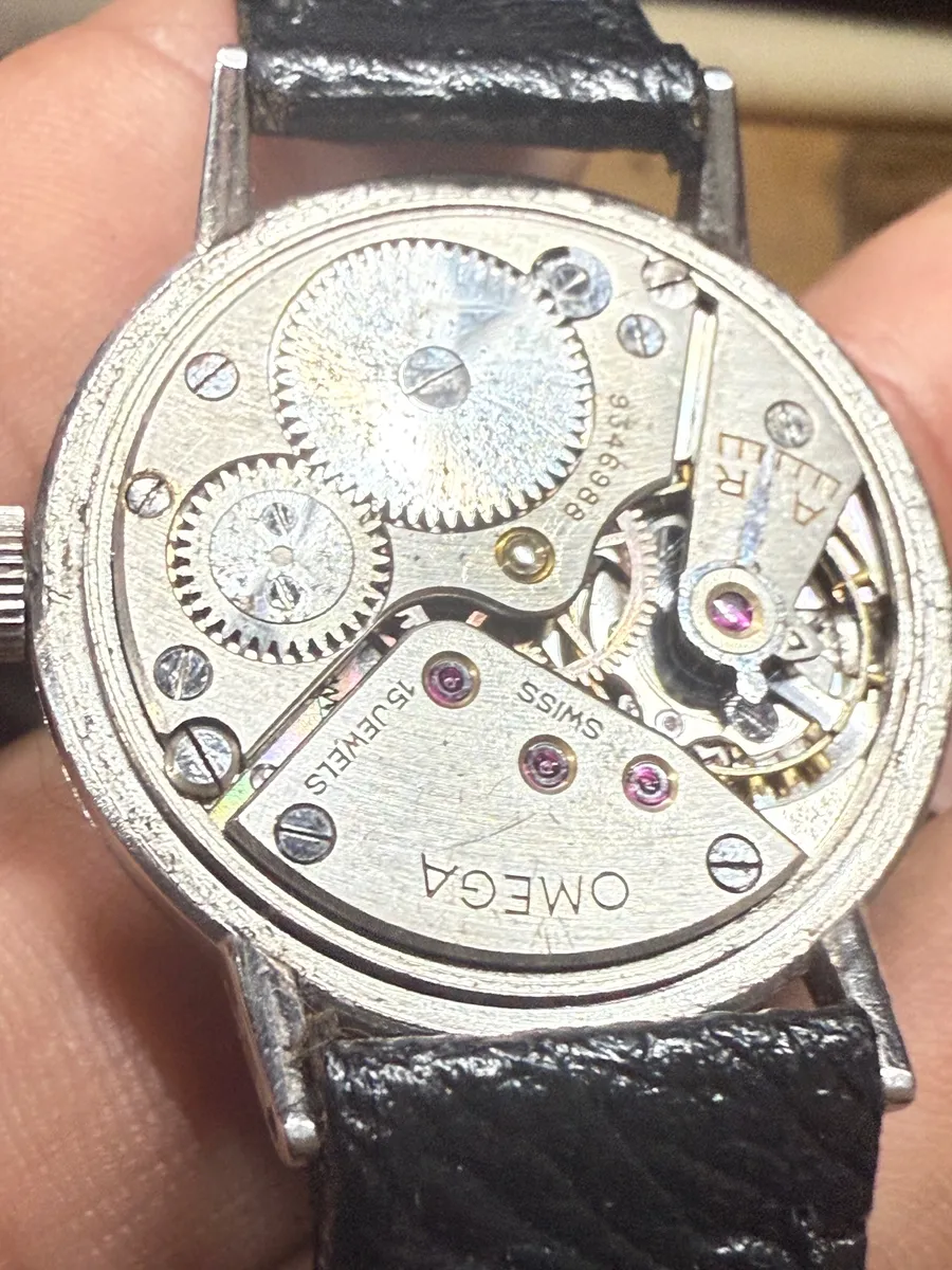

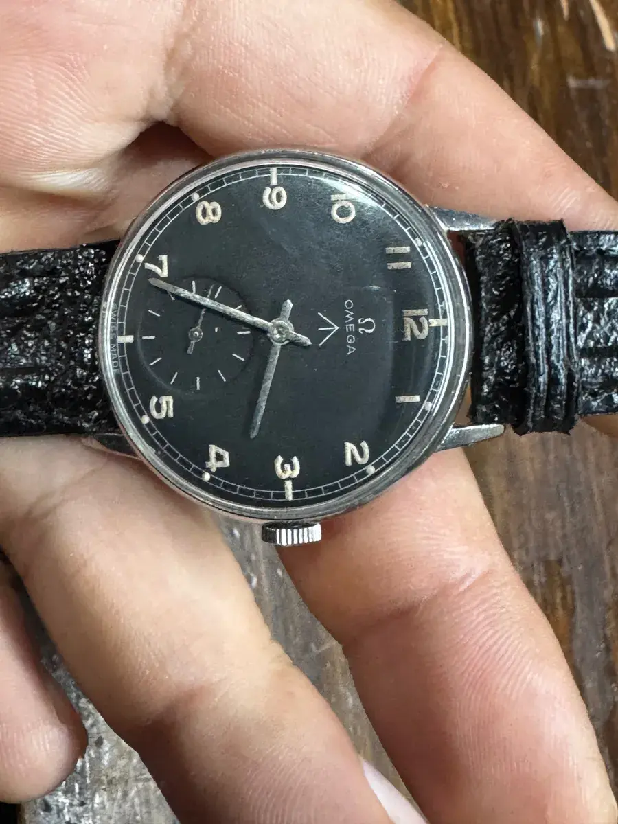

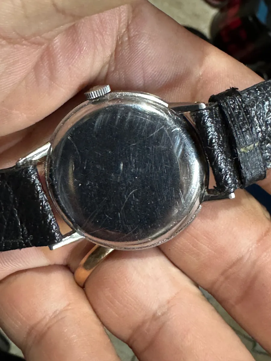

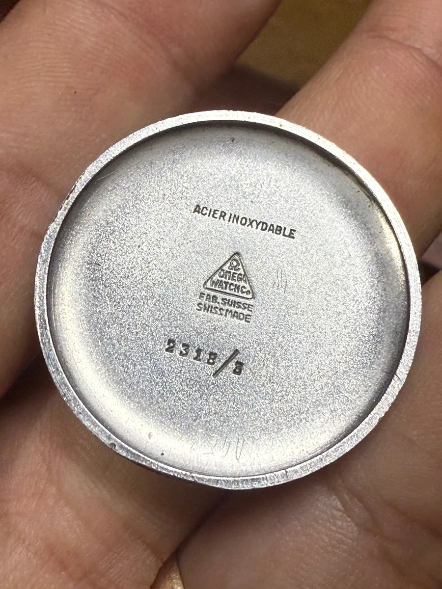

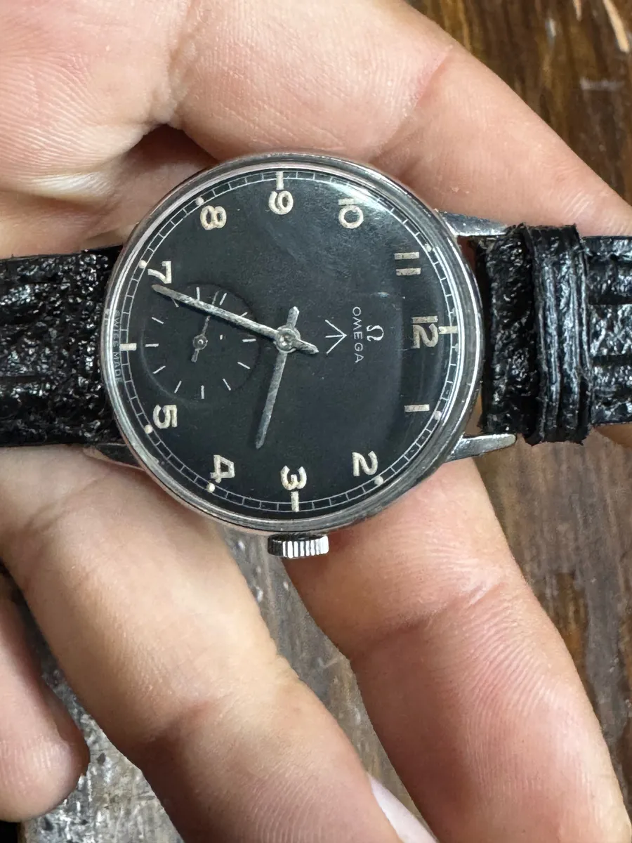

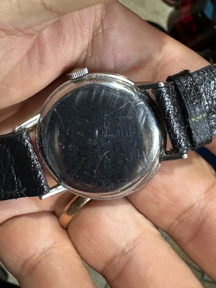

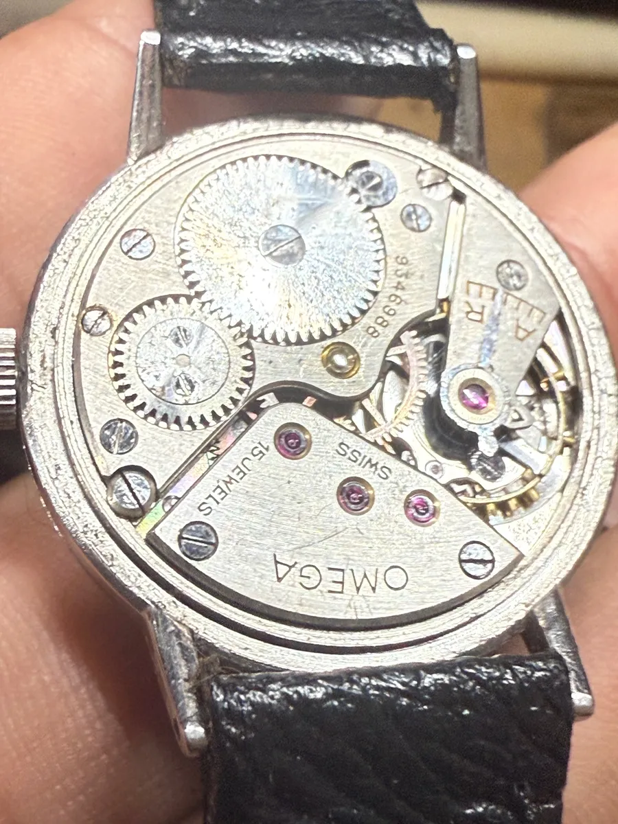

I'm new to this Forum and the world of Omega watches. I have recently bought my first Omega (Seamaster Calendar around 1960s). But my question today is about watch I could buy (or not) according to the advice of people who know much more than me.
Is an Omega 2318/8 that looks as a Dirty 12 but not completely. Those watches are mostly around SN 10.XXX.XXX and this one is 9.XXX.XXX. There are no markings on the rear cap. The arrow head on the dial is present.
Is there any chance it is legitime? If military, can it be destined to a different army other than GB?
Many thanks in advance,
Alejandro.
4
The dial has been repainted as a military dial, Hands are wrong, too.
Thanks Hoipolloi
Hands should be spade type if I am not wrong. Regarding to the dial, my eyes are not so trained as yours, so your help is more than appreciated.
Cheers.
