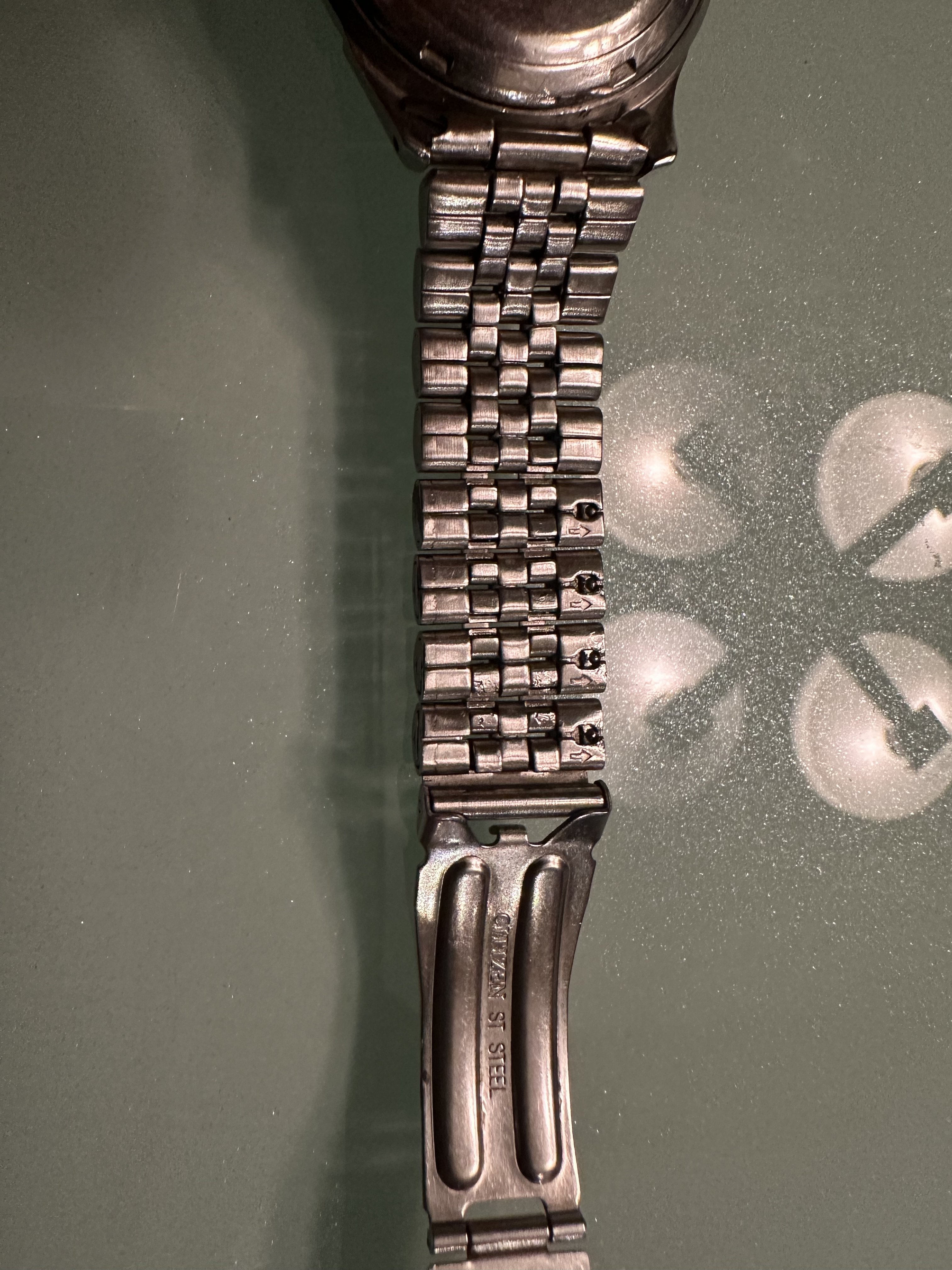

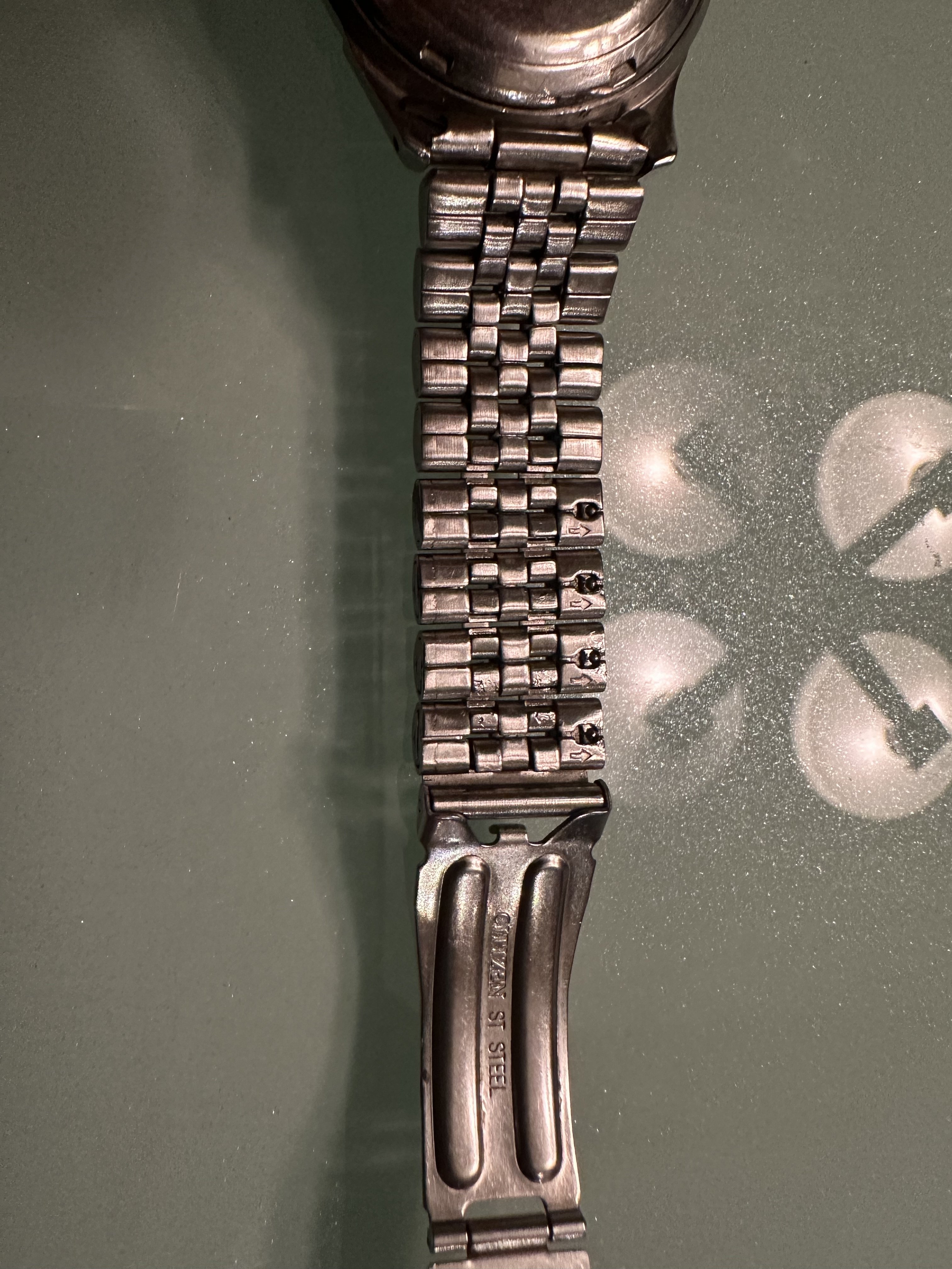

Hi, we have a Citizen Jubilee bracelet that we are trying to shrink. There are three removable links available, but how to get them off? I have attached a pic, and can see the arrows. That usually means this way to remove, right? But there is a bump in the slot, so should we open that end of the link to get the sliding part out?
and for the regular links, I presume that to remove them we pry open the two small links and then re fold them. Correct?
thanks for any help!
3,325
24,545
You just insert the straight end of a spring bar tool into the gap and push the bump in the slot, the pin should slide right out. Sometimes they take a bit of force if they’re tight.
4,521
11,137
I use a small screwdriver (the junkier the better) and tap with a small hammer.
