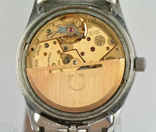

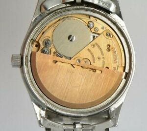

Does this Seamaster look original? Kind of looks like the G and A of the omega engraved on the movement are too close together. Or do you think the picture just makes it look like that? What do you guys think?

It’s likely fine, the finishing on the 1xxx movements is normally very shoddy. I am not a fan.

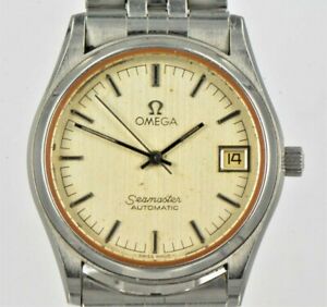

The photos aren’t very good of the dial, so it’s hard to tell - but @padders is likely right. With this piece, it will need a good clean (especially around the end links of the bracelet) and you’ll need to factor in the cost of service if you don’t have proof of it being done recently. Price will be a factor with this one, too. What’s the asking price?

So it is - thanks! The other thread had better photos and, as I said there, the dial is not the best. For $225 it’s a good piece if it’s going to be a daily wearer after service.
