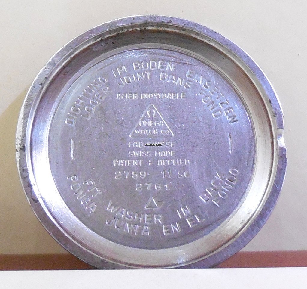

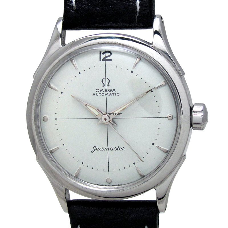

    Hello, I've decided to buy a vintage Omega, it's my first time buying and I'm a little overwhelmed/nervous about the number of scary fake watch stories I've read online. I read a magazine article that suggested using Chrono24 because it is more reputable than other online watch marketplaces. These are the two watches I found in my price range that I like looks of the best but was hoping someone here could give me an informed opinion about the authenticity and price. And help or advice would be greatly appreciated.
    First: $450
    Second $563
    http://www.chrono24.com/en/omega/vi...ails&urlSubpath=/omega/index.htm&watchTypes=U

    Hi and welcome. Both pieces as stated in the listings have repainted dials and are of no appeal to collectors.
    I would suggest to follow the items for sale on this forum if a genuine piece is what you are after.

    I'm afraid that both of these examples are truly horrible and a very good example of what to avoid, even though they are both genuine Omegas and not fakes. Besides the refinished dials you have corroded cases and rough looking movements. Sadly, Chrono24 is not a reliable or safe source for the beginning collector, there is just as much over-priced junk on there as anywhere else. You are very welcome here, and you would be well advised to hang around, read the threads, ask some questions, and keep your money safe until the right watch shows up ;)

    ;) I'm guessing the top left lug has had a new hole drilled on the first one, based on that photo. Trpt, please promise not to buy anything without support until you are a little more comfortable with spotting issues.
