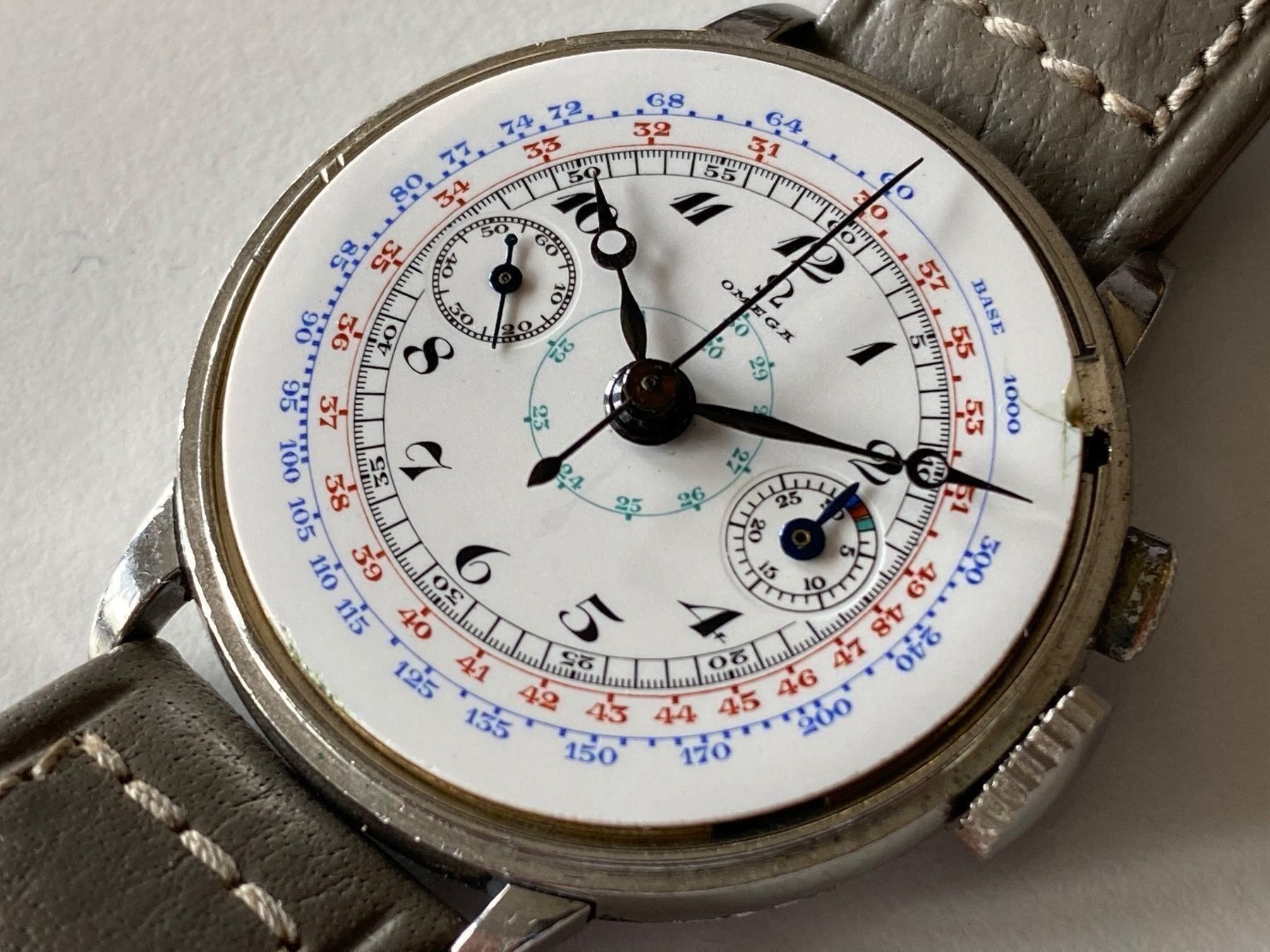

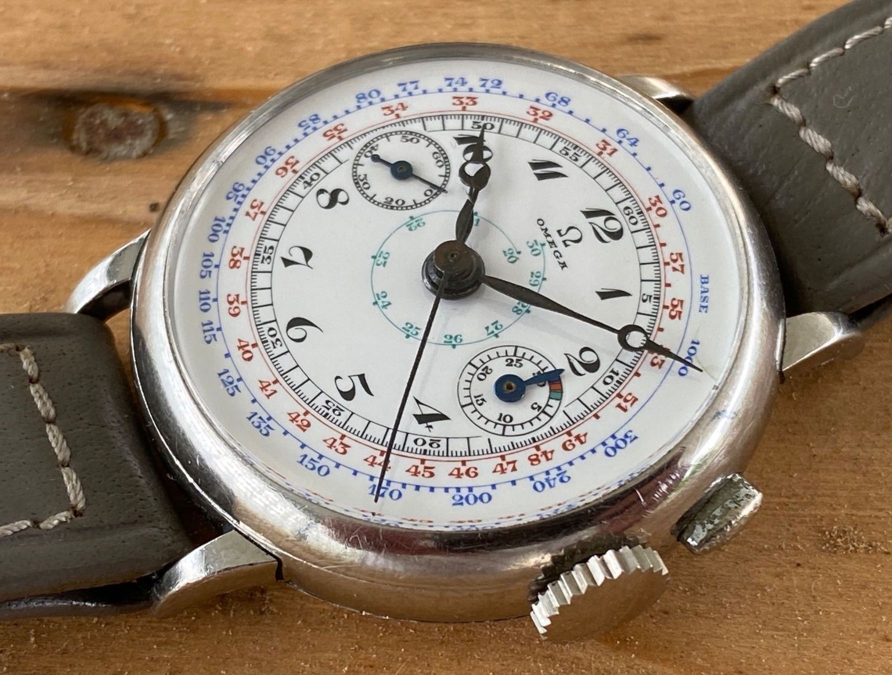

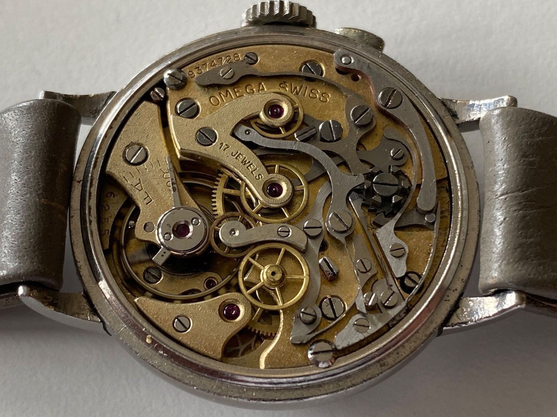

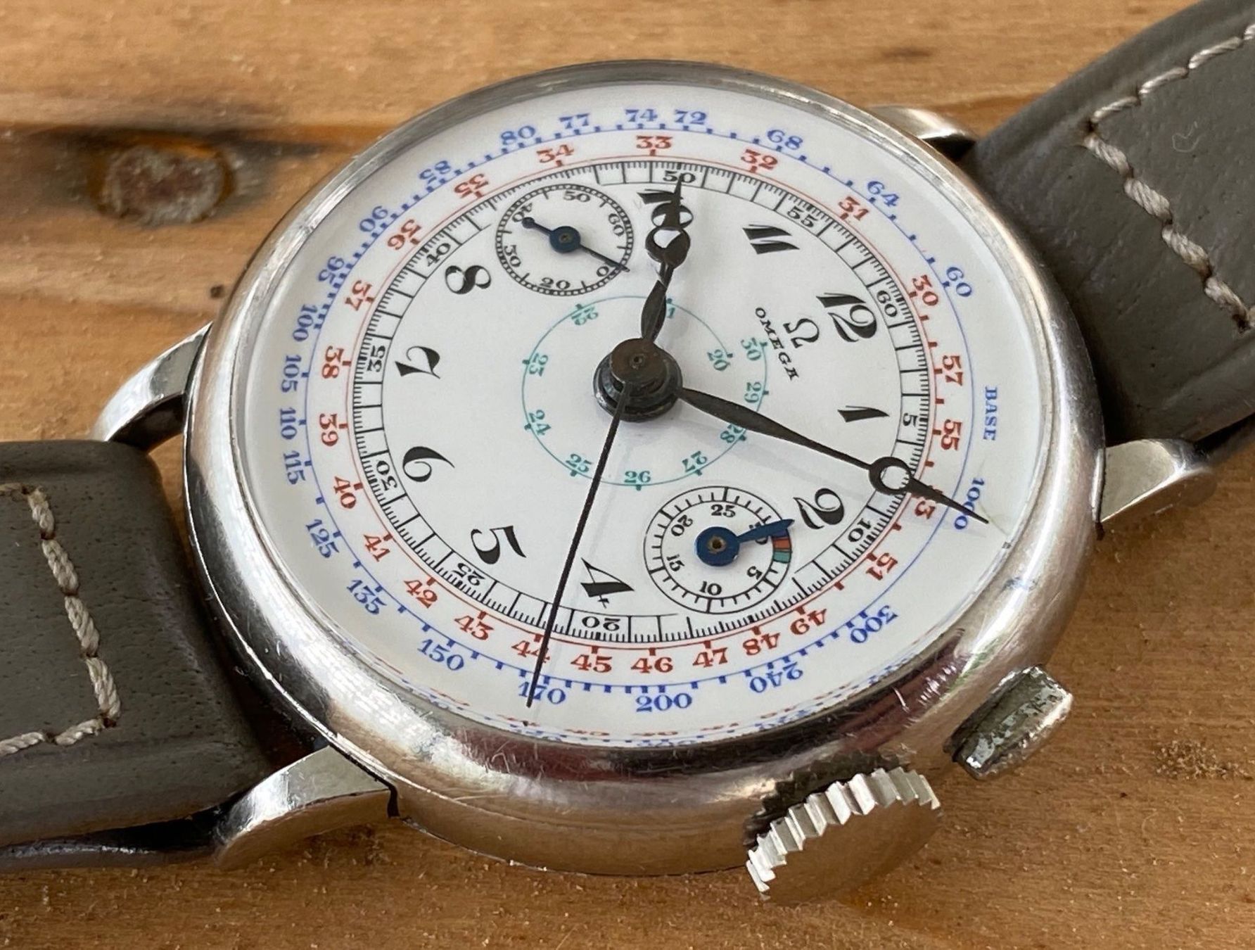

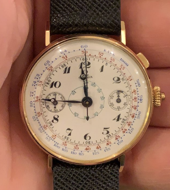

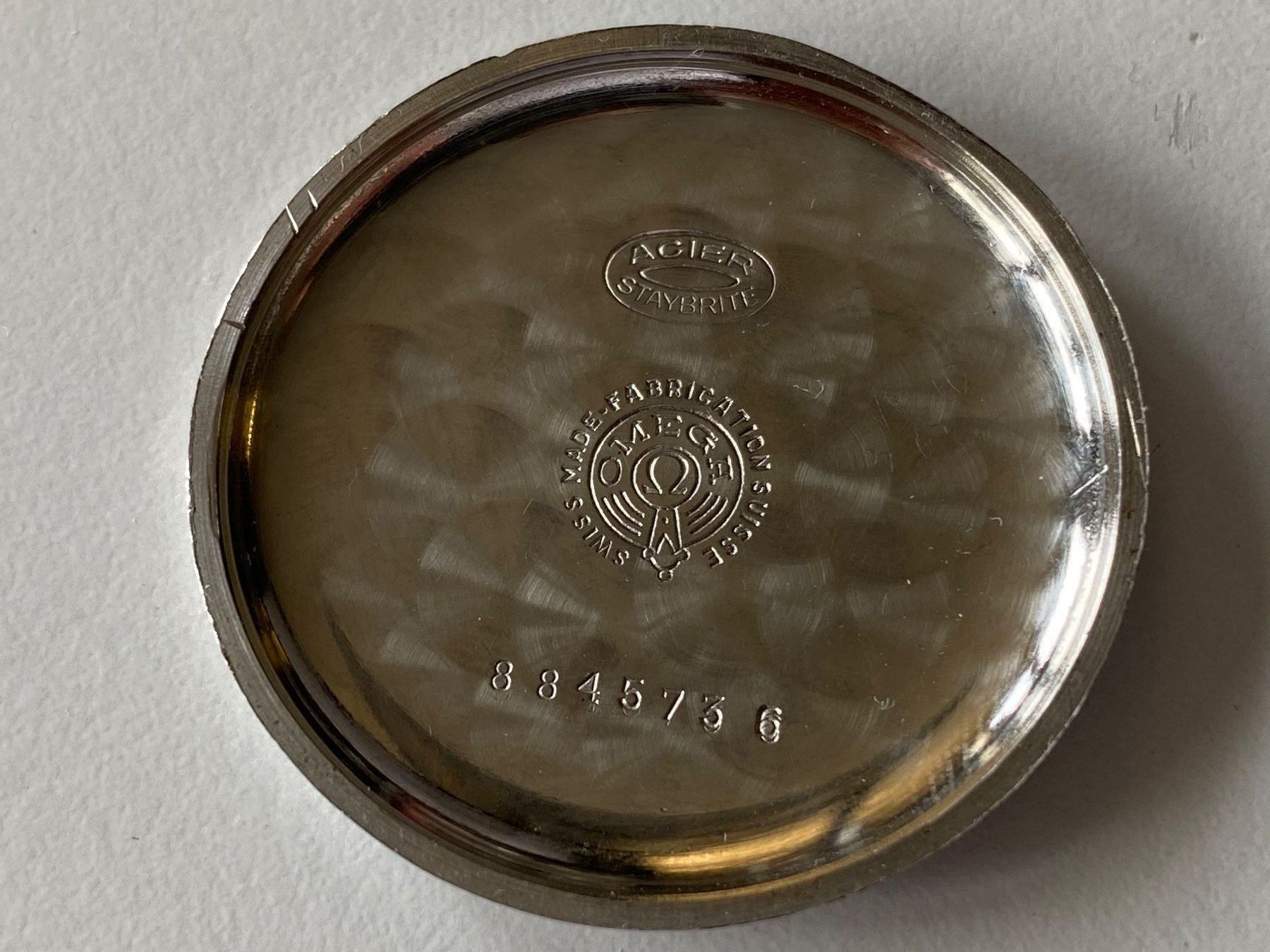

Hi i have an rare 1935 OMEGA 28.9 CHRO mens vintage chronograph watch!
Been told is unpolished with a stainless steel case of 33.5mm diameter and with snap back. 39mm from lug to lug.
Watch reference CK 710.
Manual-winding chronograph movement OMEGA calibre 28.9.
Amazing white enamel dial with mulicolor scales and arabic numerals.
What do you think about it?
Thank you in advance for your help
Greetings

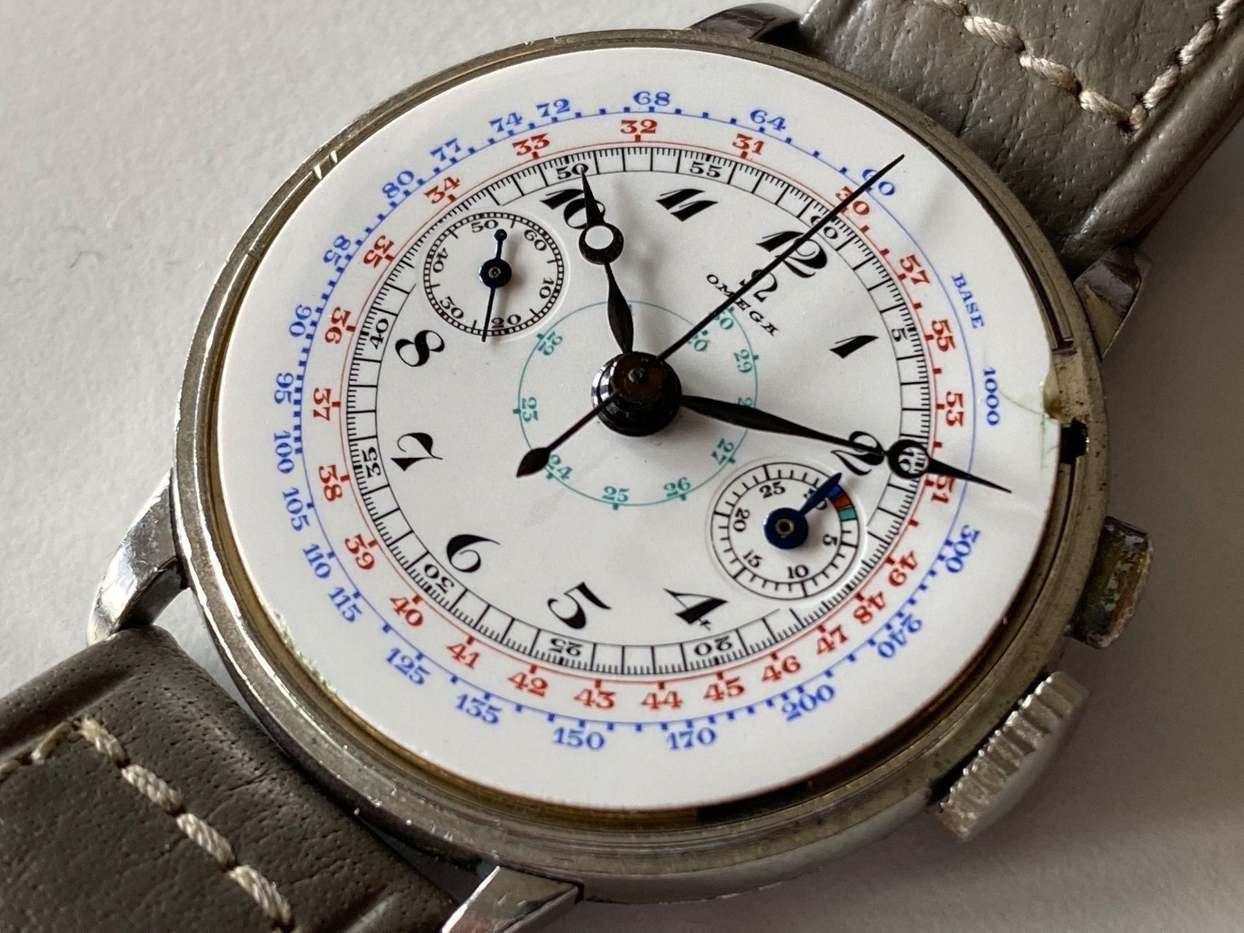

I think it's very nice.
馃グ
Pity about the chip on the dial at 1000 marker, maybe somebody in the past tried to lever the movement out of the case.
But as you can hardly see it when the crystal/bezel are on it doesn't matter that much.
And yes, I think it is all original, and I think it needs a service.

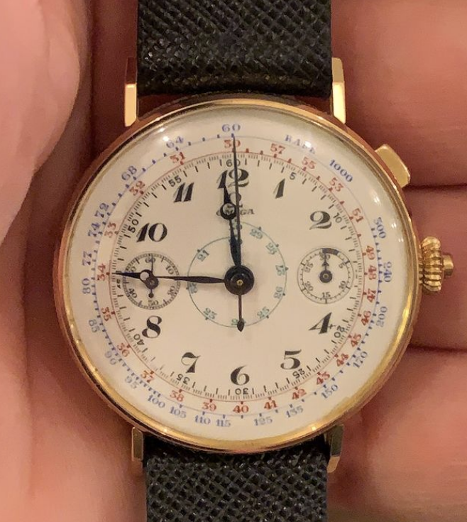

Here is the reference in AJTT.

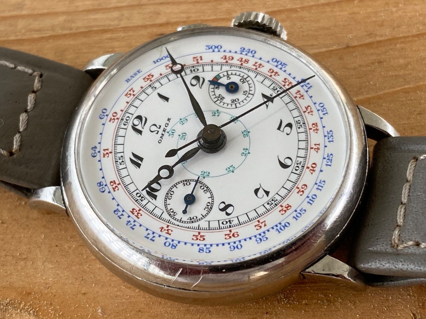

I had one of these many years ago, sorry that I ever sold it. It's worth getting if the price is right, including a badly needed overhaul.

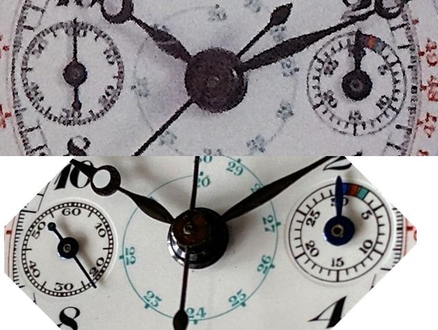

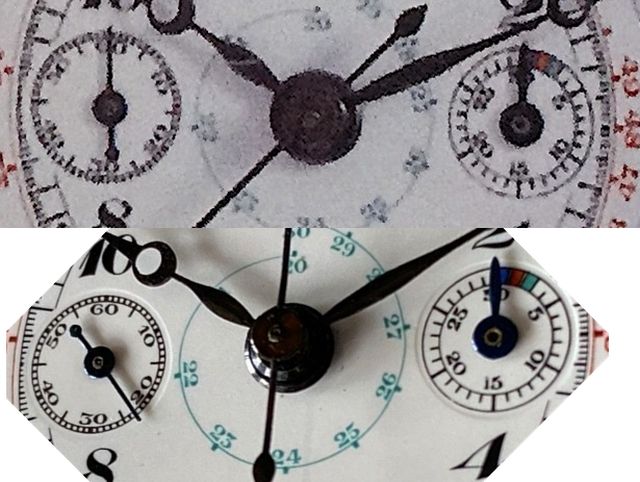

I don't think its all original.... the seconds register and chronograph counter hands are not original.
Both look too long.
963
1,252
Both look too long.
Are the hands in @JimInOz 's post, those pictured in AJTT, also not original?
Both look too long.
Not so sure
