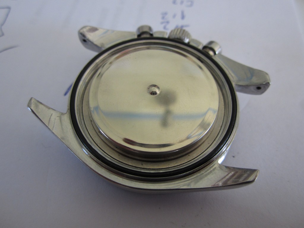

    A stupid question but have to ask . Is it the right dust cap? Let us see some pictures? I borrowed this picture from from Watch guy .

    No it is in perfect condition.
  7. sulaco Jul 31, 2015
    597
    405
    It is the same one as pictured.

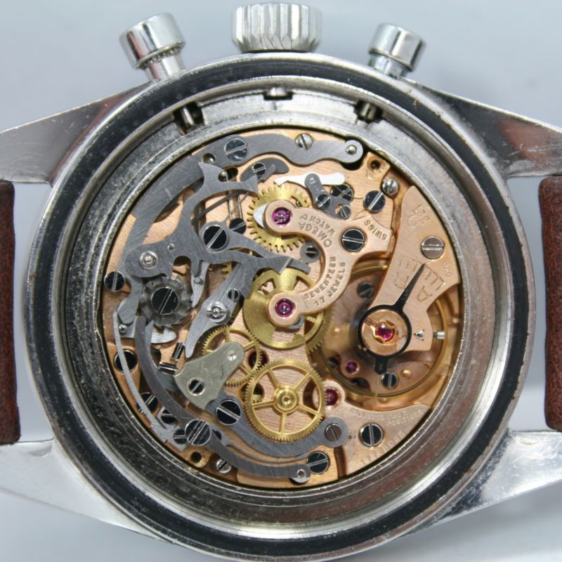

    The operating lever is a long solid piece that runs along the edge of the case on the side where t pushers are, right on the top. You can see it here in t image below across the top of the pic, kind of grey coloured. It should be nice and flat against the movement. If it is raised up, then the start pusher can't engage properly.
    ...but I'm still pretty new here and definitely not a watchmaker by any stretch.
    gemini4 likes this.

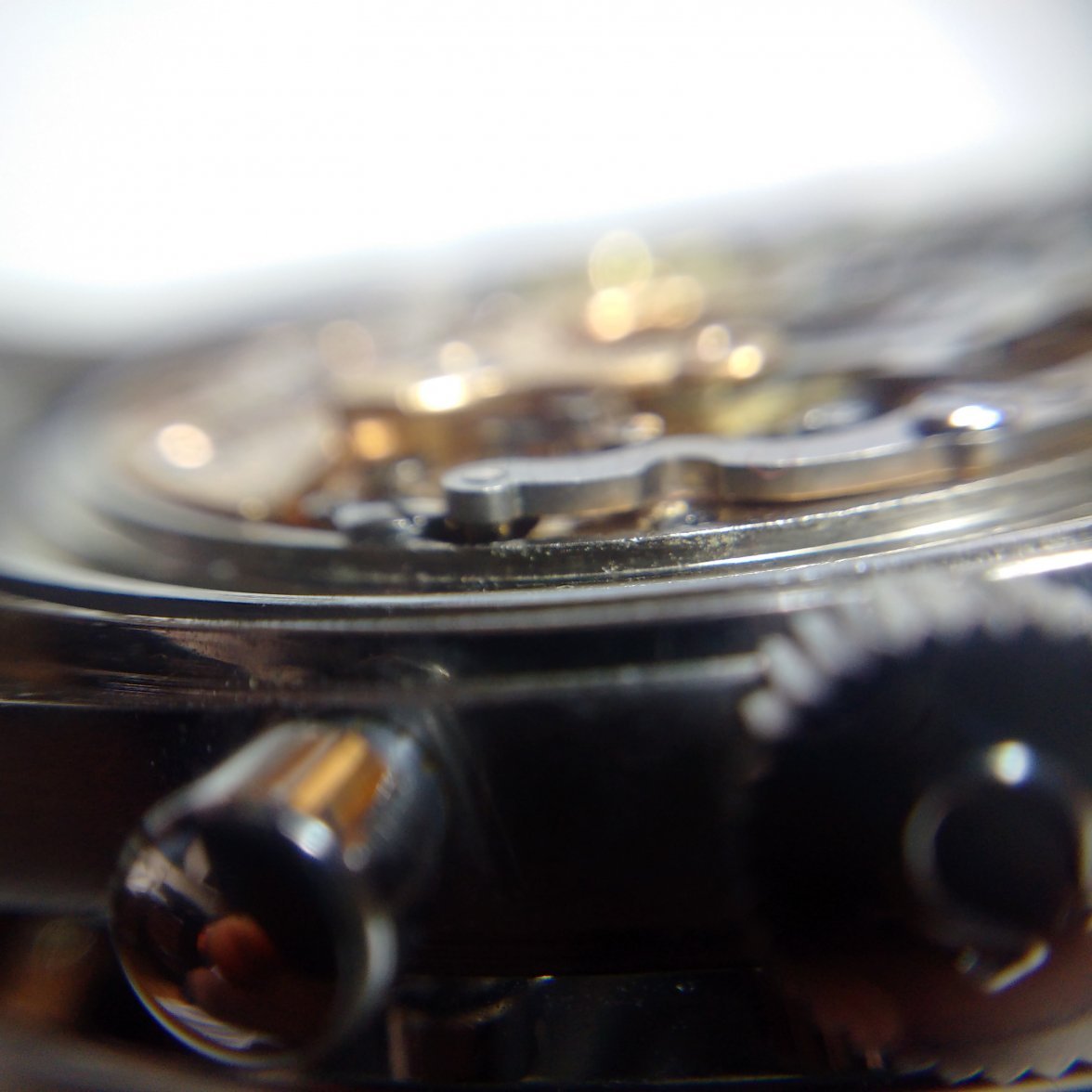

  10. oddboy Zero to Grail+2998 In Six Months Jul 31, 2015
    9,217
    23,880
    Here's a better pic of the problem I had.
    That lever shouldn't be raised up like that..
    Giff2577 and gemini4 like this.
