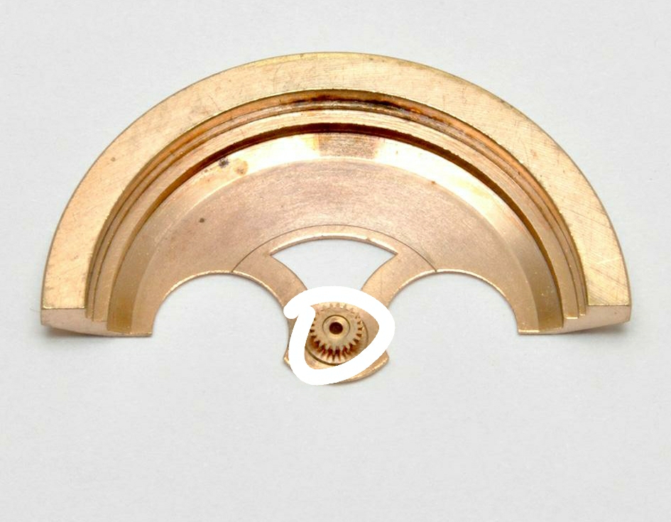

How easy would it be to remove the middle piece of the oscillating weight/rotor and could I do it myself? The one I have the teeth part is broken so I need change it. Many thanks.

The bigger challenge will be to make the new rotor bearing gear fit the rotor post, IF you succeed in removing the broken one, and successfully get the new one in. Let us know how to do with this.

If you need to ask the question, you should probably leave it to a trained watchmaker with the proper tools.

As was said by the others, not rocket science, but watch repair being a proper full time job, you may leave this task to a pro...
Doing it yourself would imply buying tools to press out and in the bushing and adjust it to the rotor post, not very economical imho compared to giving the part to your preferred watchmaker and asking for a service.

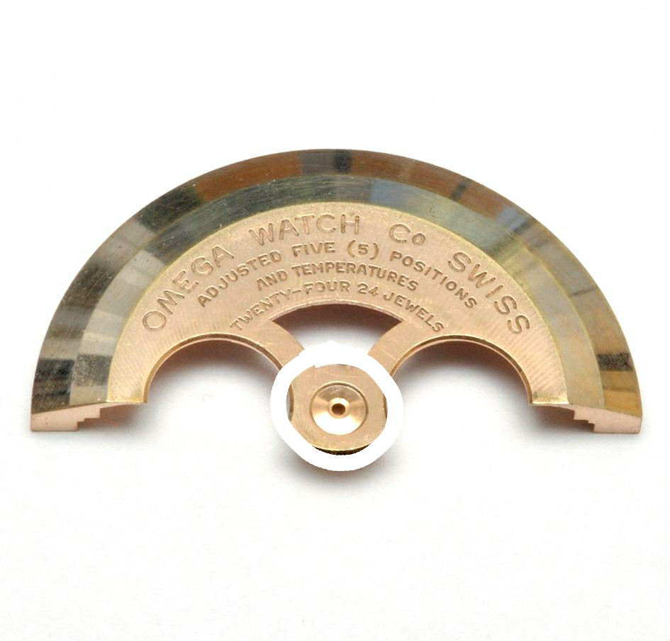

Buying a new winder assembly or a new rotor seems like the easiest option

Easier said than done with these cal. 505 chronometer rotors. They simply do not exist as replacement parts.
However, I have never seen nor heard of someone replacing the center gear on one. A specialist watchmaker might be able to do it, but will not be cheap.

It’s routine work...as shown in the linked thread. The 500 series pinions are discontinued, but you can find them on the open market.
The 550 series are all available from Omega still.

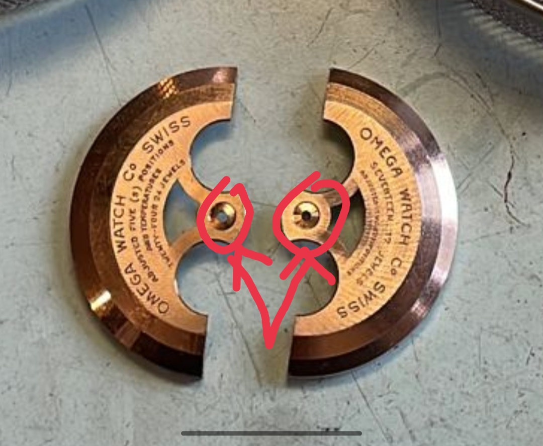

Below is an image of two oscillating weights/rotors. The one on the right is stamped 17 Jewels and the one on the left is stamped 24 Jewels and is for a calibre 504 or 505 but is missing the bearing gear. My plan was to swap the bearing gear from the 17 jewel donor rotor (image on right) into the 24 jewel rotor (image on left) but unfortunately the diameter of the rotor bush or bushing (circled in red) is not the same size. Would anyone know what would be a correct donor rotor with the same size bushing as the 24 jewel rotor that I could use? Many thanks.

Many thanks. I'm trying to repair a Constellation Calibre 505, Case ref 2852. The rotor bearing broke so I thought I'd use the donor rotor bearing from another rotor (the one stamped 17 Jewels, but the bushing is not the same size. Any advice would be greatly appreciated.

Many thanks. I believe the rotor shown on the right (17 JEWELS ADJUSTED) is from a calibre 500. The 17 jewel rotor fits perfectly on my 505 movement but for some reason the bushing is not the same size as the 505 24 Jewel rotor. Does that make any sense?
What part if it is not the same size?

Do you happen to know the part number for the pinion. Omega has always told us we can only purchase the rotor with the pinion attached as a single unit.

72205501429R | PINION FOR OSCILLATING WEIGHT FOR CS
