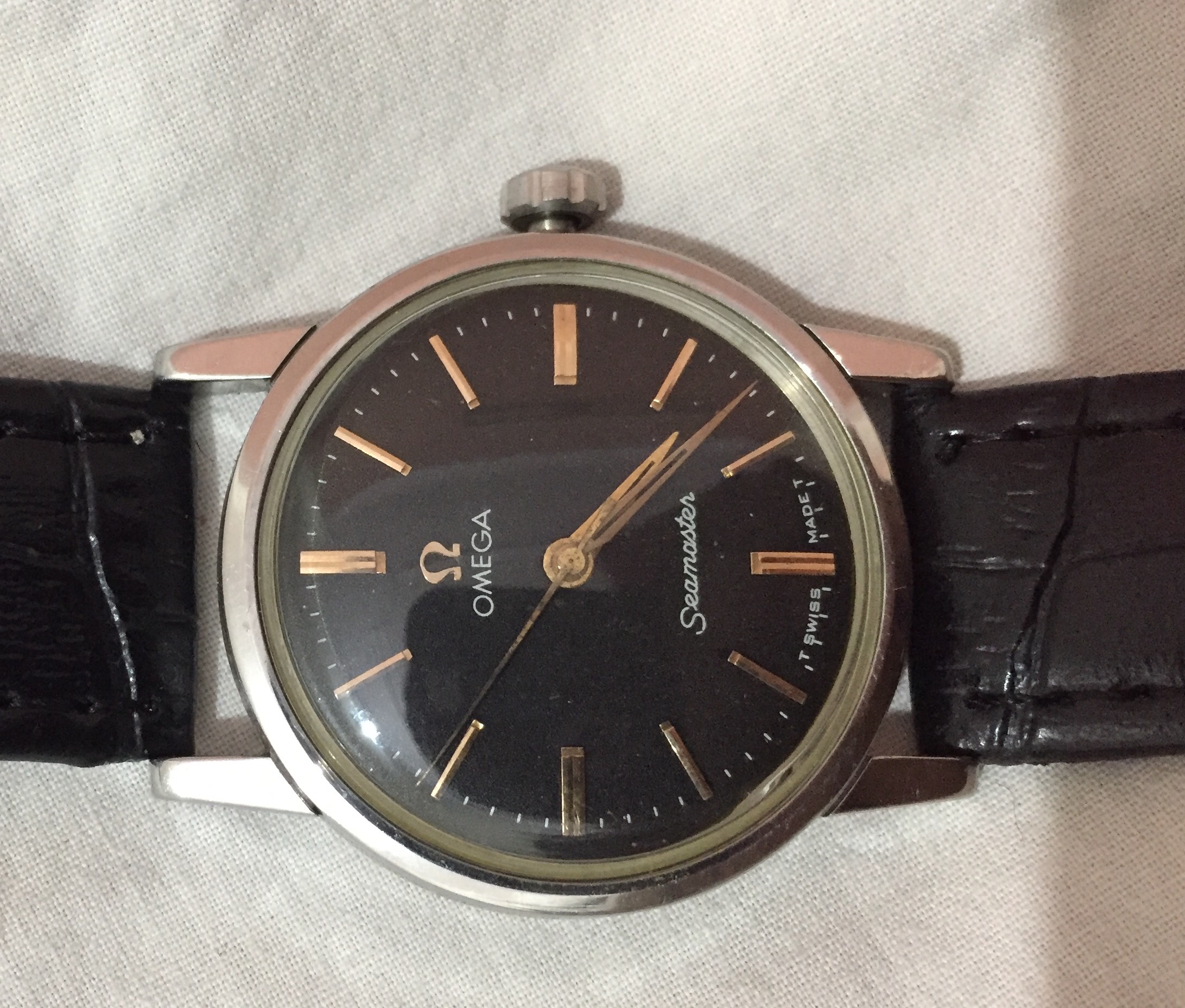

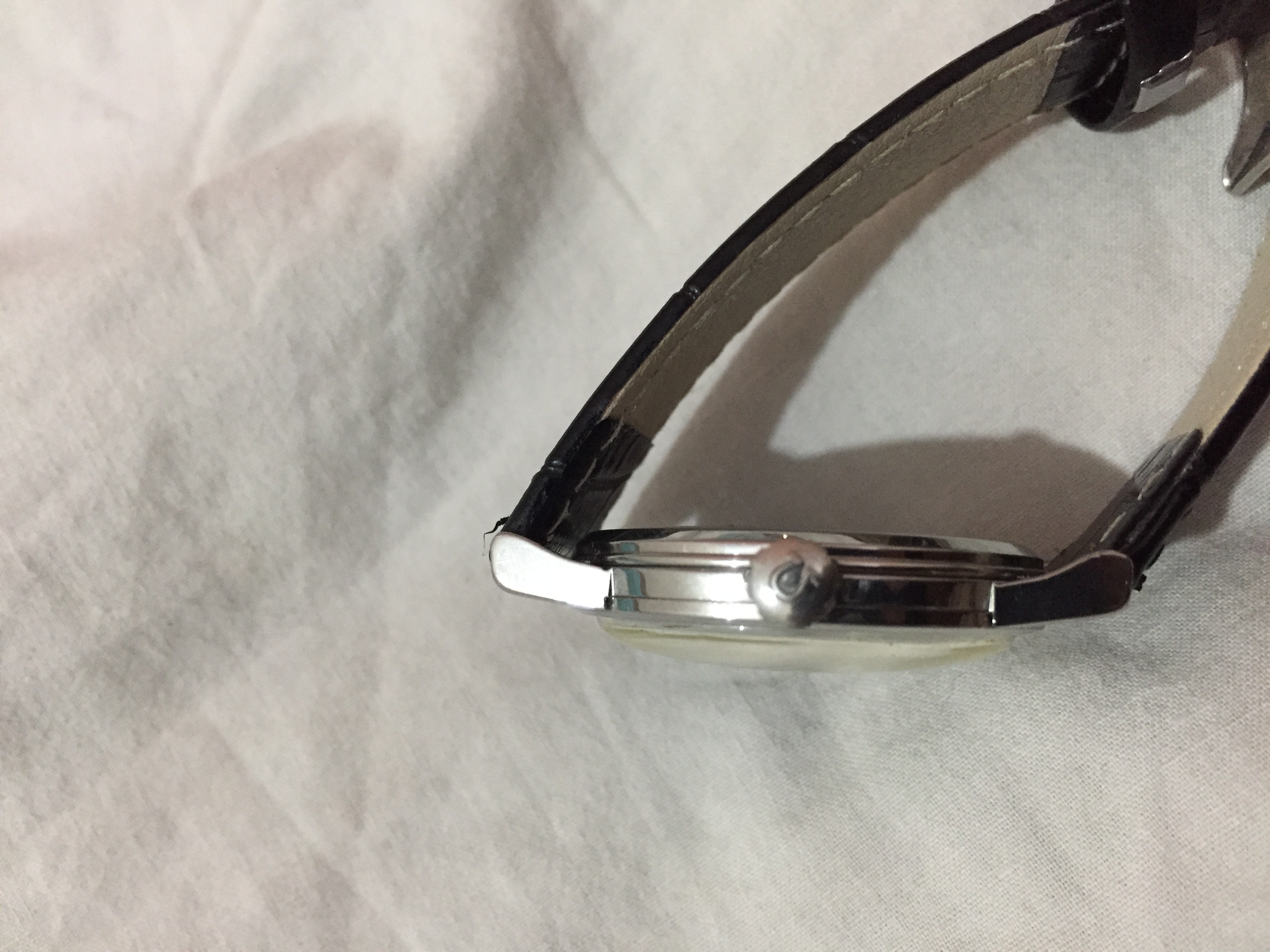

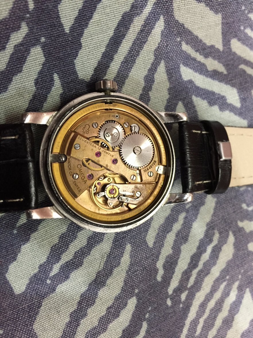

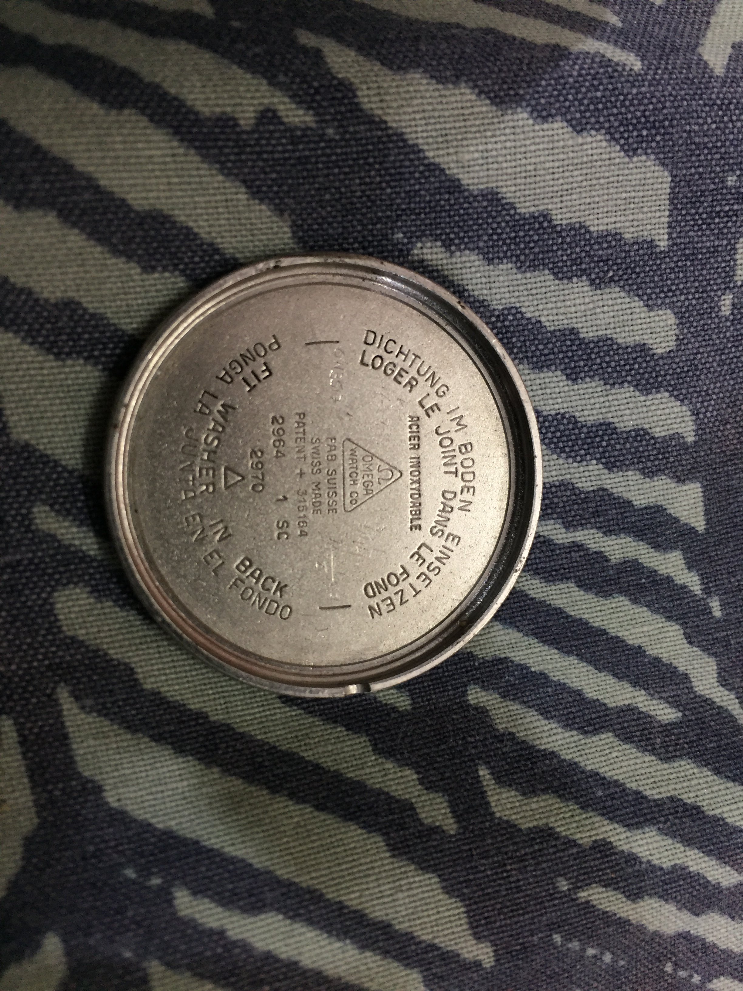

    Hello all,
    First of all, very grateful to the enthusiasts who devote their time to this forum and help novices like me.
    Here's a Seamaster I've been gifted by a friend. It's a mechanical and needs winding.
    Posting pictures. Very grateful if you could help me find whether this is an original, and, if yes, how old could this be?
    The back is very faded but I do notice some sort of a faded insignia and the words Seamaster. Didn't post pics because my camera couldn't capture it. IMG_8406.JPG IMG_8409.JPG IMG_8418.JPG IMG_8419.JPG

    Your watch dates to around 1960 and is a genuine Omega.
    Unfortunately it has been badly re-dialed and the regulator is broken.
    There are probably other issues but they are the ones that stand out.

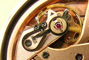

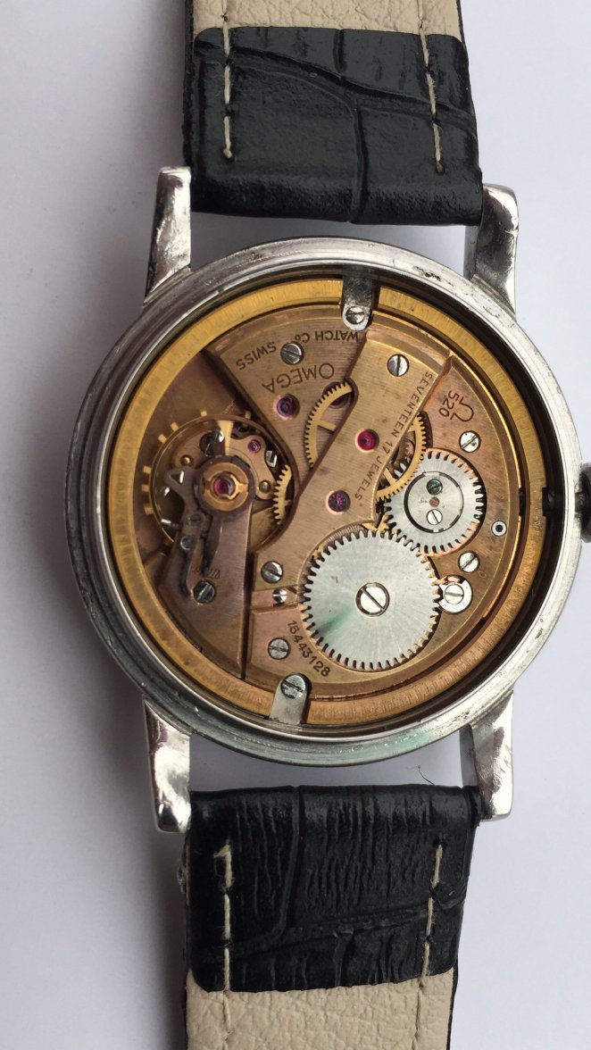

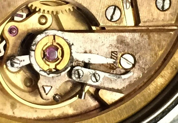

    To answer truthfully, the watch is in very poor condition, the movement has suffered water ingress and subsequent corrosion which is probably why it has been over cleaned, thereby removing the original finish from the movement. The screw heads show a lack of respect for the watch and a lack of skill by the "watchmaker".
    The regulator adjusting spring is broken, compare the two pictures below.
    Screen Shot 2016-10-05 at 11.38.57 AM.png Screen Shot 2016-10-05 at 11.44.07 AM.png
    The original dial was probably very badly marked or corroded so it was re-painted to look new but the painter used the wrong fonts and markings.
    As to functioning fine, only a check on a watch timing machine will tell if it's "running fine".

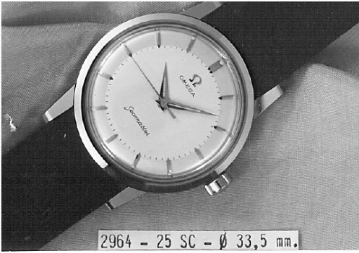

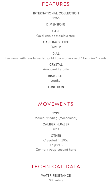

    This is what that watch should look like (not exactly but very close).
  9. Learning2fly Oct 5, 2016
    7
    3
    Ah! In that case, this turns to be a franken watch. How much do you actually think this is worth? I agree it's not polite to question a gift but no one should be duped.
