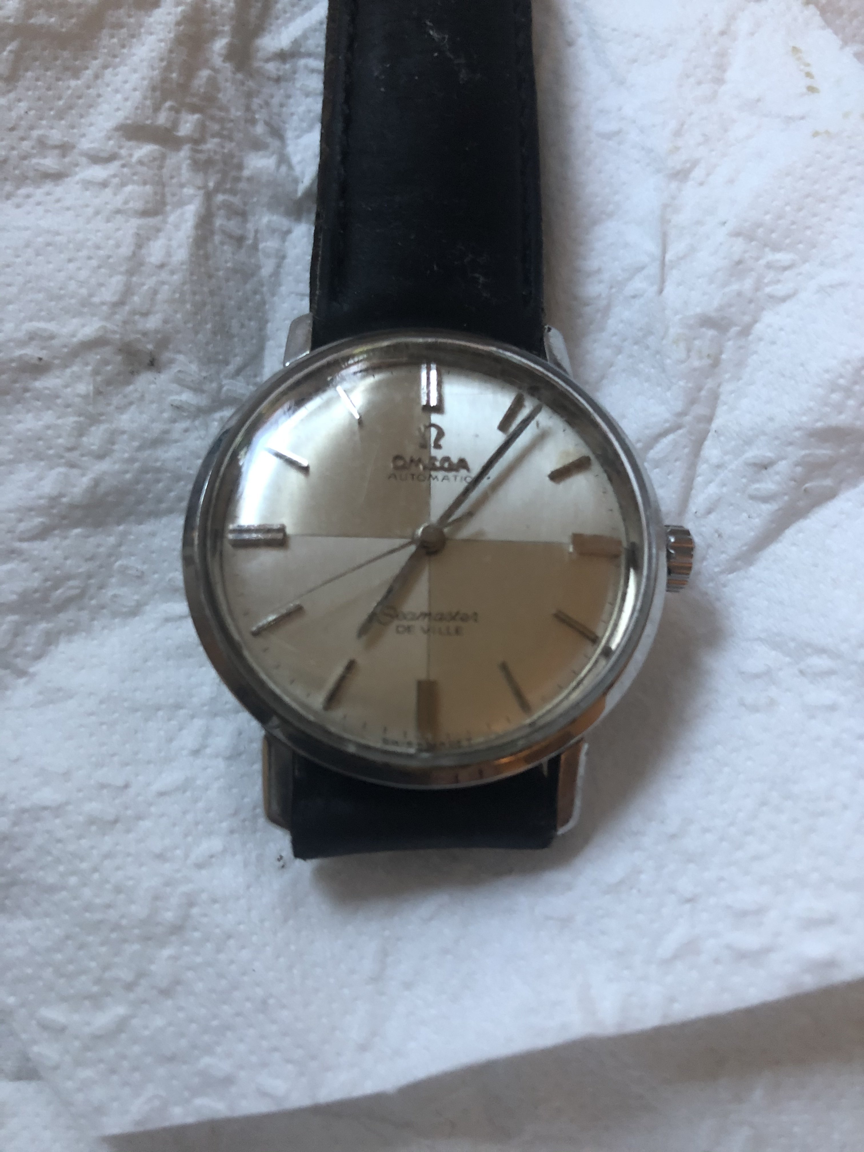

Hi, needing some advice on this one please. My Auntie gave me her vintage Omega Seamaster deville which I’m guessing is from the 60’s/70’s when she lived in Geneva. It has a crosshair face but on researching I haven’t seen one quite like this, it’s in quarters of brushed and smooth finishing. In original condition and working well, the strap has been replaced over the years though. Any information would be greatly appreciated x

All the information that's not on the dial is inside the case on the caseback and on the movement. The caseback will give you the reference number and the serial number on the movement will give you a clue to when it was manufactured.
It looks like a nice watch, pretty dial. Probably needs a service to make it wearable for any length of time.

That's a good all-original watch with a scarce and desirable dial variant in apparently pretty decent condition. I think I detect a stain around 2 o'clock but it's still very acceptable and wearable. A regular jeweller will have trouble opening it as this is a one-piece case which opens from the front, so it needs to be seen by a proper watchmaker. Date somewhere around 1963-67. The movement will be the automatic 552 calibre.
It needs servicing if it's going to be worn, otherwise the old dried-up oils will grind and damage the mechanism. Do not sent it to Omega, find an independent watchmaker who will do an equally good job more cheaply and usually more sympathetically. If you are in the UK, such a service should cost around £150-200. You can pay more but there is no particular need for a "gold standard" service on a watch that's worth about £400 as it stands and shouldn't need much doing. It's important to keep the original crown and crystal where possible and not to get the case polished.
Women's watches used to be smaller but the former men's size has become the default women's size, so your auntie seems to have been somewhat ahead of the curve. The Seamaster De Ville was and still is an excellent, understated model with a movement as good as anything else out there at the time. Treasure it.

Thank you so much for all the information. Yes, I’m in Surrey UK so can find a good watchmaker to take it to. My auntie is 80 but she has always worn men’s watches because she doesn’t like dainty jewellery and as you say was definitely ahead of the times. I love this watch and will certainly treasure it, I’m going to replace the watch strap ( not original) as it smells of cigars ( another one of Aunties quirks ) would I be right in thinking it would have had a leather strap originally? Thanks again for all the helpful advice and info, much appreciated

Looks like a nice legit piece to me as well, and the dial is uncommon. A leather strap is probably your best bet, choose one that suits your taste. You could probably find a vintage bracelet to fit it (e.g. "beads of rice"), but sizing them for a woman's wrist can be a challenge. My wife also likes to wear vintage men's watches, and we have never had much luck with the bracelets.

It’s also possible that the strap has an original omega buckle. If you decide to change the strap, make sure that whoever changes it also puts your original buckle on the new strap or, at the very least, gives you the old strap and buckle to take away with you. Vintage signed buckles are collectible and, often, have a good value in themselves.

Welcome to the forum, if the strap is original it should be branded Omega on the back. If not, you could still keep it if you like it— or buy another one, there are so many options.
It doesn’t have to be Omega, only something you enjoy.

Unfortunately it’s not the original strap or buckle on the watch.
