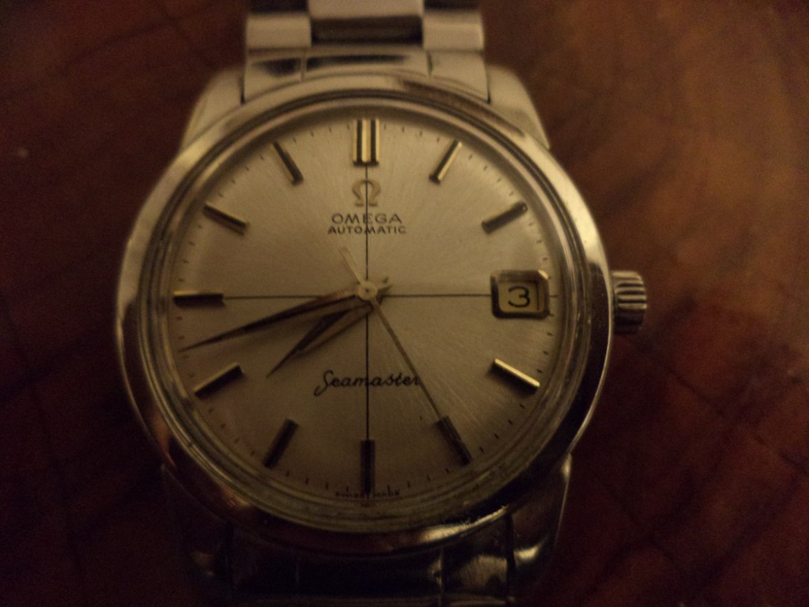

    Hello gents,
    can anybody please help me to figure out if the dial in this 166.009 Cross Hairs Seamaster is original or is it a nice redial?
    I know it's not the best photo, is the one provided in the online publication, but maybe it's good enough.
    I'm evaluating it to make my own, and the crosshairs itself look a little bold to me, what do you think?
    Thanks in advance.
    Miguel

  2. shaun hk Fairy nuffer Sep 20, 2015
    1,425
    1,516
    I say yes, the font of seamaster looks very thick as do the crosshairs though I will add the caveat that I have been wrong before!
  3. rogart ray it again, Ram. Sep 20, 2015
    1,007
    408
    Sure looks that way? The S in Seamaster doesn't look right .
  4. PatrickJ Sep 20, 2015
    1,567
    858
    Some have that hook and some are rounded in letter S
  5. hoipolloi Vintage Omega Connoisseur Sep 20, 2015
    3,516
    5,795
    Redialed.
    Crosshair is too thick. It should be thinner than the font.

  6. ulackfocus Sep 20, 2015
    25,983
    26,972
    Who can say for sure with that crappy picture? I've seen original dials mistaken for redials because of poorly lit and out of focus photographs.

  7. PatrickJ Sep 20, 2015
    1,567
    858
    Can you supply a more lit, better focused picture?
  8. Marlowe Sep 20, 2015
    30
    24
    The cross hairs need to be more delicate. On the evidence of the photo they are a later addition.

  12. Ecodelosandes Sep 20, 2015
    21
    21
    Hello Gents,
    Thank you for all the feedback, it reflects (and reinforces) most of my thoughts on this point. Sadly there is no much hope to get a better photo ro discard the effect of poor illumination and/or focus off the equation.
    I think i will decide the purchase keeping in mind the strong possibility that it is a redial or very probably the cross are added aftermarket.
    Thank you, very much.
