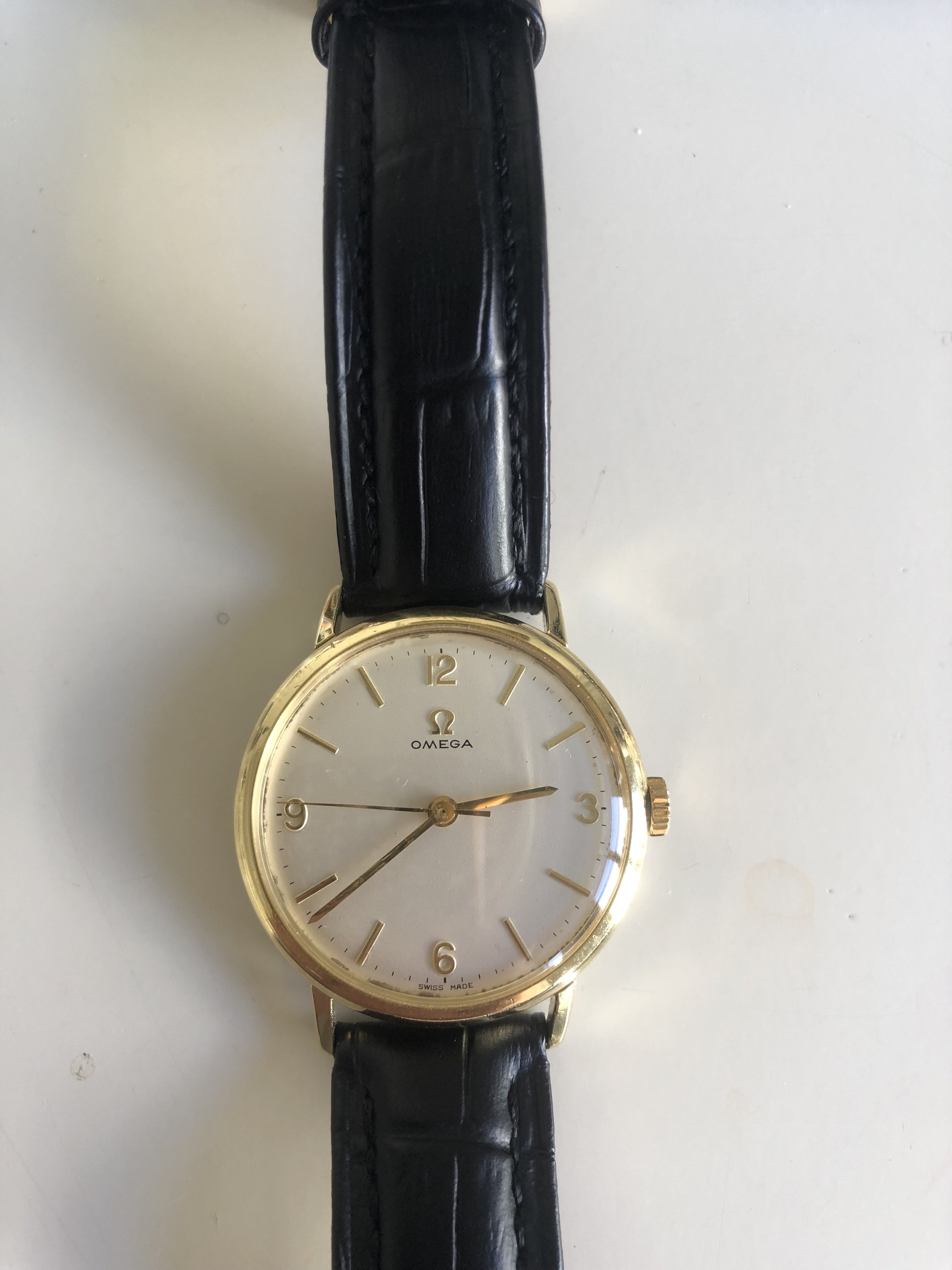

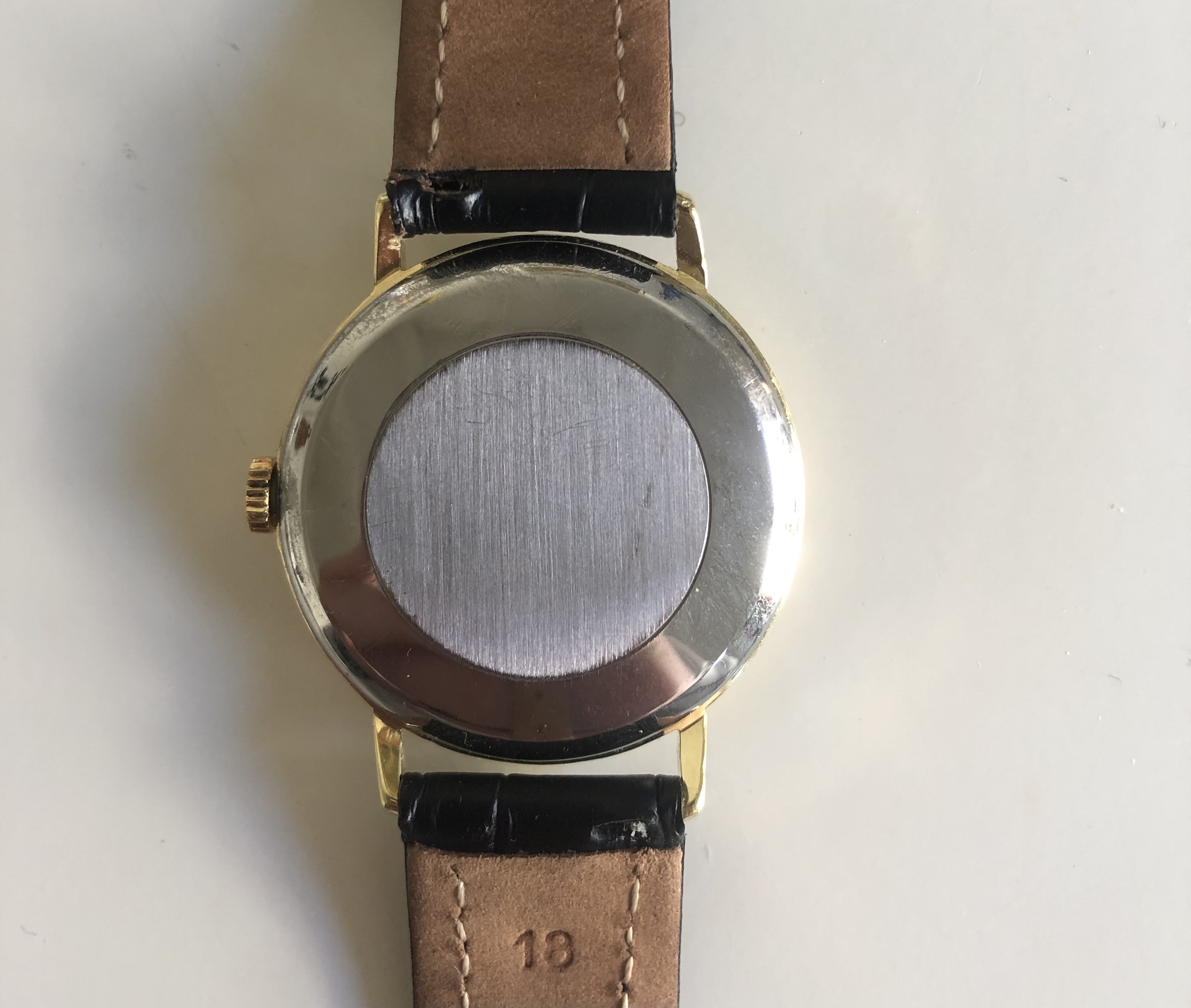

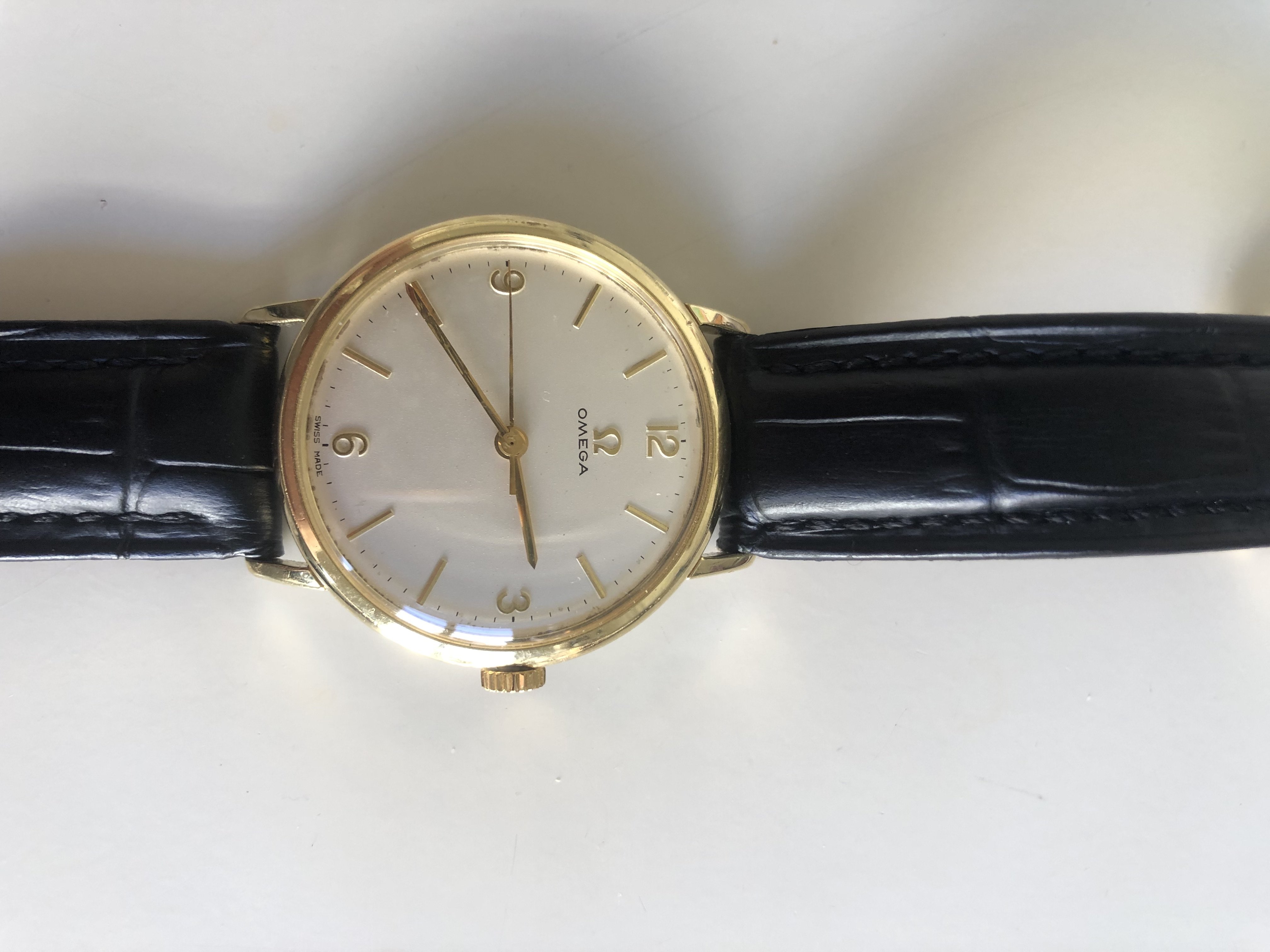

Hello all,

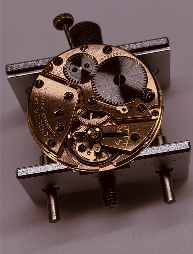

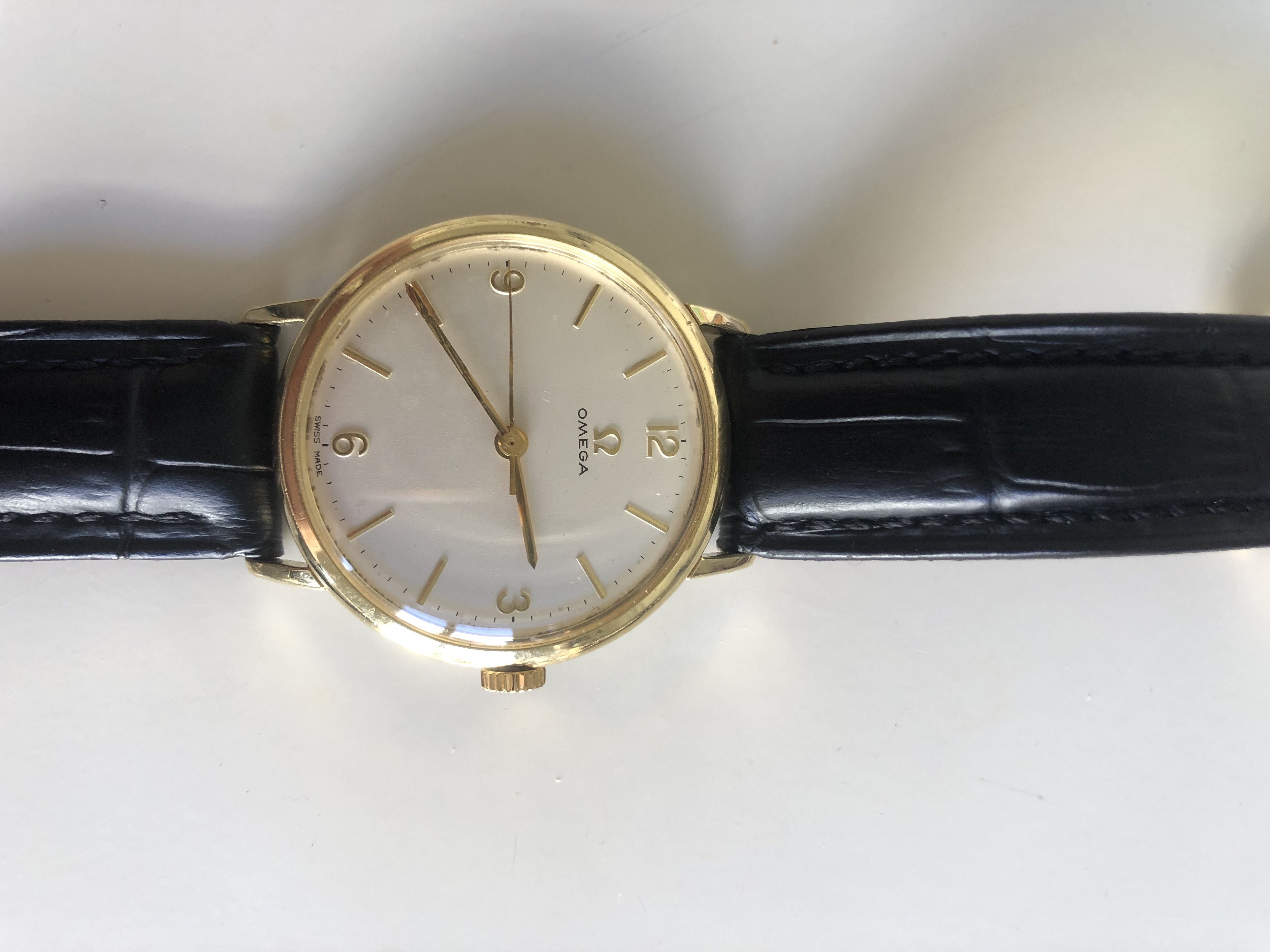

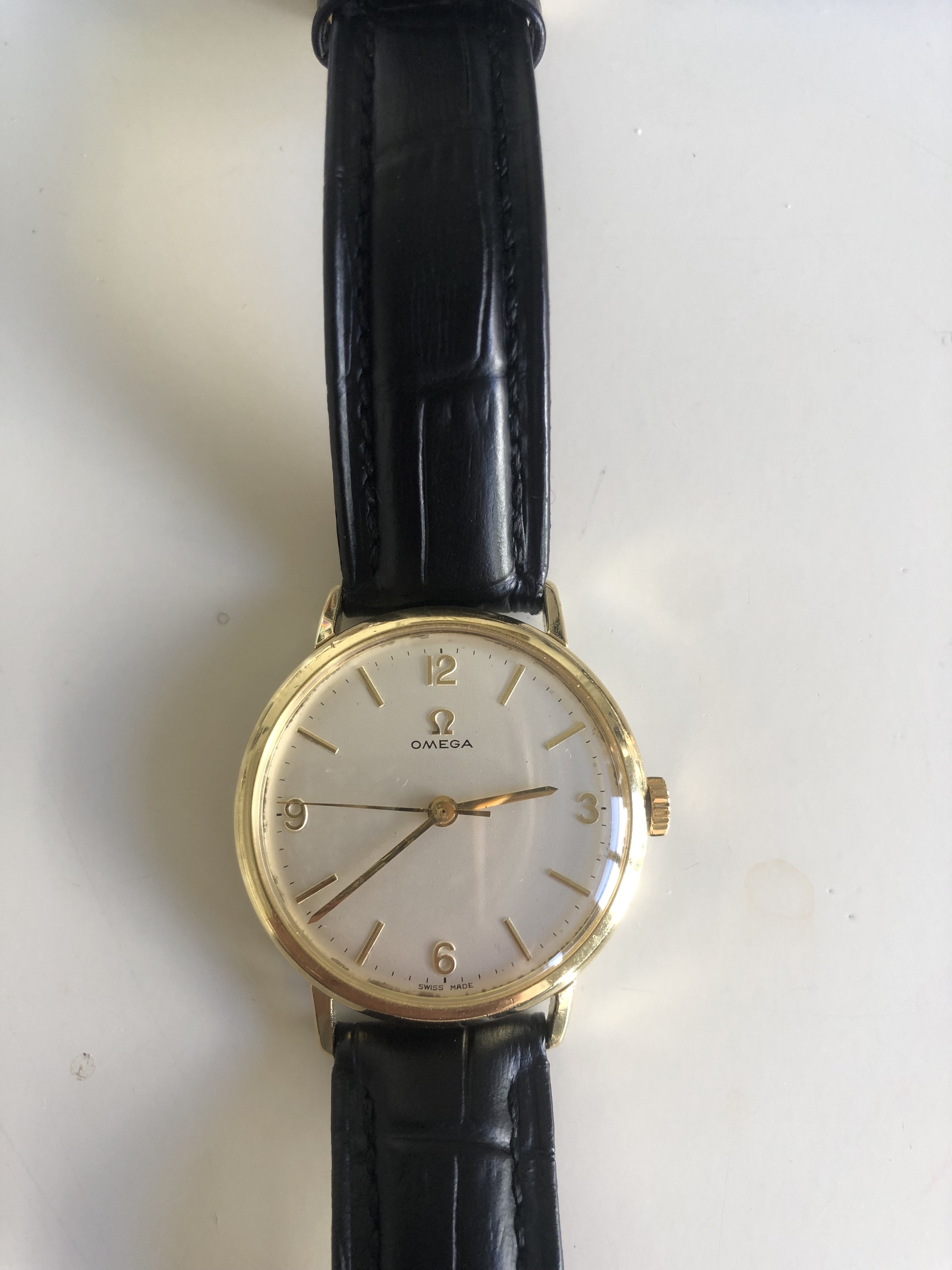

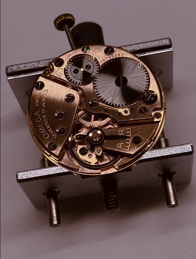

I have an Omega Geneve from 1962 (https://www.omegawatches.com/en-us/watch-omega-geneve-omega-me-131-0019). Or so it seems.. this Omega has a 601 movement. My omega however, has a 286 movement. I have had it serviced by a licensed Omega watchmaker recently. He told me that that the 286 movement was manufactured between 1963-1966. As seen on the pictures the reference number on the movement 19785051 which matches with the reference number on the caseback. The movement and the caseback are thus corresponding, but the dial is supposed to be on a 601 movement. According to my watchmaker, everything is original Omega and he said that in the last sixty years some things could have been changed around.
My question now is, which dial should have originally been on my watch? Could a customer choose a dial back then or was the original dial replaced with this one at some point of time? What are your thoughts on the dial mix-up?

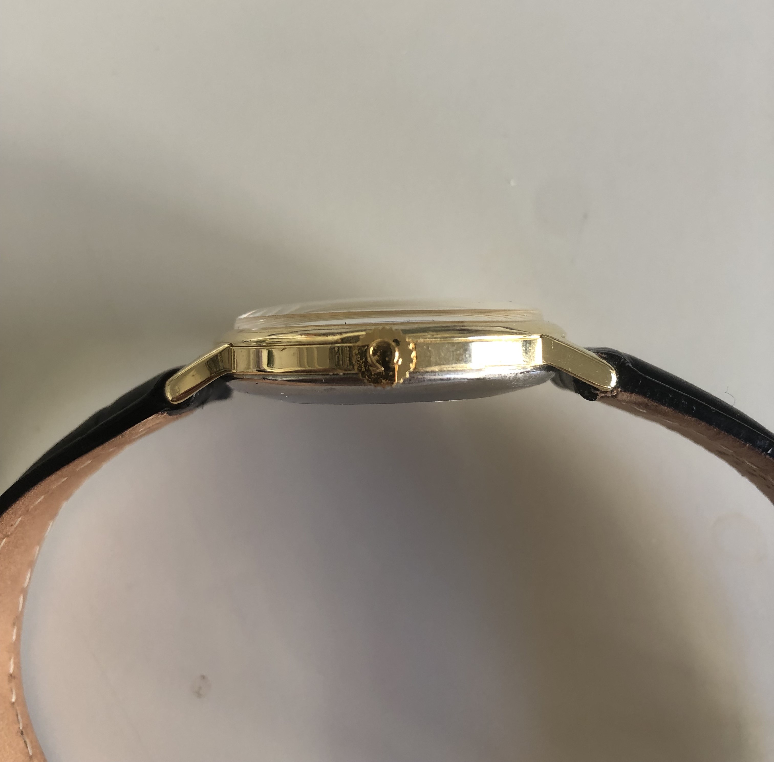

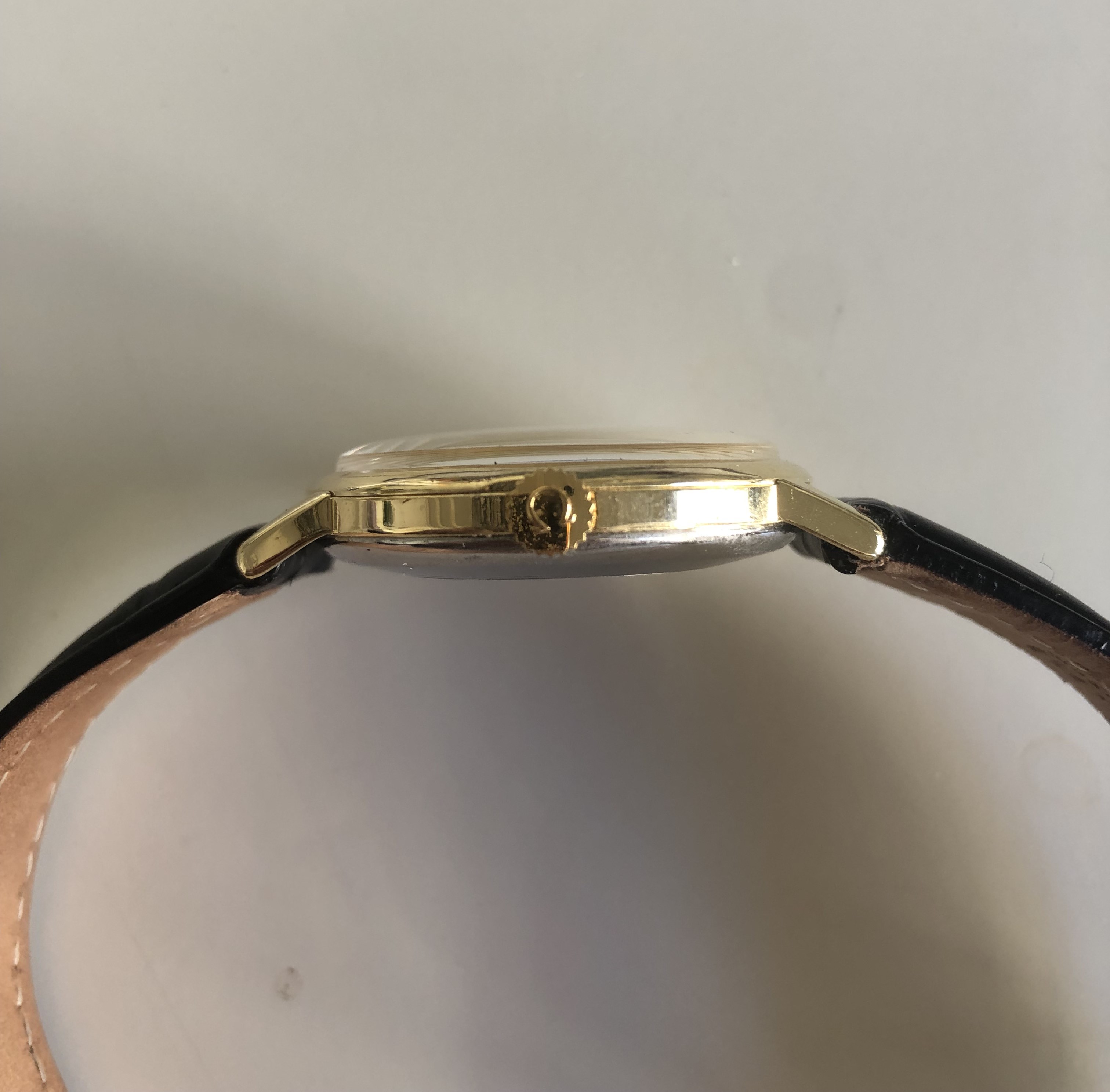

Also, this watch was made during the time where the seconds hand was moved from the 6 position to be a center seconds hand. This watch could have been from a batch where the movements where modified so that did not need to make an entirely new batch. The case should be a little bit higher when this is such a movement. What do you think, is this such a movement?
I am looking forward to hearing what you guys think about the watch and my questions!
Have a nice day you all!

Your post includes several confused points, so let's start at the beginning. Can we please see the reference number inside the case-back. If it is indeed 131.0019, then the case-back and movement are NOT corresponding. You also should be aware that each reference came with many different dial styles, so you can't simply use the photo in the OVD to determine which dials are correct. And finally, this watch was NOT made "during the time where the seconds hand was moved from the 6 position to be a center seconds hand." Center sweep 30mm movements were made starting in the 40s and your 286 is one in that series.

Thanks for your reaction! I can't open the case myself, but my watchmaker confirmed that the numbers of the movement and caseback corresponded. They are thus matching! I was wondering if a customers could chose different dial styles back then. Very interesting!

I think there is a miscommunication somewhere and it seems that you are still confused about the dial. The numbers on the movement and case-back never match. The movement has a serial number and the caseback has a reference number. And as I noted above, you have some confusion about the dial. Each reference was sold with many different dials. There is no reason to think that the dial is for a 601 movement, and in fact, dials would generally need to be modified to be transplanted from one family of movements to another.
Most likely, your watch is not a 131.0019, but instead it is a reference for a cal 286. Unfortunately, it doesn't seem that we will be able to help you without photos of the inside. I would invite you to continue to participate on the forum and learn more about vintage Omega watches; these issues will become more clear to you.

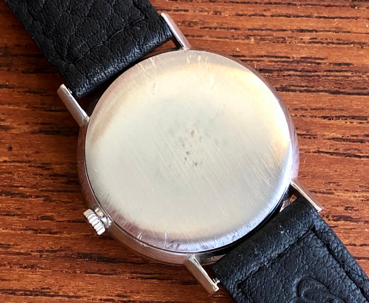

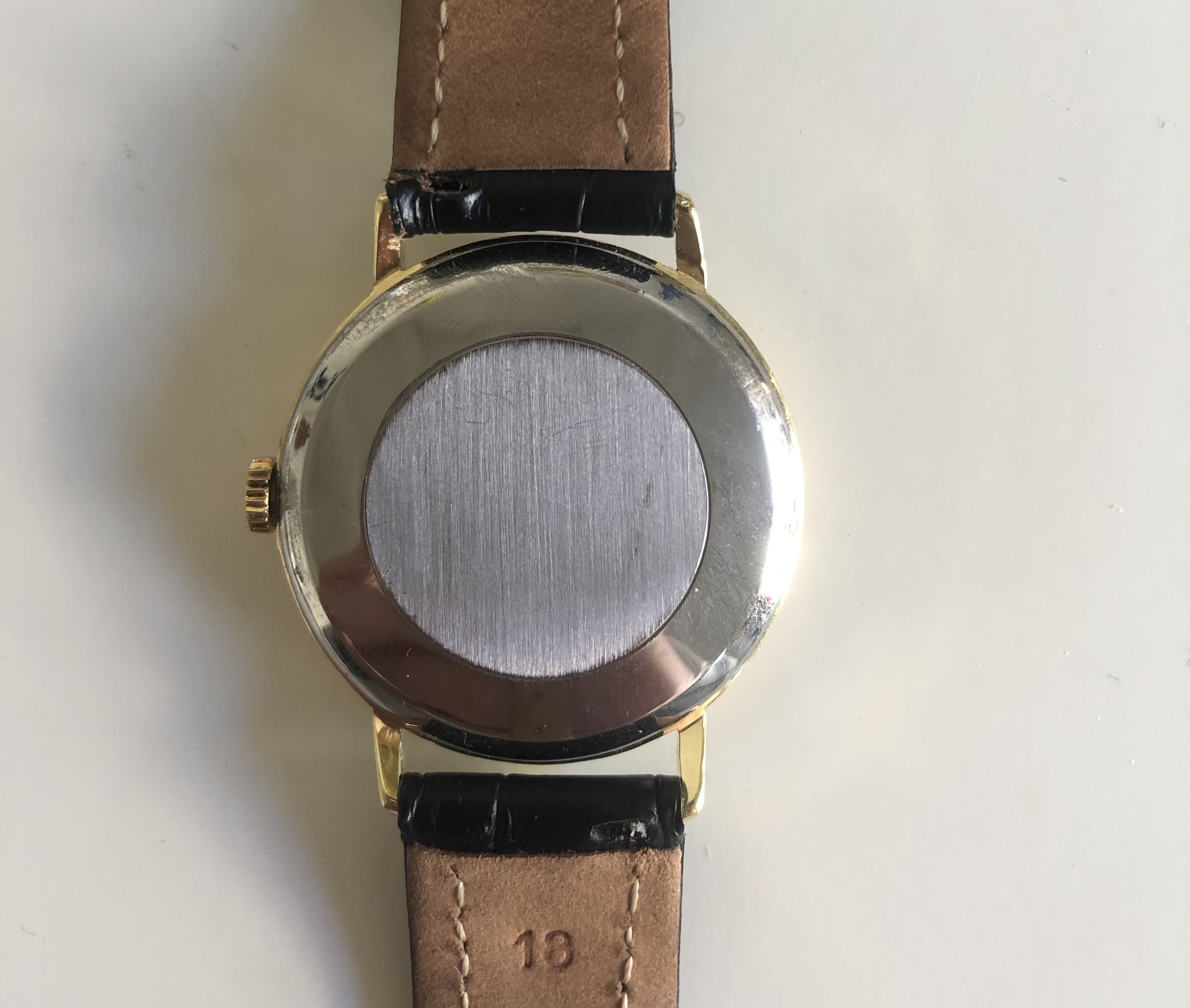

FYI this is what the back of a 131.0019 looks like.
