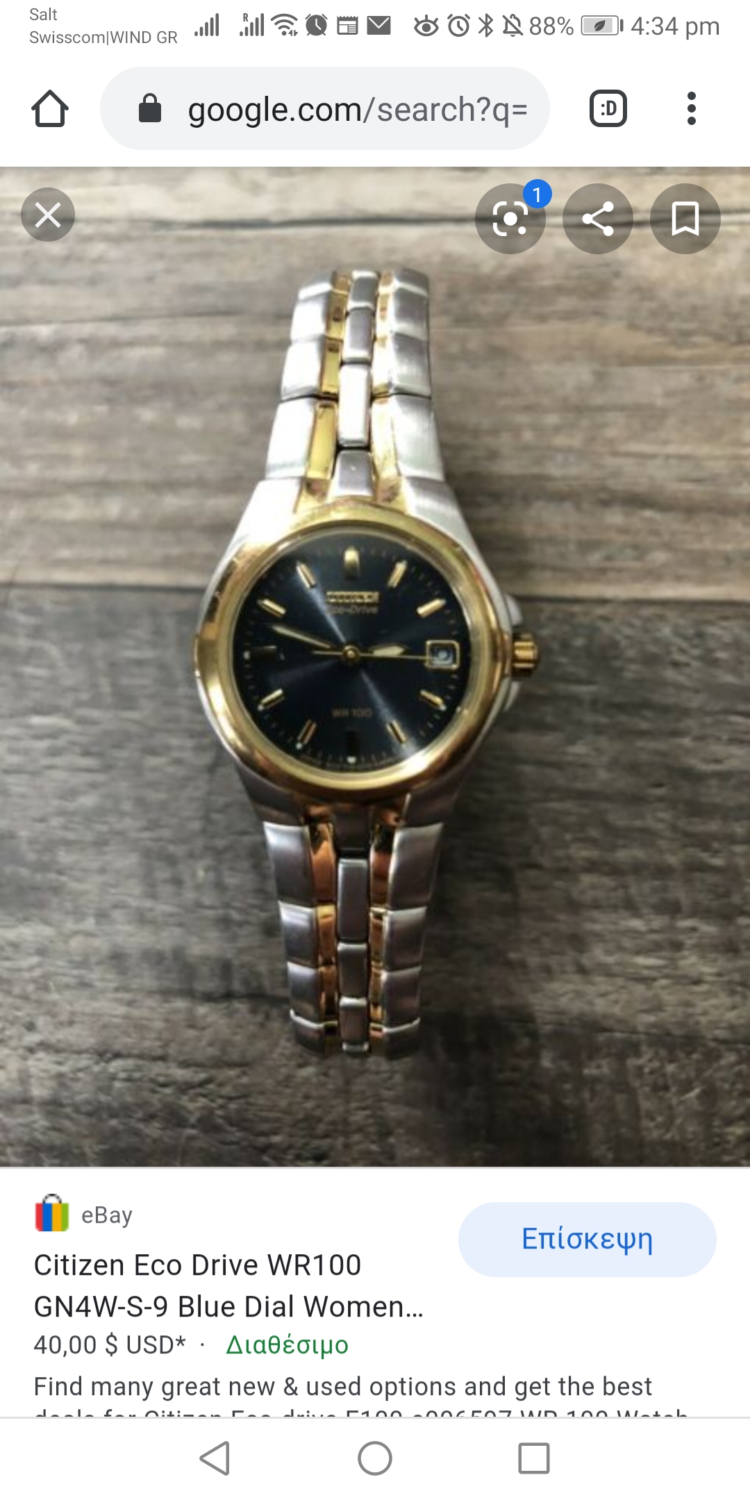

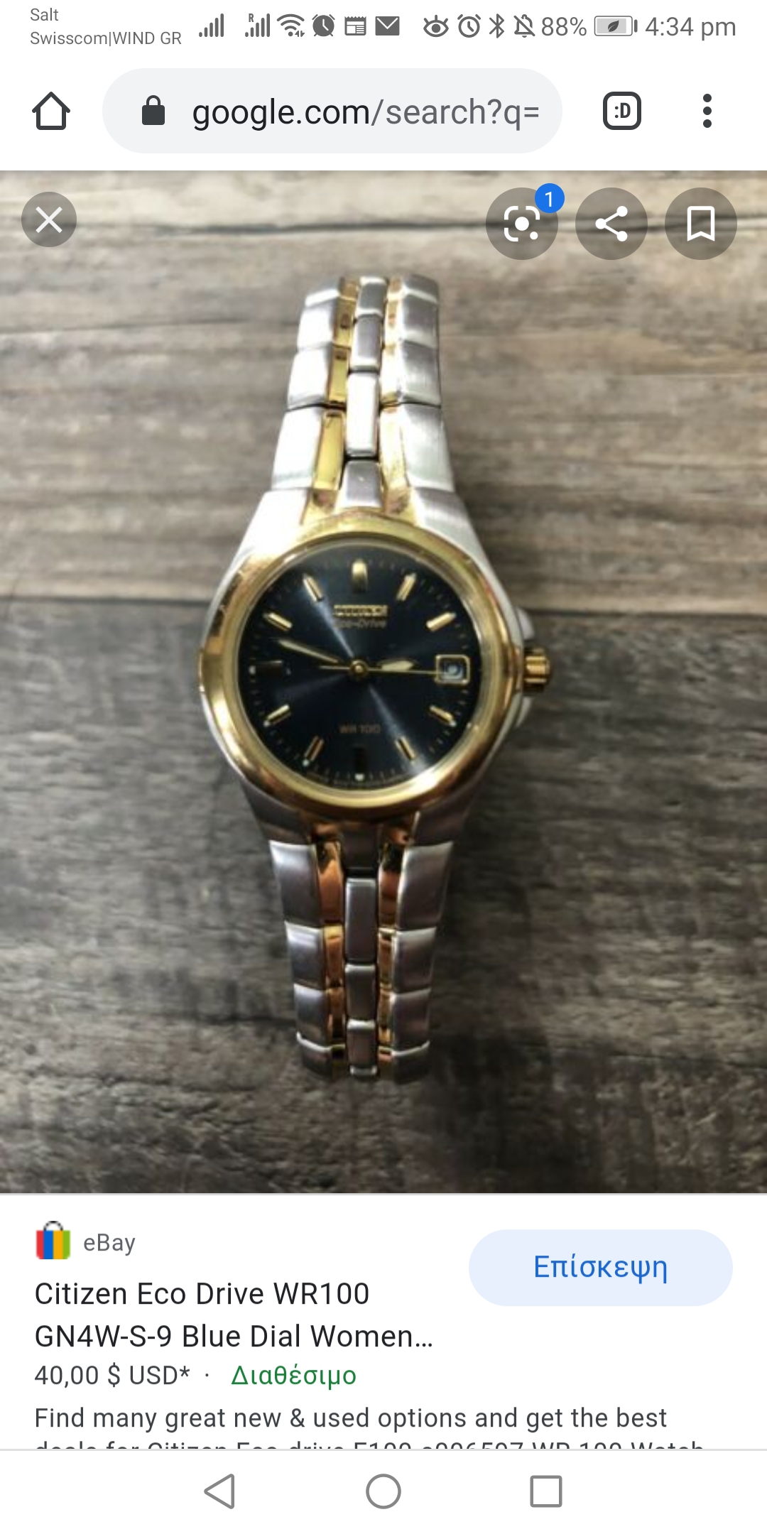

Unfortunately, I did not take any pictures of the watch before, but I found a similar watch online and I attach the pictures here.

Some early Citizen Eco drive watches did not have removable case backs, meaning the watches were assembled through the front. That may apply to yours. If it does, in order to process the repair, air pressure has to be used to “blow” the crystal out of the case. If this applies, it might be standard practice to quote for a replacement crystal and retainer ring, because of the risk of the crystal shattering when removed. These service centres are quoting for a repair THEY feel they can guarantee! Perhaps they feel if they do the repair YOU want done, they won’t guarantee it. You may have limited choices. If you don’t want it changed in any way, just ask for it to be returned, not done.

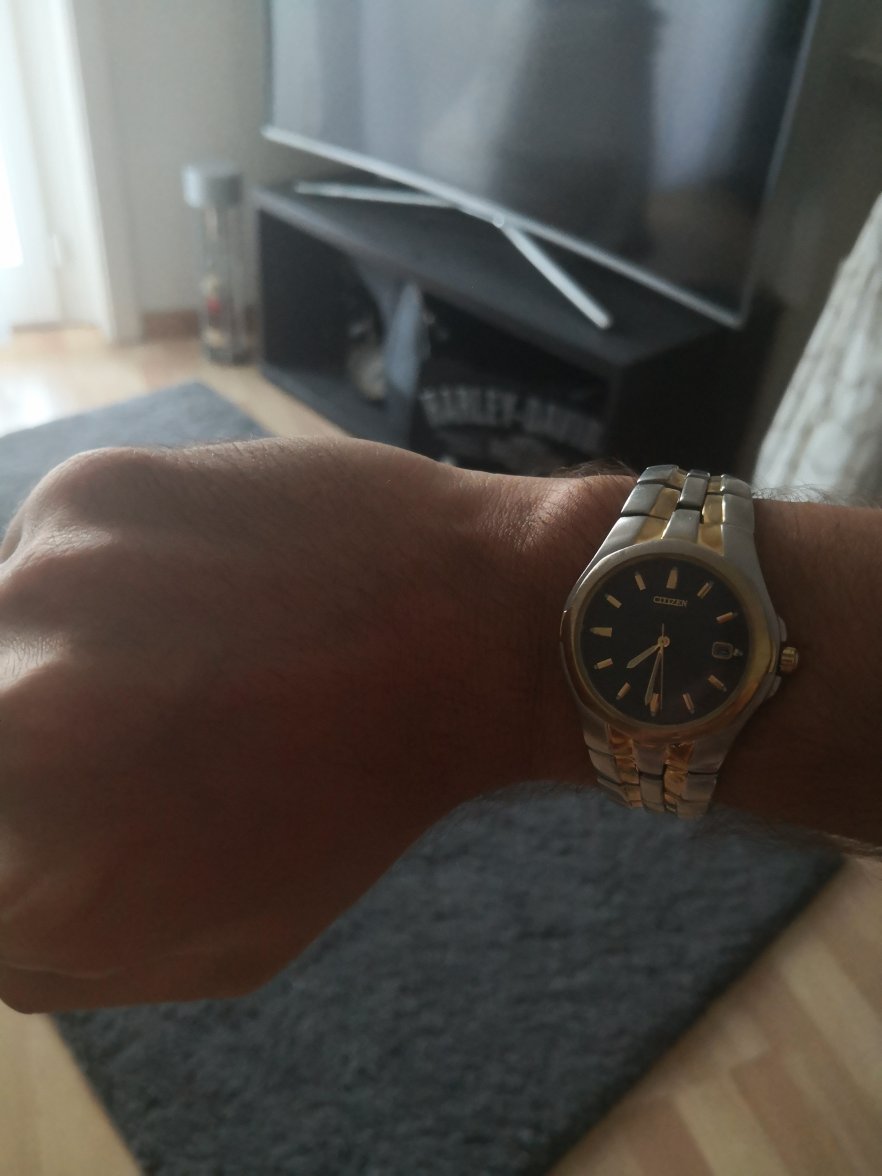

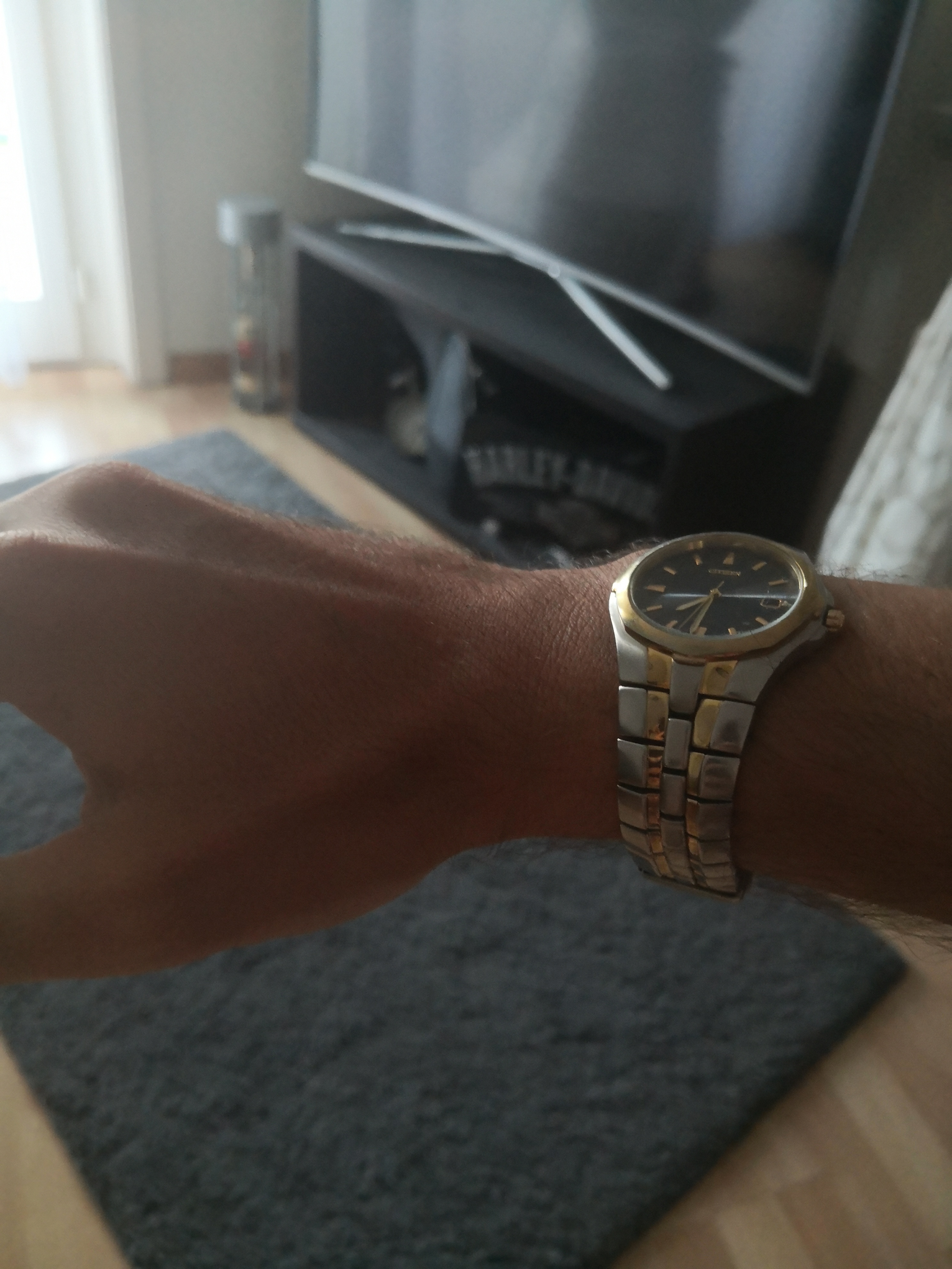

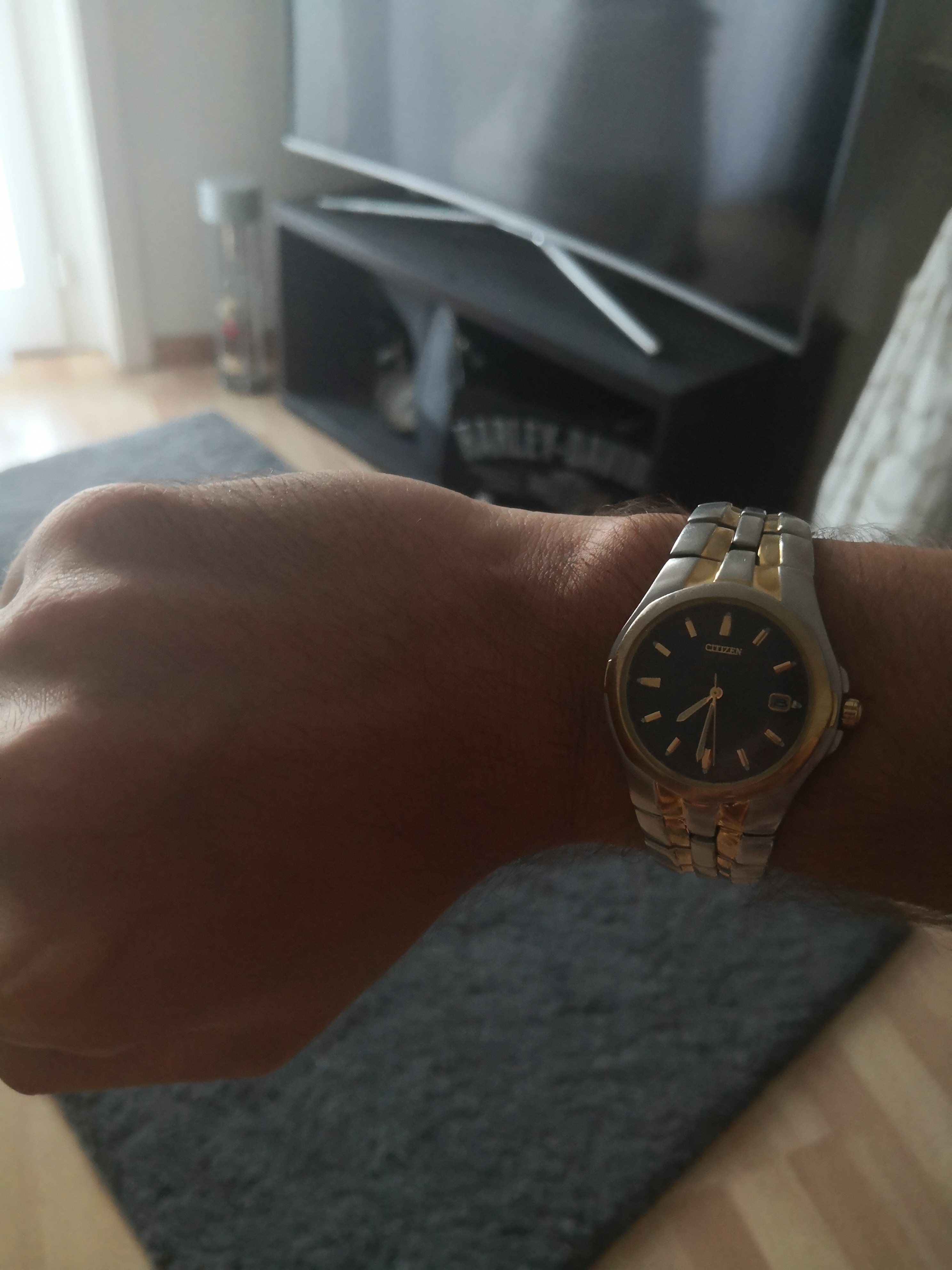

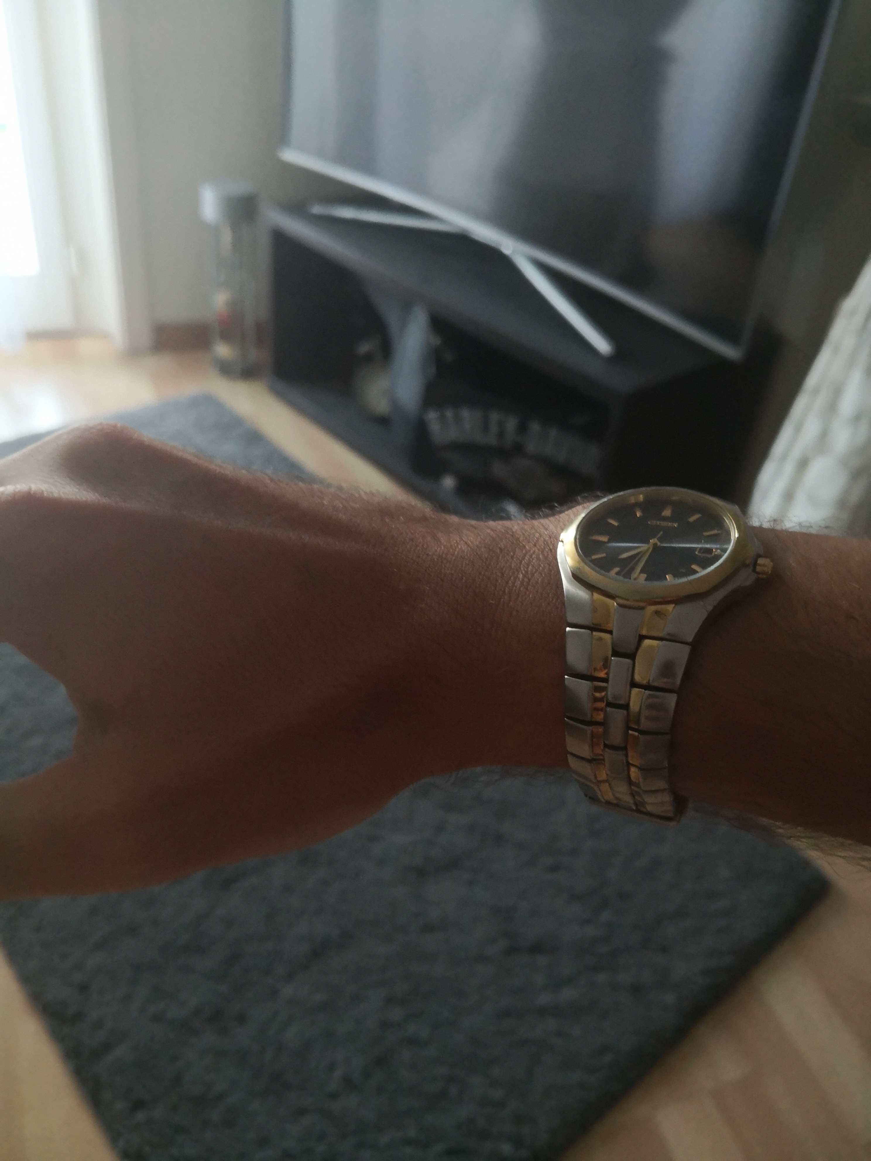

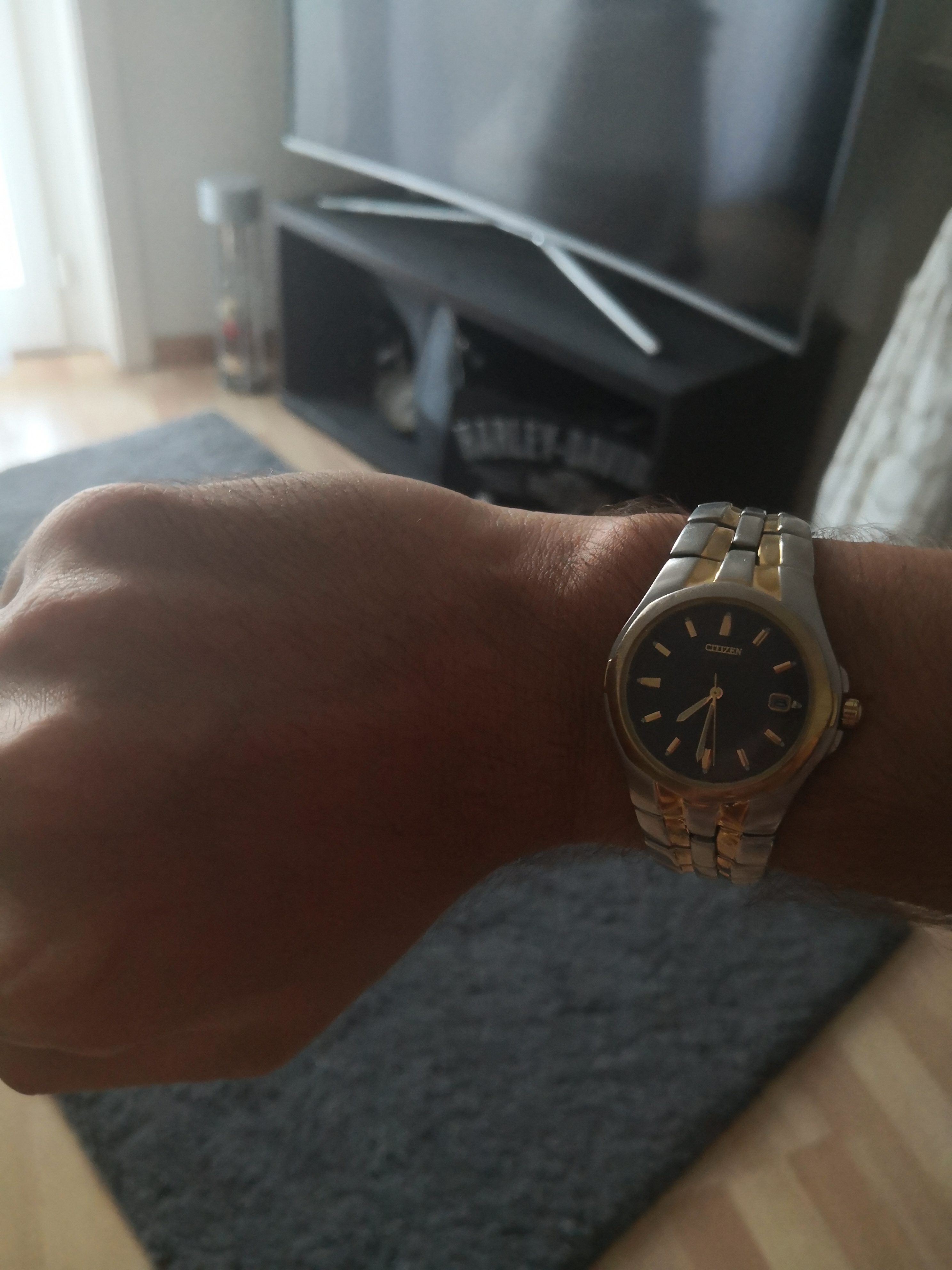

After 6 months of waiting due to corona finally my uncles's watch is back!
Complete change of mechanism but no polishing and no new crystal installation!
A piece of great sentimental value!
