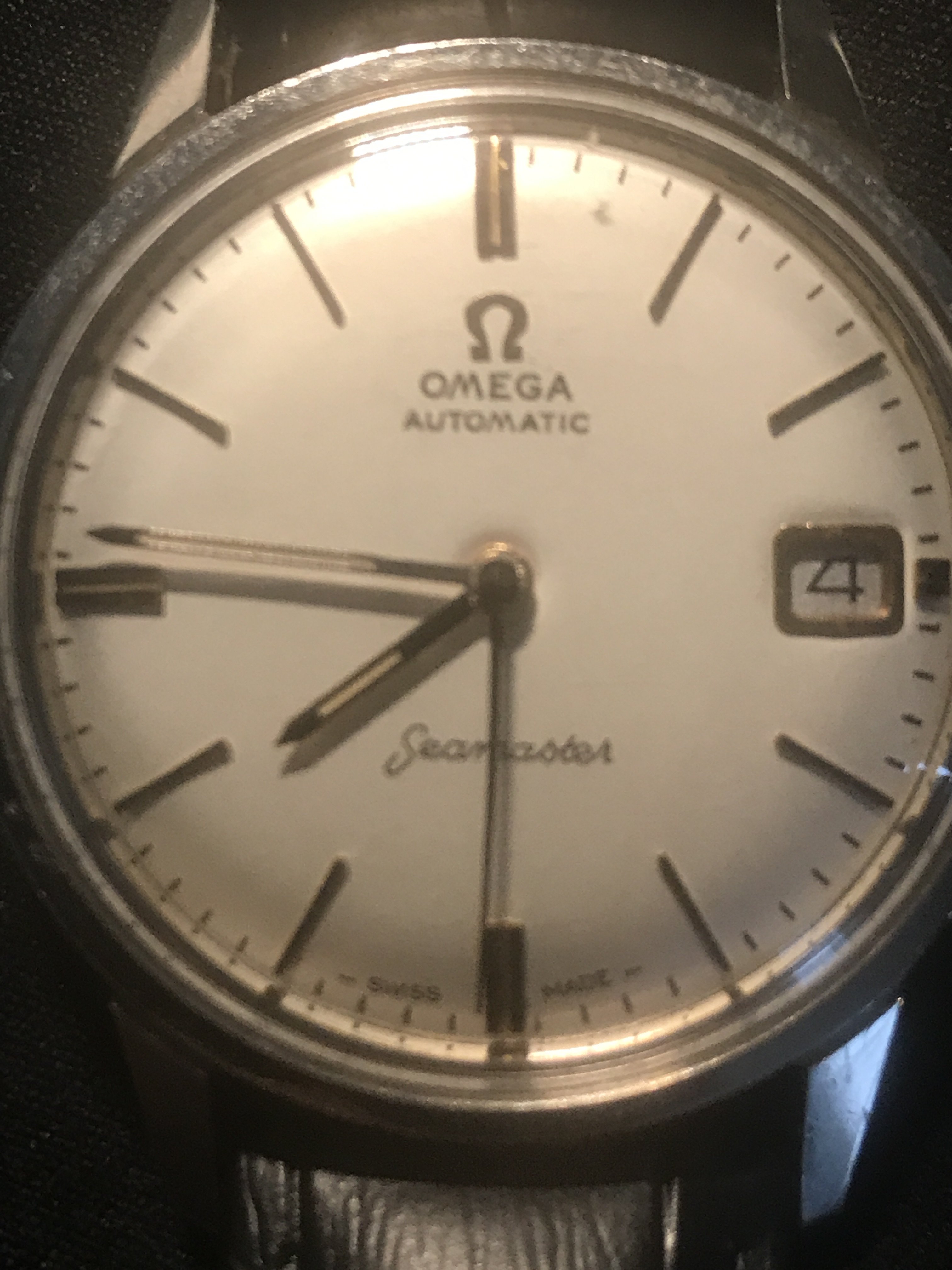

Dear community,
This is my first post here. I'd like to take the opportunity to thank you for the immense knowledge shared which is very helpful for rookies like me who are fascinated by this world.

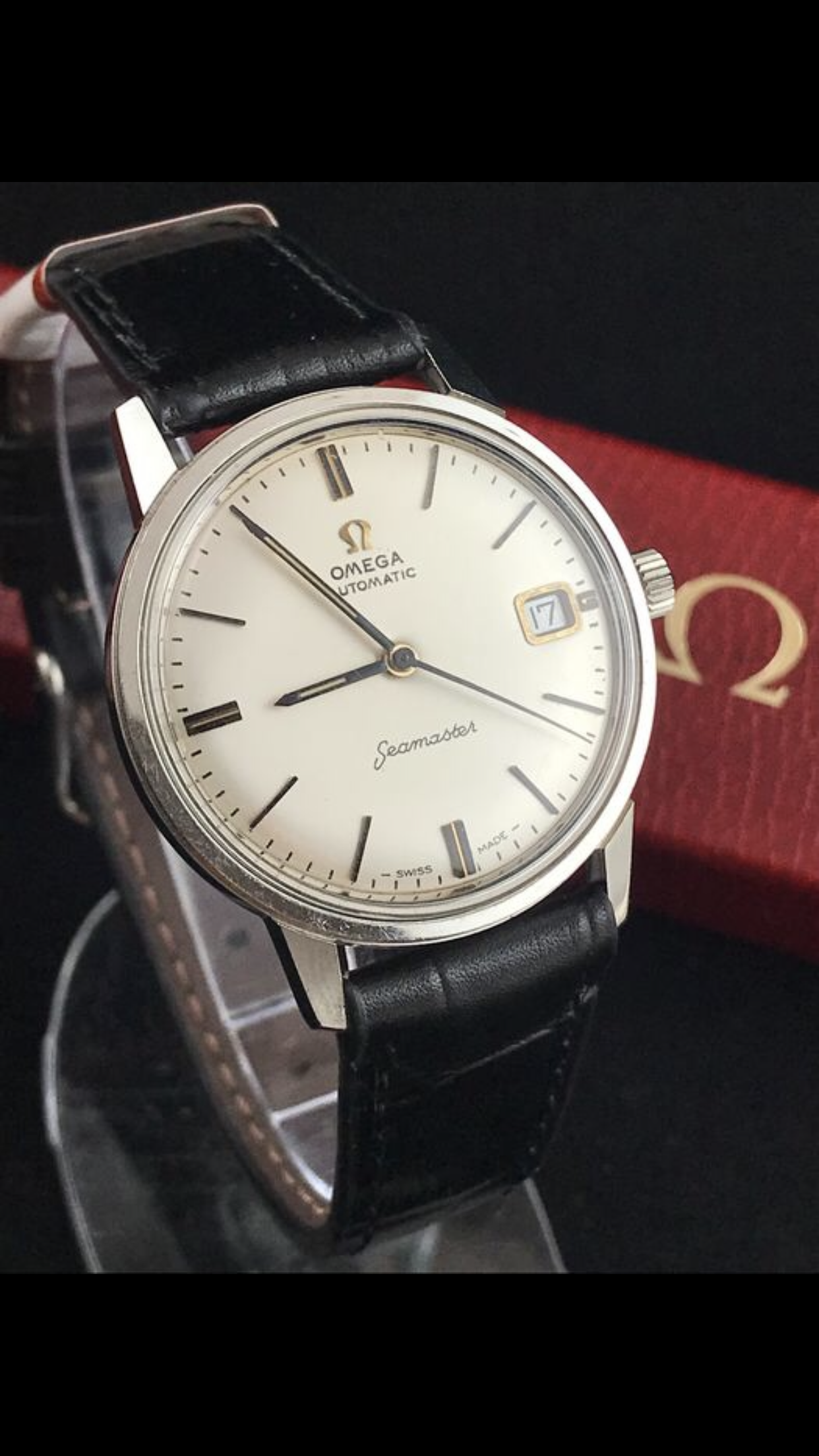

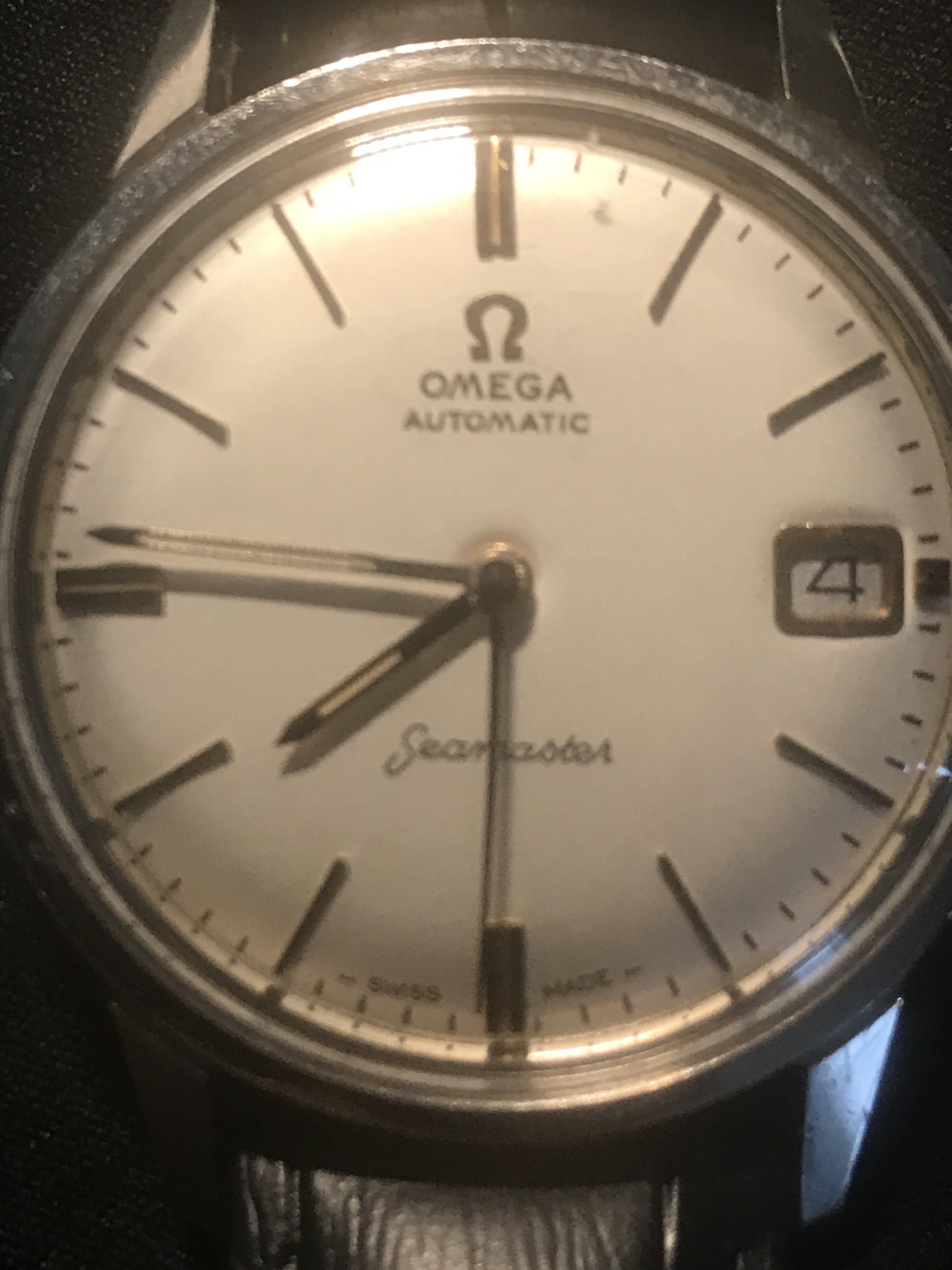

I recently purchase my first vintage Seamaster (166.002) from 1968 on Catawiki and had a couple of questions.

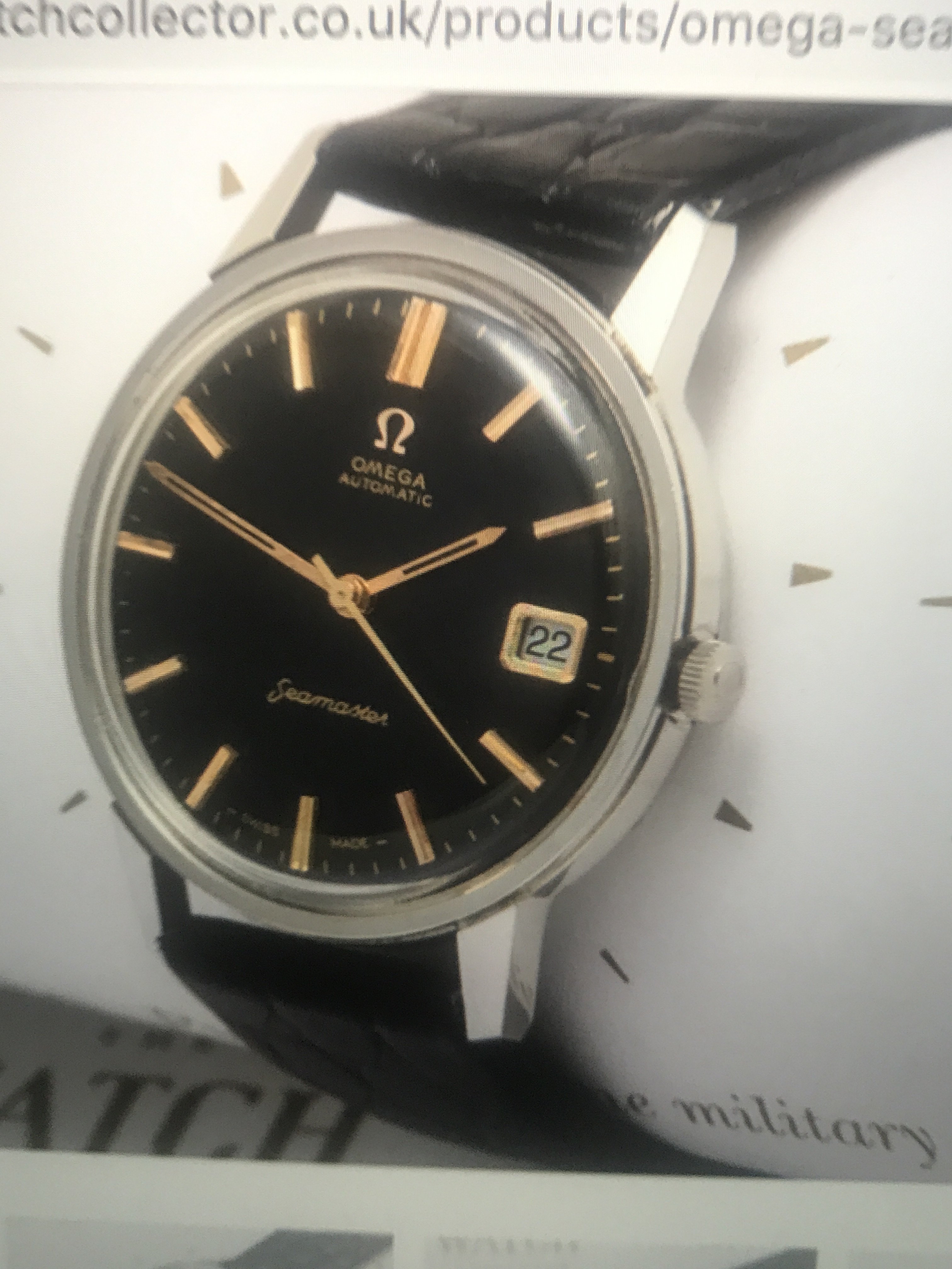

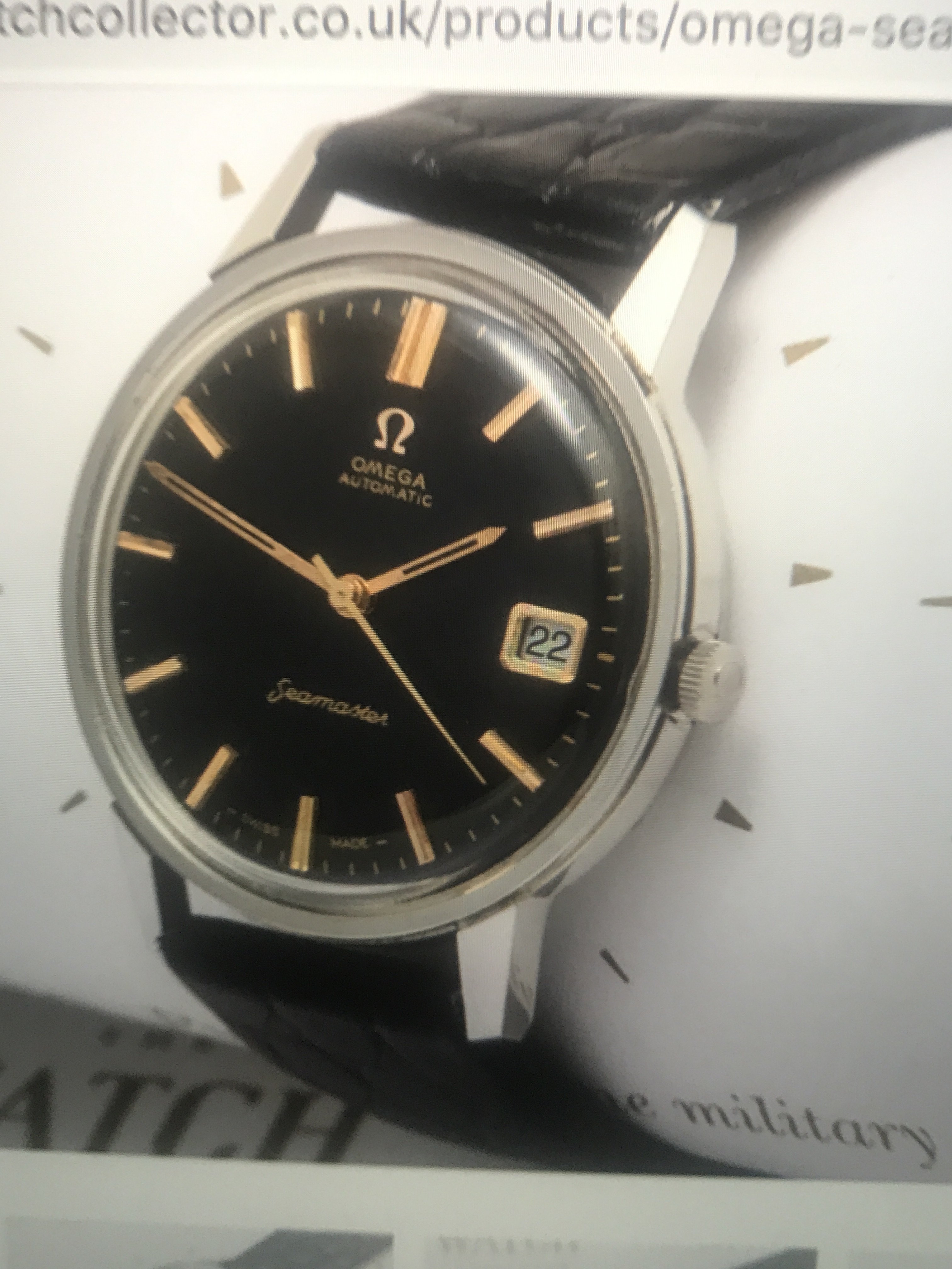

1) I noticed that the SWISS and MADE signs are not aligned. You can see that MADE is slightly higher. This sparked some concern and while researching I came across another identical piece from the same year with the only difference being the colour of the dial (black). As you can see in the pic the MADE sign is similarly slightly higher. Does anyone know why is that?
2) The previous owner claims that the watch was serviced less than half a year ago. However, I notice sometimes that the second hand stutters between certain areas (from sec 3 to 27). Should I be concerned in terms of need for immediate servicing?
Looking forward to your inputs! 😀
C.

A recent service and a second hand that doesn’t move cleanly are a combination that’s at least unlikely.
Do you have the possibility of returning it?
10,804
16,814
I too think it is a redial. The second track is misaligned badly in places.

Indeed the minute track markers are badly misaligned. Sorry for the bad news; next time be sure to post before you buy, not after.

Yes the seller gives the option and I probably will return it. Thanks!
Thanks! Well on such details I relied on the fact that a Catawiki watch expert would have taken such details into account. But clearly is not the case. Lesson learned.
The seller is not aware of the state of the dial as he had bought it from a watchmaker and can’t provide detailed info. I will return it. The hunt for a proper one will have to continue...

1. Refinished dials aren’t always declared.
2. “Recently serviced” means very little, unless you have proof it was done and know the extent to which it was performed. Factoring in the cost of a fresh service is good practice where these are unknowns.

What about the coathanger S and the 1968...
What about "Swiss Made" above the minute track...

Update: Watch returned and refund received. The more I look dials online, the more I spot minor inconsistencies. In the end I think I will go for a local seller in Belgium who offers servicing and guarantee.

Since no one has mentioned it yet, I will; the source of the second hand hesitating is a result of the movement design. Many of these movements, particularily the automatics, the second hand is not directly driven from the train. Therefore, there is some give. There is a tension spring on the second hand that puts just enough drag on the second hand pinion so the second hand goes around smoothly.
Sometimes these get a little loose and the second hand then stutters.
(This is how it was explained to me. If it's right, not my fault!)

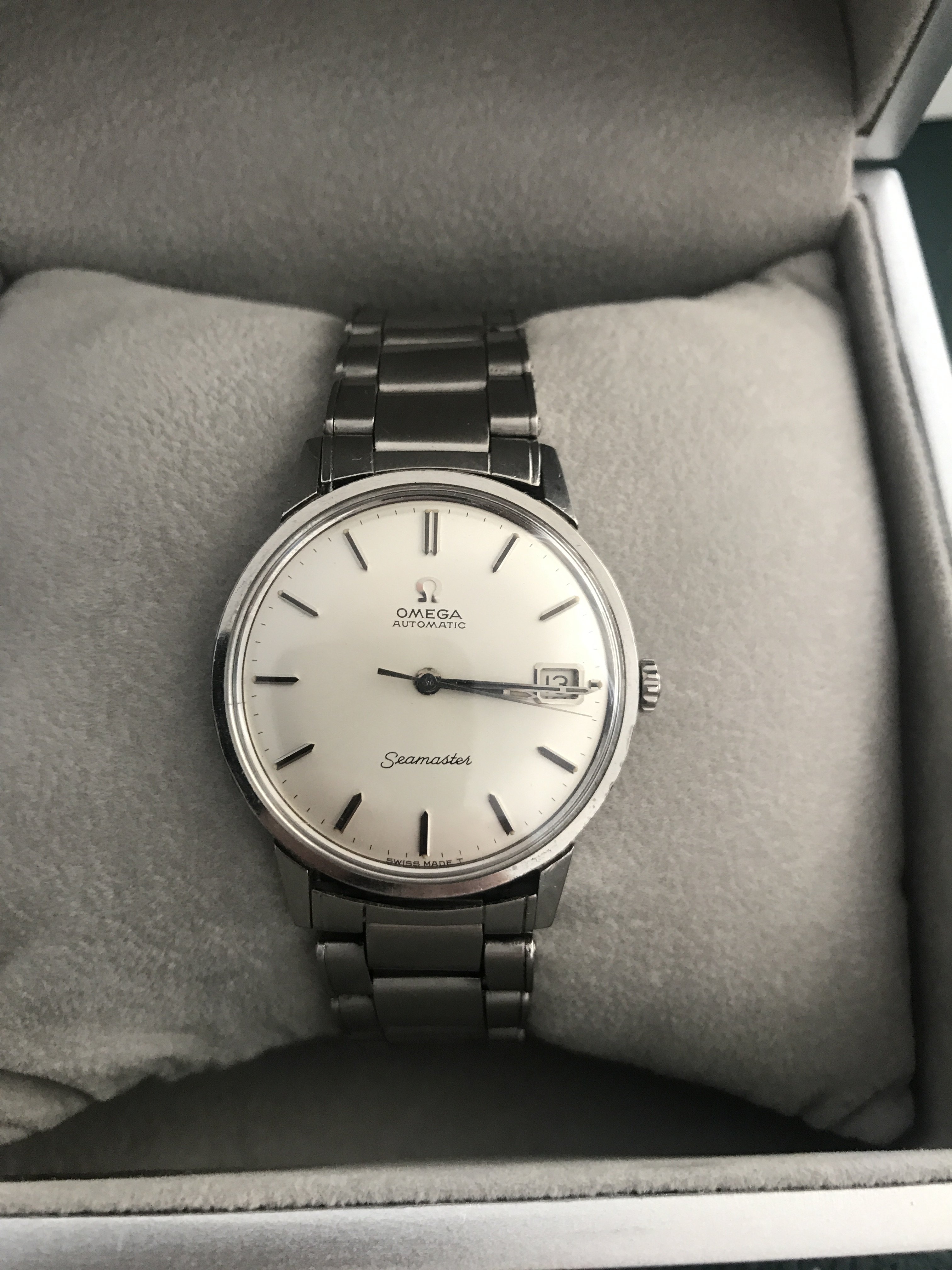

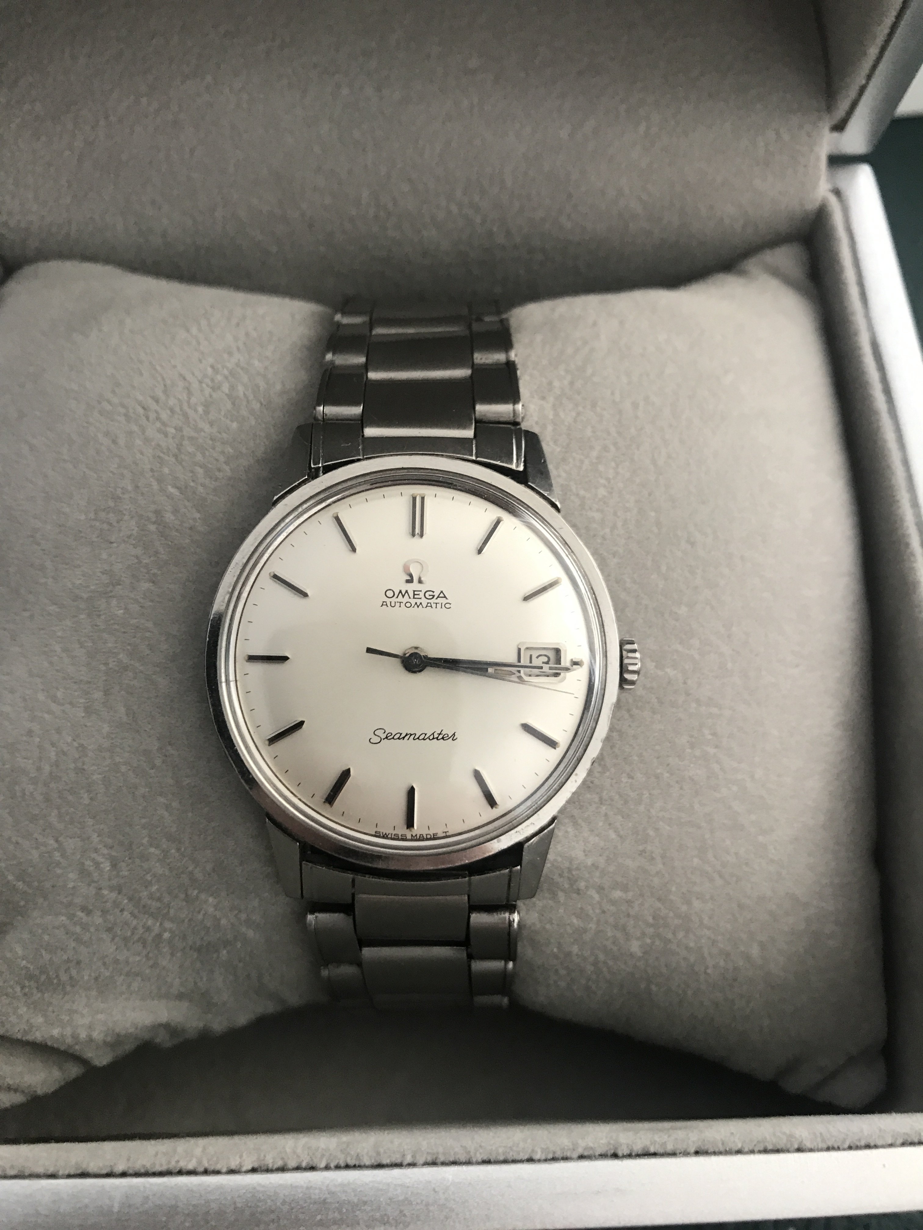

Thanks a lot for the comments! In the meantime, we have a winner! Comes in its original bracelet, serviced and 2 year guarantee. ::psy::

That might be “original” but it doesn’t fit right. What is the case number?

@SkunkPrince is spot on. That is not the bracelet that shipped with that watch. The radius is all wrong. It may be an original Omega bracelet, but it sure wasn't meant to be on that watch.
Still, that watch head on a leather strap will be very nice.

Yes, leather, or with the case number we can at least identify the correct bracelet, if there is one.
