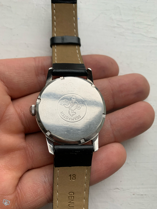

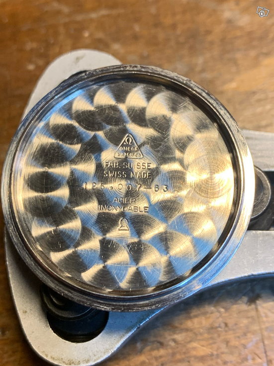

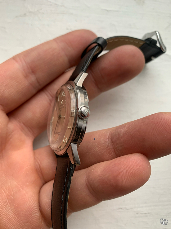

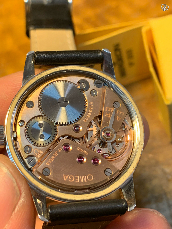

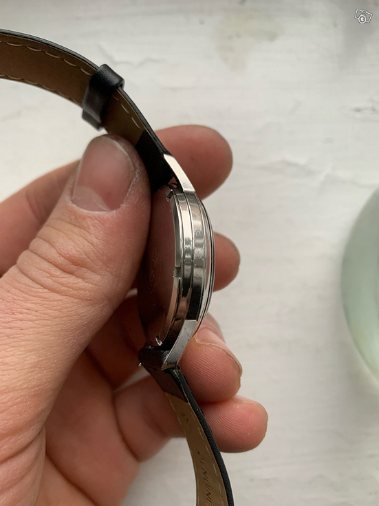

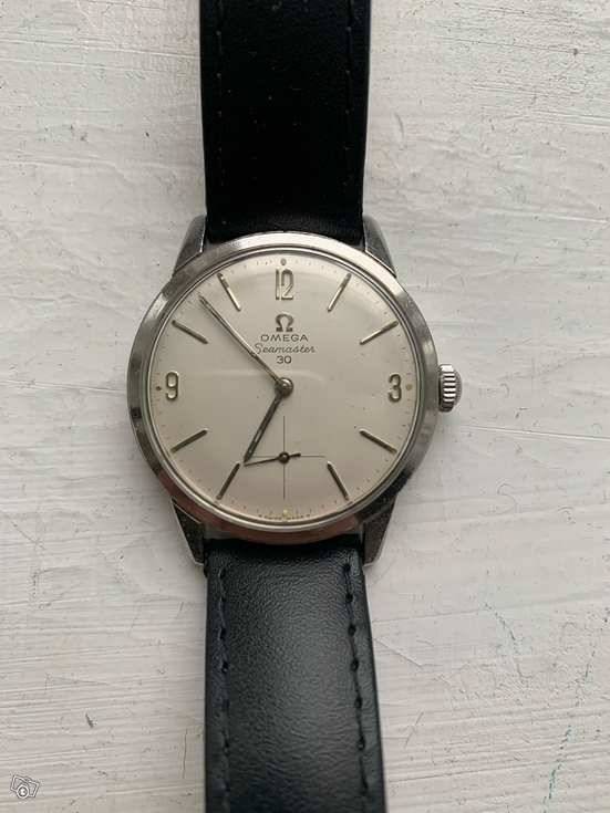

Hi all, another weird question for you, in relation to Seamaster 30 lume. I have come across a Seamaster 30 that looked somewhat appealing. With my radioactive quirkiness, I had been keeping away for a while... What has been striking me is that it appears that this one has a T on the dial, which spells out either a dodgy dial or the fact that perhaps some T models do exist? From the serial number it appears to be perhaps a 63 model, if my interpretation of the last 2 digits of the number is correct? Here go some pics for you to browse. Thanks for sharing your views, they are always an informative and enlightening read!

Looks fine. Prob made in early 1964 hence by then tritium dials had the T marks.

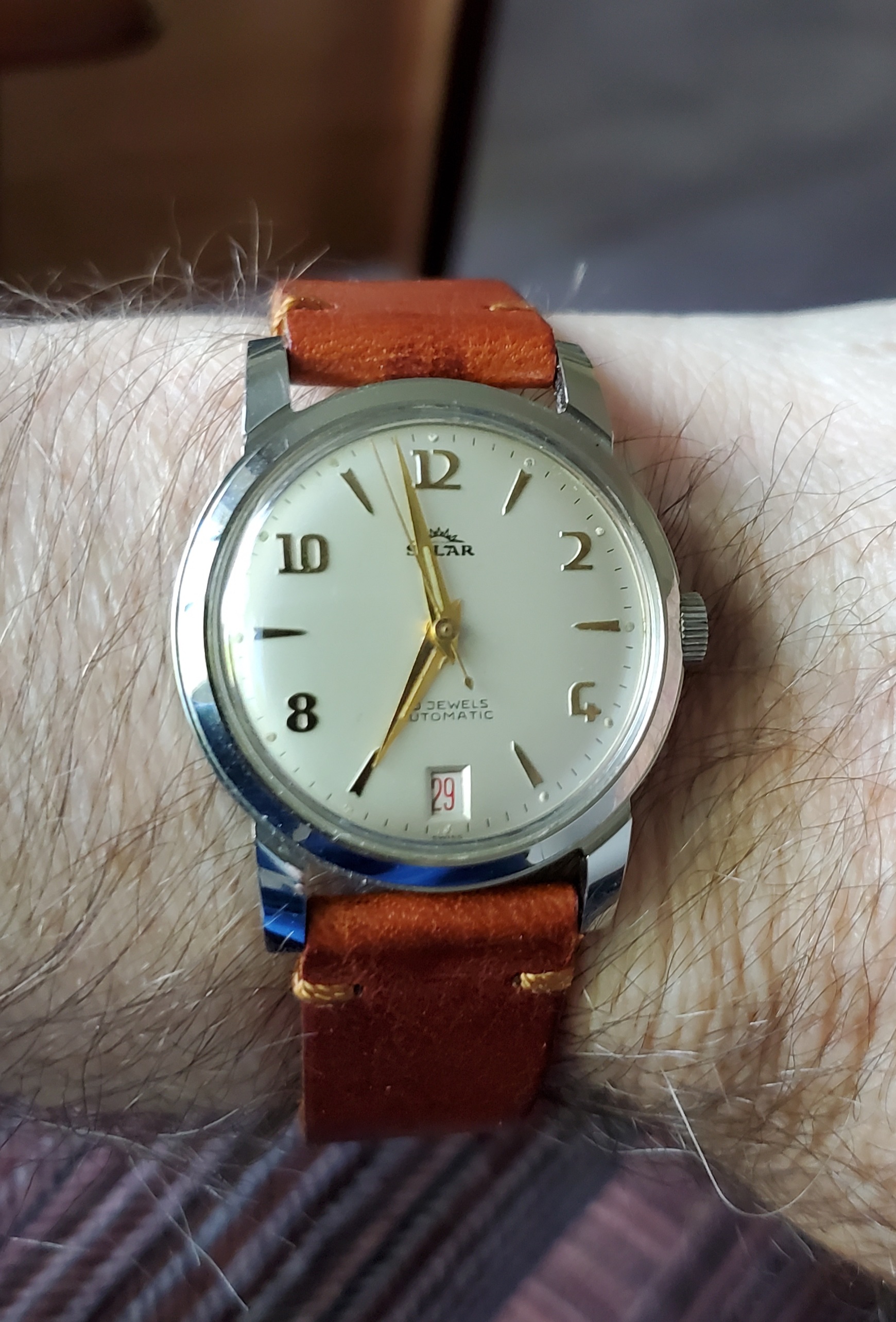

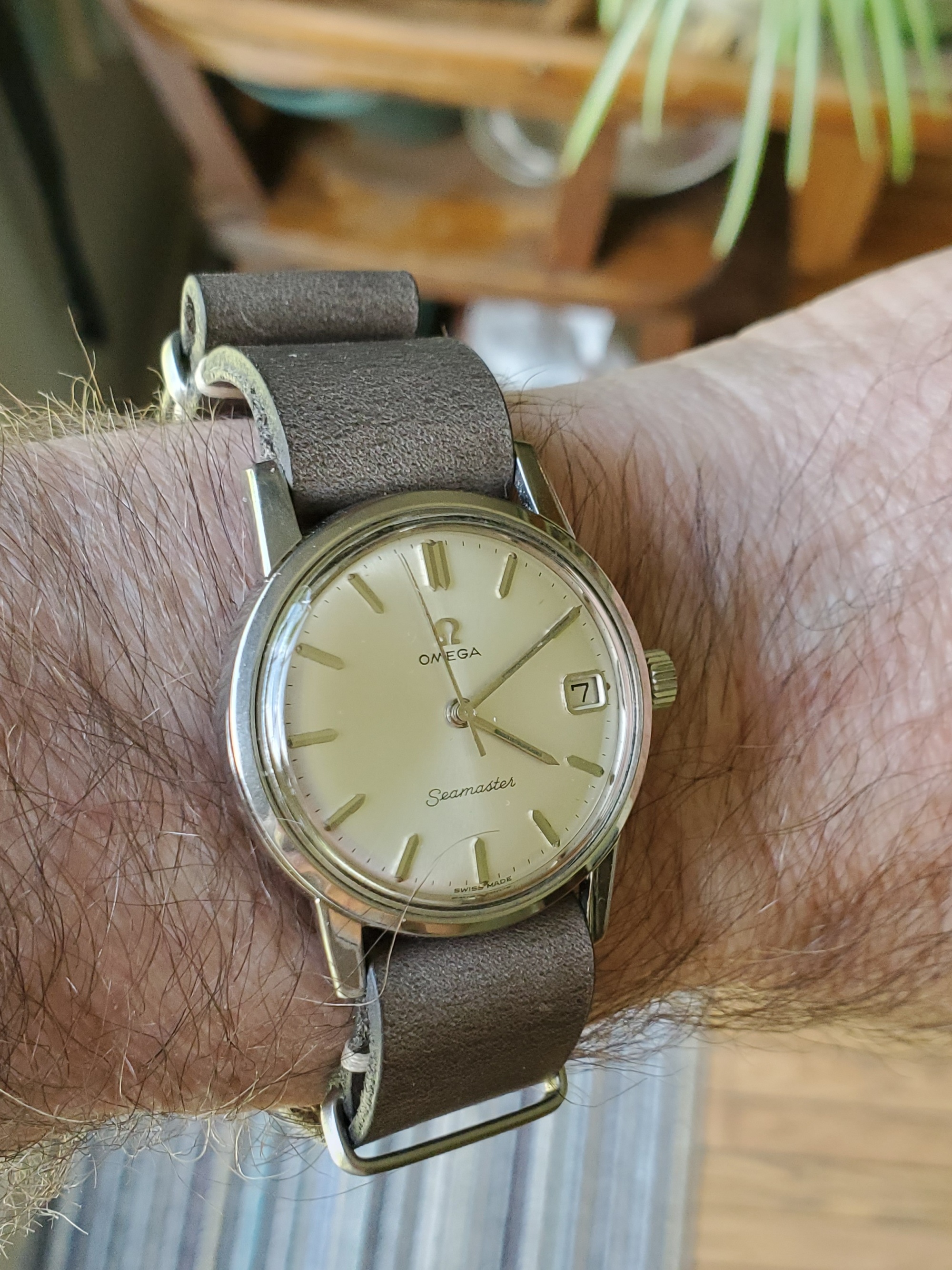

The Seamaster 30 in the photo sure looks like tritium based on the colour. I have a 1963 Seamaster and it is tritium. Radium lume in good condition is usually beige and tritium generally has a greenish hue. They can both go an ugly dark green when oxidized.
I have a very early 1960's Solar that has a radium dial and tritium hands. The watch is apparently all original, and pristine condition, so they probably ran out of radium hands but still had some dials left over. The hour markers glow all night long but the hands only glow for 2 minutes immediately after exposed to light.
