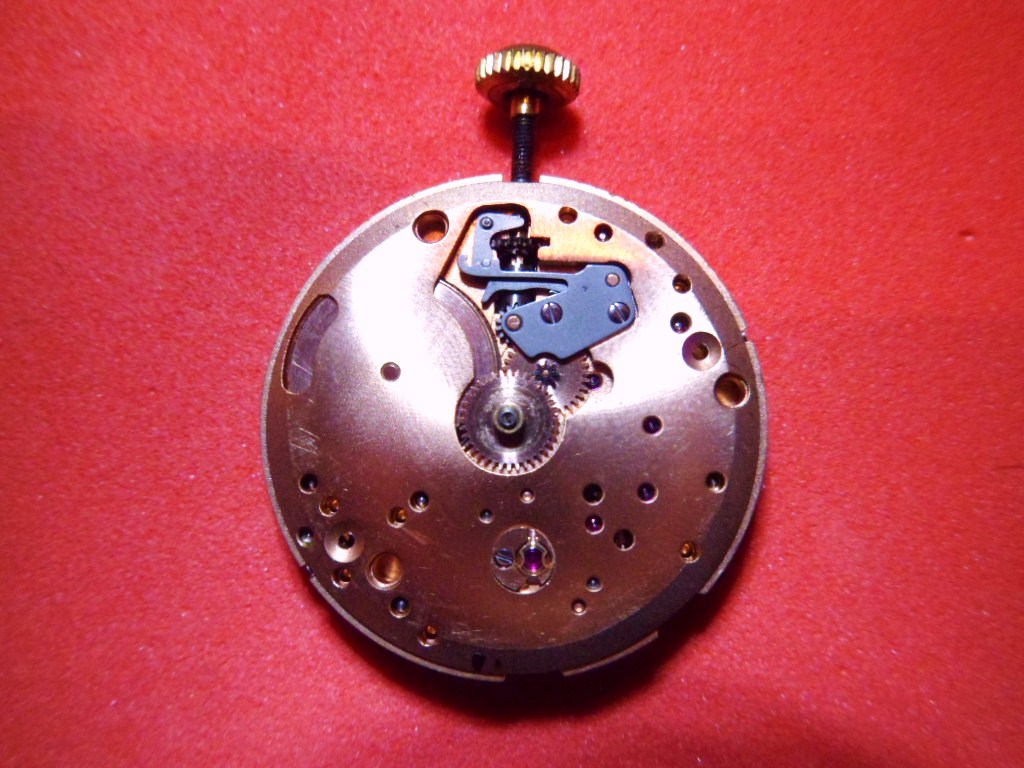

    Can anyone help a novice in distress,I have a 1952 Omega cal.420 in need of repair but being a complete beginner in this field i don't even know what the part needed is called or the part number!! Can anybody come to my aid,The part in question is the wheel/cog highlighted in the photograph,Any assistance would be greatly appreciated 420 022a.jpg

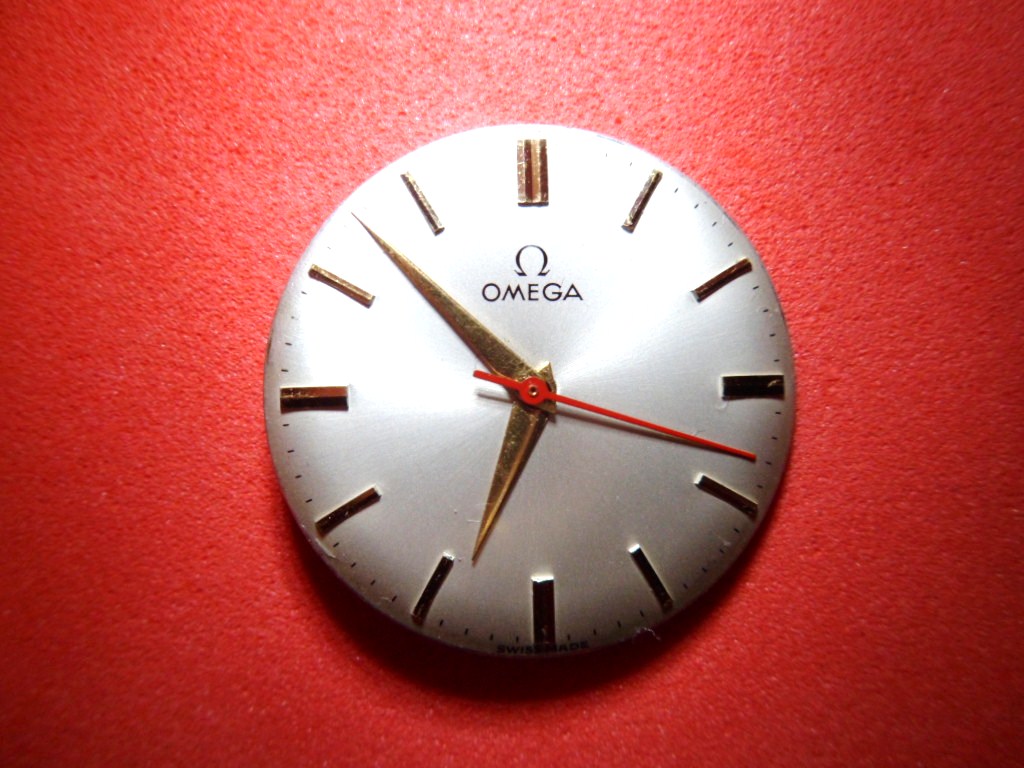

    The watch is not cased but i hope these help. 420 001.JPG 420 022a.jpg 420 056.JPG

    So does that make it the centre wheel the OP is talking about?
  8. ursa1951 Oct 30, 2012
    7
    You have to remember your dealing with an amoeba when you talk to me!! All i can say is the wheel in question is not centre.

  12. cicindela Steve @ ΩF Staff Member Oct 30, 2012
    15,047
    23,789
    I believe you are looking for the sweep seconds/third wheel on the this movement, though I am not very familiar with 420s . You should be be able to get one cheap here, http://www.julesborel.com

  14. ulackfocus Oct 30, 2012
    25,983
    26,972
    It's an intermediate wheel which indirectly drives the sweep second hand. What it's actually called by a parts store is another story. It's a separate wheel than any in the train.
    A watch with subseconds has the second hand driven directly by the fourth wheel. Center sweep was done a few different ways back then. Normally, I'd link you to a schematic from this site:
