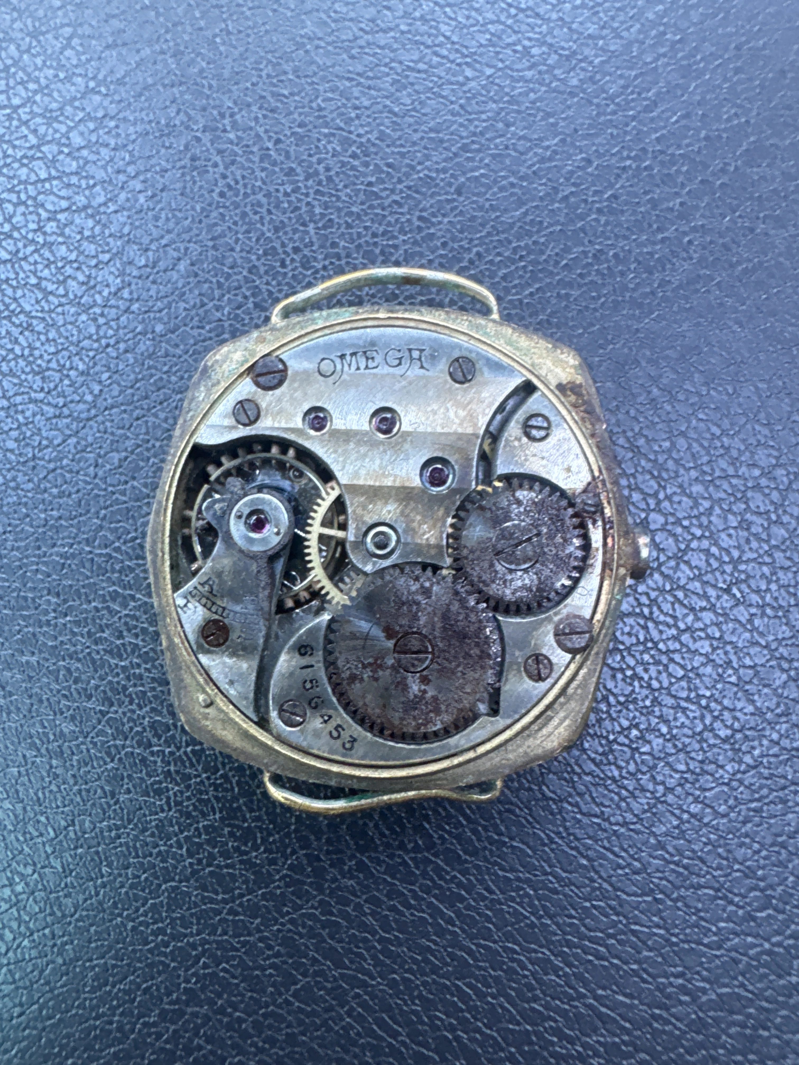

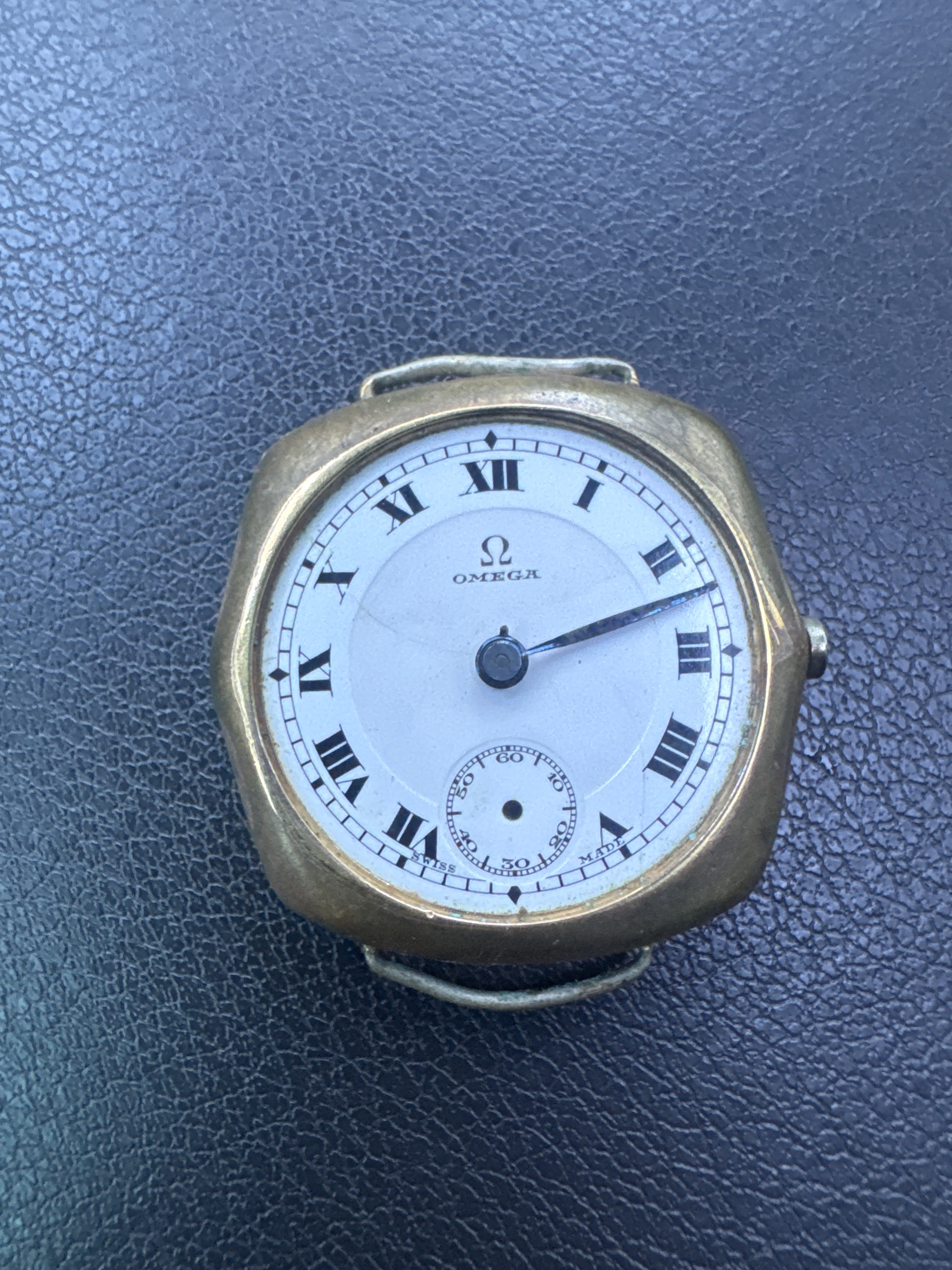

Help me identify the watch
178
51
Looks like an early omega but very bad condition
Probably only worth scrap gold value assuming it's likely 9k gold
17,939
37,516
Ladies Omega wrist watch, caliber 23.7 dating to about 1924.
Vitreous enamel dial with Roman numerals and blued steel "leaf" style hands, missing hour and sub-seconds hands.
Case is probably silver of some grade, picture of the inside of the caseback would help.
In it's current condition it's worth very little, cost to restore would be far more than the value of the watch, even if parts could be found.

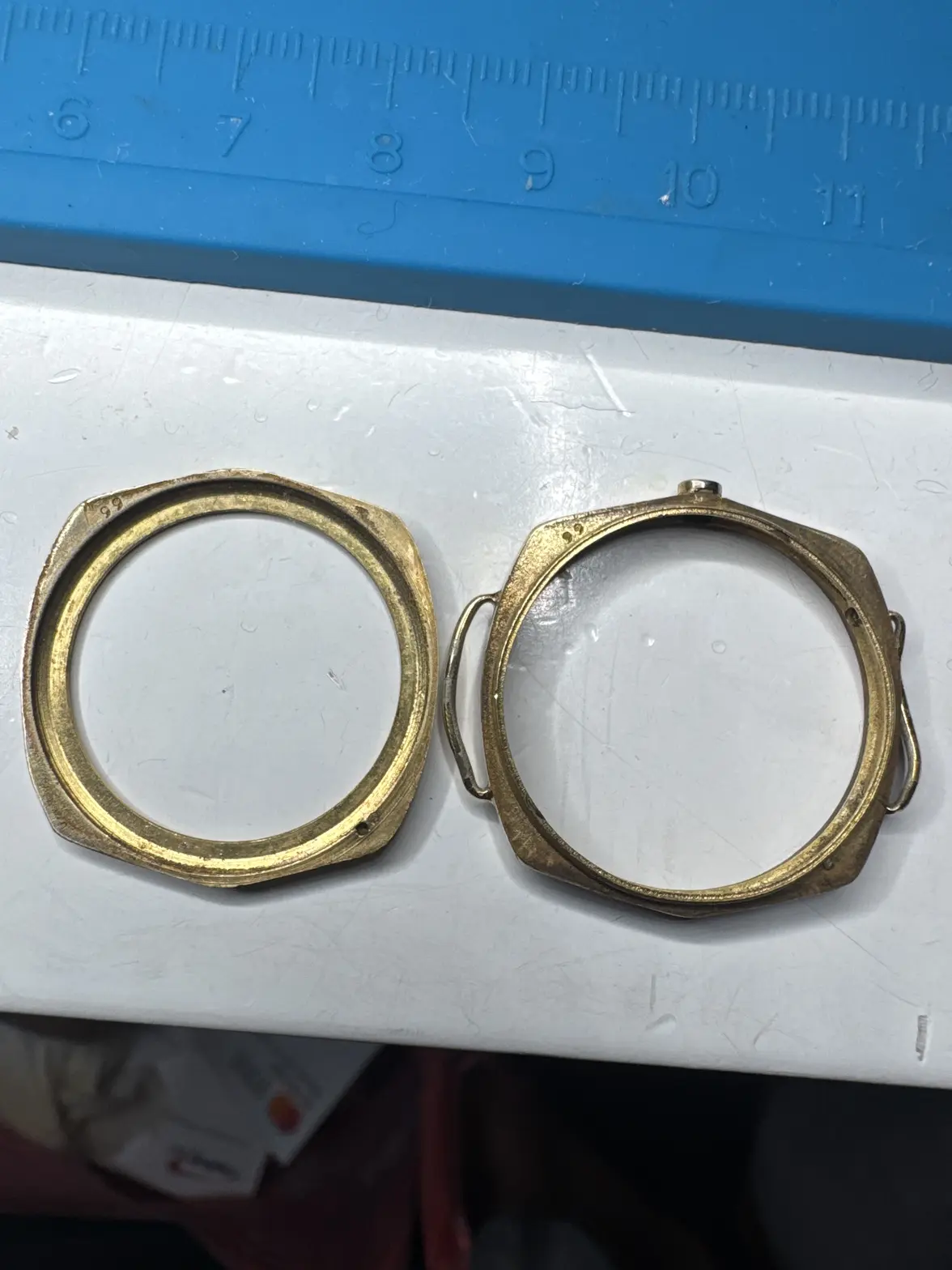

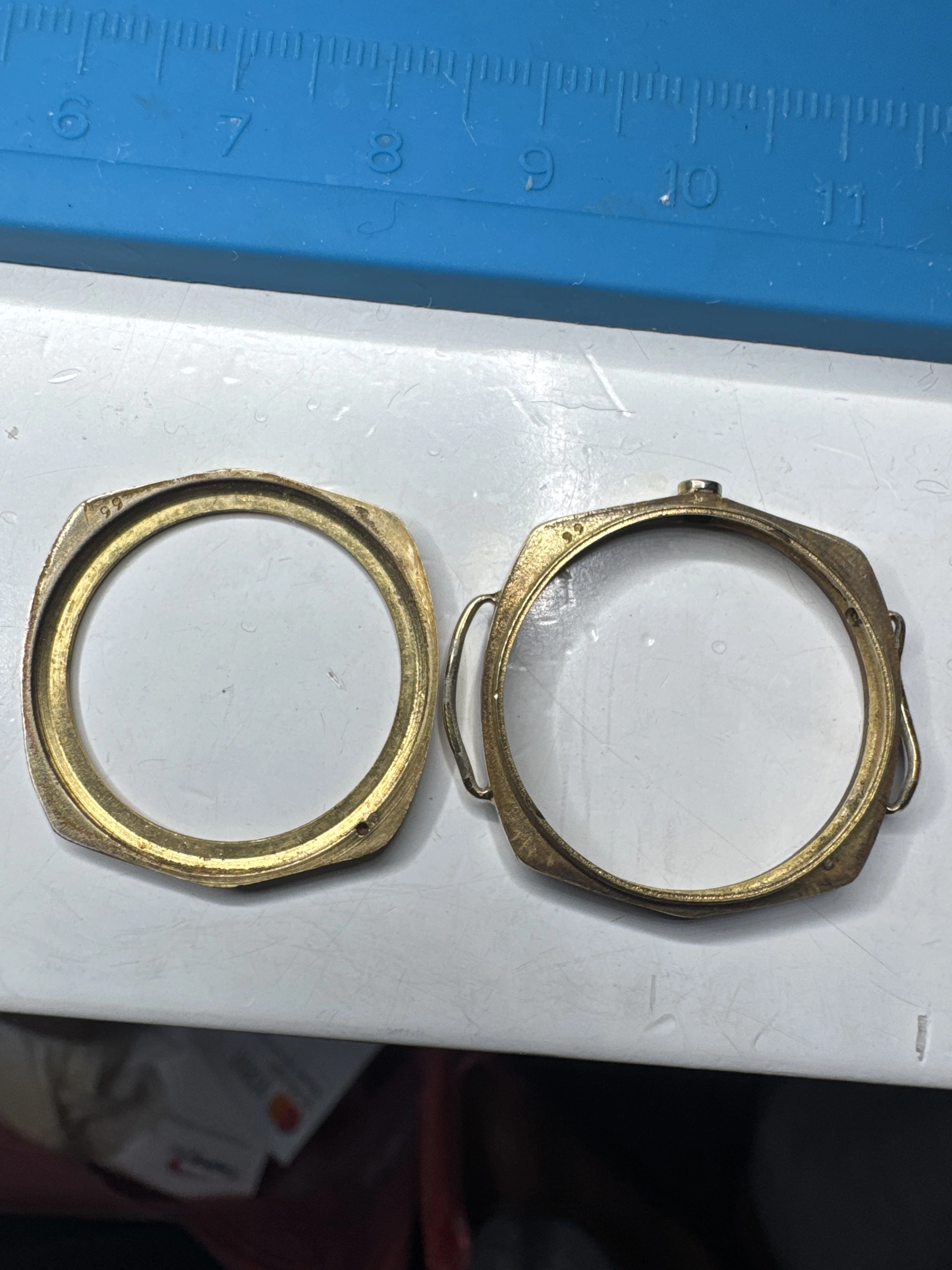

Unfortunately I don’t have the case back. On the bezel and case I see 99? Is that suppose to mean something
17,939
37,516
Just the case numbers so the hand fitted case and caseback stay together in final assembly.
