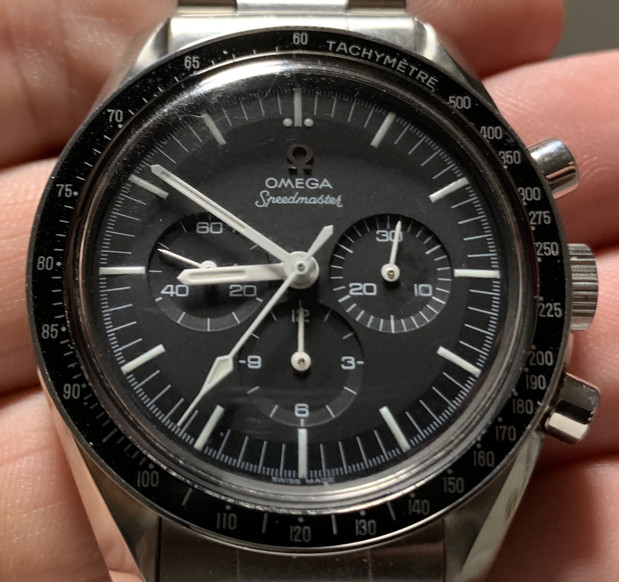

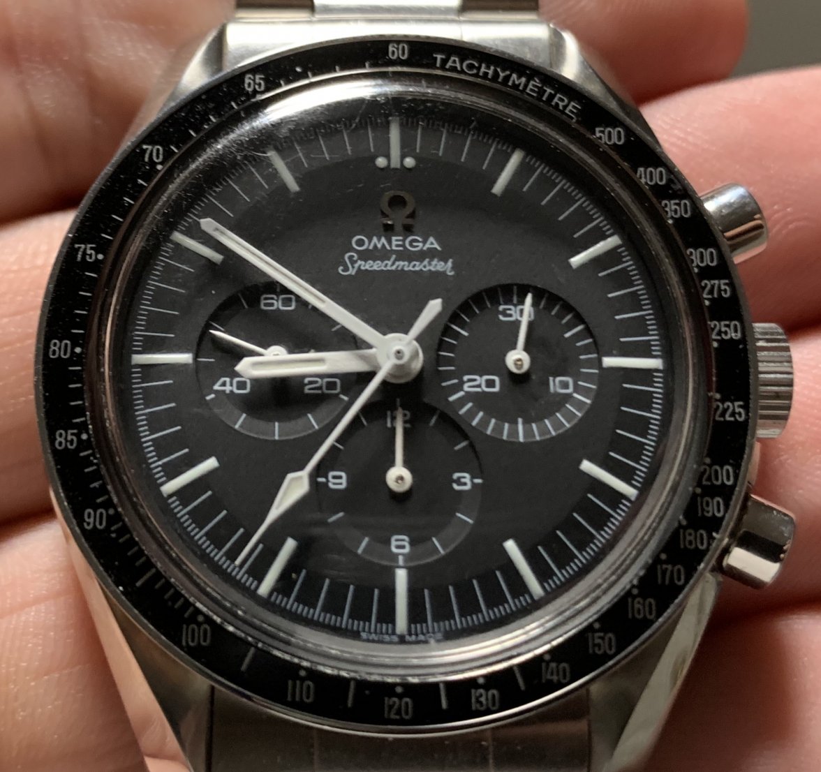

Picked this watch up this week, more of a curiosity than anything.
This is what I have been able to ascertain
Dial - 2998 or 105 service dial, unknown age
Hands - newer service part, unknown age
Case - 145.012
Caseback - 145.0012 (service part?)
Bezel - service part, DNN
Pushers - 2988 or 105
Crown - unknown
Bracelet - 1171/1 +633 70s-90s
Movement - 1983xxxx 105.002-62 ?
Would really appreciate input and feedback.
On the fence whether to keep this monstrosity or part it out. Thoughts?

My take:
The dial looks to be a modern SL replacement for the EW as you thought (see the lack of T marks) with no step.
Hands might be aftermarket but are certainly not for the Moonwatch (well maybe the chrono is) and also look to have SL lume.
Not sure about the case, might be 60s or it might be later, you can't depend on the caseback if that is clearly a replacement though you don't show a pic of the interior so its hard to form an opinion. An original one will have a year iteration, -67 or -68.
Bezel looks 1990s

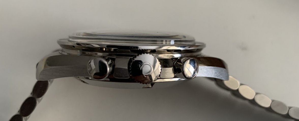

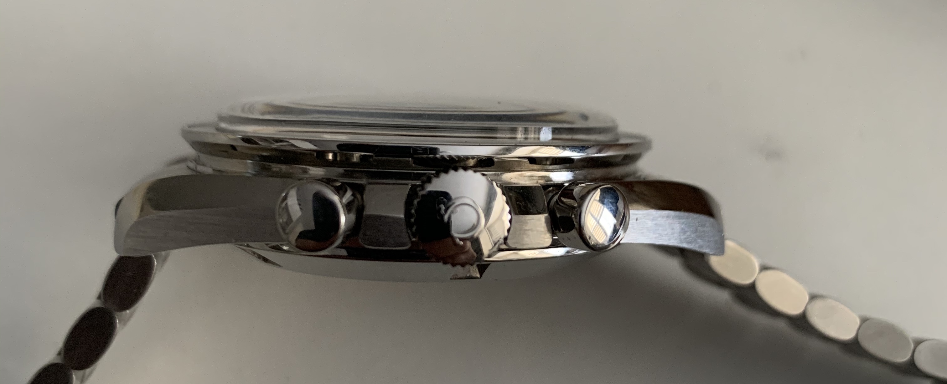

The pushers are current so post 1967, they are not the shorter 105.012 model.
The crown looks current. EDIT, it does indeed look like a 32 tooth as stated by Luca below, I would still prefer to see a 24 tooth flat foot on an untouched 60s watch.
The end links look modern, that is laser engraving I think. The 1171/1 bracelet was current in the 1980s so is older.
The movement might be from a 2998-62 or 105.002-62 but might also be from a Seamaster or DeVille I guess.
On balance, it could be either a very heavily modified 145.012-6X or just as likely a recent put together using a mix of modern service parts and some from the spares draw.

Crown looks like a B2 32 wide logo. These came out in 1967, so they should be correct for a 145012

Agree with @padders that this is likely a put-together. The the case-band, crown, pushers, and hands (although not Speedmaster Pro hands) look brand new.

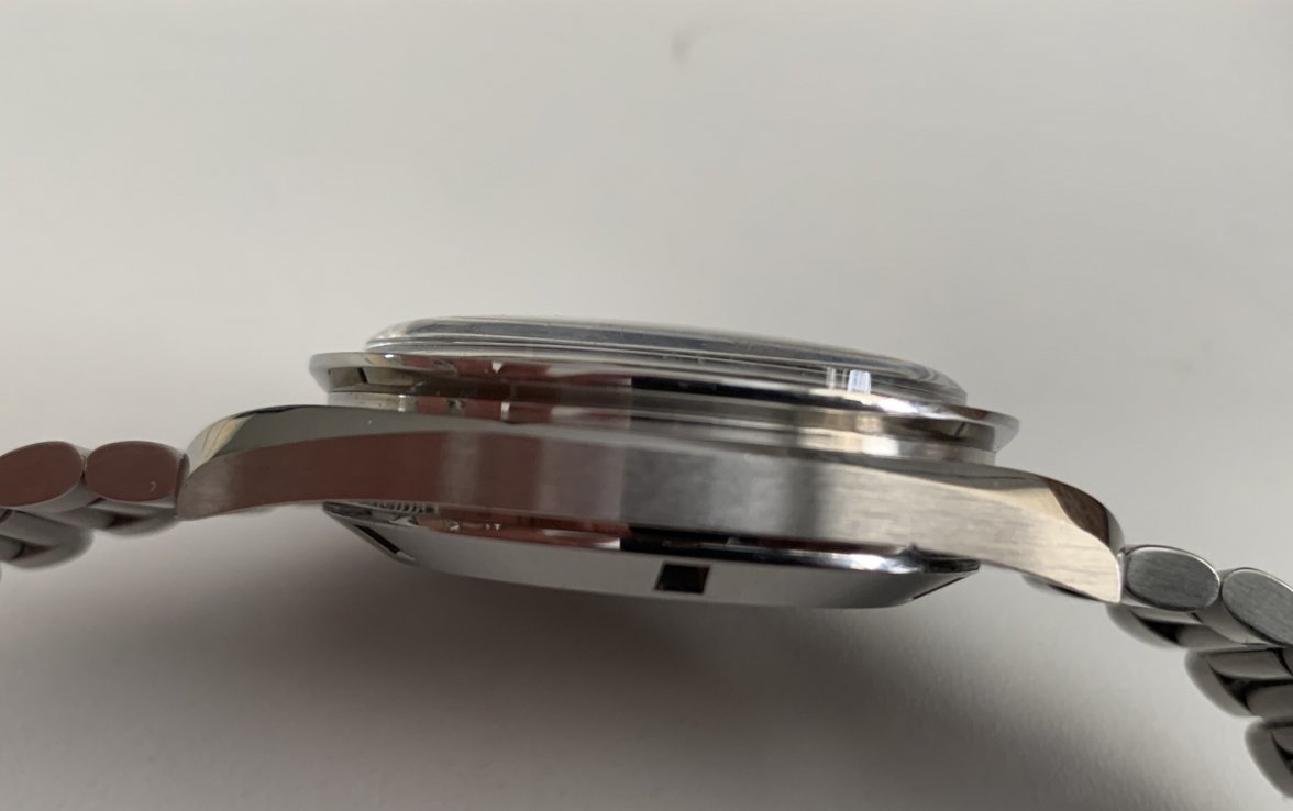

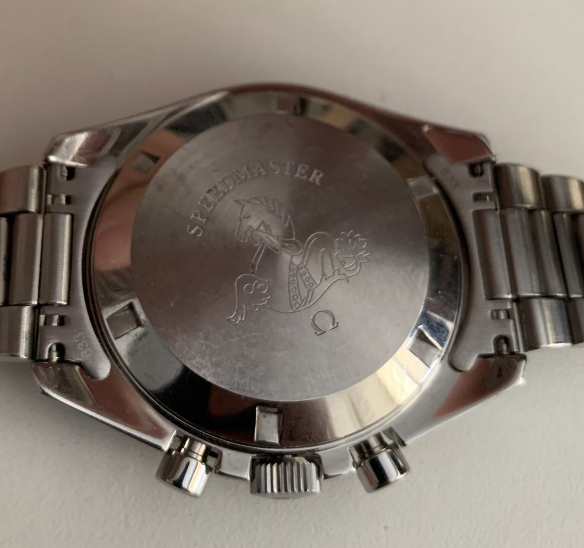

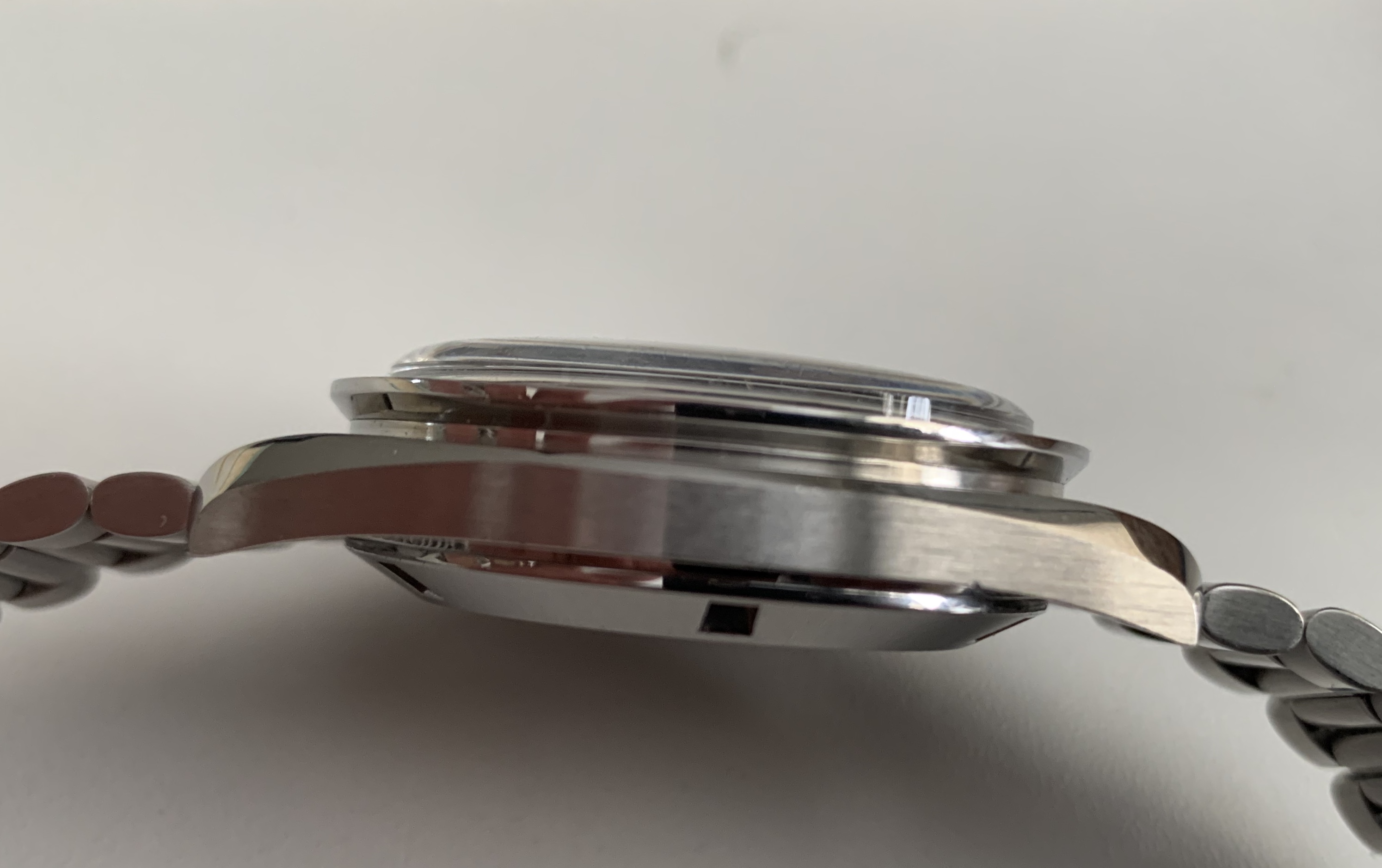

I wonder if the case is a 145.0012 service case? Lets see inside, and the left side profile.

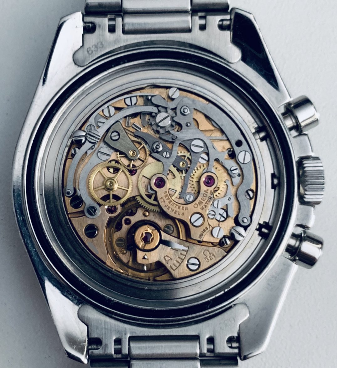

Photos added, thanks! I checked the omega website and they won’t provide an extract unless an image of the watch, description and serial all match.
Makes verifying the serial difficult.

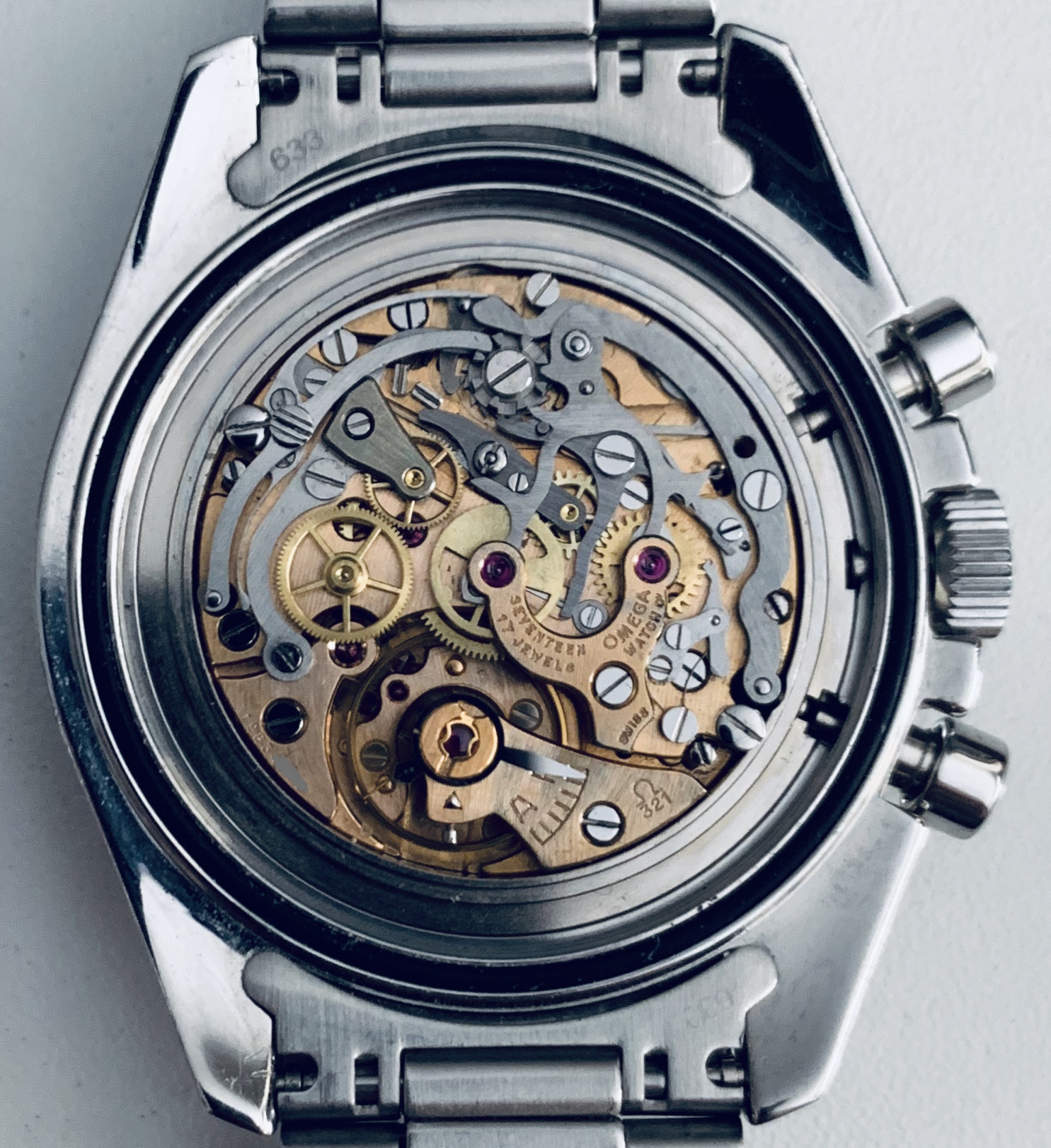

I would have expected a symmetrical clutch bridge on a 19m serial 321, maybe that has seen a bit of monkeying too.

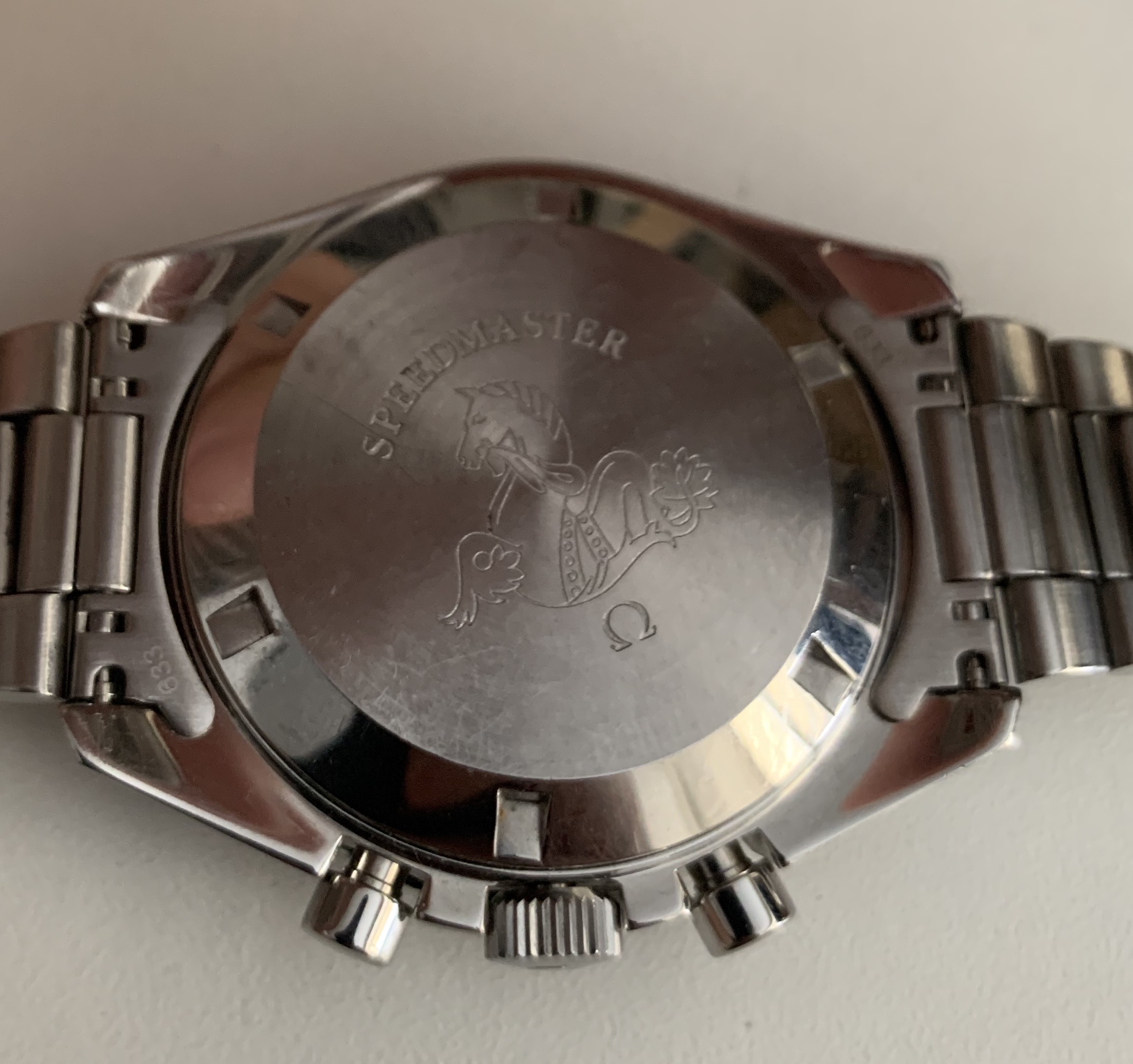

Do you have a photo of the inside of the caseback? That will help to identify if it is original or not.

Having seen the movement it’s not worth much except as donor for parts that can’t be sourced.
case looks more and more like a service, but let’s see inside the case back.
service case backs still fetch good money on eBay and the movement will be useful for parts.
Based on the shape of the key notches, i'd vote for a 145.0012 service caseback of newer production.
Edit: As mentioned by the OP.

The hands are current 321 service hands. The watch smells like factory overhaul with new 145.0012 case.

Hi Dan, I’m curious why the movement isn’t valuable, would you please take the time to explain? Thanks.

Well not really. I don’t think even the factory won’t put those hands on, nor will they change the movement bridge. I think it was assembled by someone who got hold of what he could.
The movement is clearly not original because of the asymmetric bridge which is not commensurate with the number, so either the bridge or the number is added - thus not original
So the movement can not be used as a replacement as it is incorrect for the number, and unless you can get an extract, it can’t be used to replace a bad movement once you change the bridge....see where I’m going?
The movement is only valuable as an original documented speedmaster movement.
If it were a complete and documented Ed White movement, it would be valuable, but in its current form, with replacement parts and undocumented, it's a parts movement. Again, that's not to say it has no value, but the value is limited.
