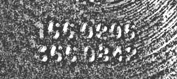

    I bought this watch, but I don't know much about watches (first vintage watch!). Anyway, I wanted to start to restore it or at least order the parts, some of the issues are that runs fast, the day/date doesn't change when it's supposed to and the crystal is damaged. Anyway, helping me ID the watch is the first step, so thanks in advance.

  3. ulackfocus Mar 4, 2012
    25,983
    26,972
    Hi Michael. Welcome to Omega Forums! The information you're looking for is in the pictures. The watch's reference number is on the inside of the caseback. I can't completely read it, but it looks like 165.0205 (which doesn't match up to anything so I must be reading it wrong). The bottom number probably starts with a 3, which would be the reference number if it were on a bracelet from the factory. You might need both numbers for ordering parts. The movement's serial number of 42,422,641 means it was manufactured in 1979.
  4. Trev The Architect Staff Member Mar 4, 2012
    1,892
    1,757
    What about 155.0205?
  5. Michael Mar 4, 2012
    5
    The back cover says 166.0206 and 366.0842
    Is it possible that its the wrong back plate?
  6. Trev The Architect Staff Member Mar 4, 2012
    1,892
    1,757
    Bottom number could be: 355 0247?
  7. Trev The Architect Staff Member Mar 4, 2012
    1,892
    1,757
    Well... the image wasn't much help. I was sure those were 5's :)
  8. ulackfocus Mar 4, 2012
    25,983
    26,972
    Not only that, you have more incorrect parts. The back plate is for a watch with an integrated bracelet, and the caliber 1010 should only be a date - not a day date. Some movement parts have been replaced also. It's what we call a frankenwatch.
