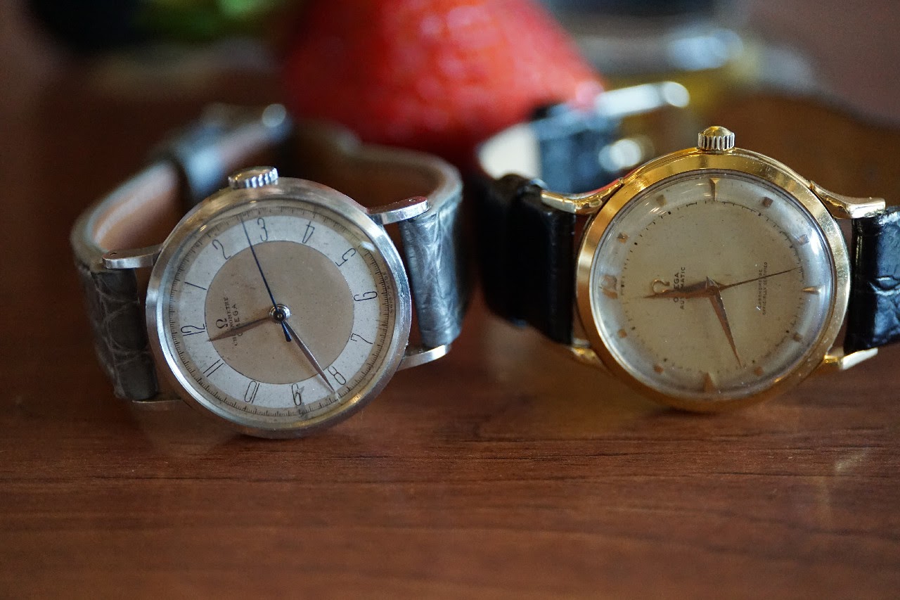

Here's one that belonged to my pal West Coast Bill.
[my 2365 left, Bill's 14311 right]
Sad to say Bill let it go earlier this year.

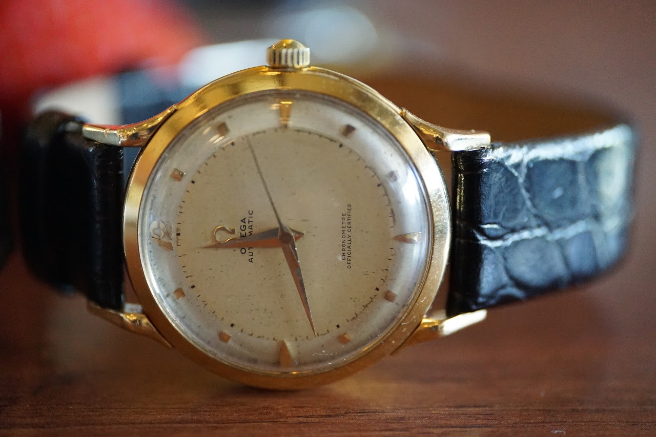

That’s a great shot of the markers. Thanks, Art!
Found another pic of Bill's ref 14311 . . .
. . . in my files.
