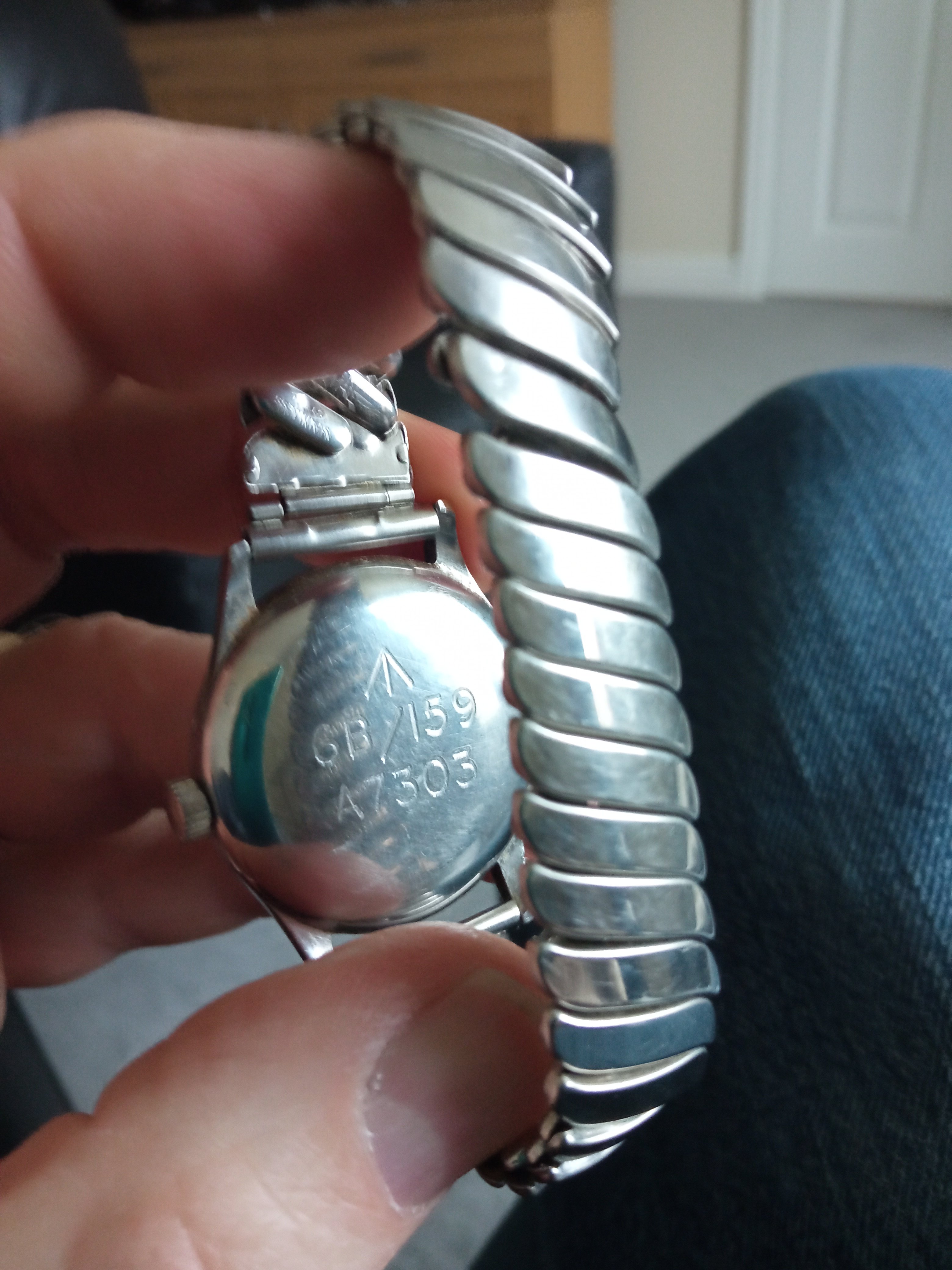

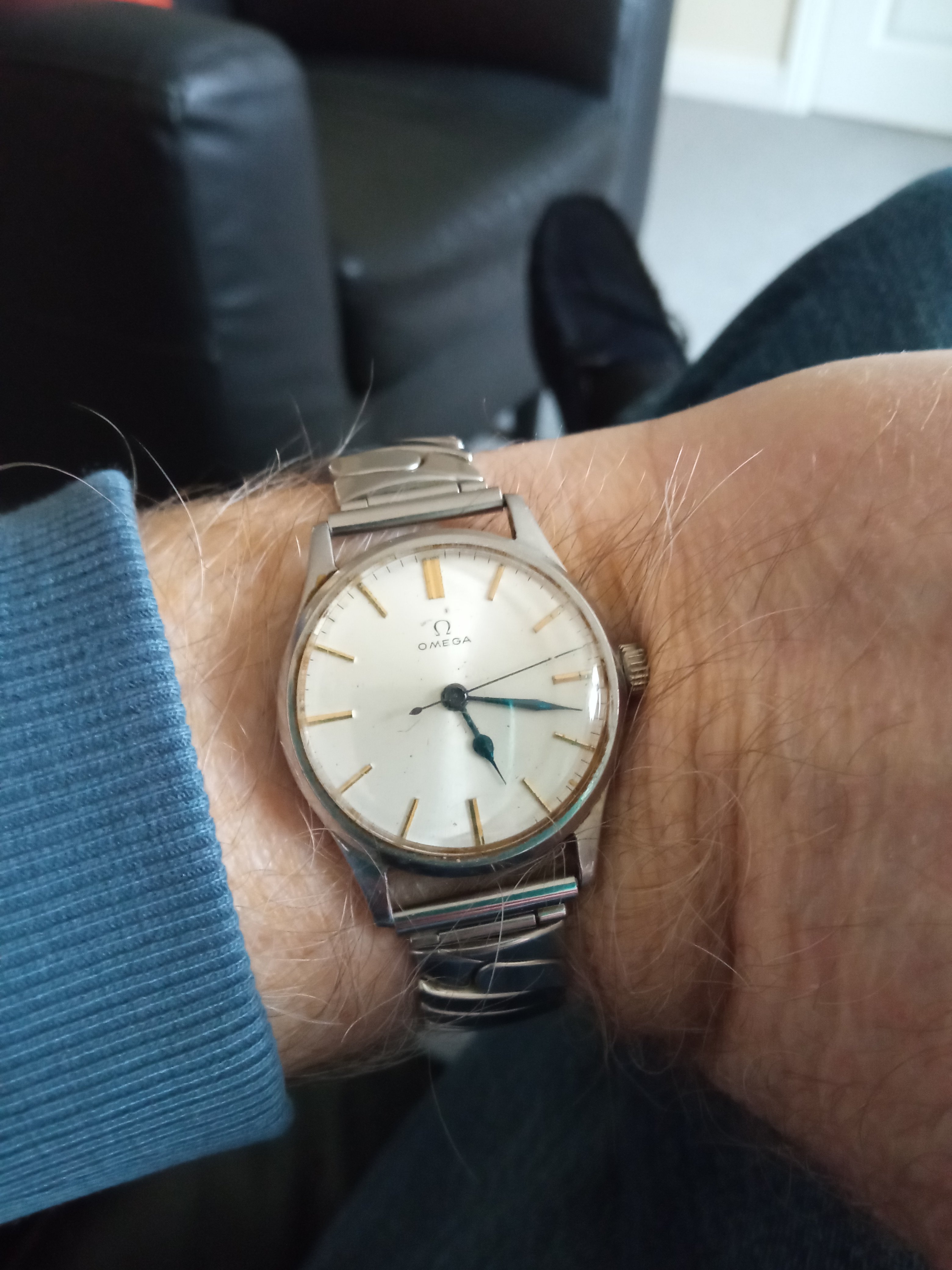

Clearing out my mother's house I have found 2 Omega watches.
I remember my father wearing one, a Dirty Dozen, but not the other.
Google tells me it's a Seamaster but the hands don't look the same. If I Google the numbers on the back I find watches with numbers on the face which this doesn't have.
Any guidance would be appreciated as this one runs!

Looks like a British Air Ministry watch that's had a completely different and period incorrect dial plonked into it.
Google "Omega 6B/159" and you'll find some info and the correct dial style

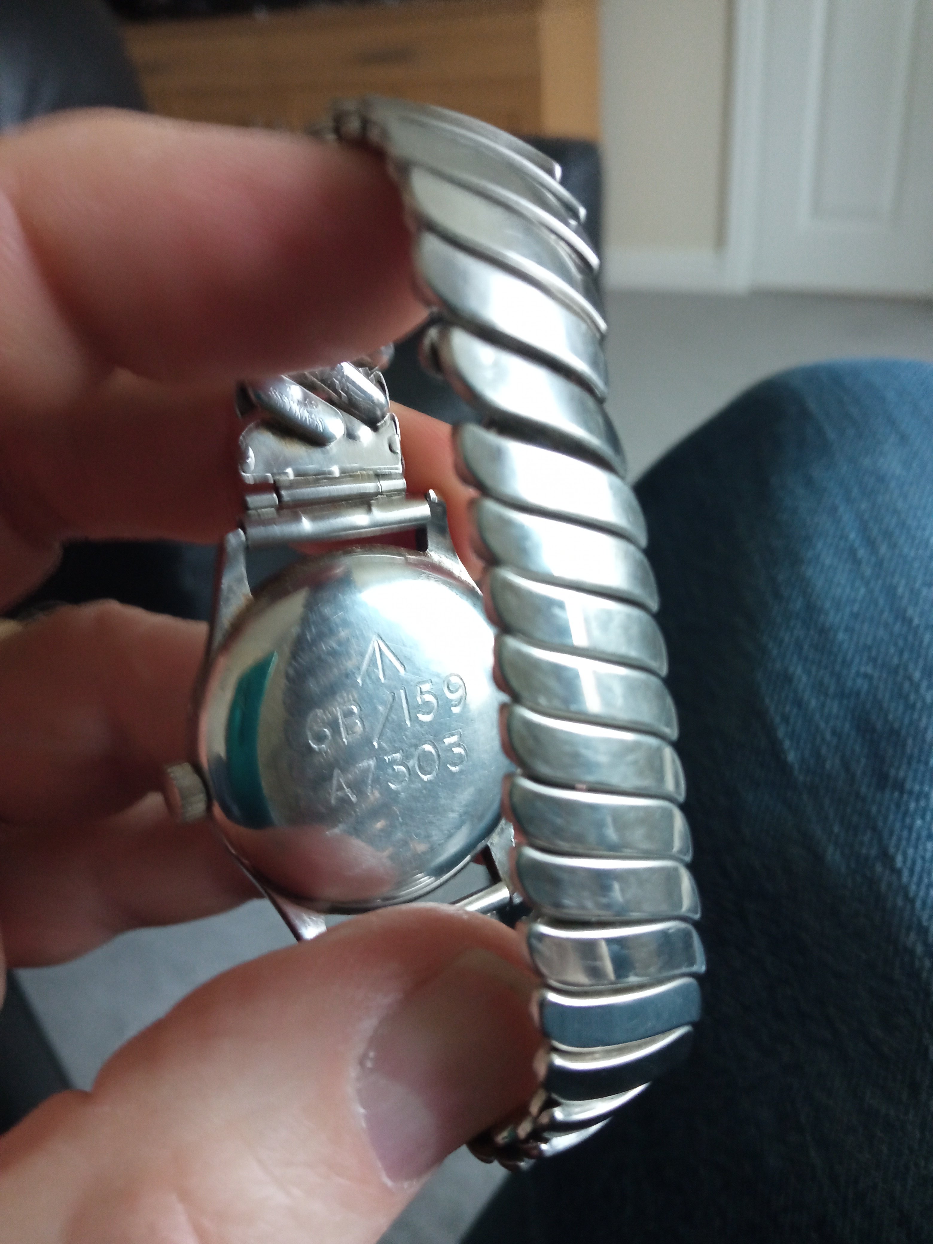

Thanks what is the significance of A7303?
Not much, really. It's the issue number, which was basically a serial number that the Ministry of Defence would have assigned to the watch as a way of keeping track of it.
Thanks. Much appreciated.

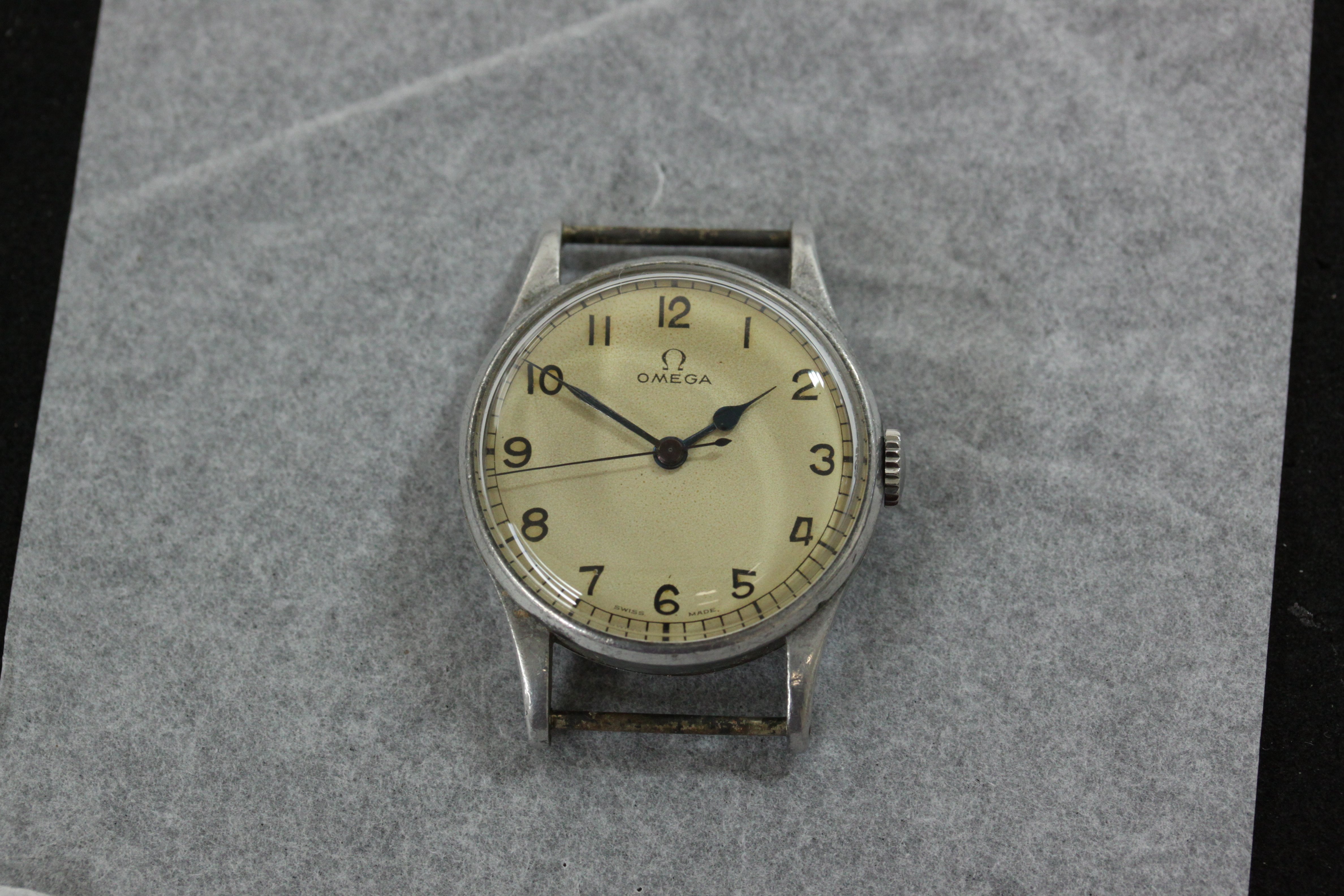

In essence yours started life as the RAF/AM equivalent of the Omega dirty dozen.
It's the other way round I think, the earliest were AM (Air Ministry) and the later had the WD pheon (broad arrow). All the Duralumin alloy cased ones were made around 1943, with some recased in the mid 1950s so there is a lot of mix and match. There were a few made in 1942 in all steel, those seem to have AM hence my feeling that text is earlier than the arrow. It may be that some were for general, non aviation use so had the Pheon but I suspect it changed at a point in time.
These had fixed bars originally by the way. The hands on yours are right for a 6B/159 I note.
Mine, currently being fettled in the UK:

The 1940s 6B/159 watches still in WO/MOD stores were recased in the mid 1950s into those steel WWW style cases you refer to. The reason for this may have been that the originals have zero water resistance and the Duralumin alloy mid case originally used is not as hard as steel though mine is in good nick so some have survived well. AFAIK they repeated the original 40s case markings onto the recased examples, hence you'll see both AM and pheon type. Well that's my take anyhow. My watch is with Mika who has had to replace the balance staff and do some other stuff, not too surprising on a watch 80 years old. That's his pic above.

Could be wrong on this one but the tip of the minute hand looks to be broken 🙁
10,823
16,841
Could be, it's shorter than mine. Good spot.
Probably broken by the sloppy watchmaker that replaced the dial...
