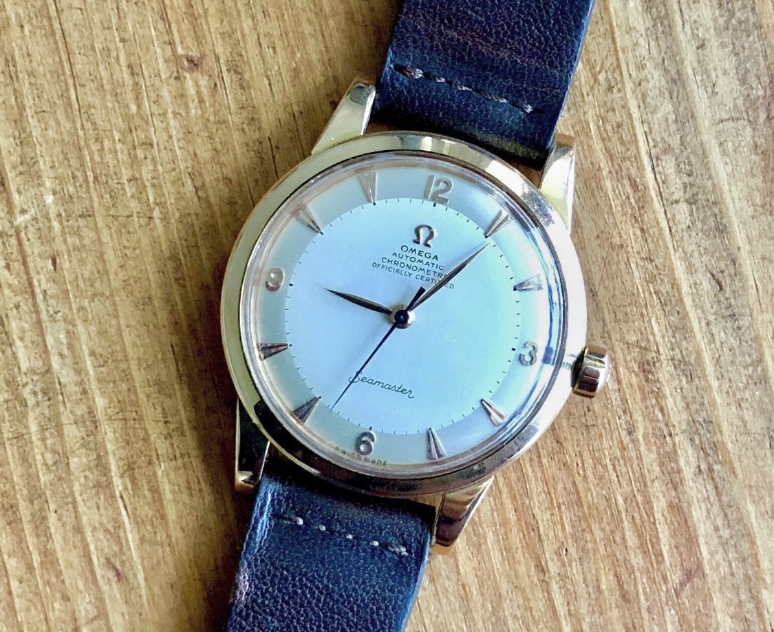

Help identifying this Seamaster
4
My father just gave me his father's old Seamaster watch. I've been doing a lot of internet research but have been unable to find this exact watch. It says "14k Gold Filled L&K" on the back. There's no other markings. Still works, keeps great time. Any help with identifying it, when it was made? I'm guessing the 1950s sometime? Thanks!

American market reference G6250 early to mid 1950s, caliber 354 (351 possibly).
Case maker, L&K - Lutringer & Kammerer.
There were many different dials offered on this reference so finding an exact match may not be possible.
If you intend to wear it have it serviced.
4
Thank you so much! The fact that it had many different dials explains why I couldn't find a match in all my searching.

However this seems to be a redial. The font and then the seamaster is not straight..plus minute track
8,174
36,709
The dial looks good to me...I don't see anything worrying at all, in fact it's in very nice condition.

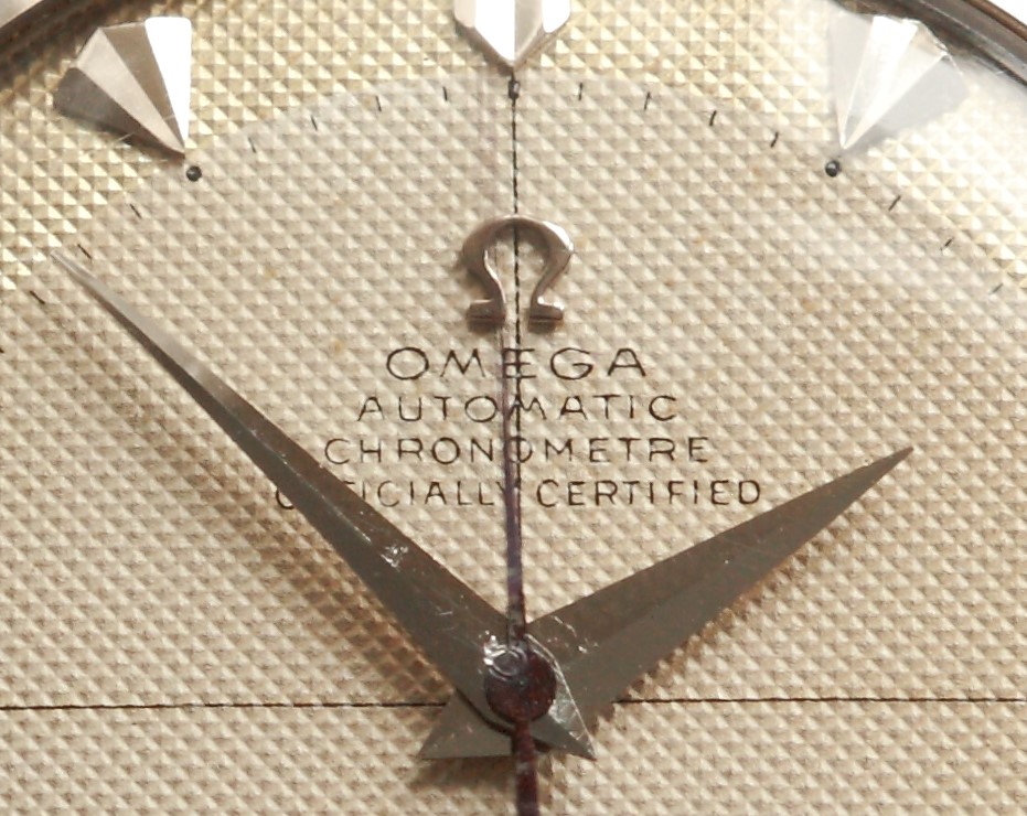

Here's the same font on a contemporary Constellation

Oh sorry, i was refering to the "seamaster" which seems to be sloping. I am far from being an expert and maybe it s just the angle of the photo.
1,208
5,038
Yep, good reminder that I am still a noob. 😲
Yep, the photo was taken slightly askew (look at the top lugs).

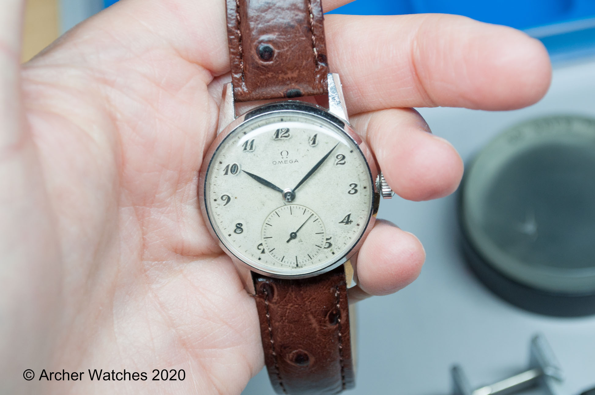

Leaf hands and Breguet numerals are a pretty normal combination, so for example the manual wind Omegas have used this combination before:
I do admit I've not seen it on a Seamaster though...but I wouldn't be surprised if this was correct.

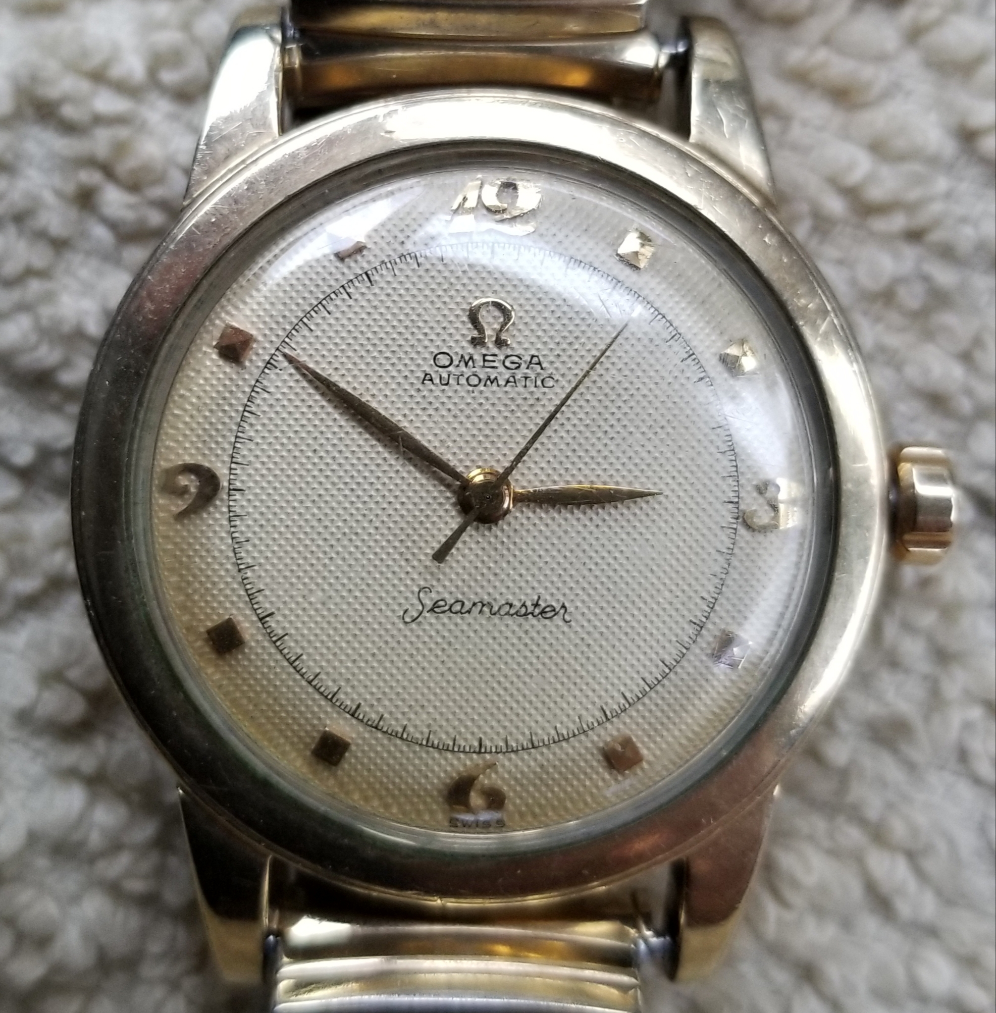

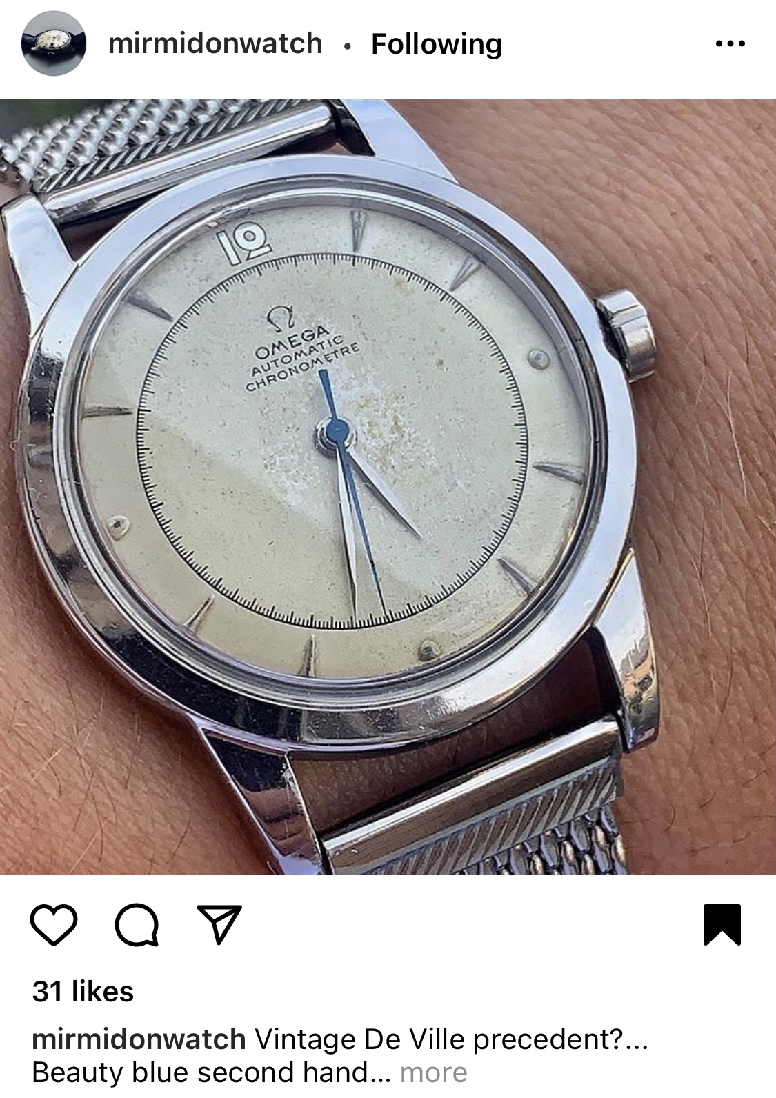

I’m generally in alignment with this..
However, I’m thrown off by 1) this image from the Omega 1948 line promo materials:
2) I’ve seen them before on “real” watches, I just don’t know that they’re original. Interestingly, these three also all feature fairly uncommon “dot” markers at the five minute marks, which style wise align with the idea @Syrte mentioned above. However, the 1948 Seamaster watch doesn’t align with this.
