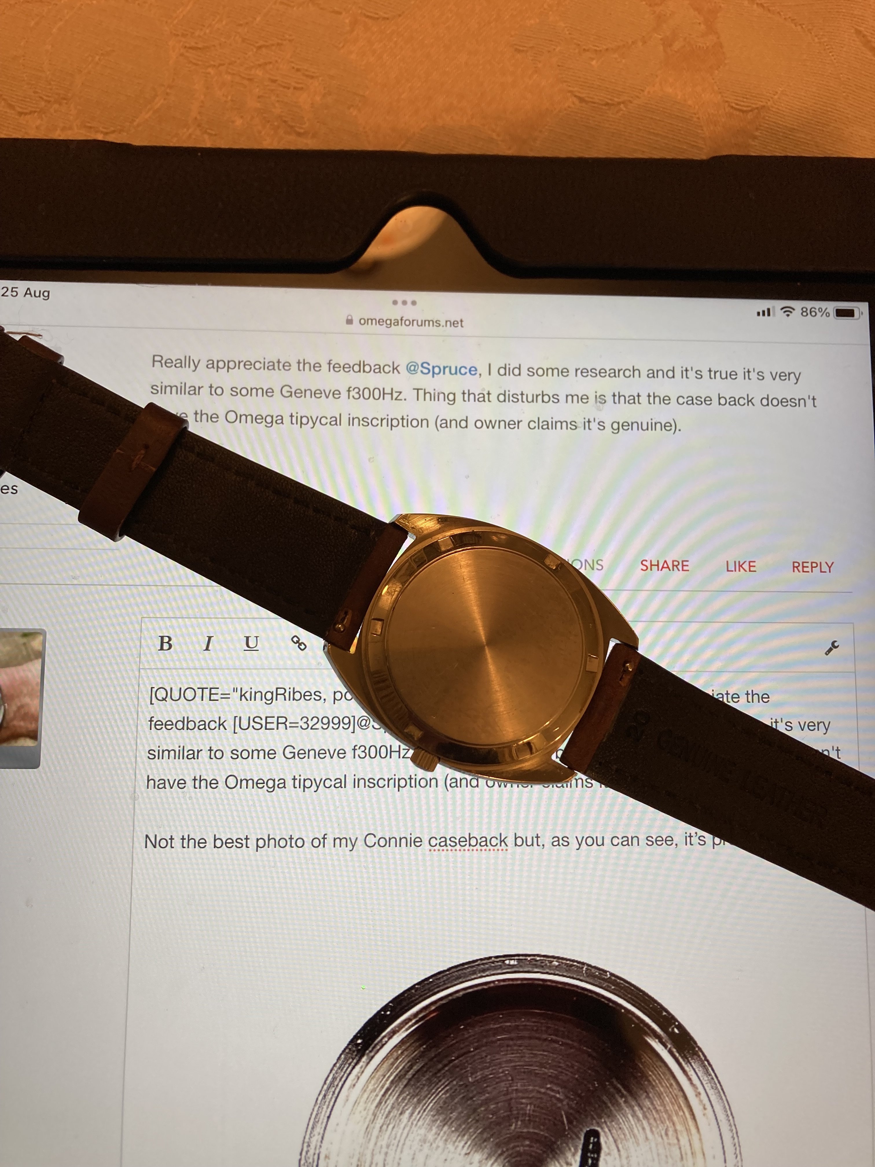

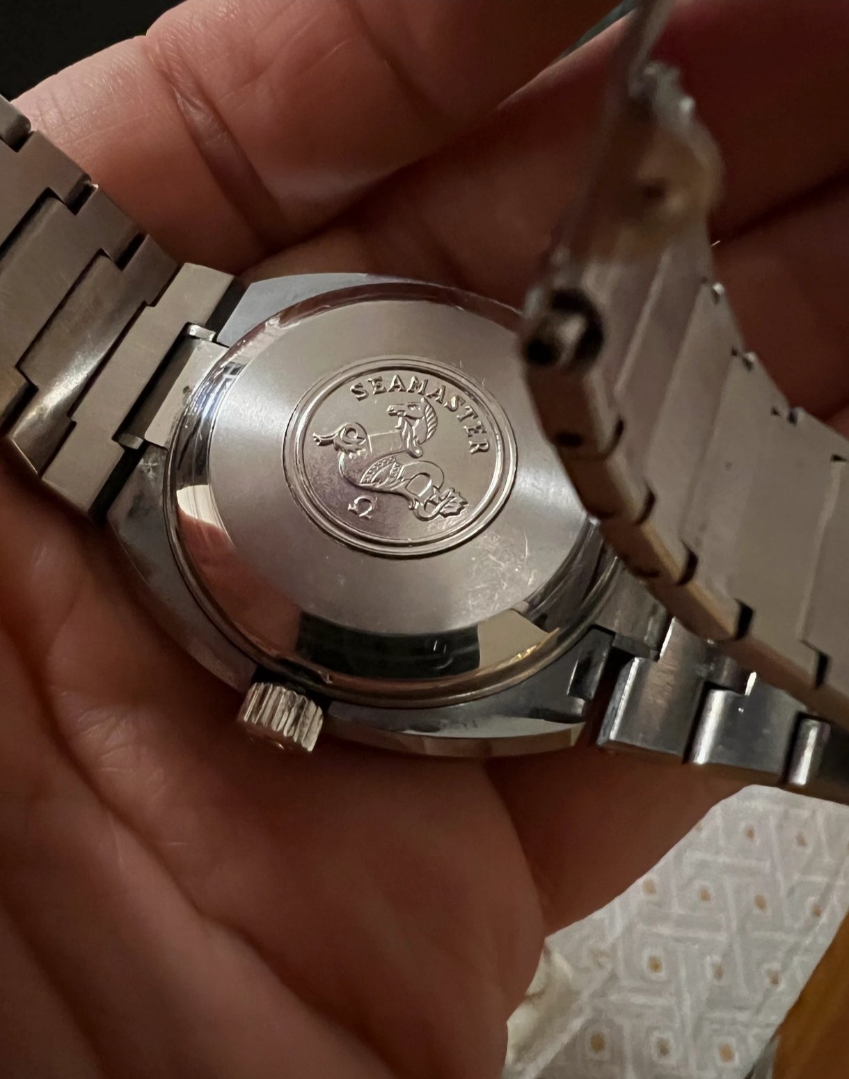

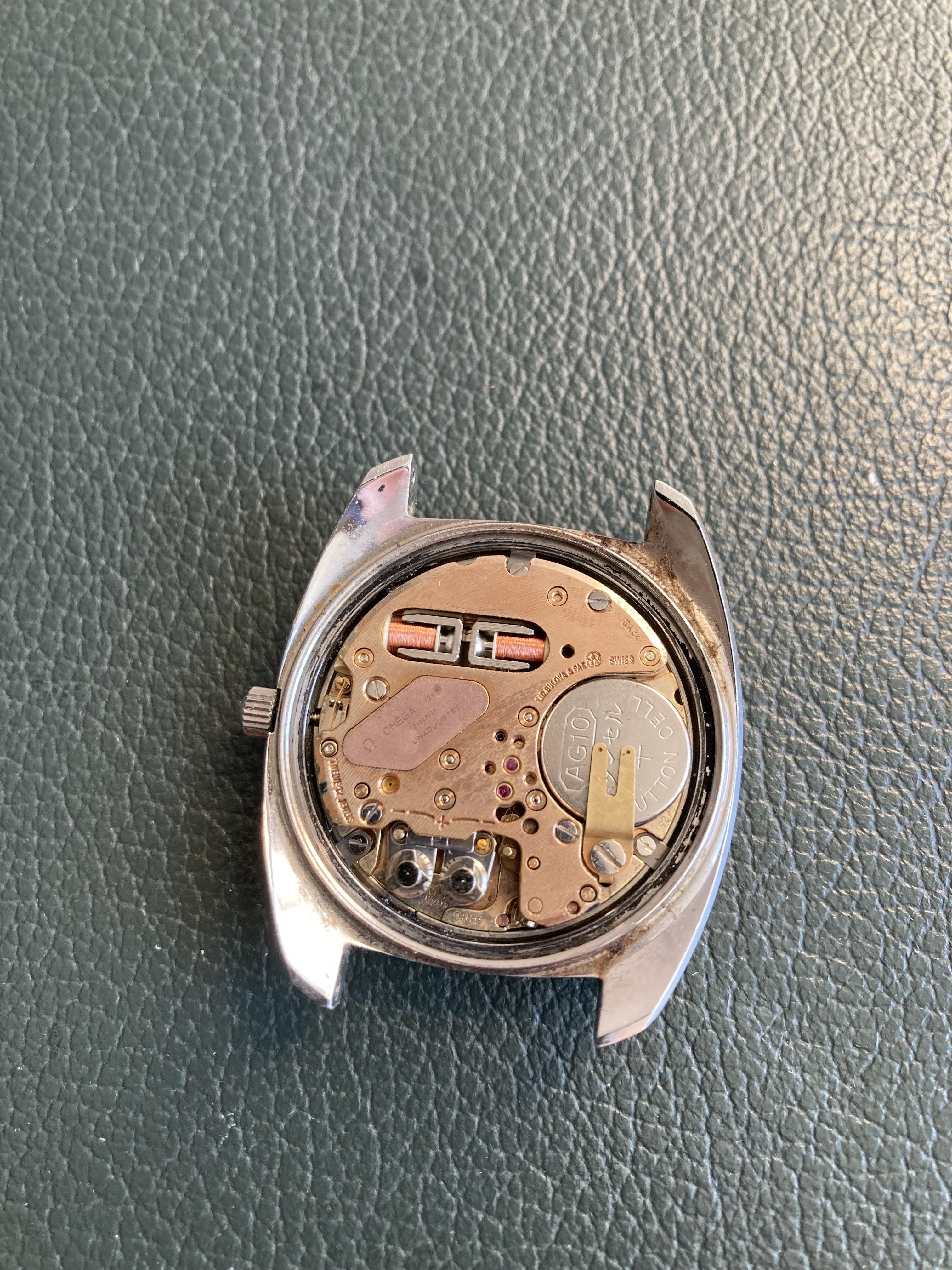

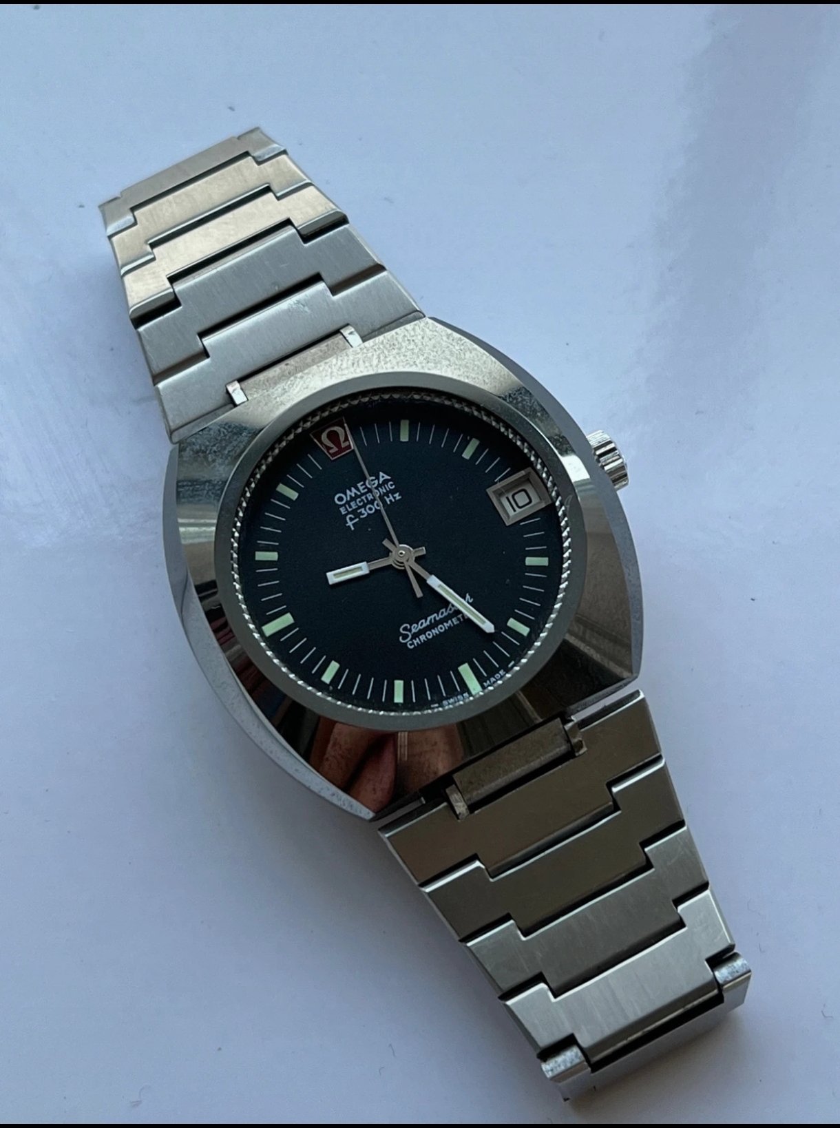

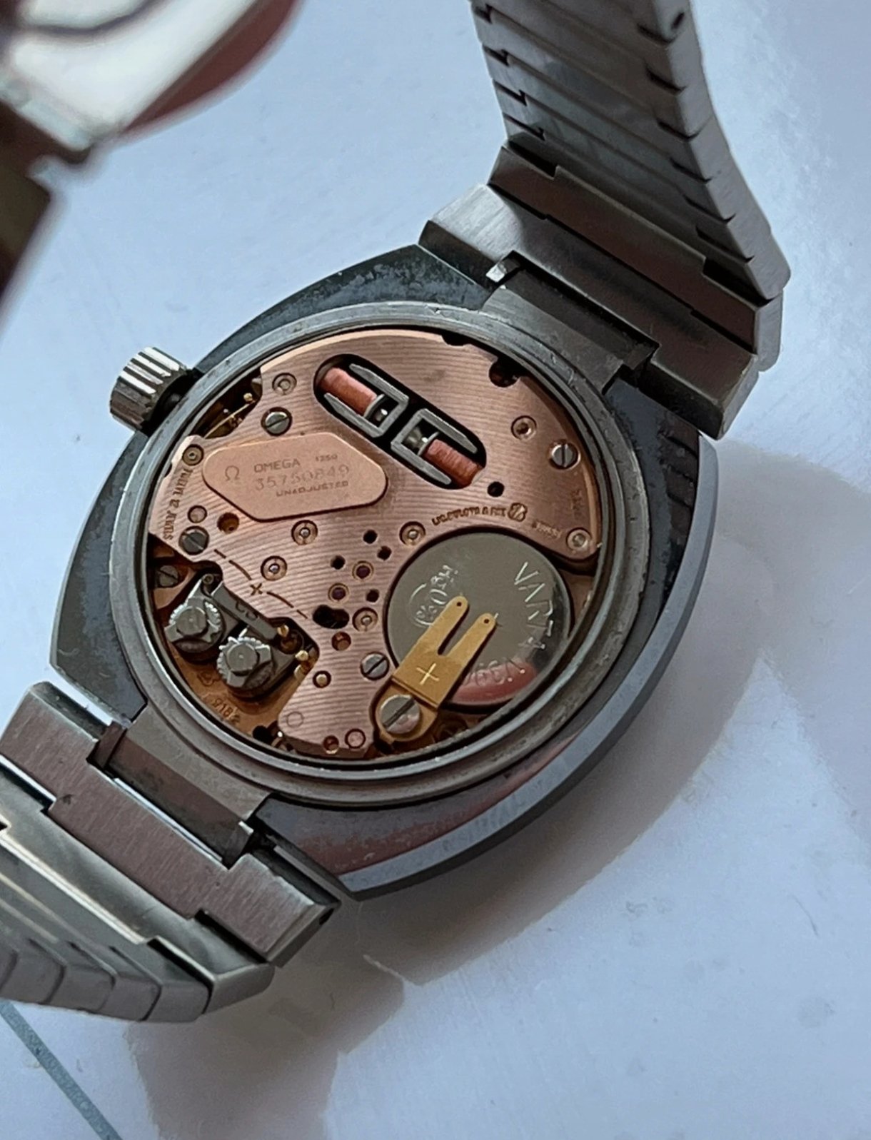

Hello OF! I'm negociating for this Omega Seamaster f300Hz. Looks great, but the backplate is not original, can someone help me identify this watch (and maybe find the ref. number)?. It's a 1250 caliber, I leave some photos here.
Thanks y'all in advance!!
16

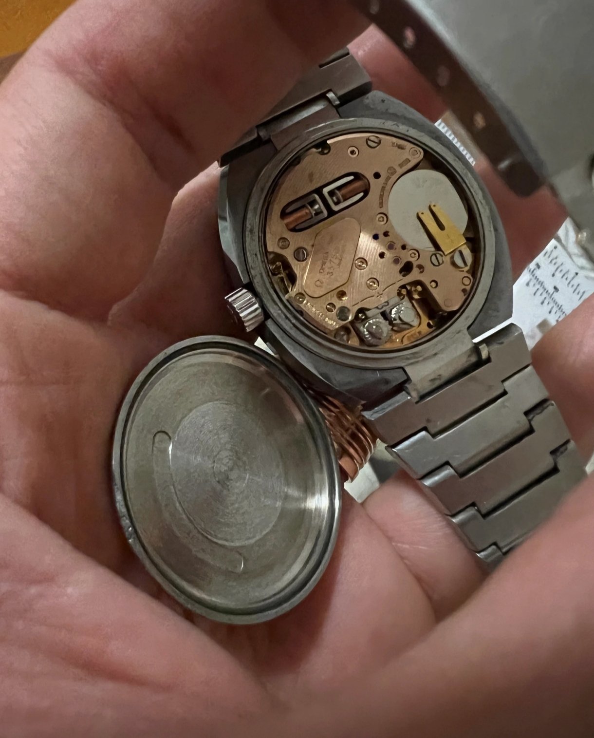

Edit: apparently back is genuine, but it doesn't have the inscription with the reference number. I have never seen this type of situation. I'm leaving some photos here.

Looks nice but these hummer’s always go for less than you’d think because of the difficulty and cost of service and repairs.
The bracelet is a bonus

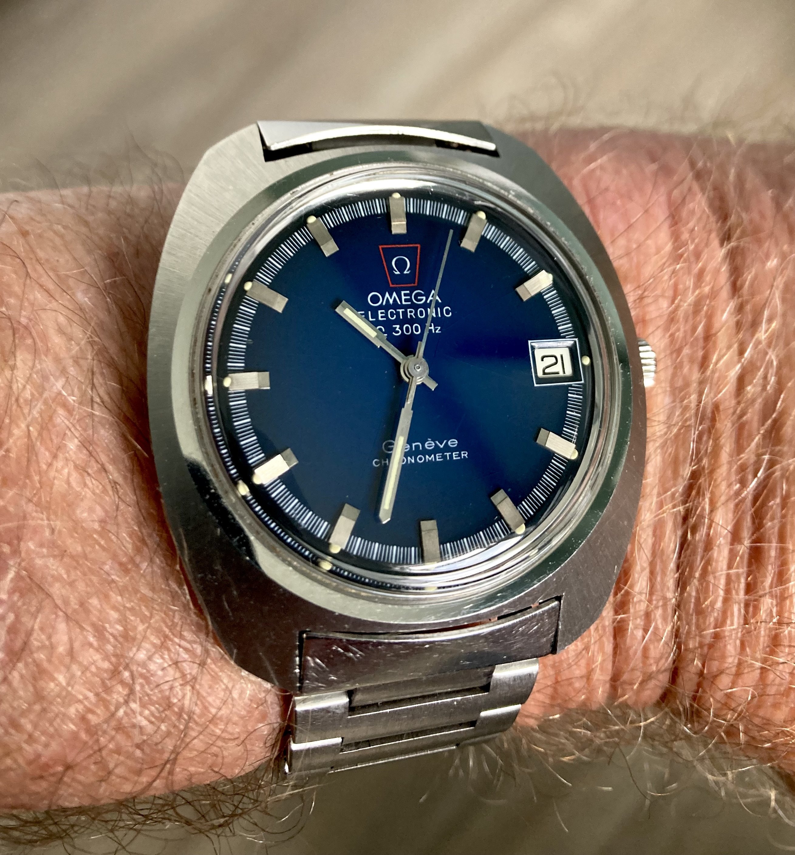

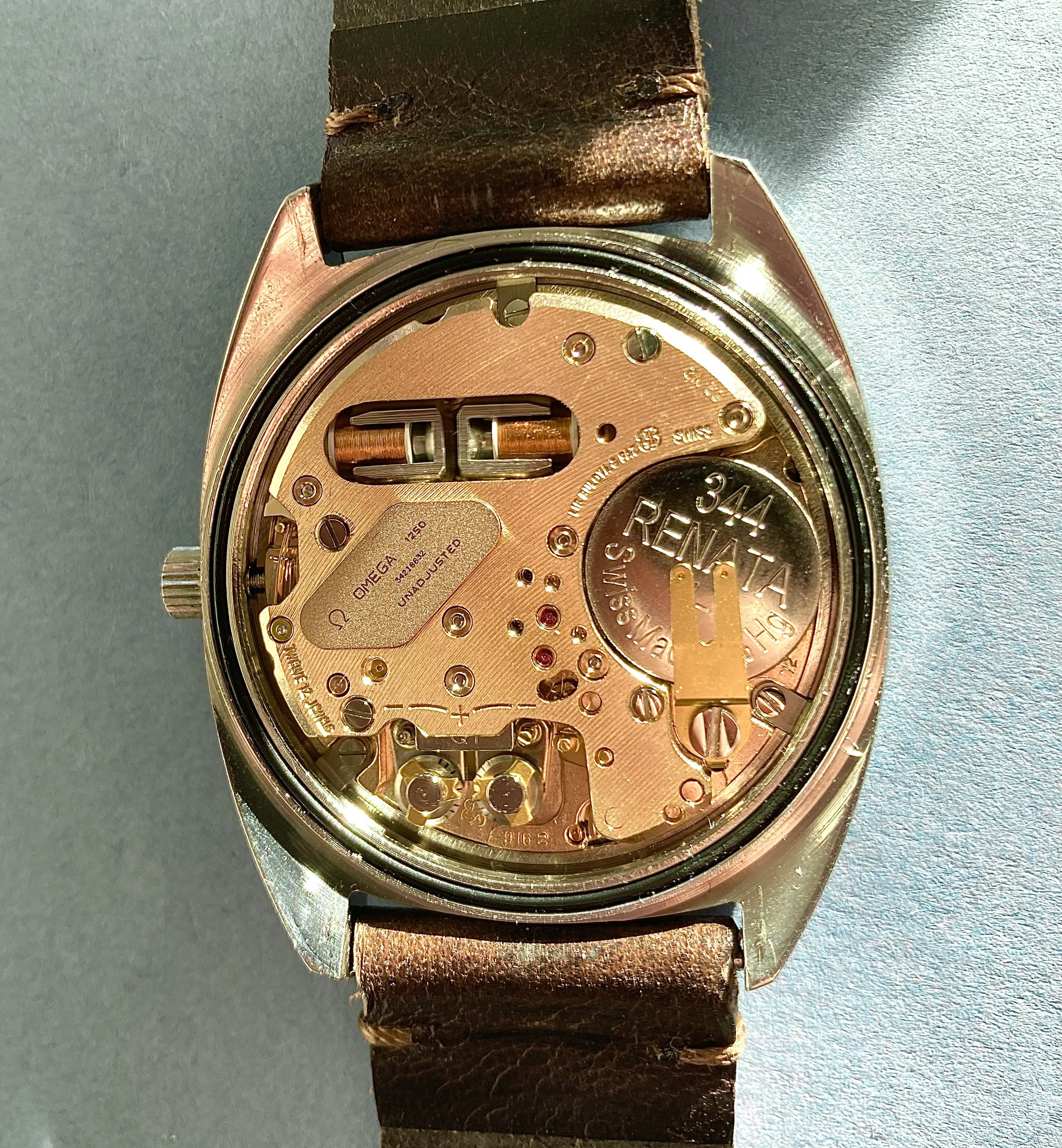

I have two cal 1250s, neither with the same dial as yours but my Genève is similar

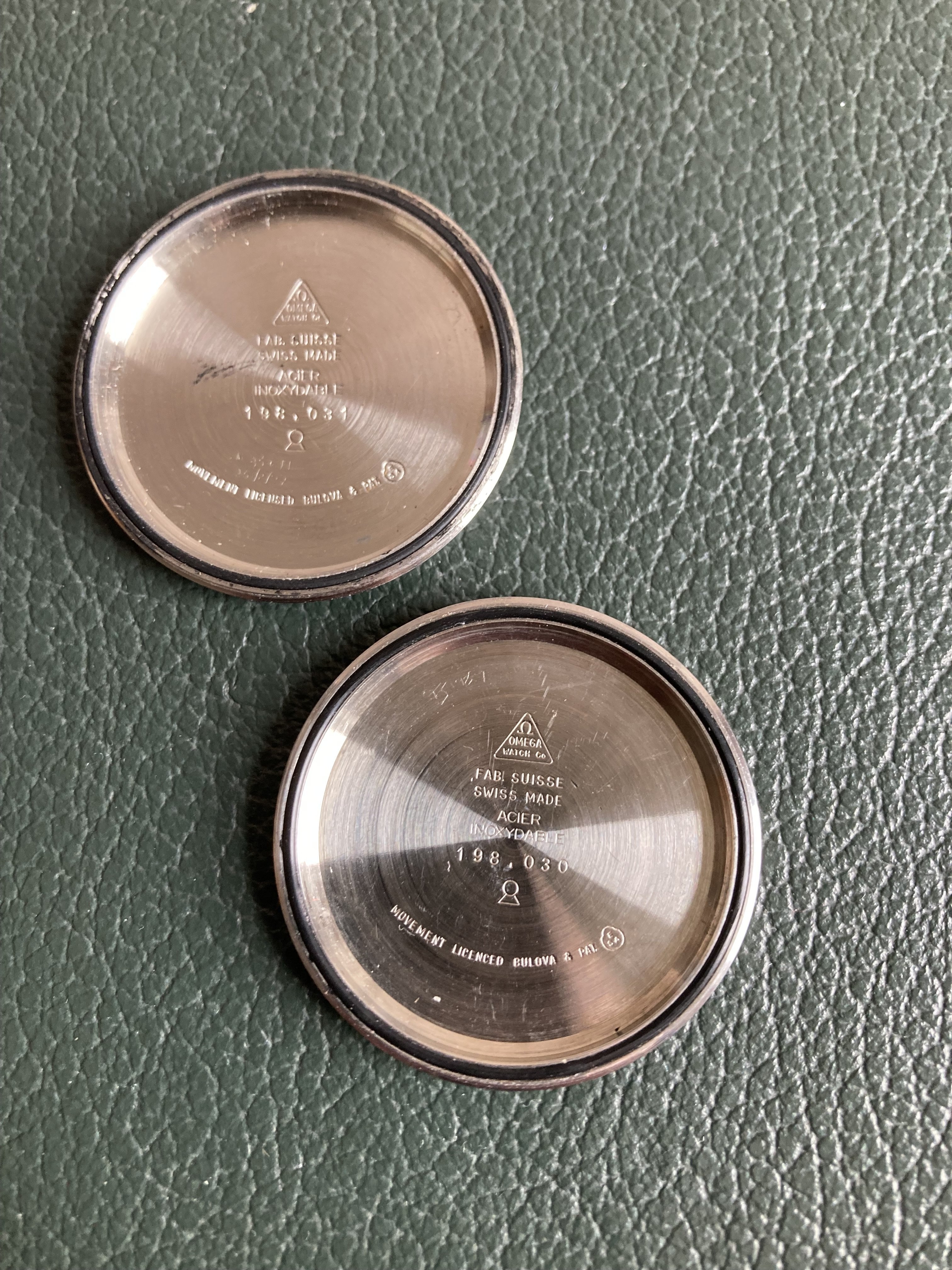

Mine is a 198.030 but it also had the wrong caseback. I bought the correct one on eBay but now have a spare 198.031 although it doesn’t have a decorative caseback.

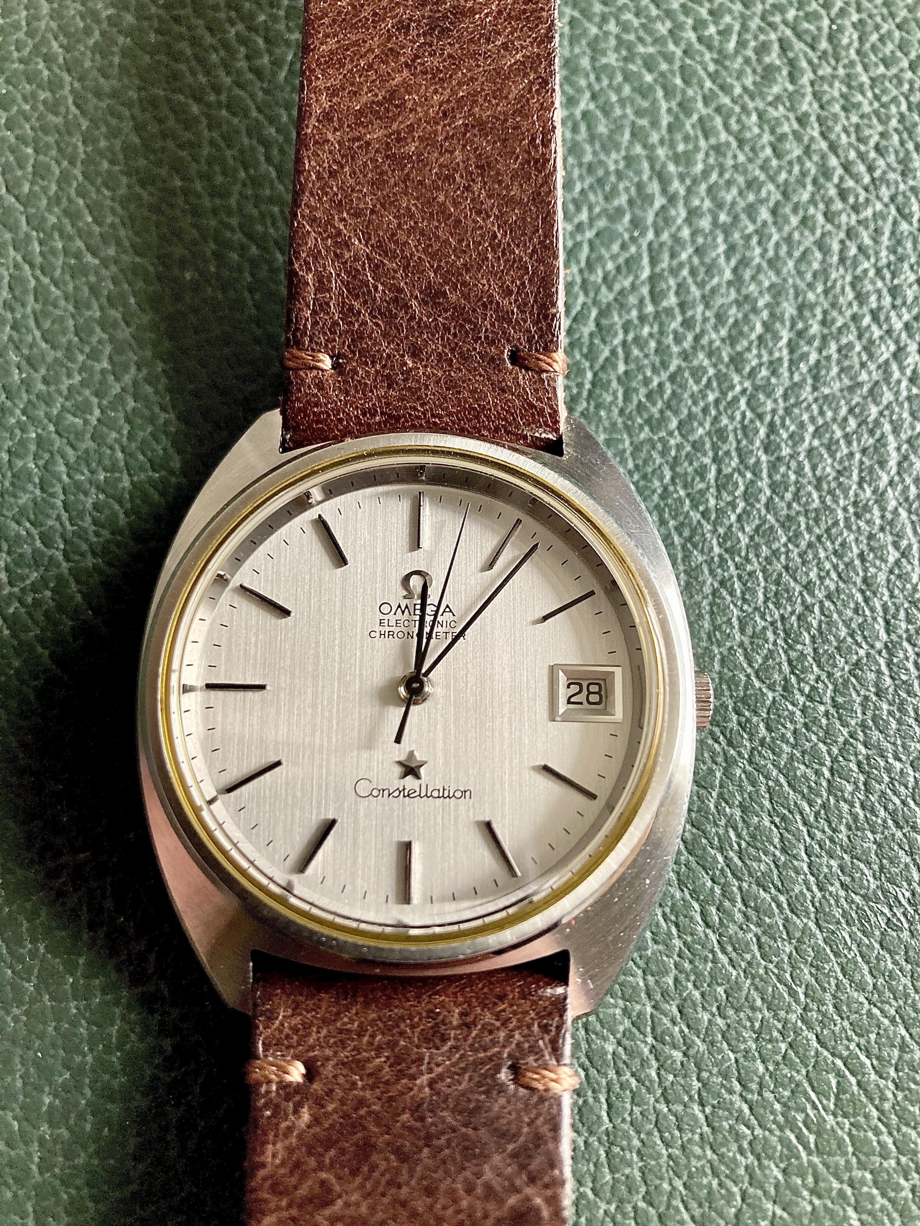

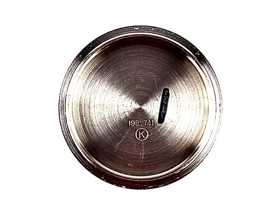

I also have a Constellation 198.741, again with a cal 1250 but the original caseback also has no decorative back

Really appreciate the feedback @Spruce, I did some research and it's true it's very similar to some Geneve f300Hz. Thing that disturbs me is that the case back doesn't have the Omega tipycal inscription (and owner claims it's genuine).

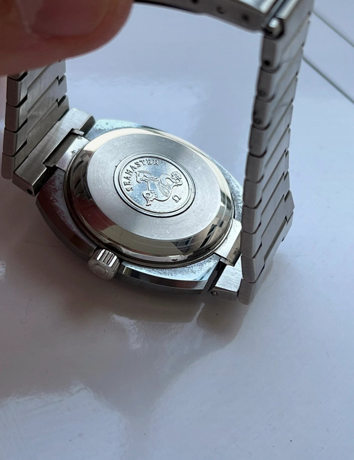

Not the best photo of my Connie caseback but, as you can see, it’s pretty atypical and I’ve just snapped the actual back and it’s unadorned (and stainless steel despite the lighting).
