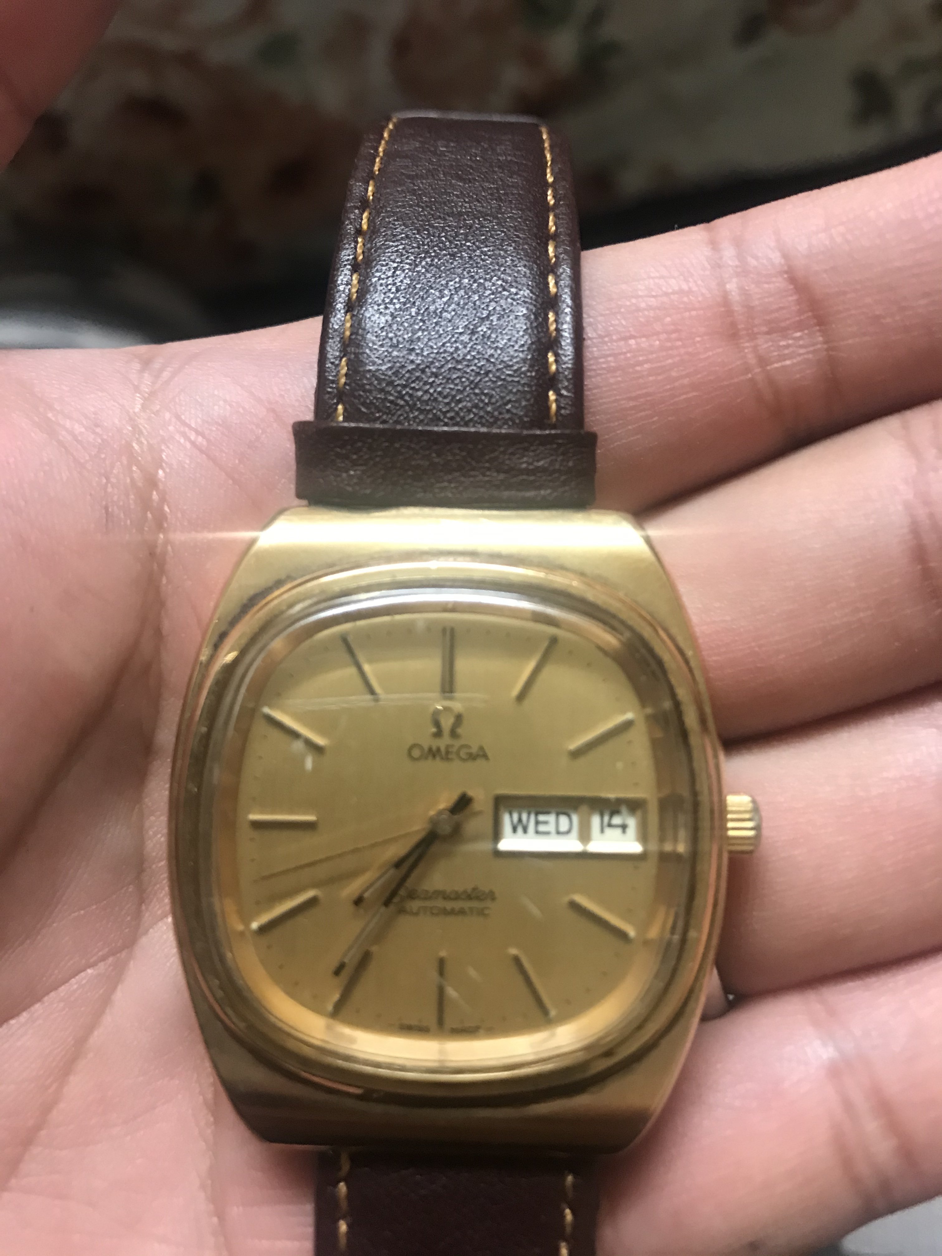

Help identifying seamaster watch my mom gave me

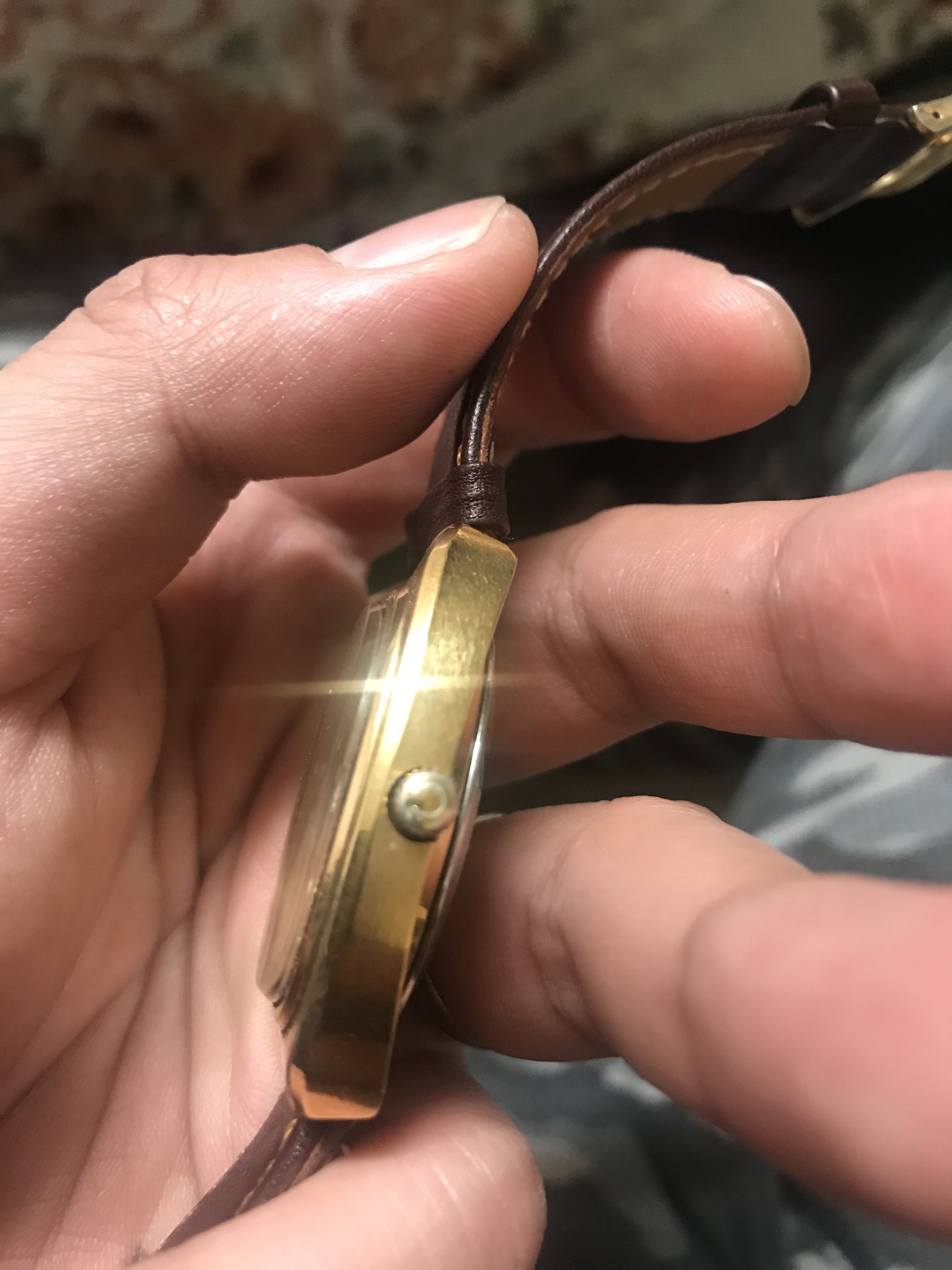

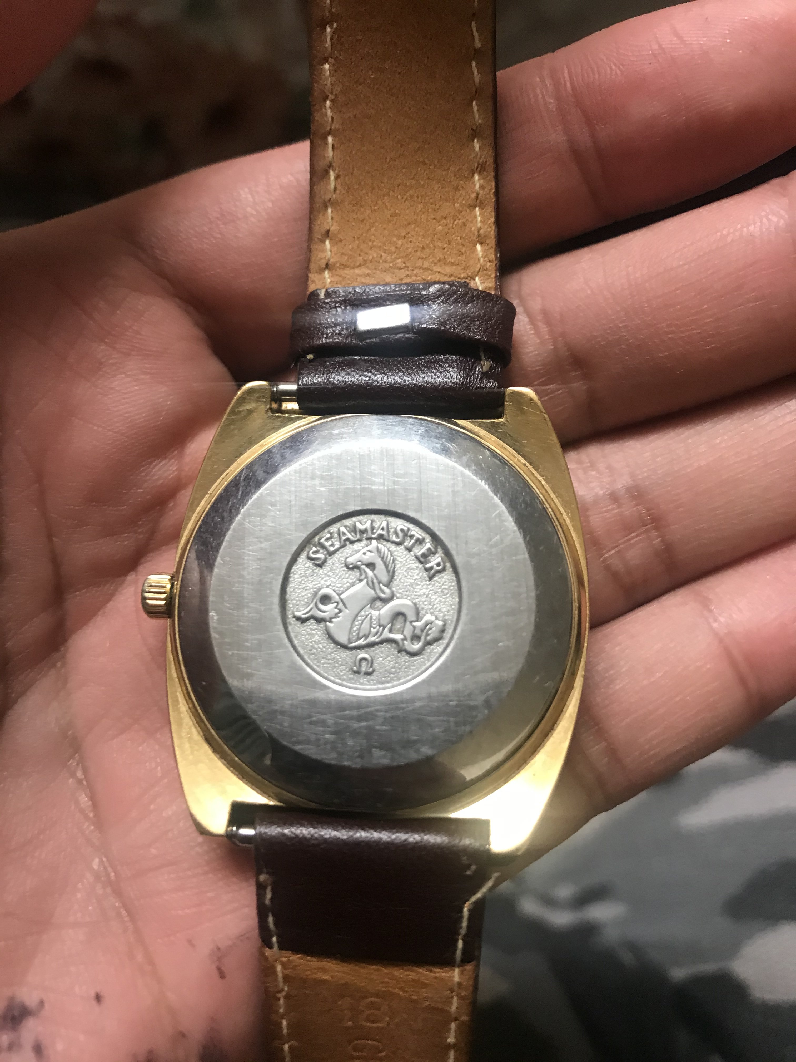

Early 1970's, maybe 166.0196 from '73-74. Looks to be a gold-filled nice example but we need to see inside to give good info.

I do love the 70's watch designs... Congratulations.
I'd say maybe a 166.0213 with a 1020 movement perhaps, but you'll have to remove the back to confirm
If you want a correct Omega bracelet, we'll have to know the reference #.
There is a possibility Omega never made a bracelet for this watch which means experimentation with the aftermarket.

Any brown 20 mm strap will look 10000000 times better than the one you have on there currently ( its the wrong size)
