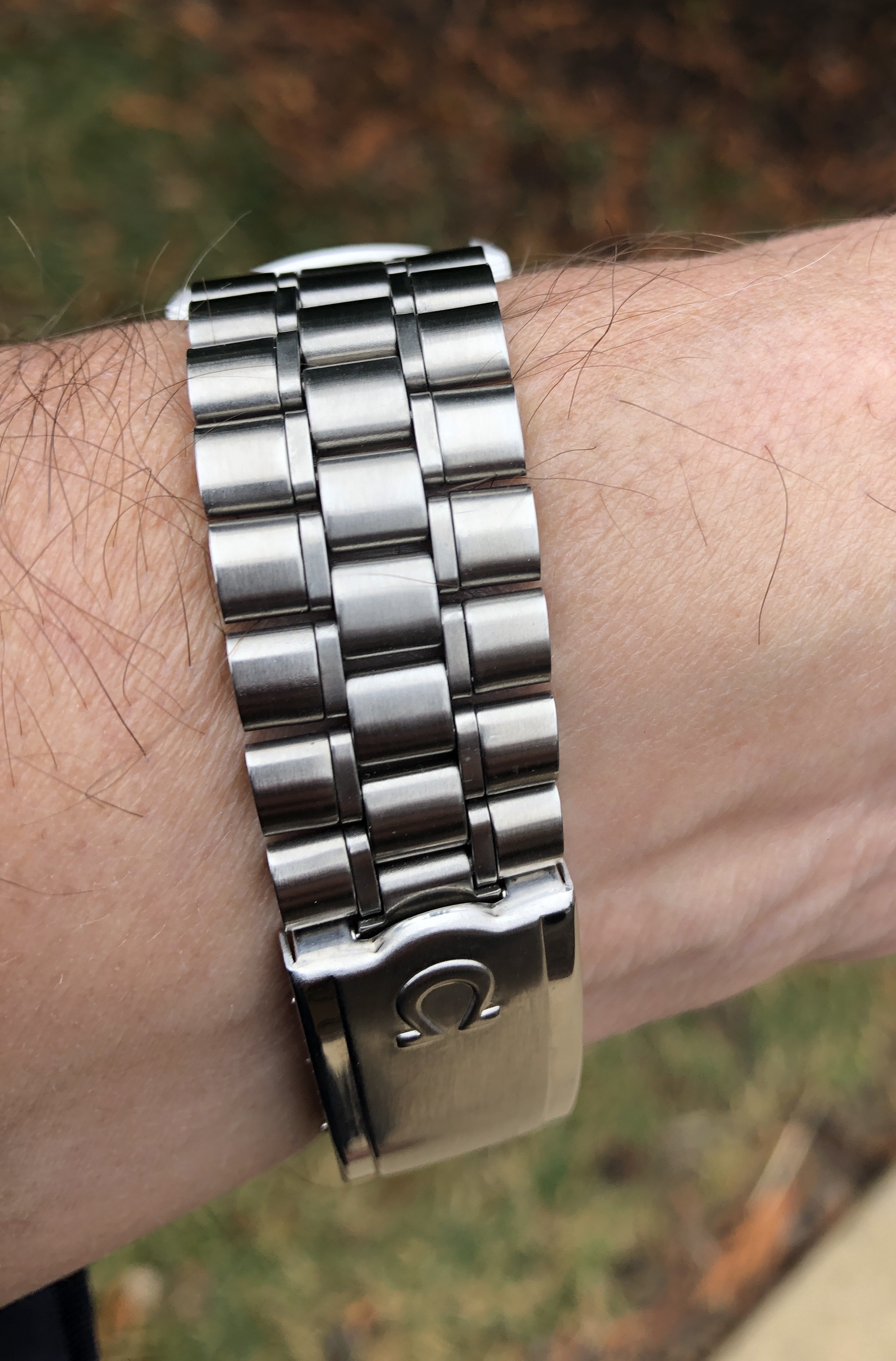

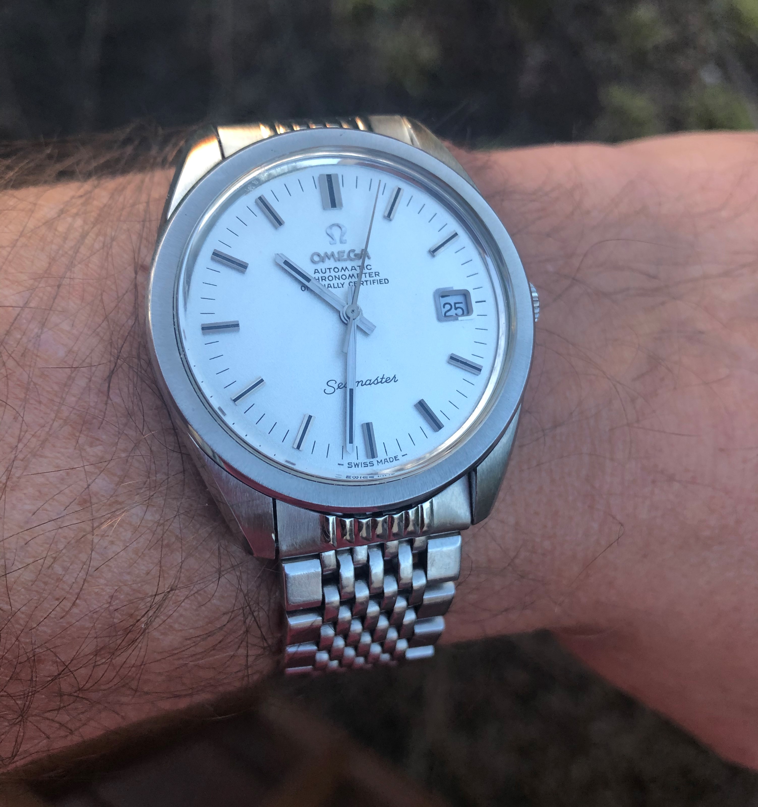

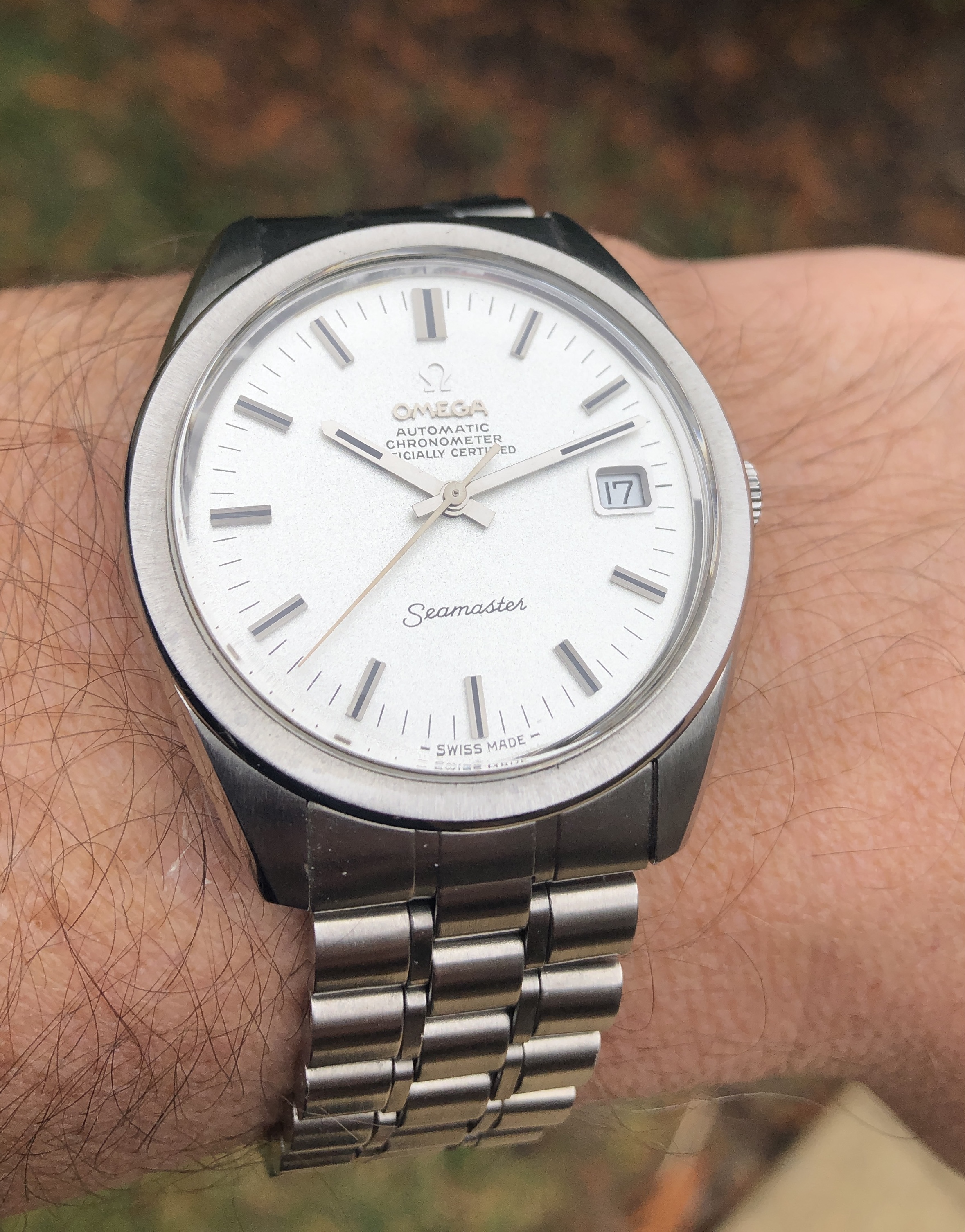

I thought I'd update the status of my bracelet. I originally put on a beads of rice bracelet on my 168.022. Even though this is not a correct bracelet for the model, I just wanted a beads of rice!
Since then, I purchased another watch that comes with the BoR (specifically an Ingenieur 666), so I decided to get the right bracelet for my Seamaster. I found a 1098 (apparently NOS) and bought 540 endlinks from my AD:
Admittedly it looks better than the BoR. The watch is 55years old and looks almost new! 😎😁
