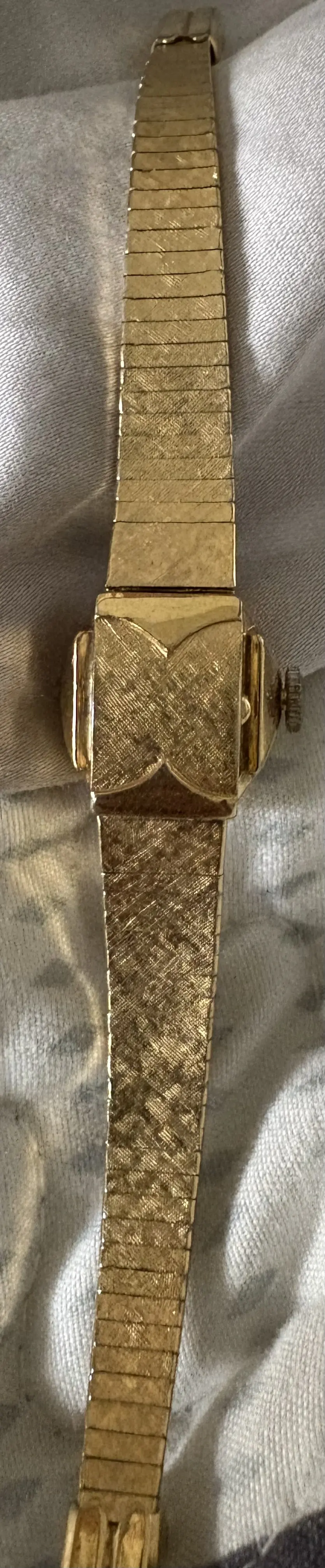

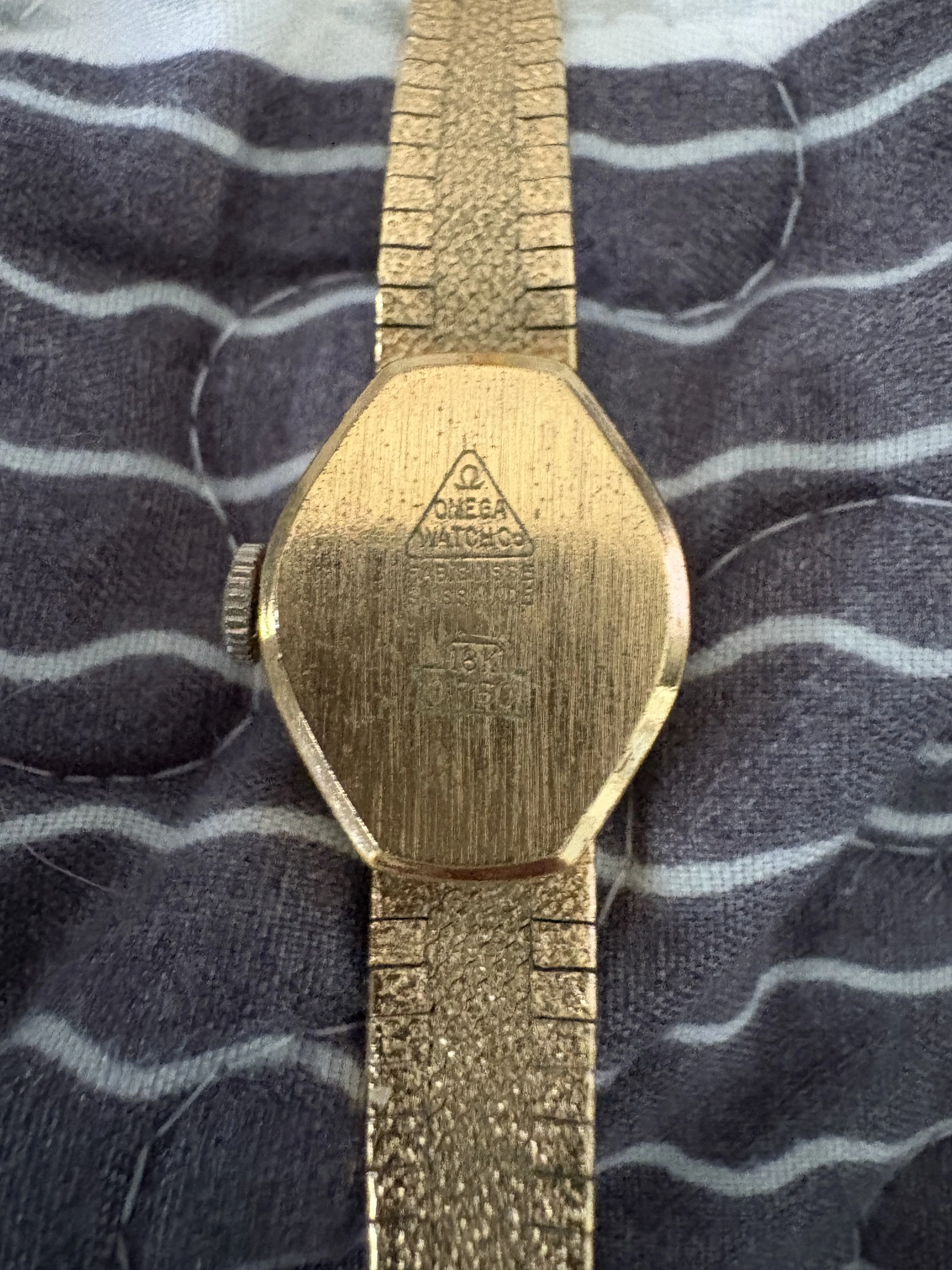

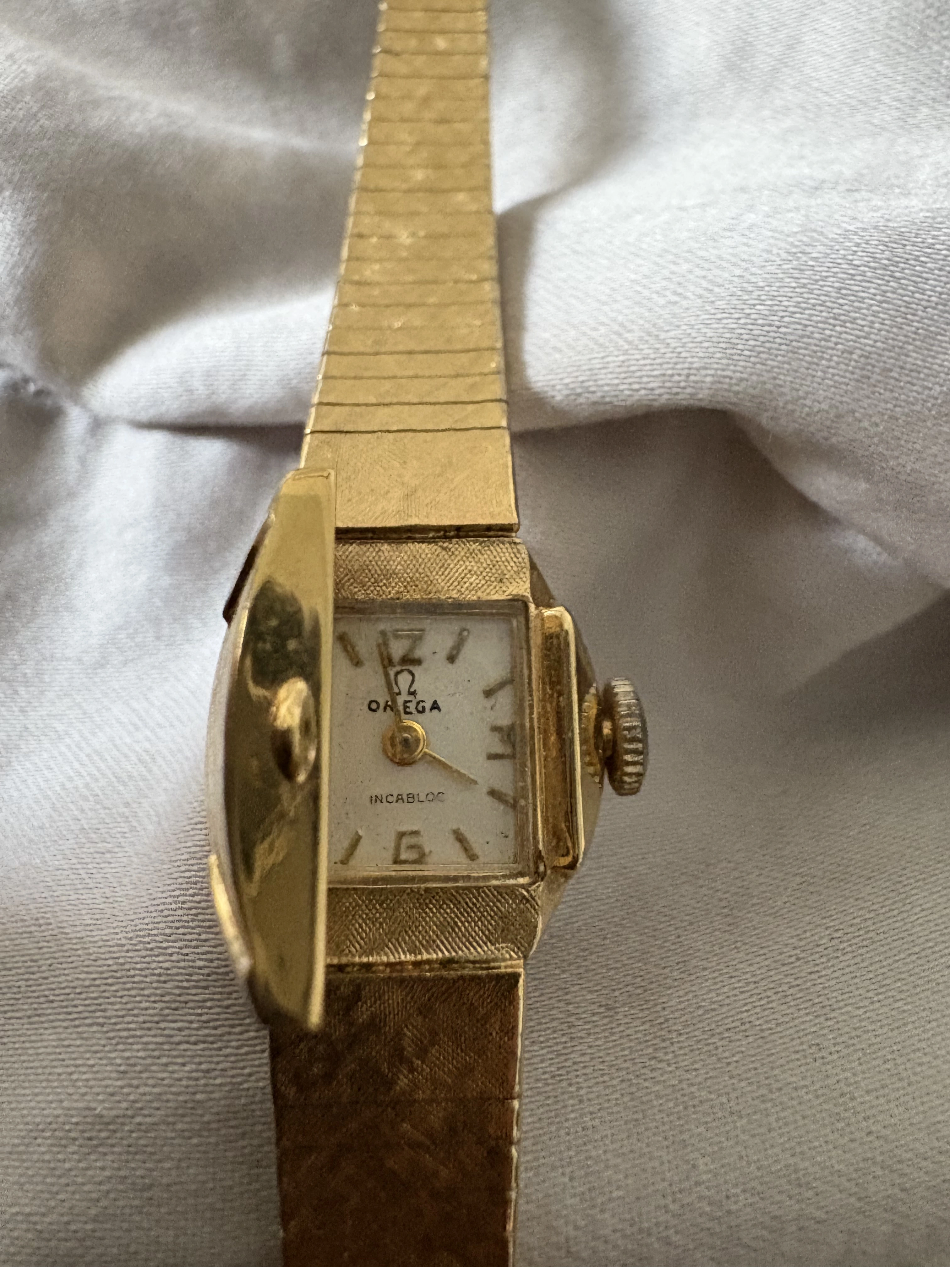

Hi All,
I'm new here, learning to be a watchmaker - I have an Omega ladies watch 18k with a flip door. Can anyone help me identify this watch?
Thank you in advance

The markings on the back show it as a fake.
Omega also did not write incabloc on the dial.
This watch is base metal and worth nothing.
The movement is probably some cheap generic.

I have to agree, it has all of the well documented indications of a counterfeit.
They were widely produced in Europe in the 1950s/1960s and have subsequently made their way all over the world.

Actually, Omega did print Incabloc on some watch dials in the early days of the Incabloc shock system.

Opened it up - the movement is Sellita - not ETA which I think Omega was using at the time - there is an Incabloc though! lol
Thank you for your help.
Can you provide an example.
I've seen "Omegas" marked with Incabloc, but never any issued by Omega.
