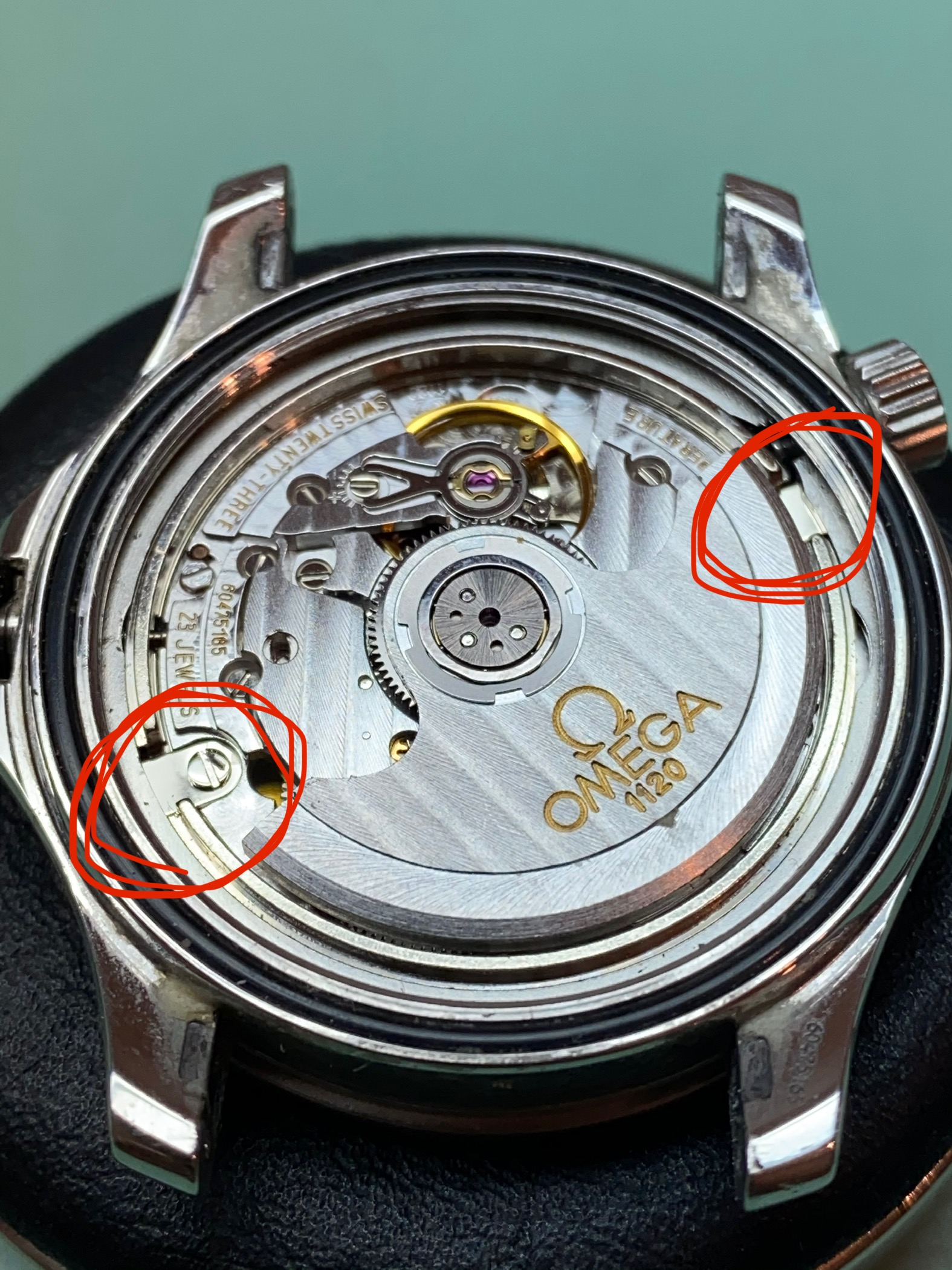

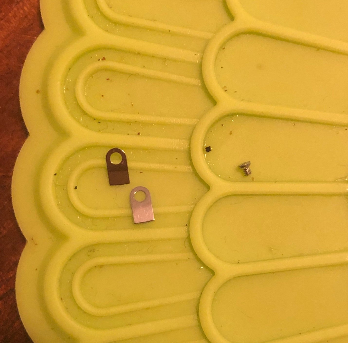

I removed the antimagnetic cover bc I was going to try to regulate it slightly. I removed the antimagnetic cover and tilted the watch slightly to get it to fall out of the watch. Right then two tiny metal pieces fell out as well as a tiny screw. I have no idea where these came from or how they were just loose waiting to fall out.
Any advice would be much appreciated!

EDIT* there are two tiny screws not one.

You have two loose case clamps, and two screws, one of each which holds one case clamp. @Scarecrow Boat beat me to it. His picture shows the location and orientation of the one case clamp, and 180°across from it is the location of the other clamp and screw.

The tip of each clamp, protrudes out, and under a lip machined in the circumference of the case. The tip of the clamp should be placed under the lip, and the screw fitted, to hold the clamp. The two of them hold the movement tight.

So, did you get them back in right-side-up?
Yes, there is an up and a down, and if not put in correctly, they don't hold the watch snug against the case.
Your chances of getting it right blindly are only 25%. Not good.

I looked up how to reinstall them. Also, I could tell they didn’t fit right if they were upside down.
