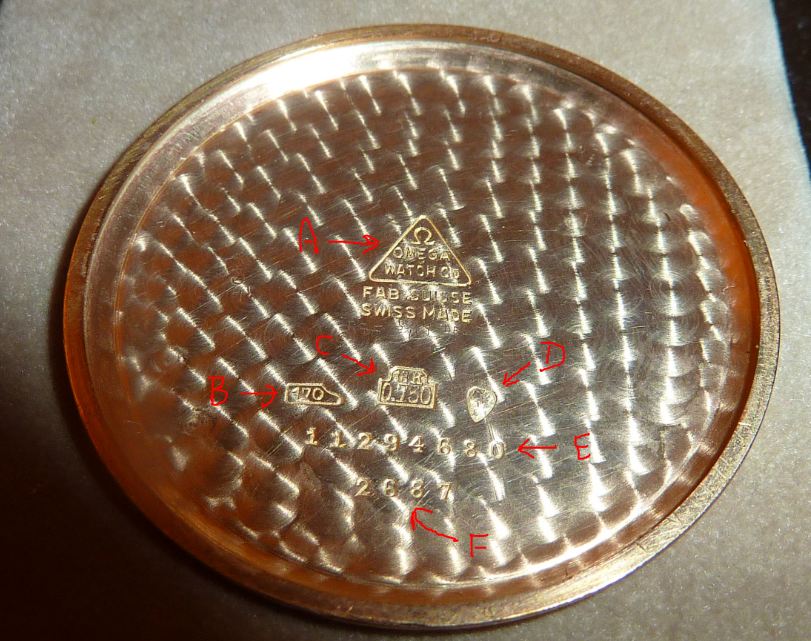

- In the photo of the cover I put letters e.g.: A,B,C,... to each sign that I don't know what it means or how it is read or interpreted.

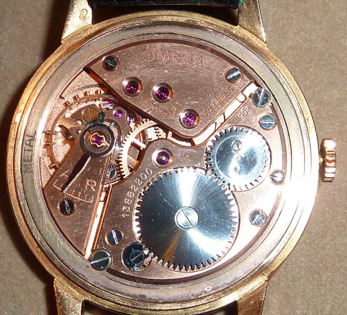

- Is it gold or plated? because I see that inside it says METAL (steel). Gold. The steel thing you see is a ring to fit the movement in the case
- what are the red dots that it has on the machine? Jewels https://www.prestigetime.com/blog/what-are-the-jewels-in-a-watch-for.html

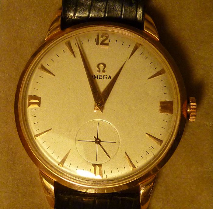

Does anyone know the value of this piece (I will never sell it, I am just curious). The dial is refinished which makes it not that attractive to collectors
- Its belt is not the original one, does this influence a lot? Zero

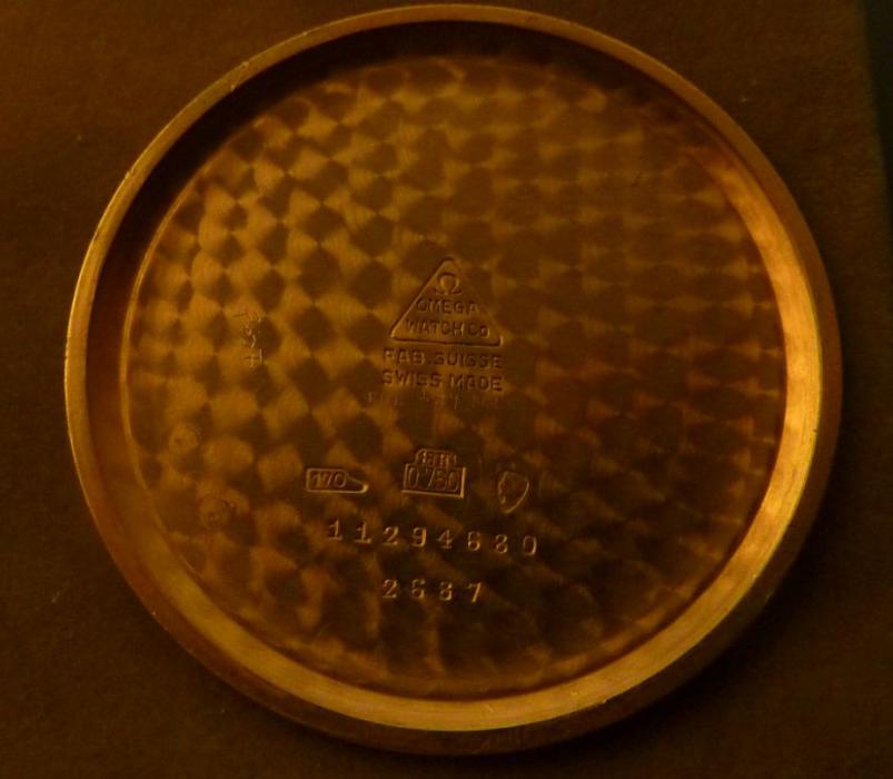

A = Omega mark
B = case maker in this case Cedex, Charles Dubois SA
C= 18 ct gold
D= Swiss?) gold mark
E= case serial
F= reference

if the E= serial case, then the watch is from the year 1947, then, what is the number ( 1 ), which is on the machine ? the number : 13882200 ?

On the case - Omega would contract a case maker and provide them with a batch of serial numbers for the quantity of the contract.
On the movement - Omega would assign production of a batch of movements with serial numbers.
Later, during assembly, the two would come together, so the dates of production of cases and movements could be close together, or they may be some years different.

You should use the number on the movement to date the watch. Your watch with movement number 13882200 was made around 1952.
1: movement number (used for dating)
2: number of synthetic jewels in the watch (these are functional and not decorative)
3: this is the movement calibre (or type). In this case Omega calibre 266
The watch case is solid gold 18k gold. There is a casing ring around the movement which is probably brass.
The red dots are synthetic jewels.

The unoriginal strap will not affect the value too much. However, the dial has been repainted at some point. This does affect the value.
