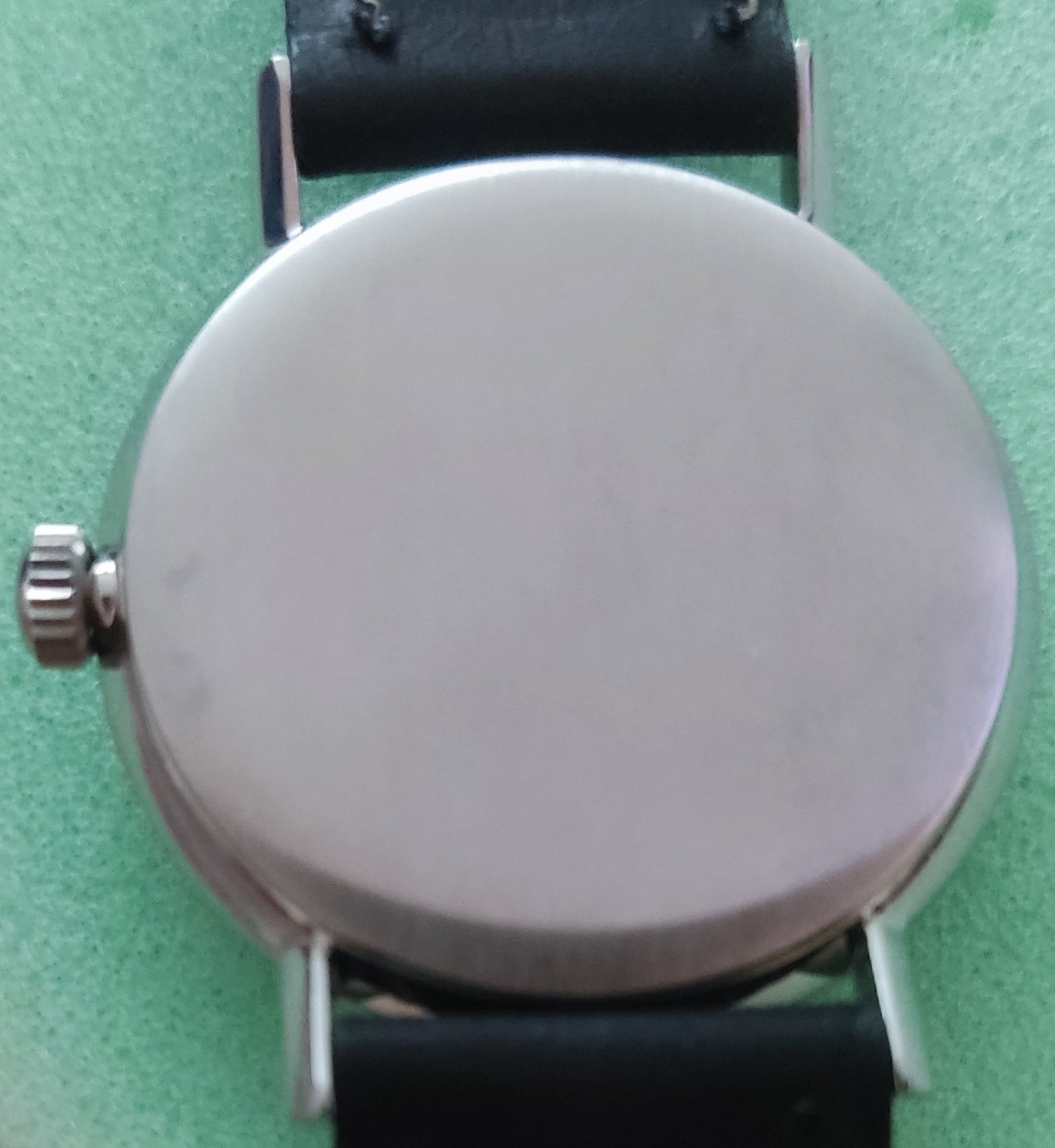

I just received my first Omega and got super excited only to open the box and see the watch... running.
131.019 should be cal. 601, yet I don't see how the watch could have travelled for a week and running out of the box... unless it's automatic... or even worse... a quartz fake.
457
152

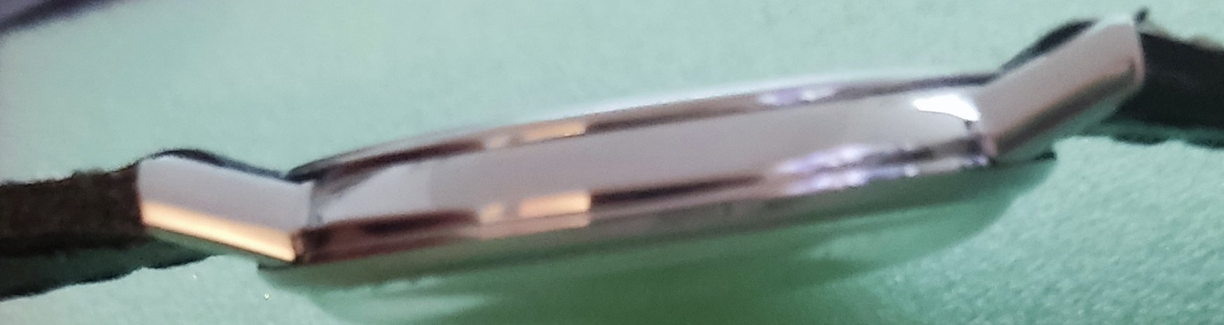

But the caseback is flat... it makes no sense... if it's automatic it should be thicker.

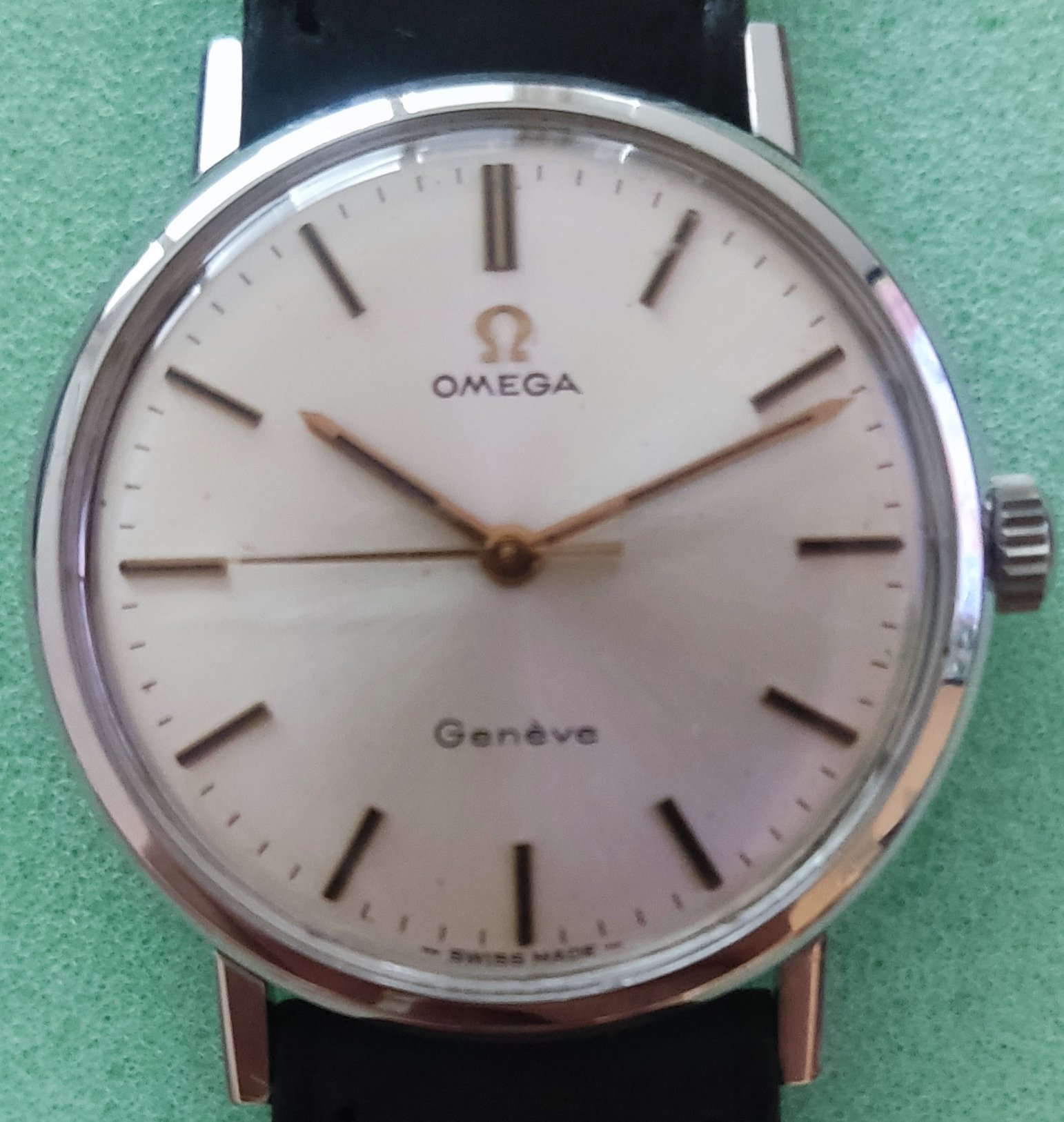

Thanks for the help, everyone. Otherwise do you think everything looks alright? As in dial, hands, etc.?
I will take it to a Horologist to verify anyway, but it will take me a few days before I can do that. I still don't have any tools, so I can't open the case back myself.

Good plan.
I'm 99% confident your watch is OK, so wait until your watchmaker confirms and then just enjoy it.
