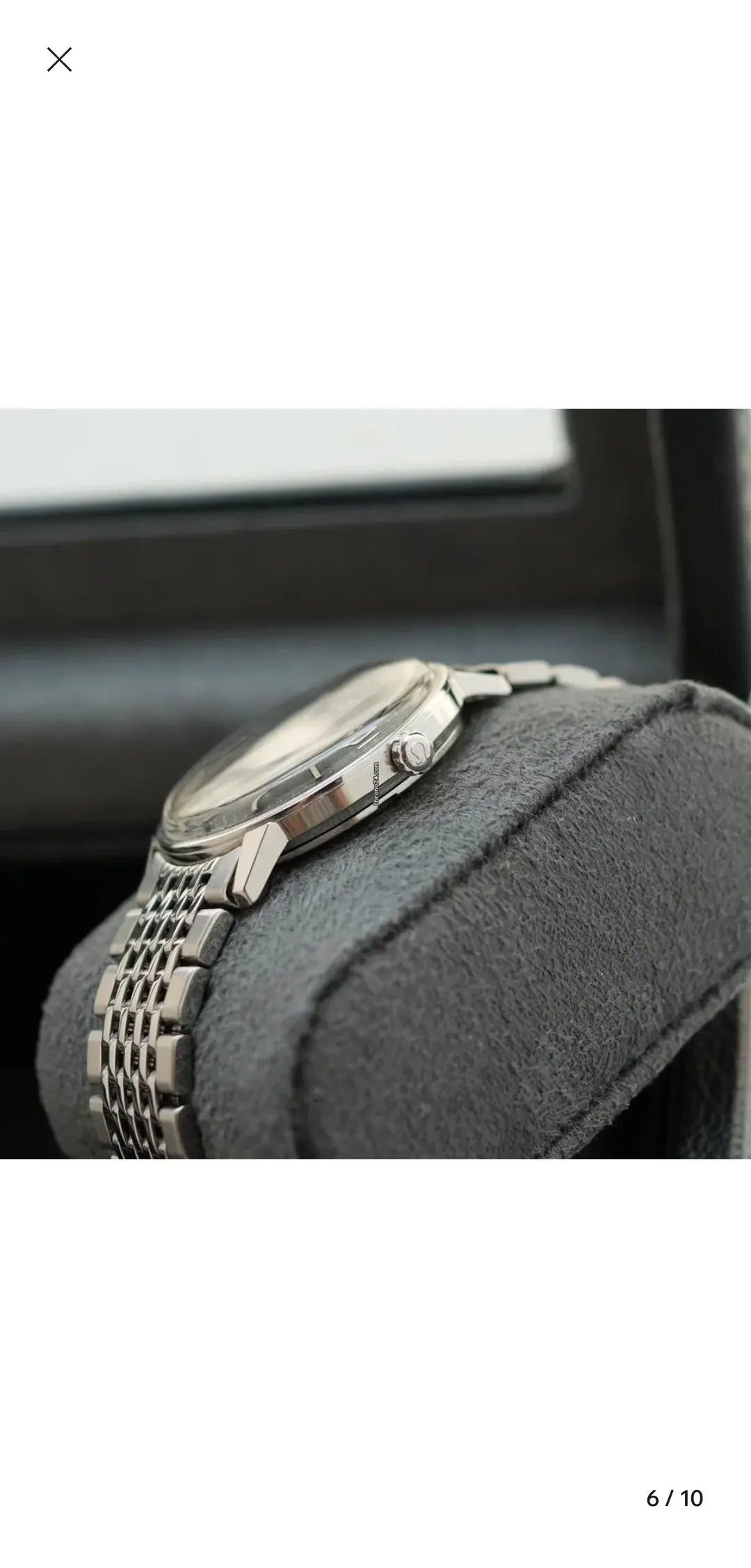

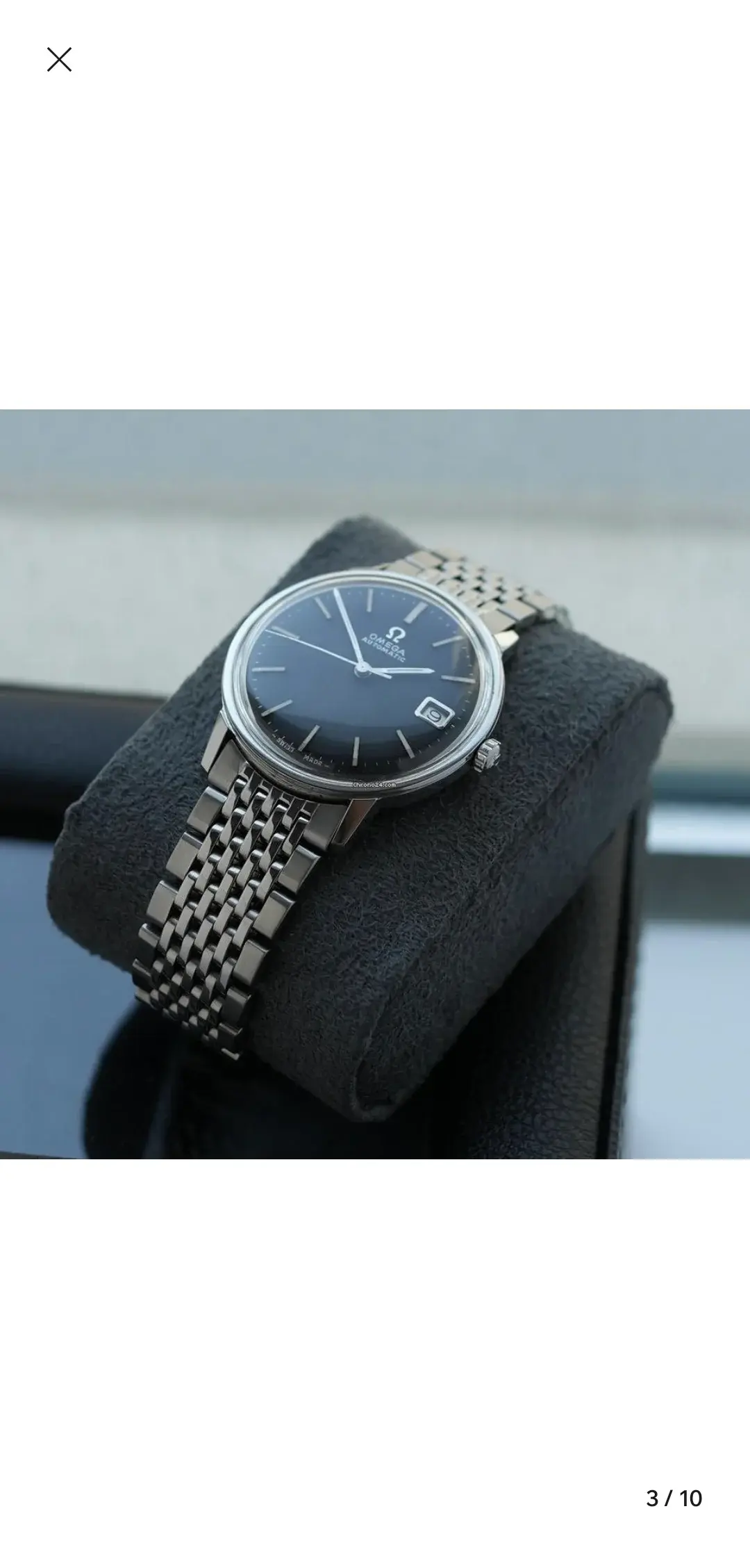

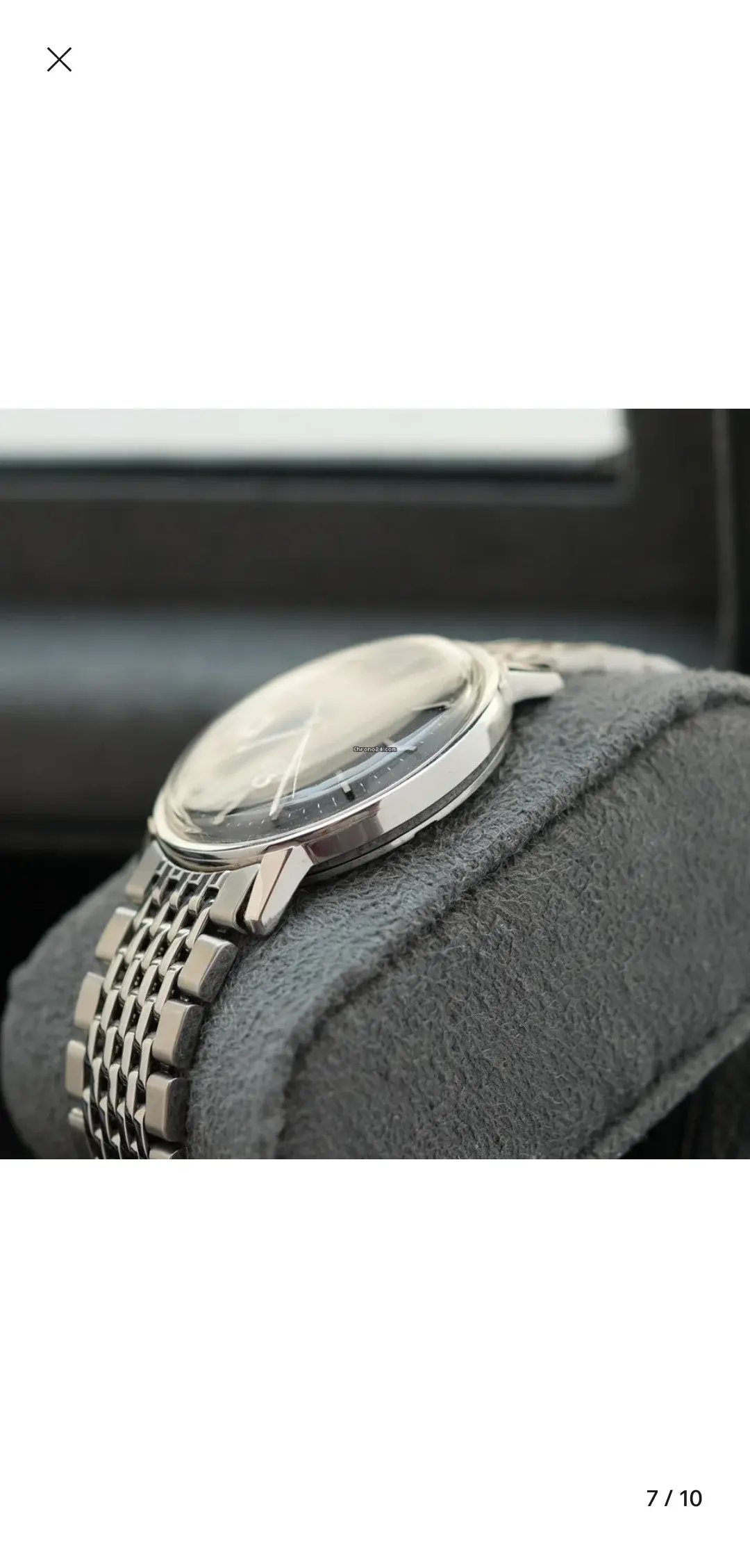

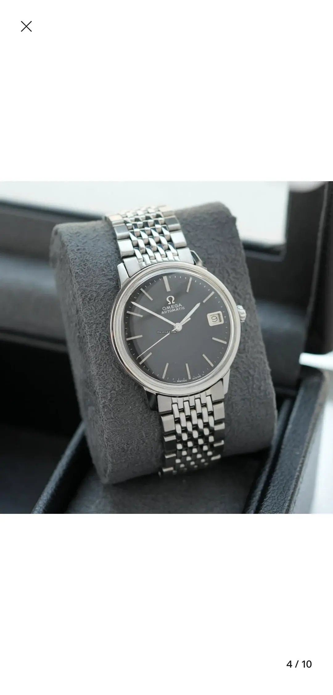

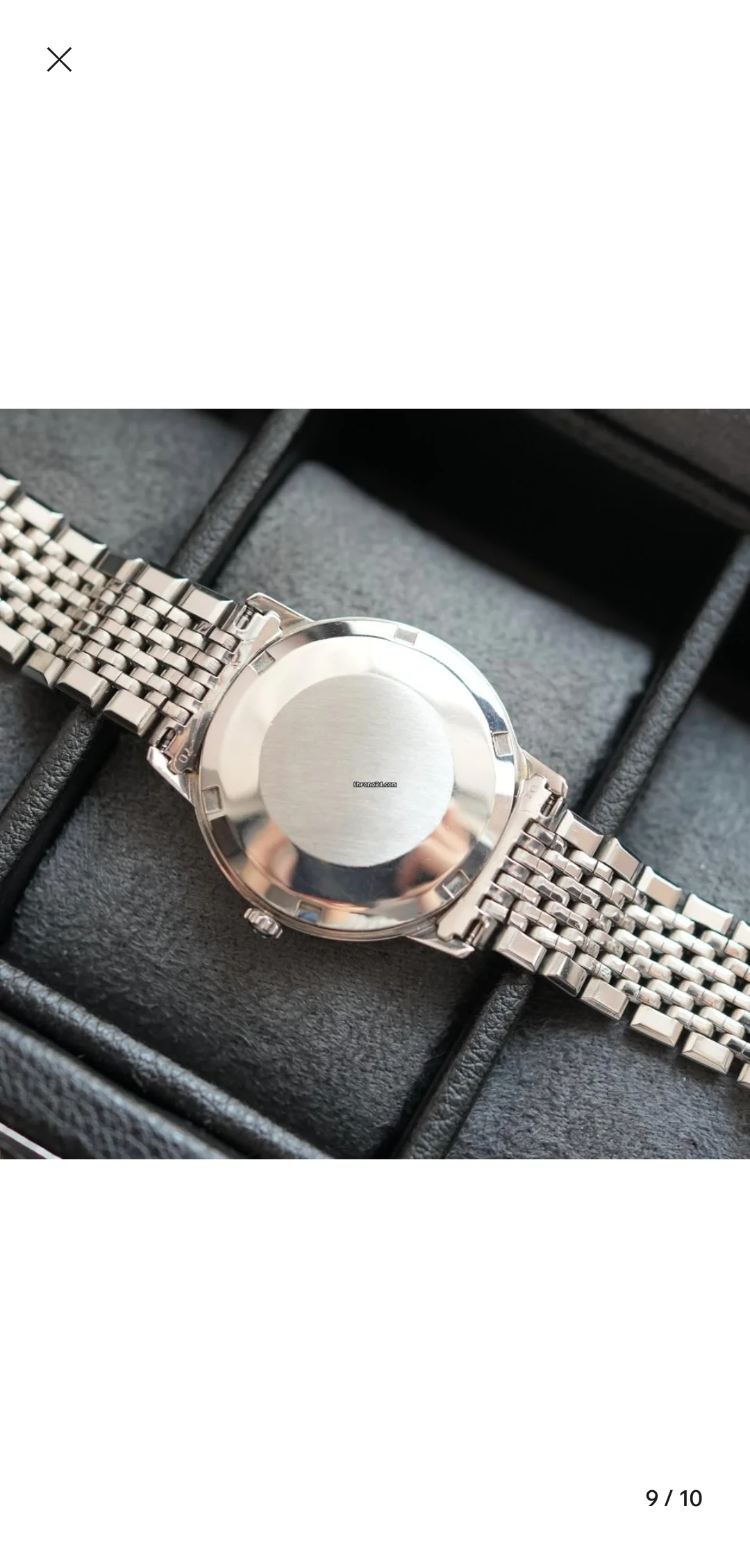

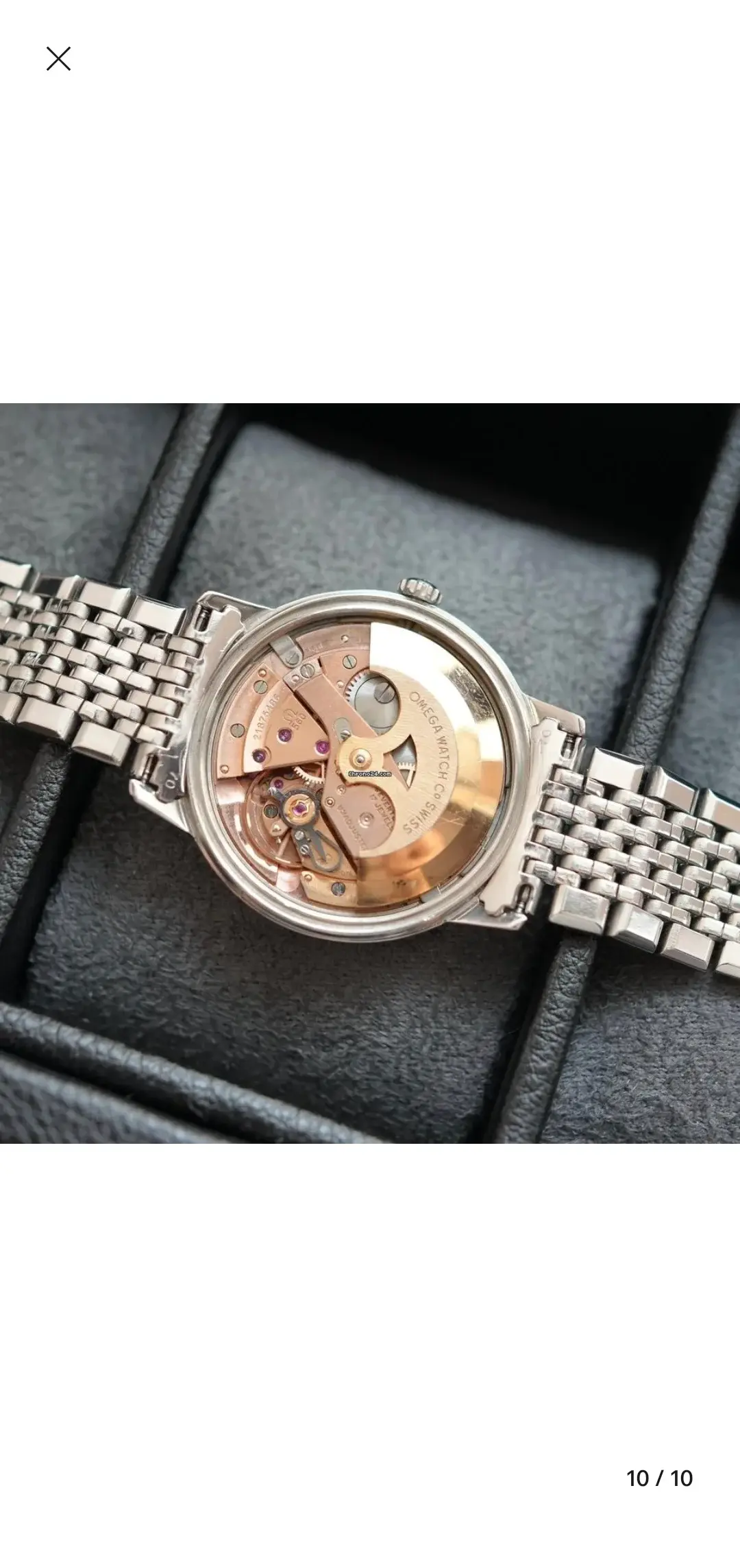

Hi everyone,
I am considering this timepiece from a dealer that advertised it for $1100 and wanted to get some experts opinions on the forum on whether I should proceed, one comment I have is his ad states that movement is 552, any advises are greatly appreciated.
35,789
40,068
Its cal 560 not 552, dial looks refinished, way overpriced in general, 165.002 is a non-date reference yet it has a date which means the movement, dial and case don't match at all and the watch is just an assembled pile of bits.

I did noticed the movement discrepancy between what seller stated in the ad and actual movement but thought it was just a typo 😀 😀
Hard pass, thanks very much

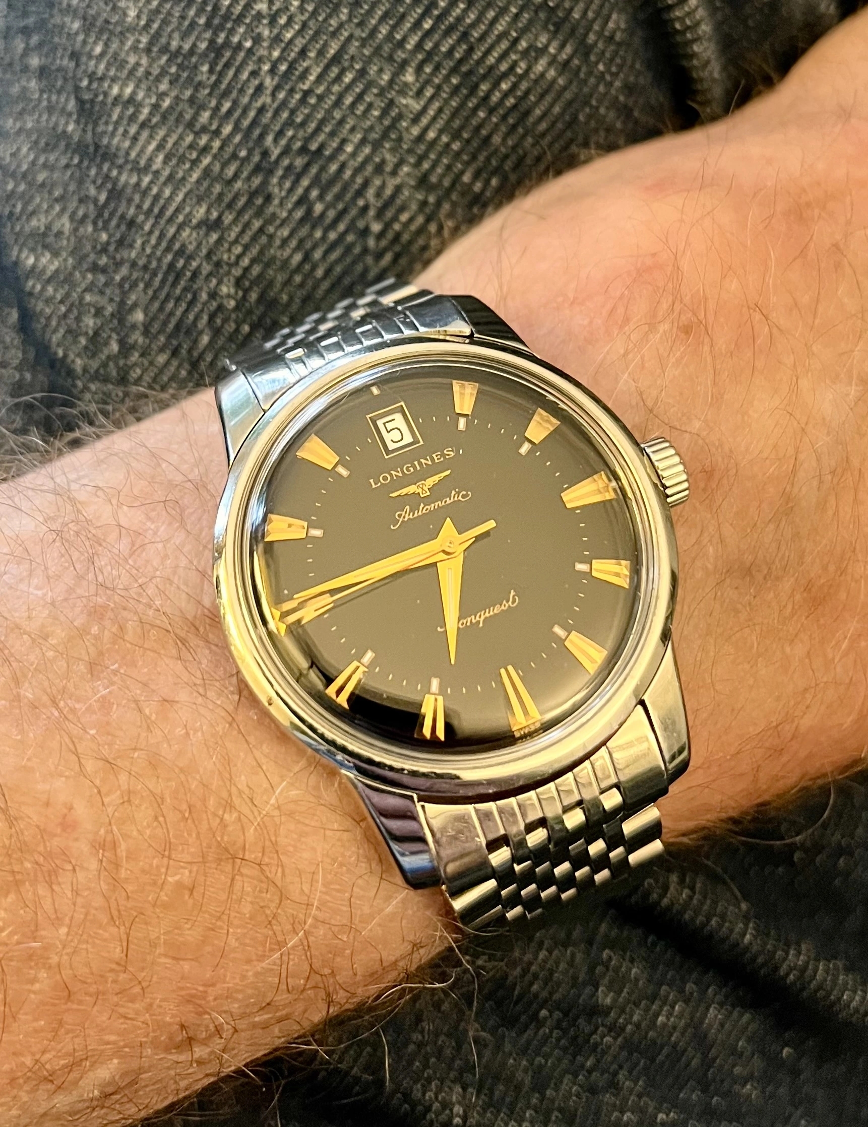

And @Yayatar16, to save you looking it up, here’s one of mine (admittedly with an aftermarket bracelet) 35mm and lots of them available for around £500/600 on eBay and Chrono24.
