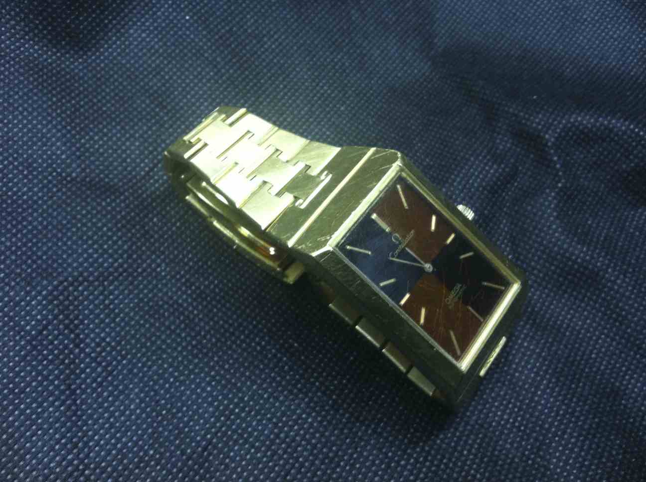

    Hey. I Would wish to know more about this watch Omega Constellation.
    I can not locate it on the WEB Omega listings.
    It's a fake?
    If not, could help to determine its date of manufacture and value?

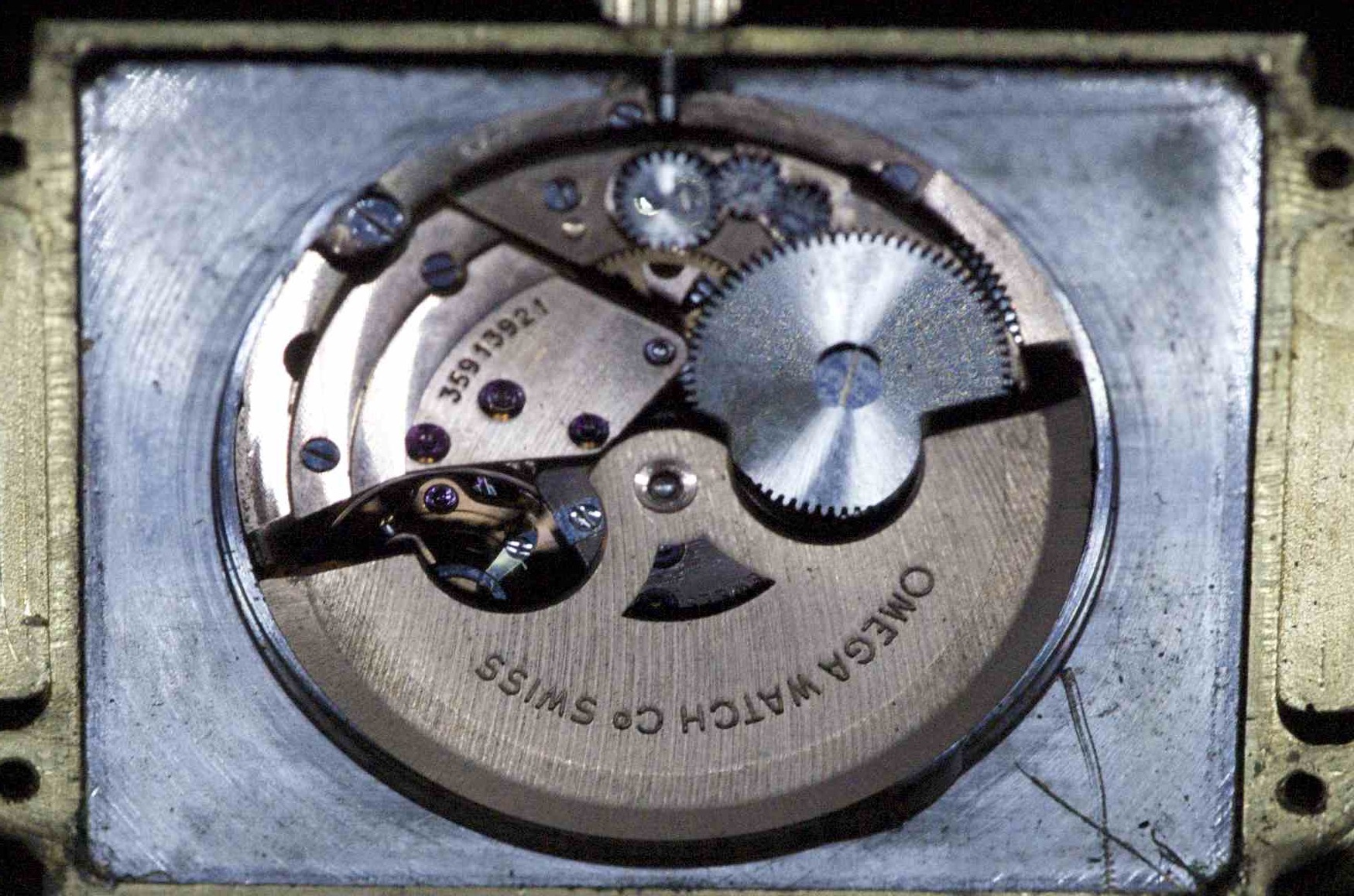

    Do you have a picture of the movement? That would help.
    My gut tells me that it is real, but there just isn't enough info there to tell for sure.

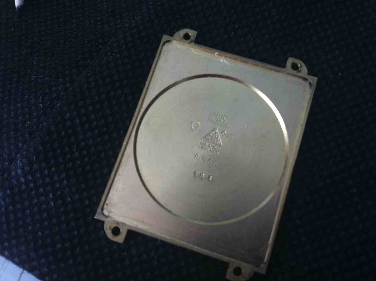

    Movement definitely looks Omega. Does that marking on the caseback say .750 18K? Is this a solid gold watch?
  5. stuka Feb 16, 2012
    6
    yes. its a solid gold....do you know the date and the value?

    8365 163 on the backplate is not registed at Omega web data base.....

    Yea the database is not complete, my 1958 18K gold chronograph isn't in their either. I messaged a couple other guys that might shed some further light on it.

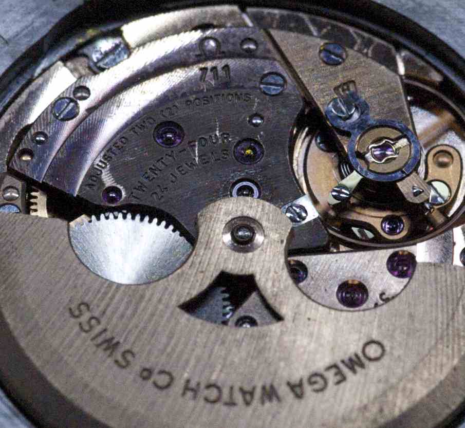

    If you can get the serial number and caliber number off the movement we can give you the date of manufacture and maybe take a stab at identifying it. It looks like that's a 71x series, but the watch is a little thick for one of those ultra-thin movements.
  9. stuka Feb 24, 2012
    6
  10. ulackfocus Feb 24, 2012
    25,983
    26,968
    It's from 1972. Most of it's value lies in gold content which would probably be around $2000 now (give or take a few hundred depending on the weight).
