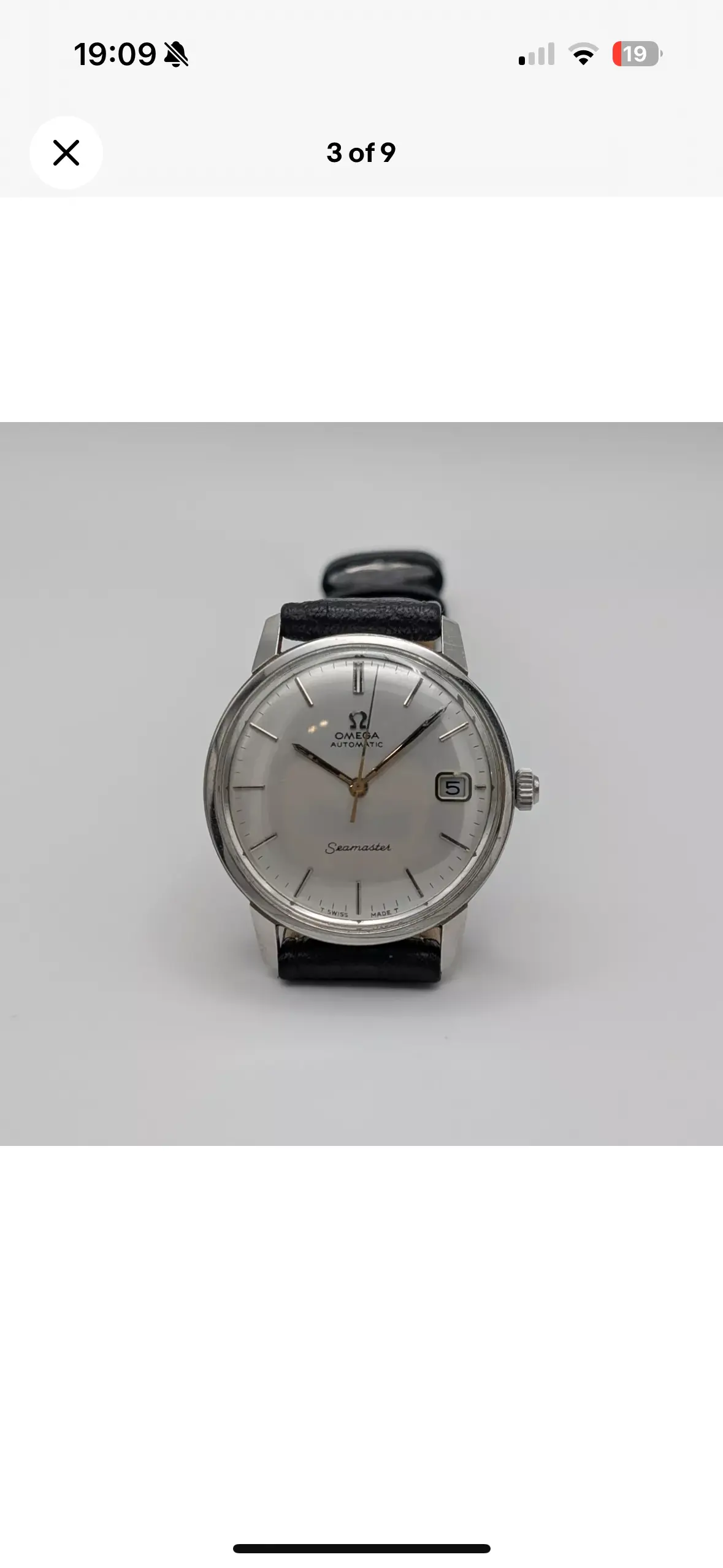

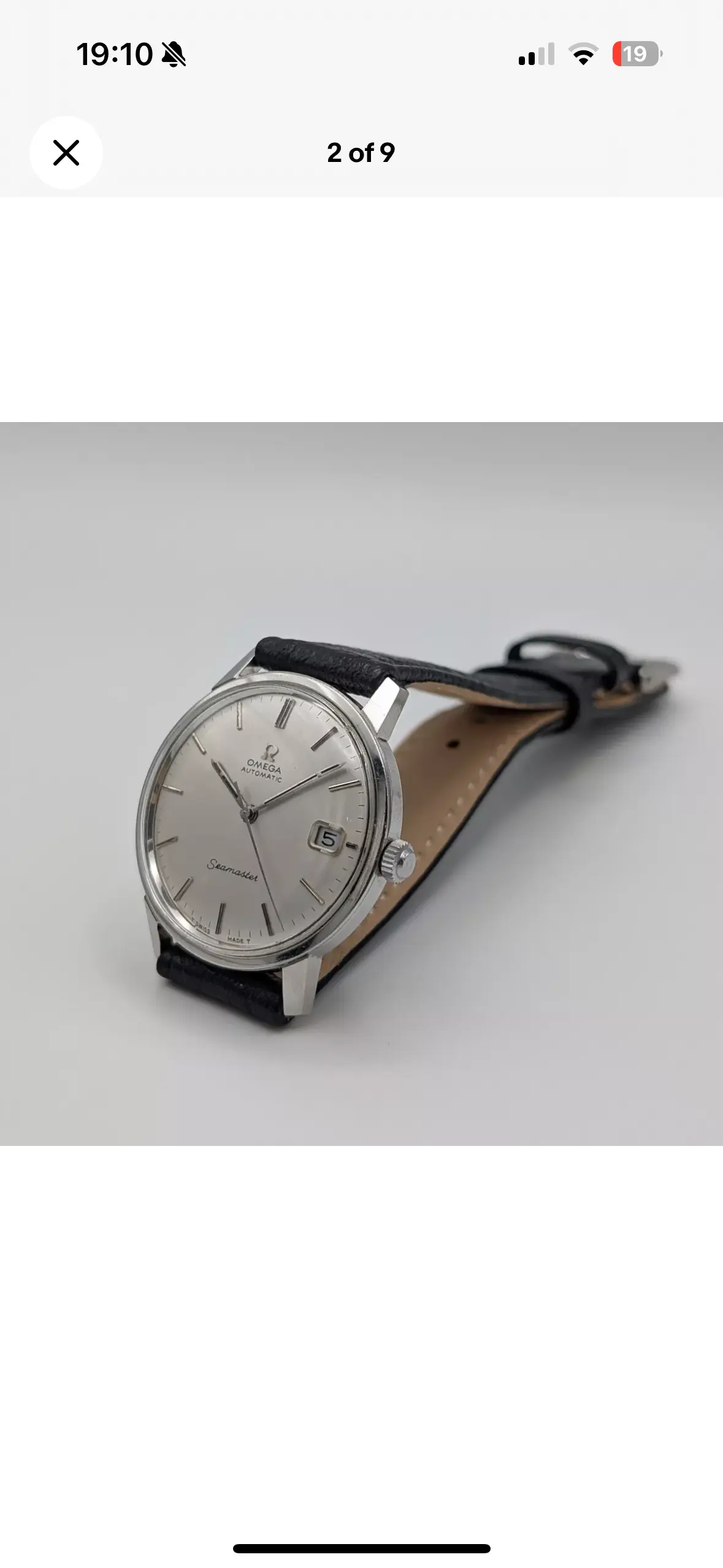

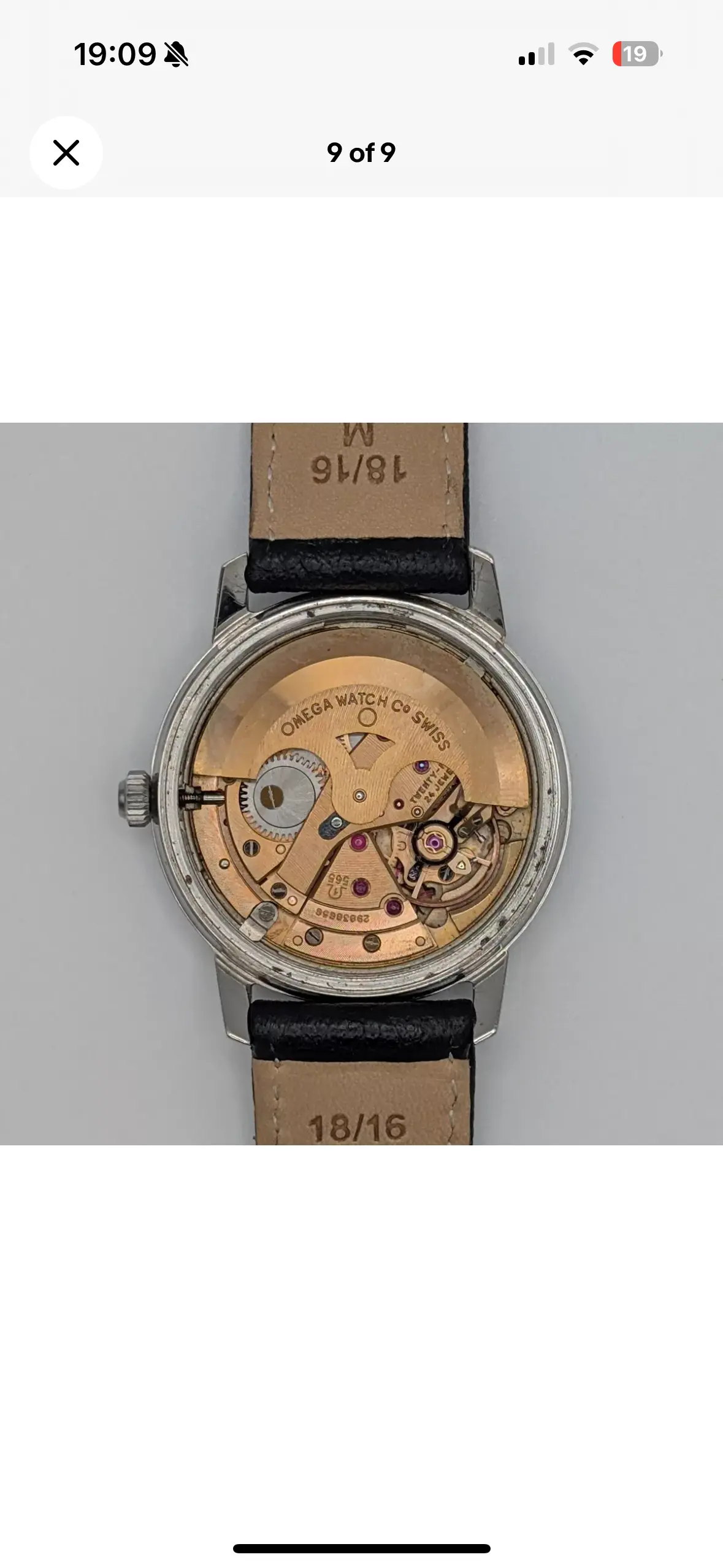

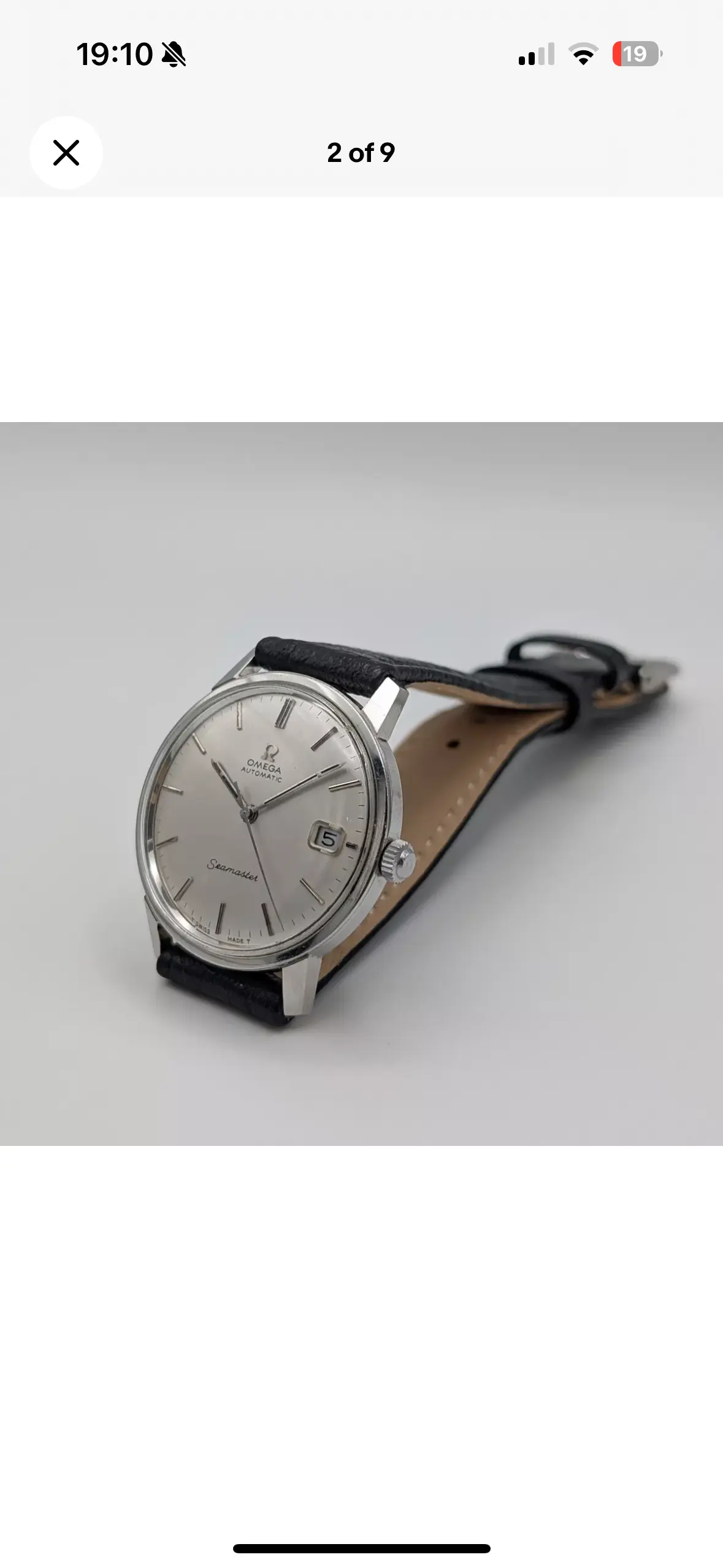

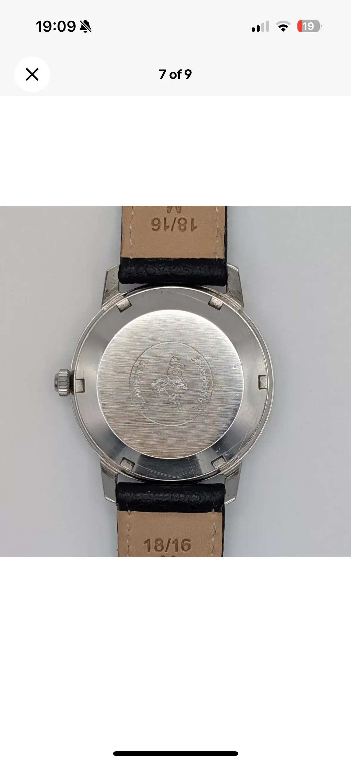

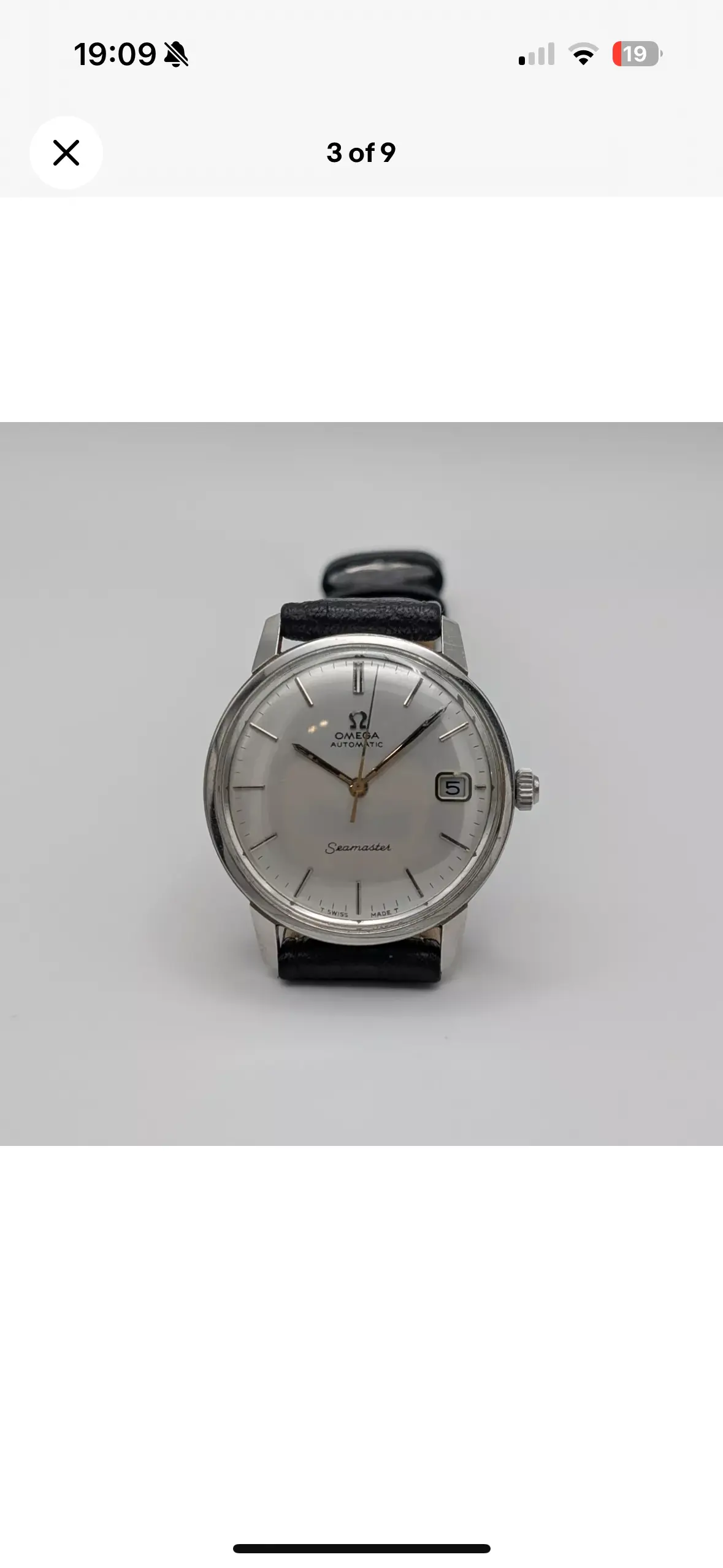

The first is a Omega Seamaster - Ref 166.037 - Steel Vintage Wristwatch - circa 1969.
Currently bidding but I’d be willing to pay around £750.

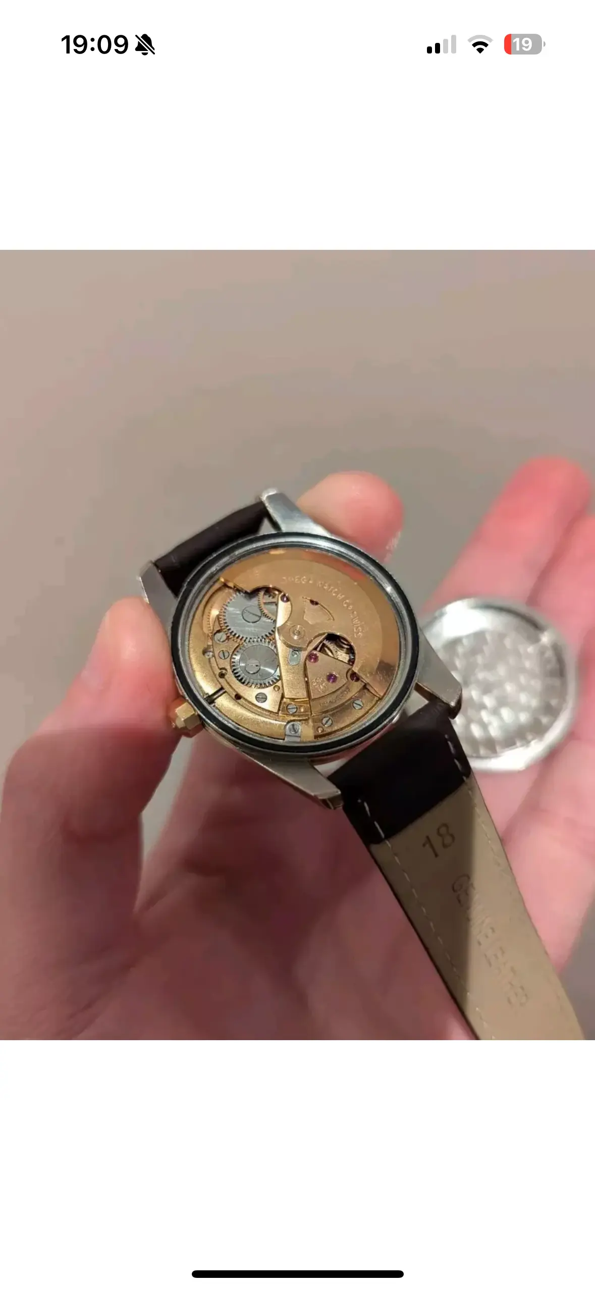

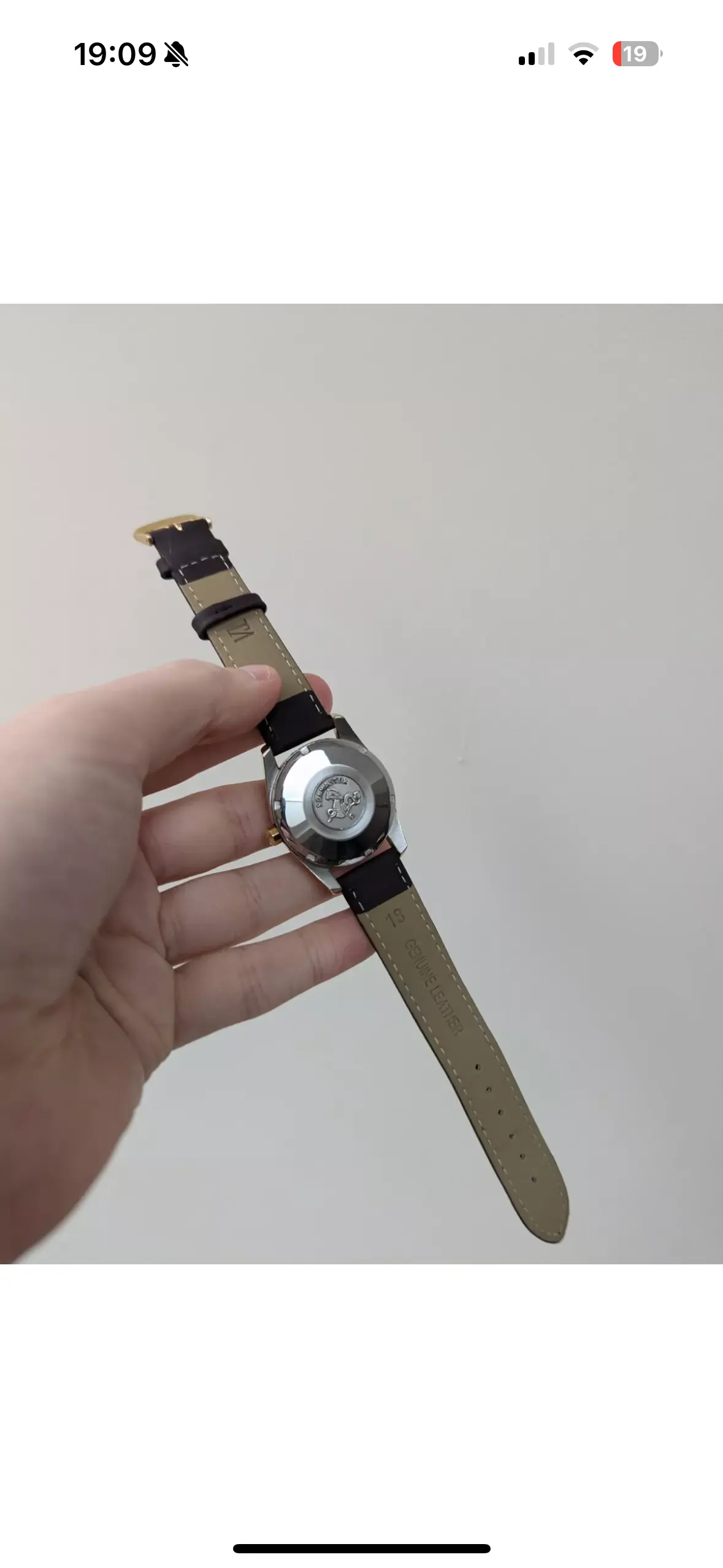

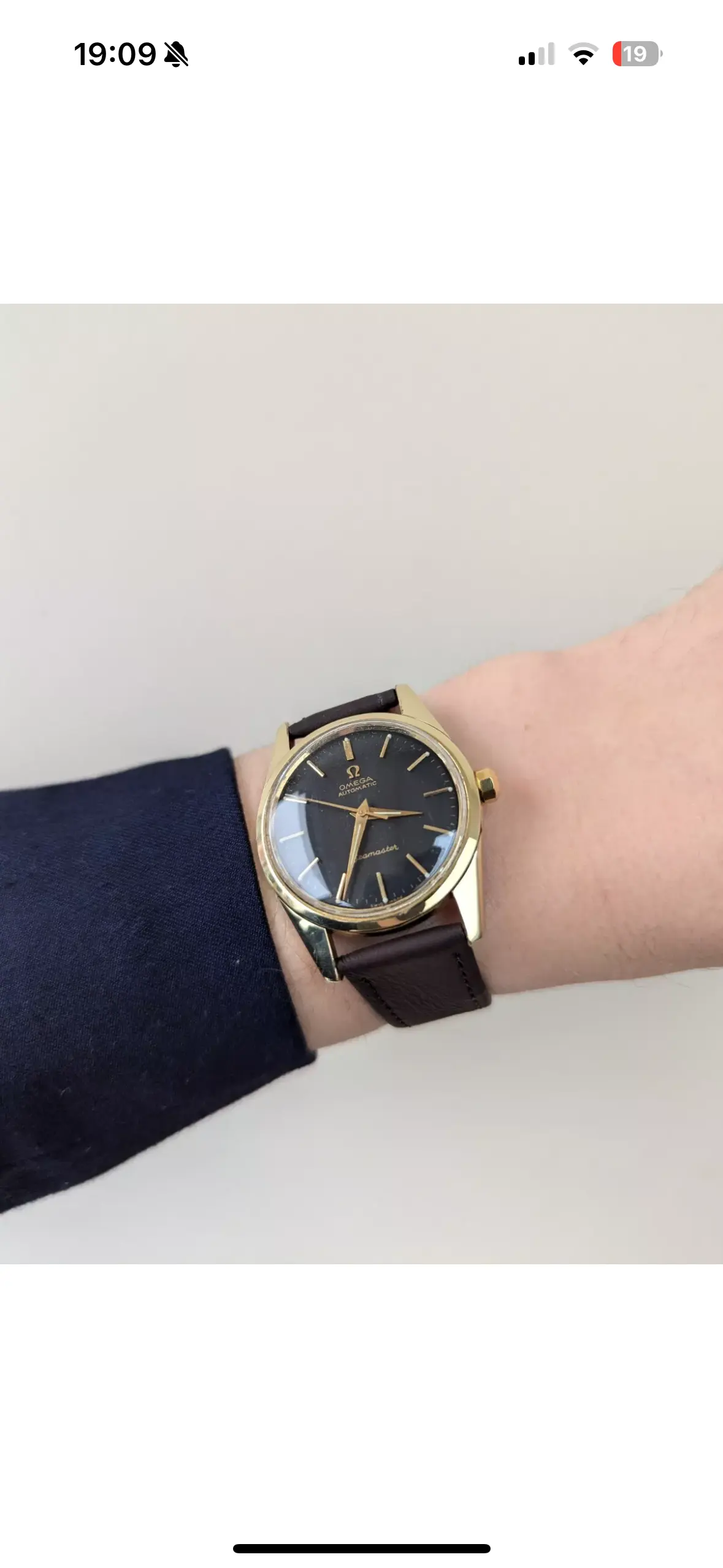

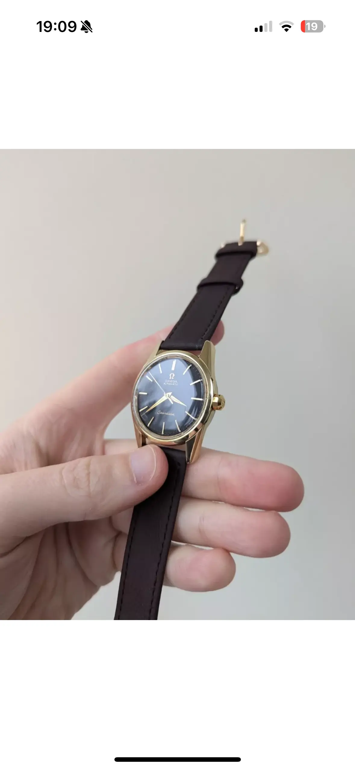

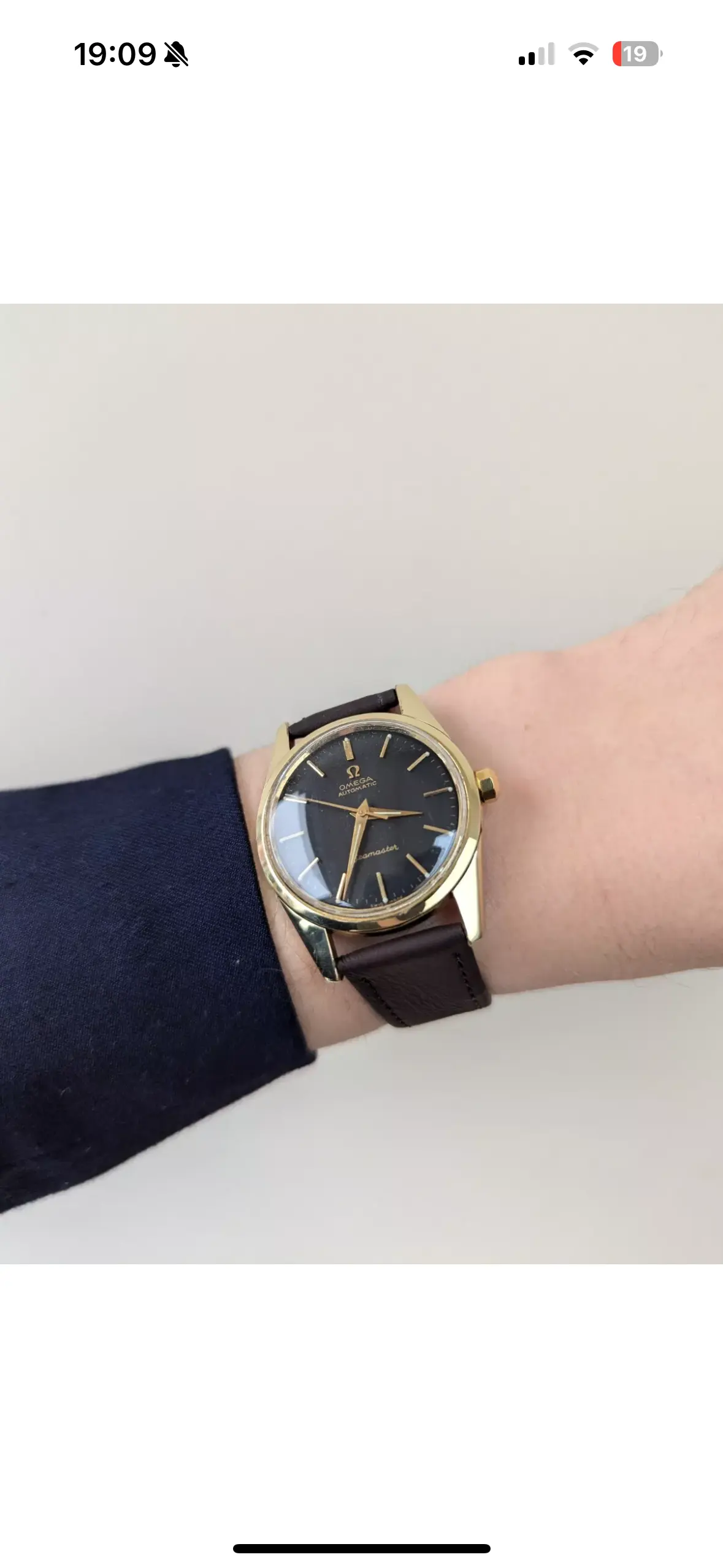

The second is Vintage Omega Seamaster Mens Automatic Watch 14700 61 SC cal.552.
I’ve been sent a buy it now offer of £735, but I’m struggling to find info as the model isn’t showing on chrono24.
Any advice/help would be much appreciated.

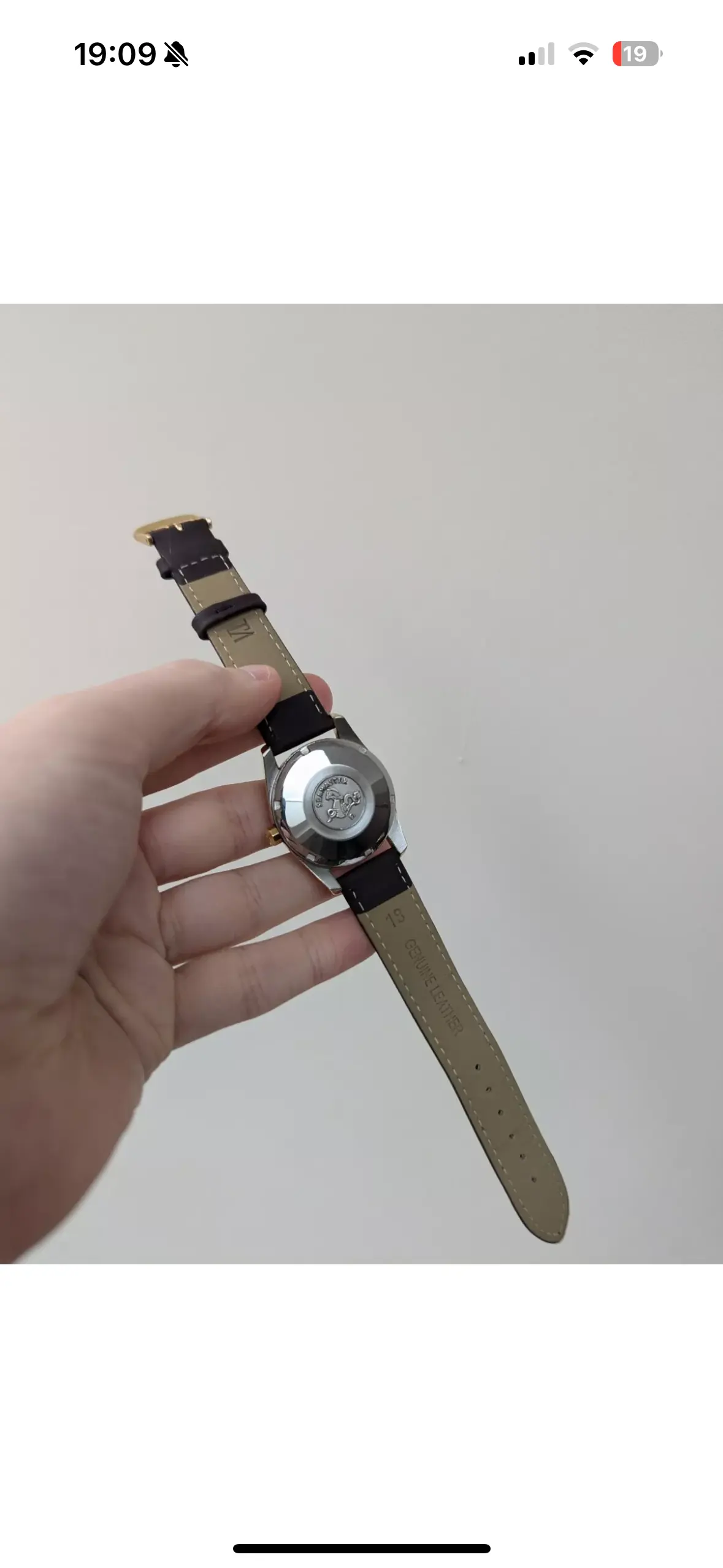

Is the second a gold plated case?
I'd go with the first, myself, though black dials are so cool.
7
Thanks for the opinion- I am swaying to the first myself, as it’s bidding I’ll have to try my luck.
If not I won’t be disappointed with the second.
It is indeed the gold plated case, I also love the black dial, I currently have a Tudor royal with the black face so it would be nice to have something a bit different.
Thanks
1,615
3,862
Both watches make me uncomfortable: wrong crowns, priced high and I'm not convinced of the originality of the dials. They look like 2nd choice dealers watches to me.
You may land a better watch from a member here by posting a WTB... just hang around until 200 posts. This way you will learn a lot about vintage and not be easily burned by buying iffy watches.

I am not sure about the crown and originality of the dial for both.
If I had to chose, the first one.
8,174
36,709
1st I'd say is definitely a redial
2nd I'd say also a redial as black 14700/14701's are AFAIK always gloss and gilt

First is certainly a redial.
Second, I can’t tell on my phone with those pictures.
