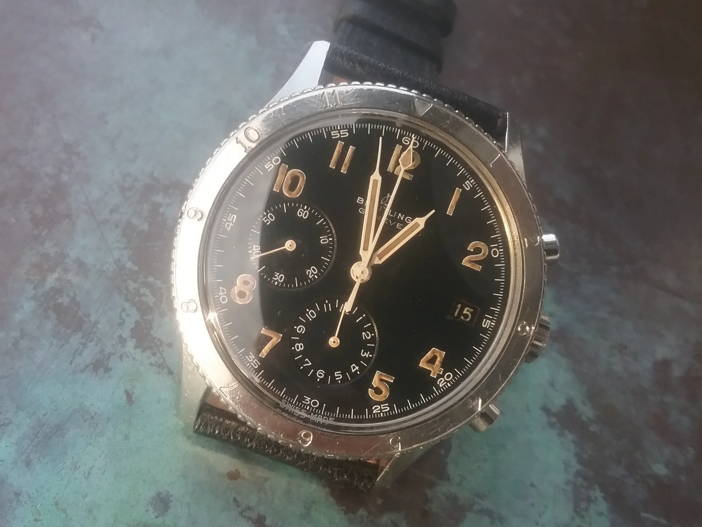

I'm trying to locate a steel bracelet (non-mesh) that will fit a vintage 765. While I believe the 302A will work, they are not in the current catalog and finding one elsewhere is proving impossible. Also, it seems that any bracelet that would fit on a Classic Avi Ref 765 1964 Re-edition (AB09451A1B1X1) will also fit the vintage 765.
If you have ideas as to what will fit either (vintage or re-edition), and where it may be sourced, please reach out and let me know.

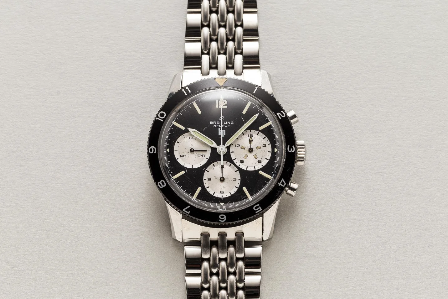

i don't know, if any steelbracelet will makes this watch a good/better looking watch

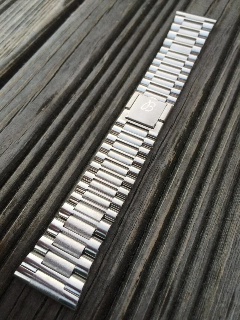

from one decade later it would be possible to try no10, 13 or 14
i would like to see the 765 on a no14 (a lot of collectors don't know, that this one existe),
but think no10 would be the best choise
a contemporary Breitling bracelet as 302a would be no option for me for a vintage 765
(most contradictory is the clasp logo than)
regards from my digital brother

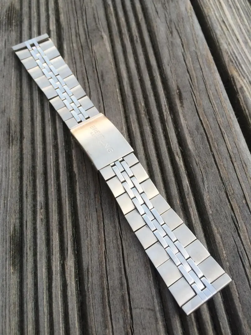

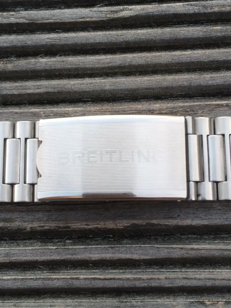

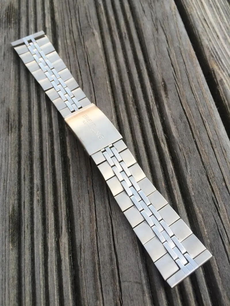

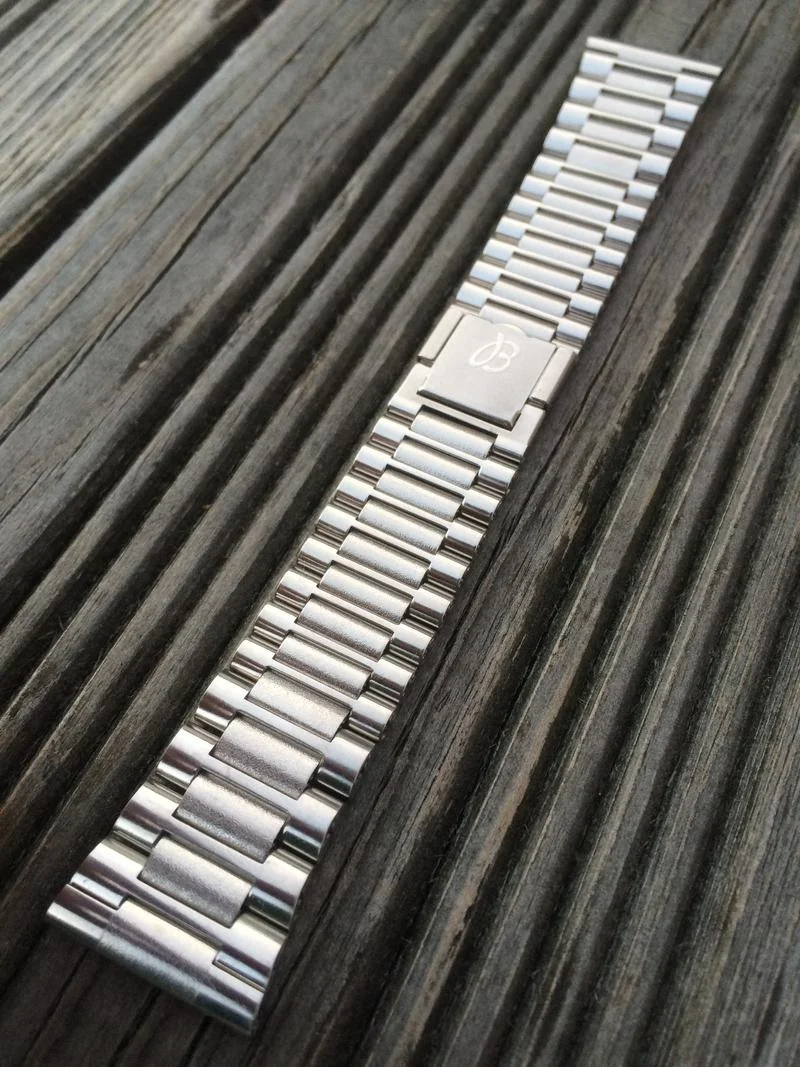

14 is hard to find, 13 is in ebay offered (price no one pays - offer 400 and see what happens),
NSA Novavit you can try to find in 22 mm - is the same as 13 without branding an the clasp
10 (perhabs the best option) should be possible - most sellers don't know the numbers and
you don't find them on the bracelet - 10 has often a lot of stretch
search bracelets for the fried egg models - they all have 22 mm
whatever you find, please post a 765-picture with steel-bracelet than
10 (without stretch), than Novavit with even with B-Logo clasp (asume attachement once over Breitling dealers to buy)
and than 13 (the clasp)
pictures credit from a friend of mine, who once had them all

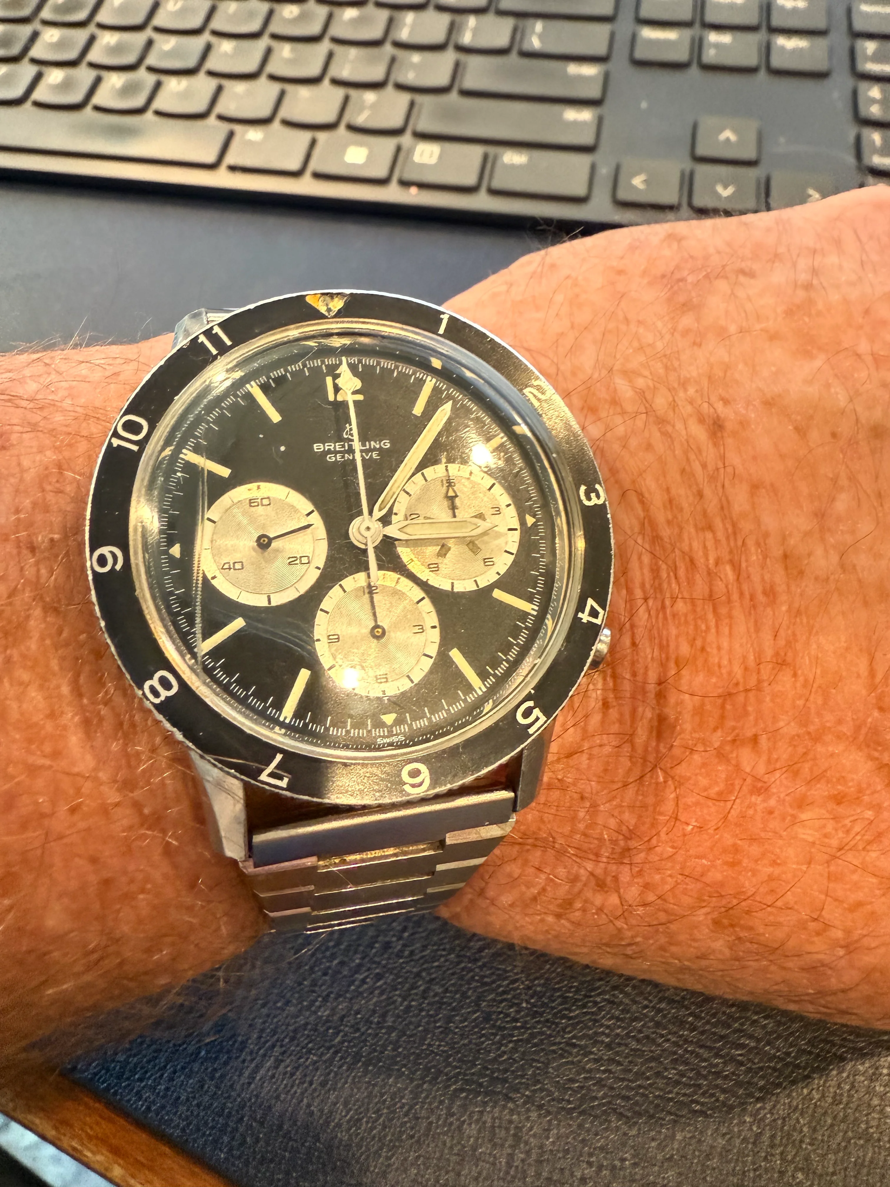

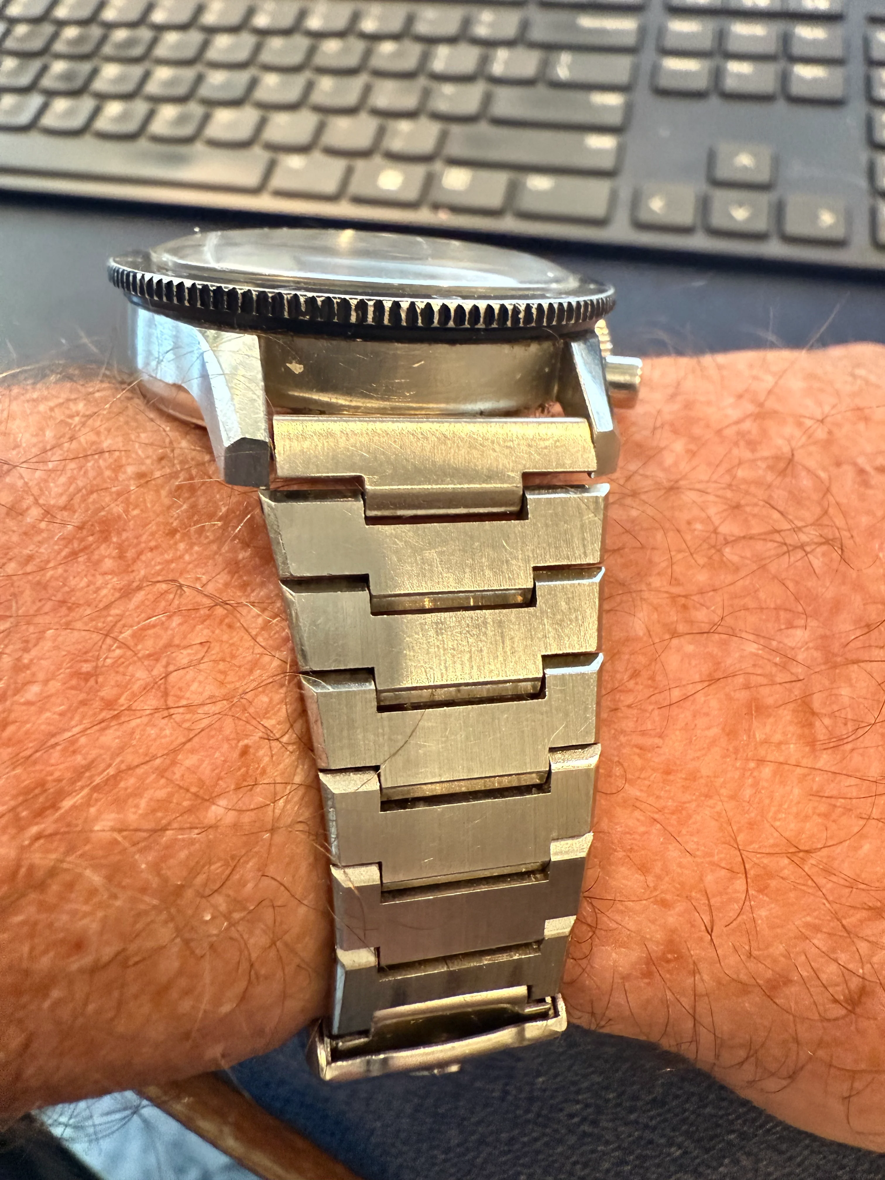

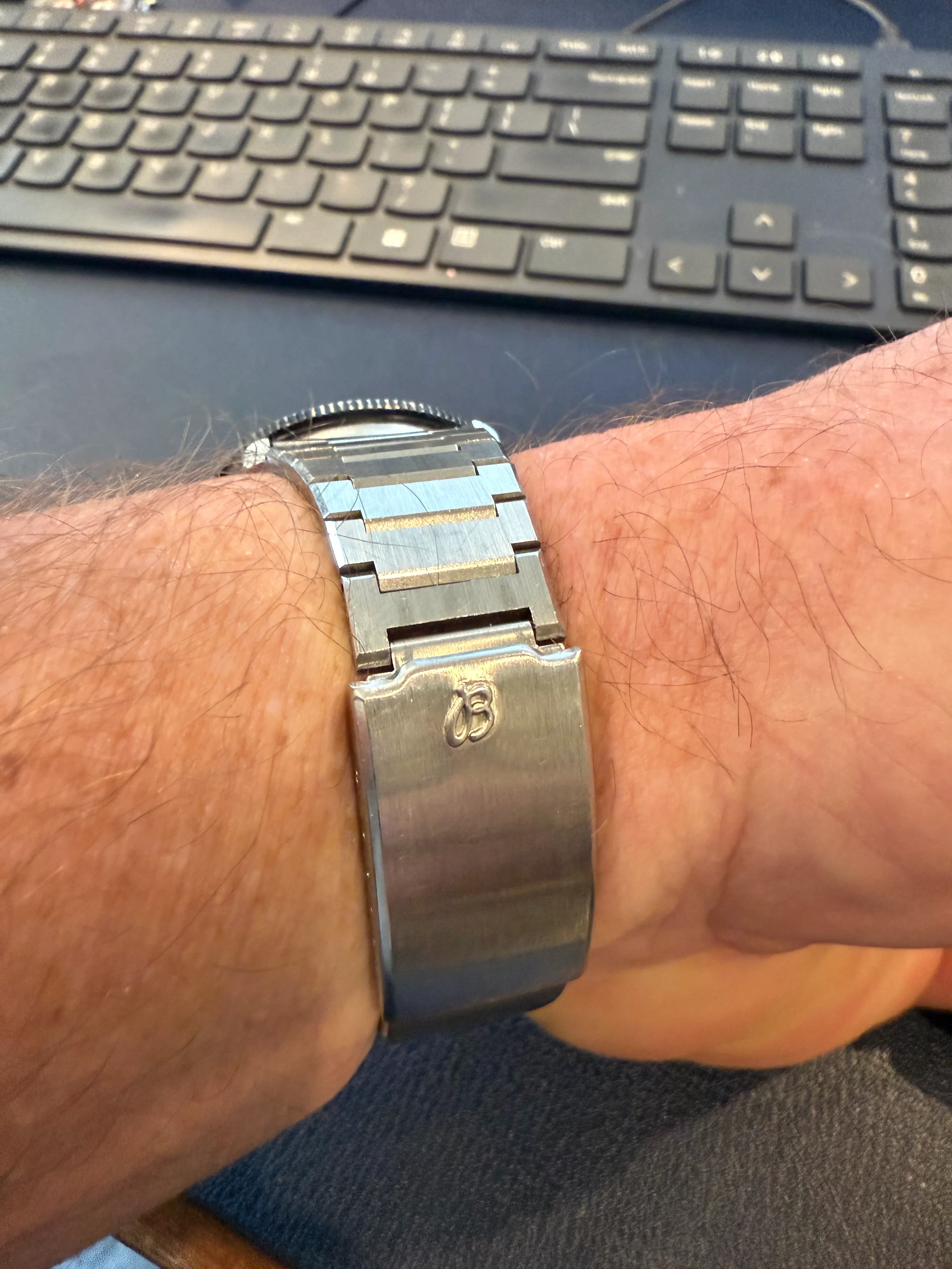

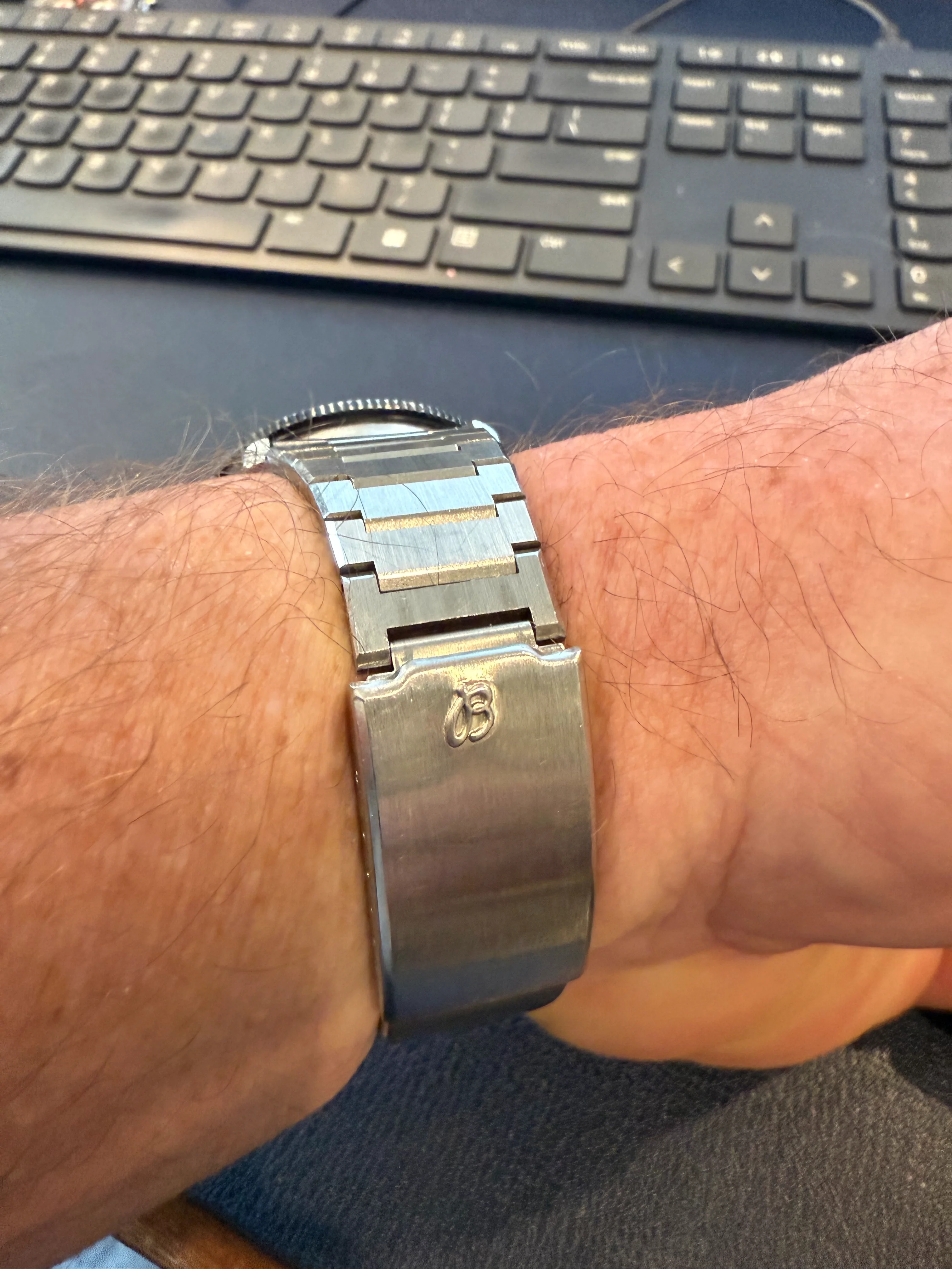

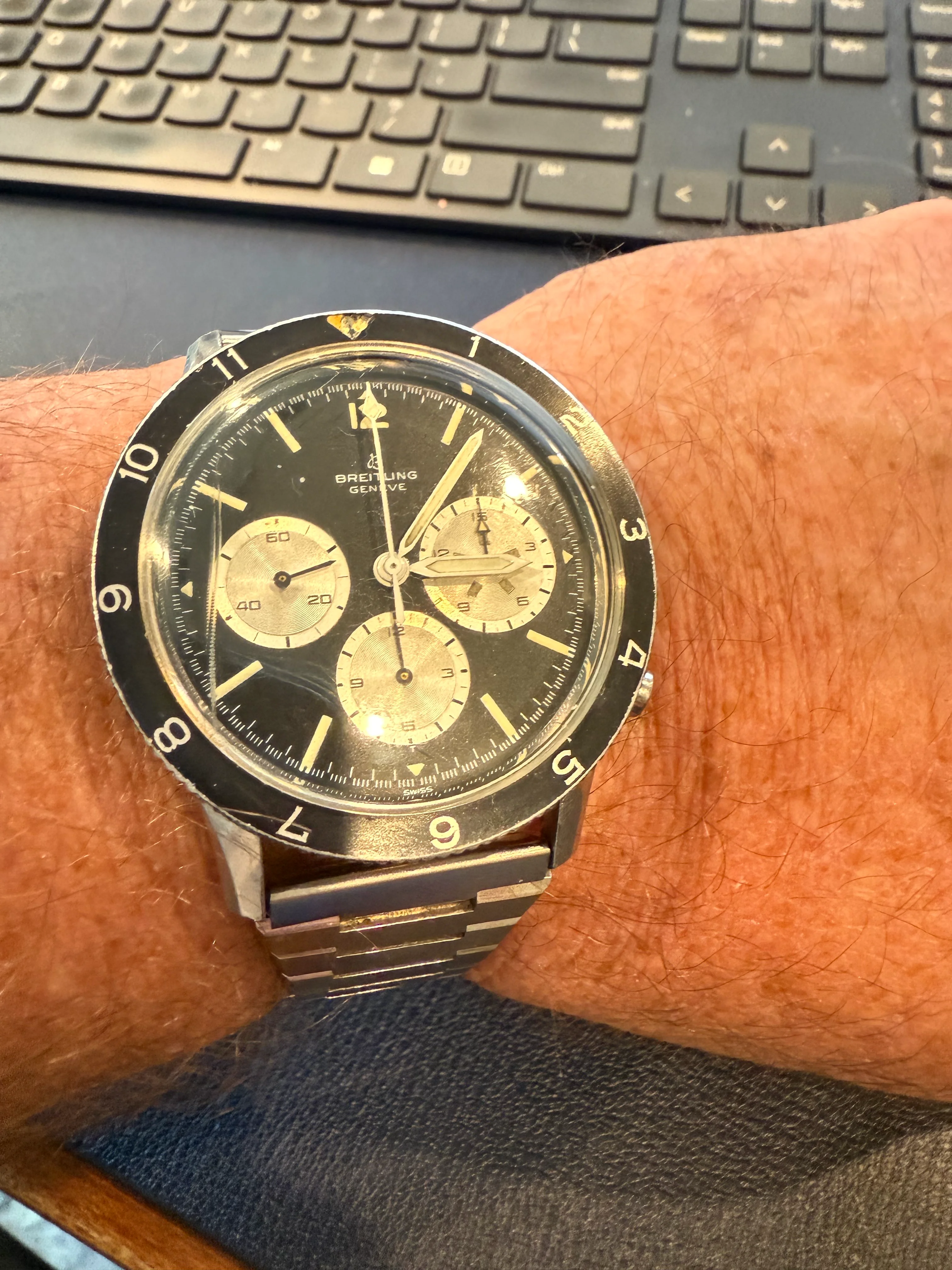

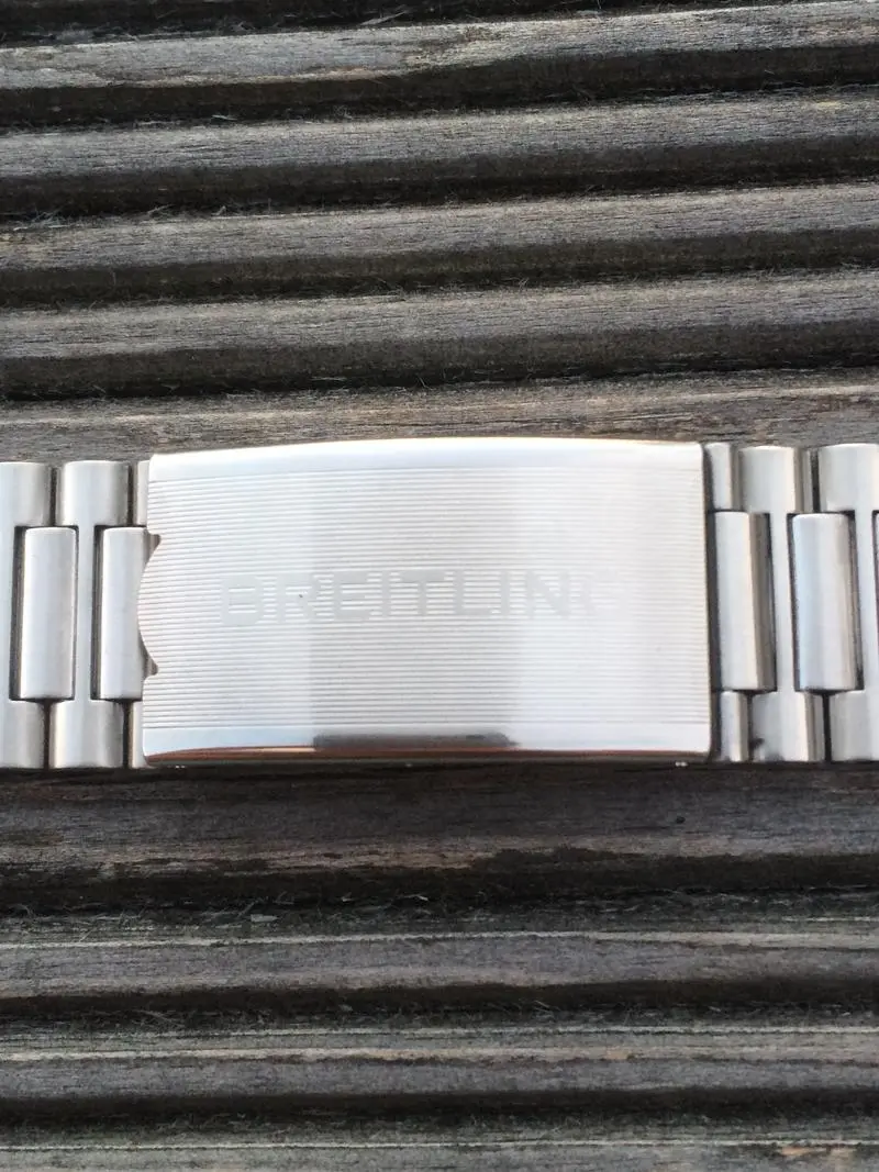

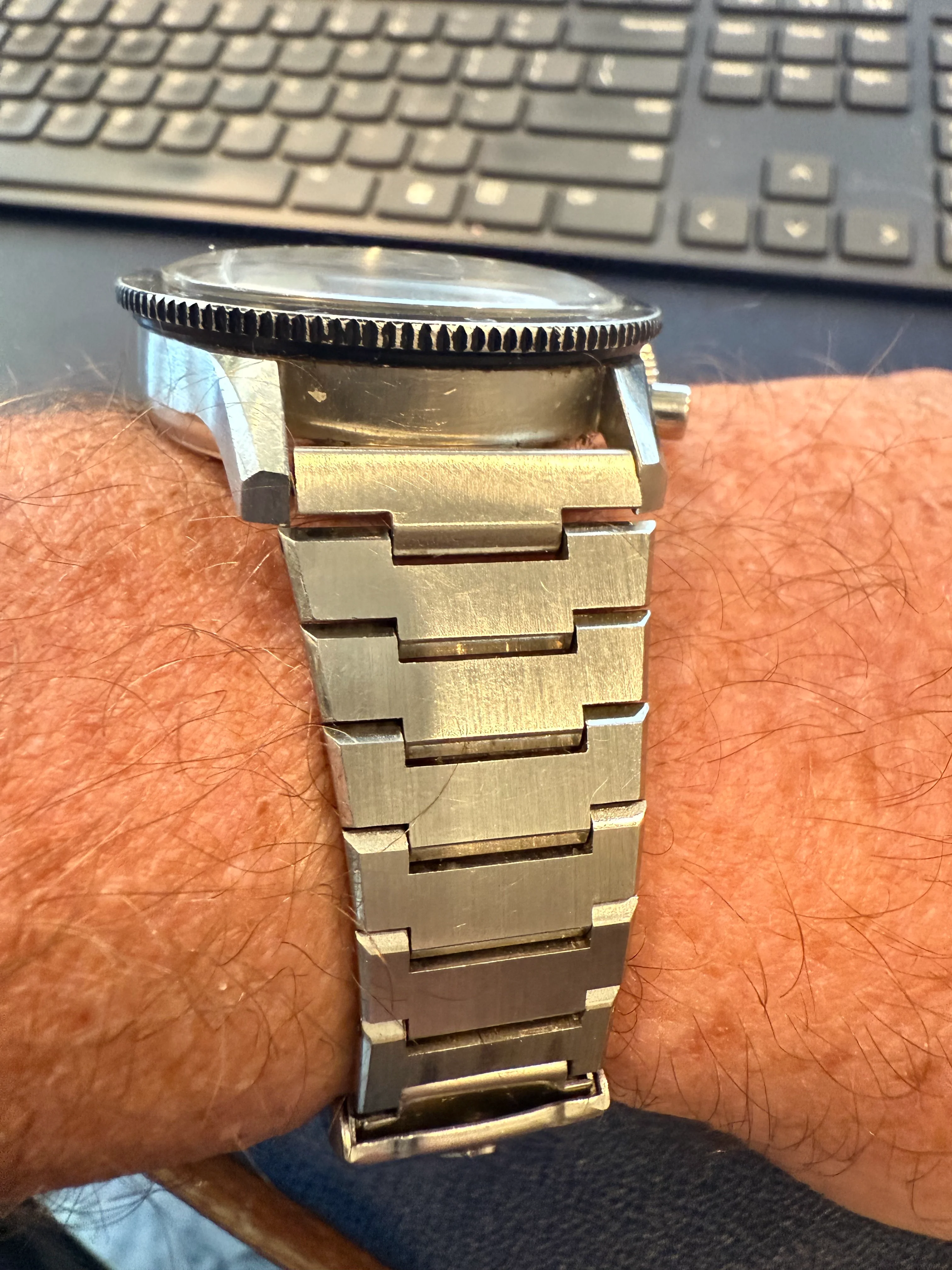

@big case Ran across this thread, and saw no response to a pic with a 765 on a steel bracelet. Picked up this 7650 with a 80's steel bracelet. Not a number 10/13/14 (could only find this bracelet beginning in late 70's catalog
353
1,079
i think this bracelet is from Jupiter Pilot or another 80's / late 80's watch
4
It's shown in the 1980 catalog on the mod jupiter and mars navi.....doesn't look bad on the 765 though.
Also in the 1977 catalog. on the 9403 ref.

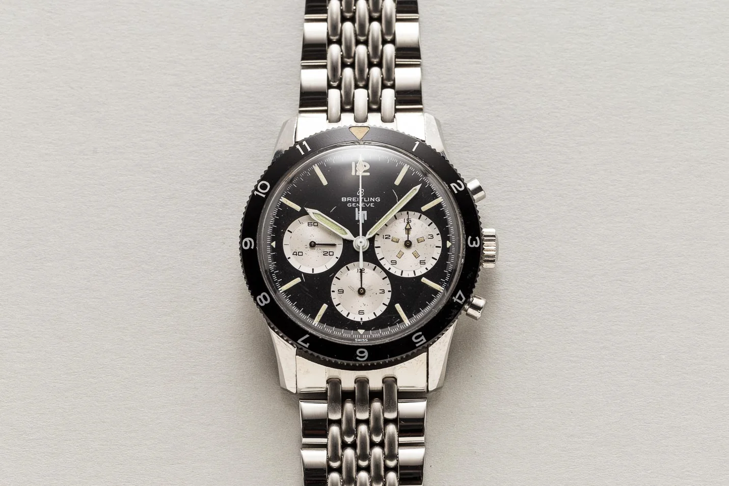

found a picture with another good looking option
picture: credit from shuck the oyster vintage watches
