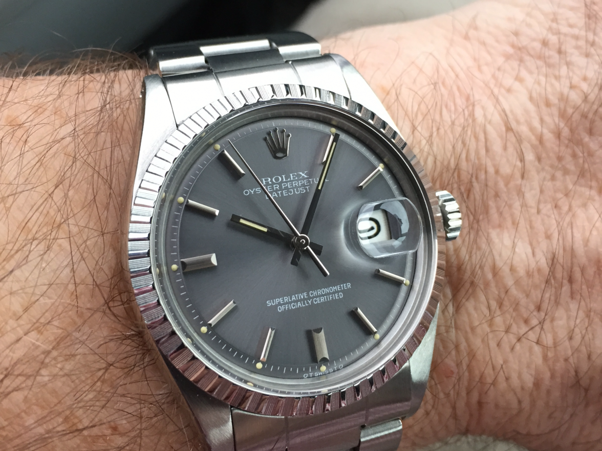

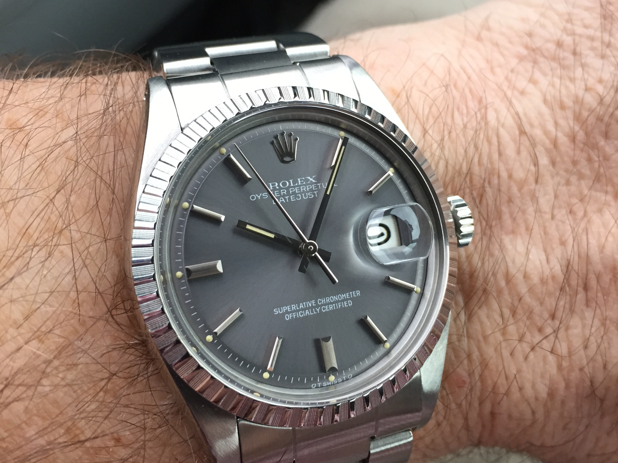

Hi nice 1603 here's mine on an oyster bracelet..
