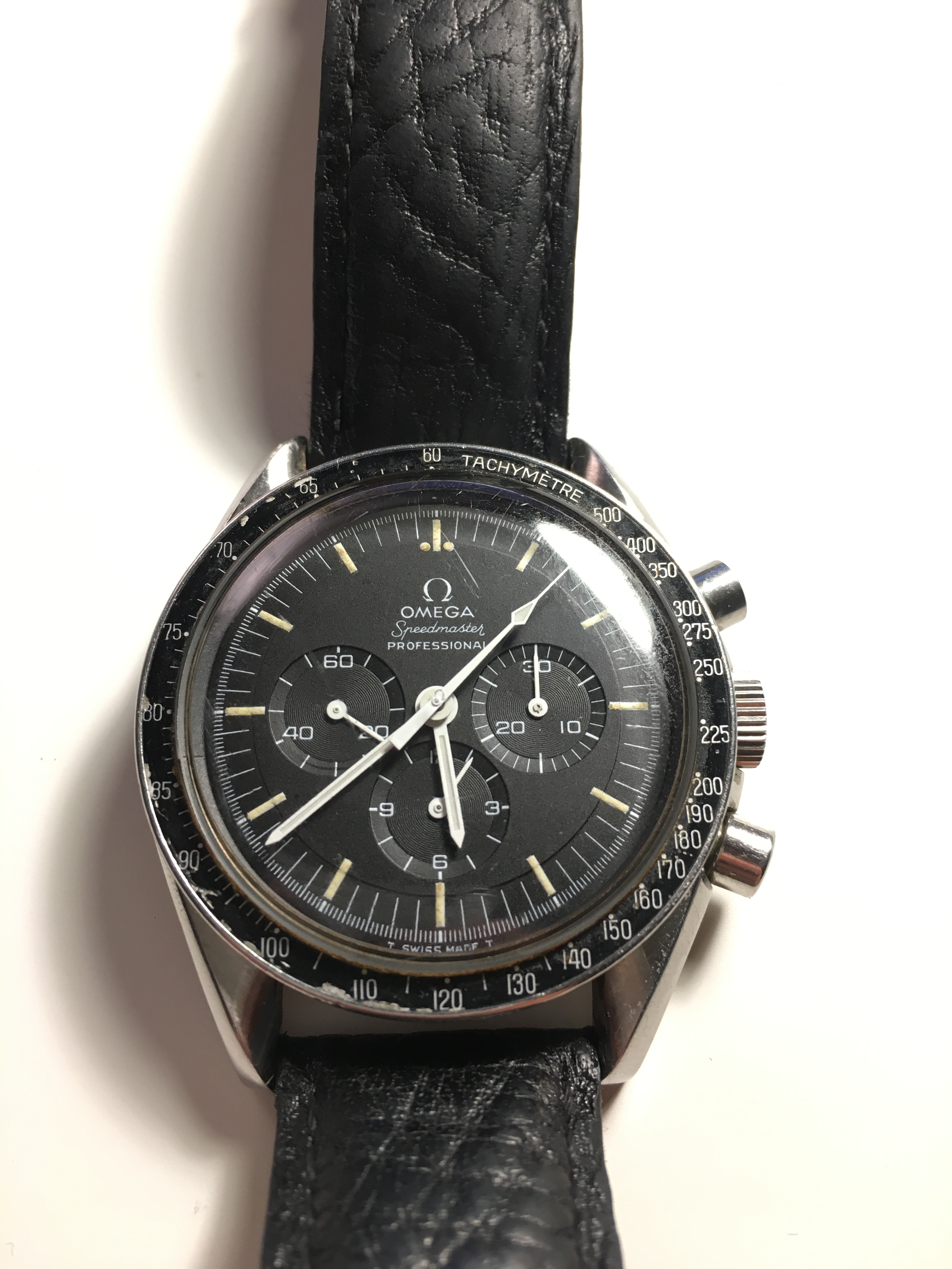

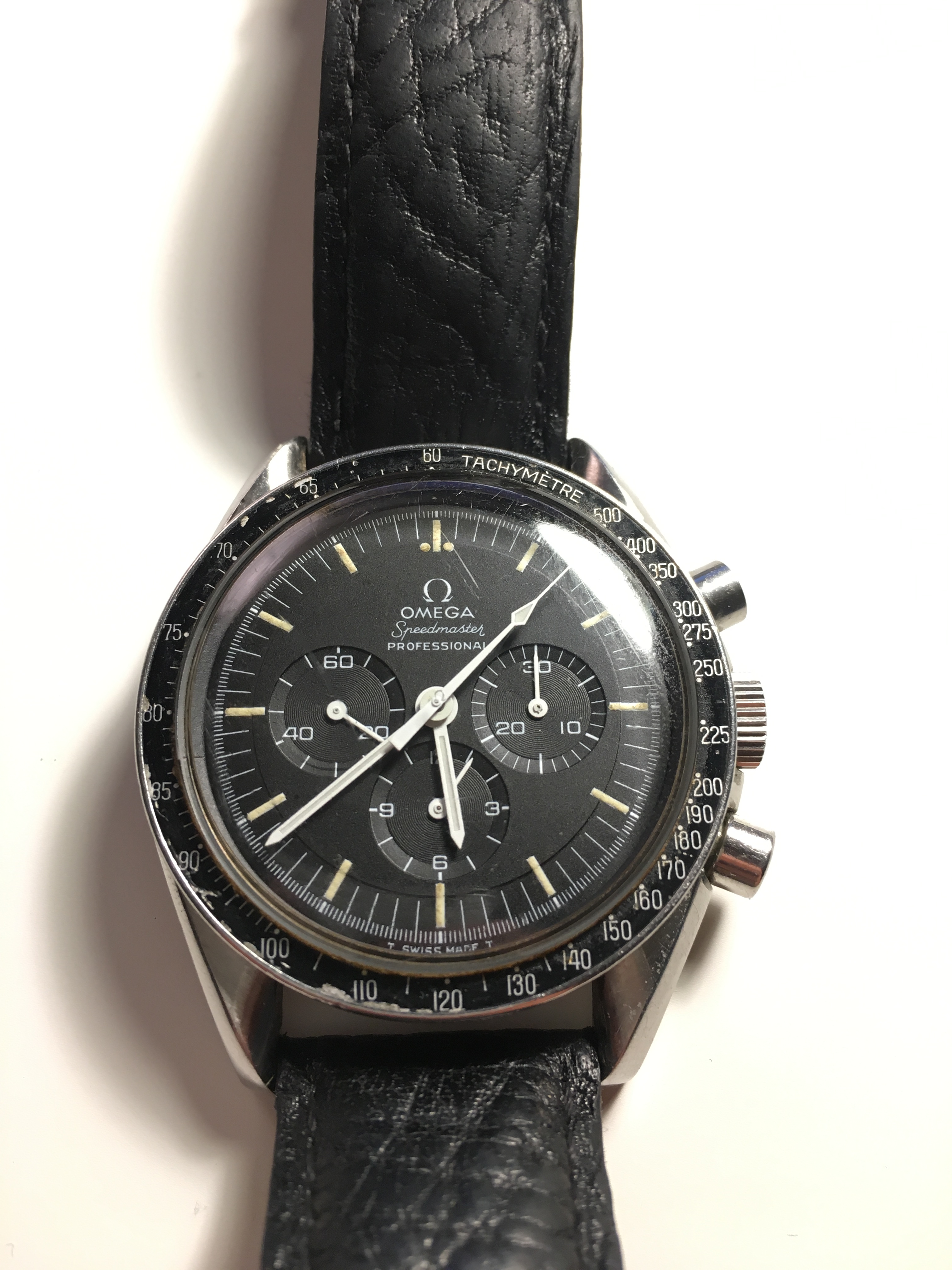

1) The outside

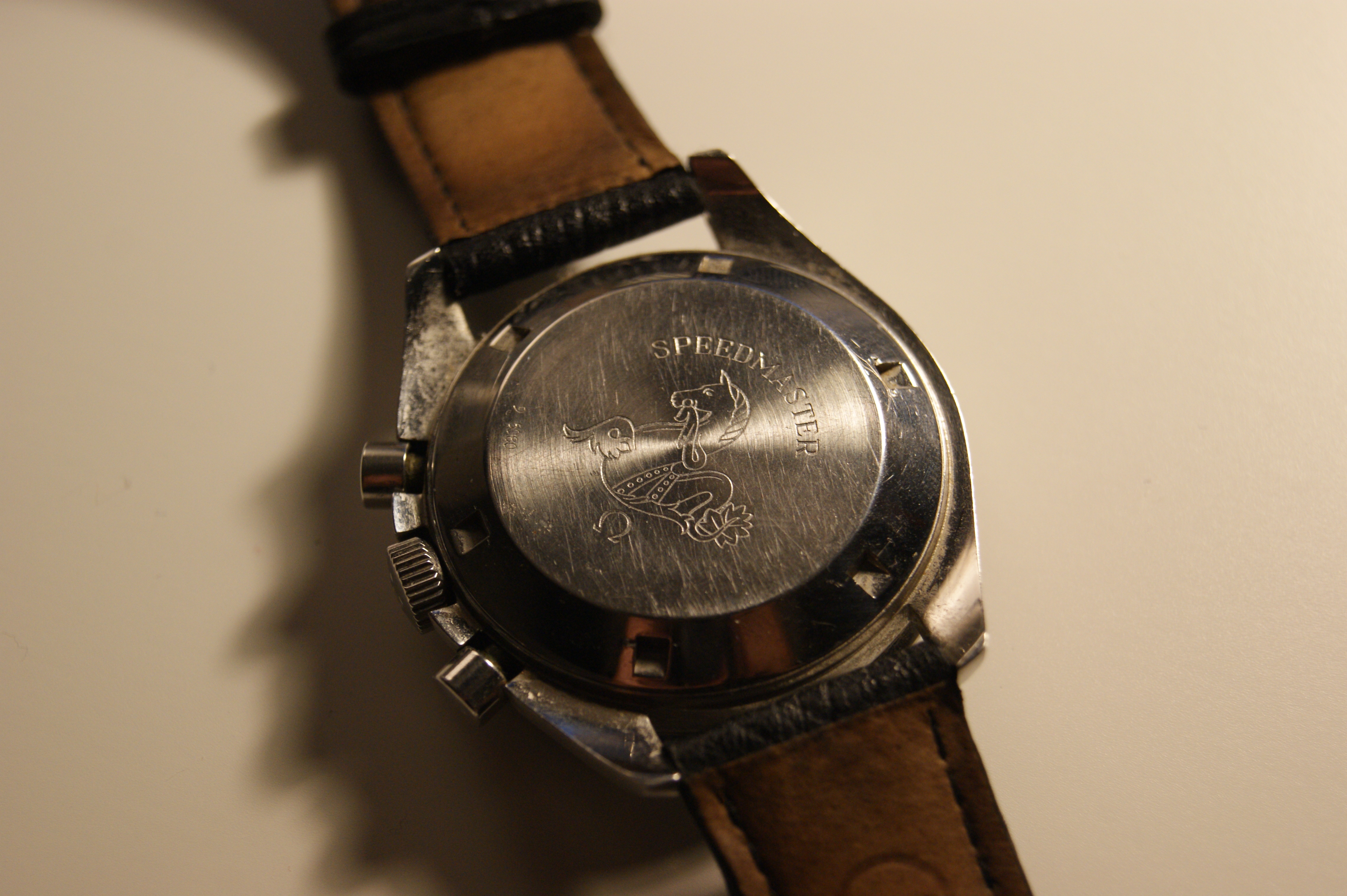

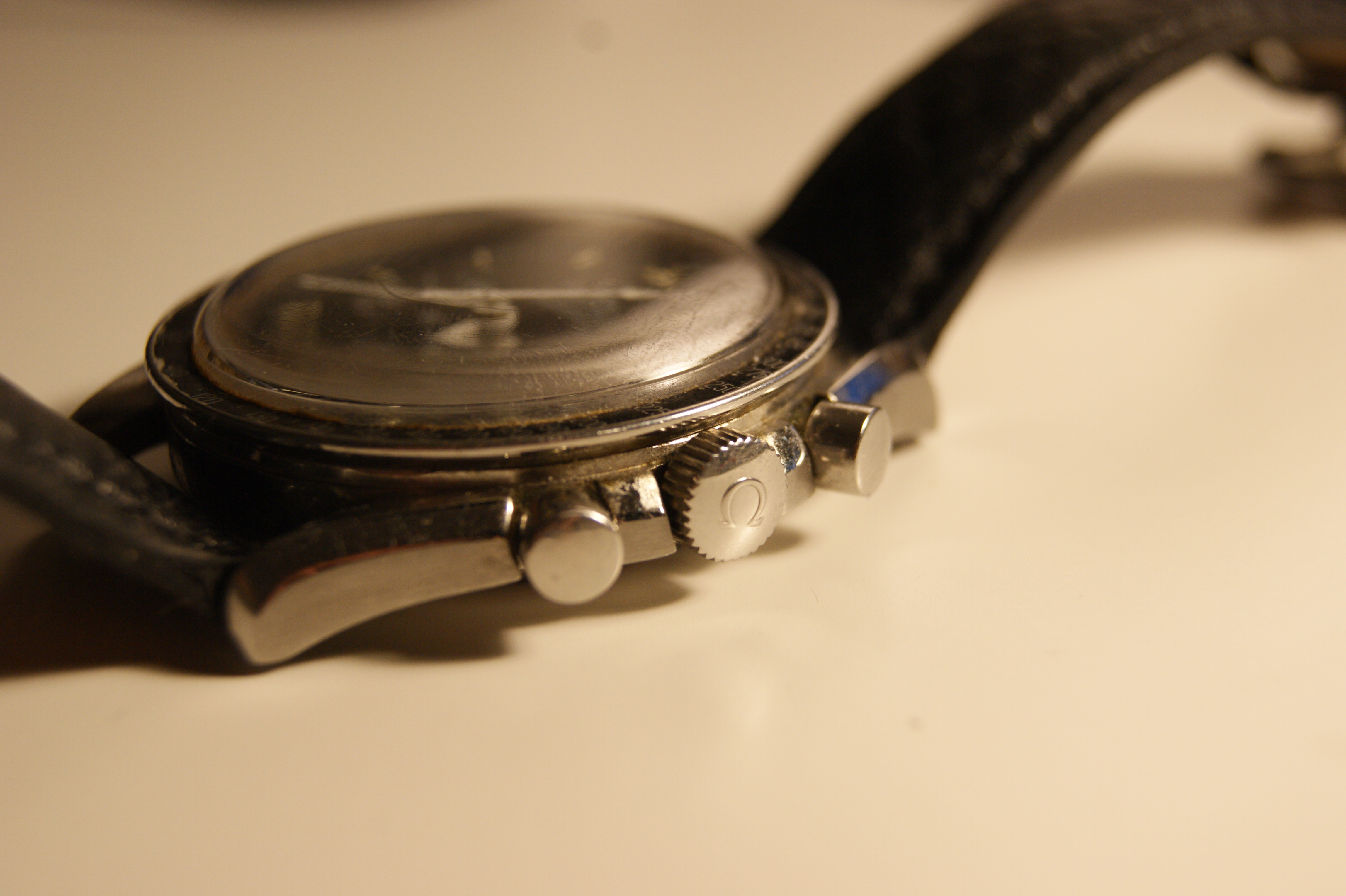

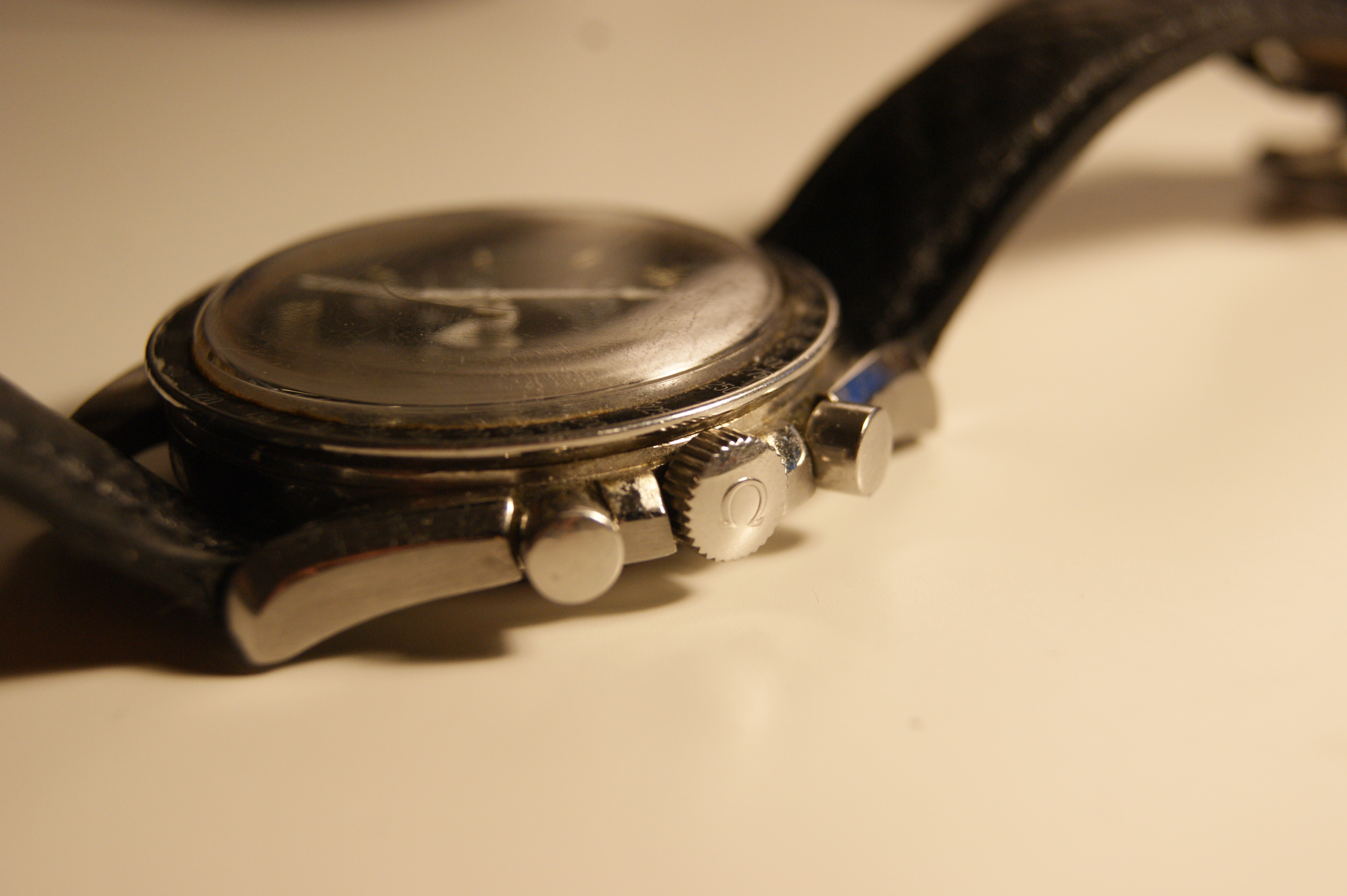

We have here a mix between pre-moon and post-moon. What I notice is a very nice DON (dot over 90), typical from pre-moon models, along with the "猫" on Tachym猫tre. But I also notice that I dont have the classic "stamped" Omega logo, rather a printed one.

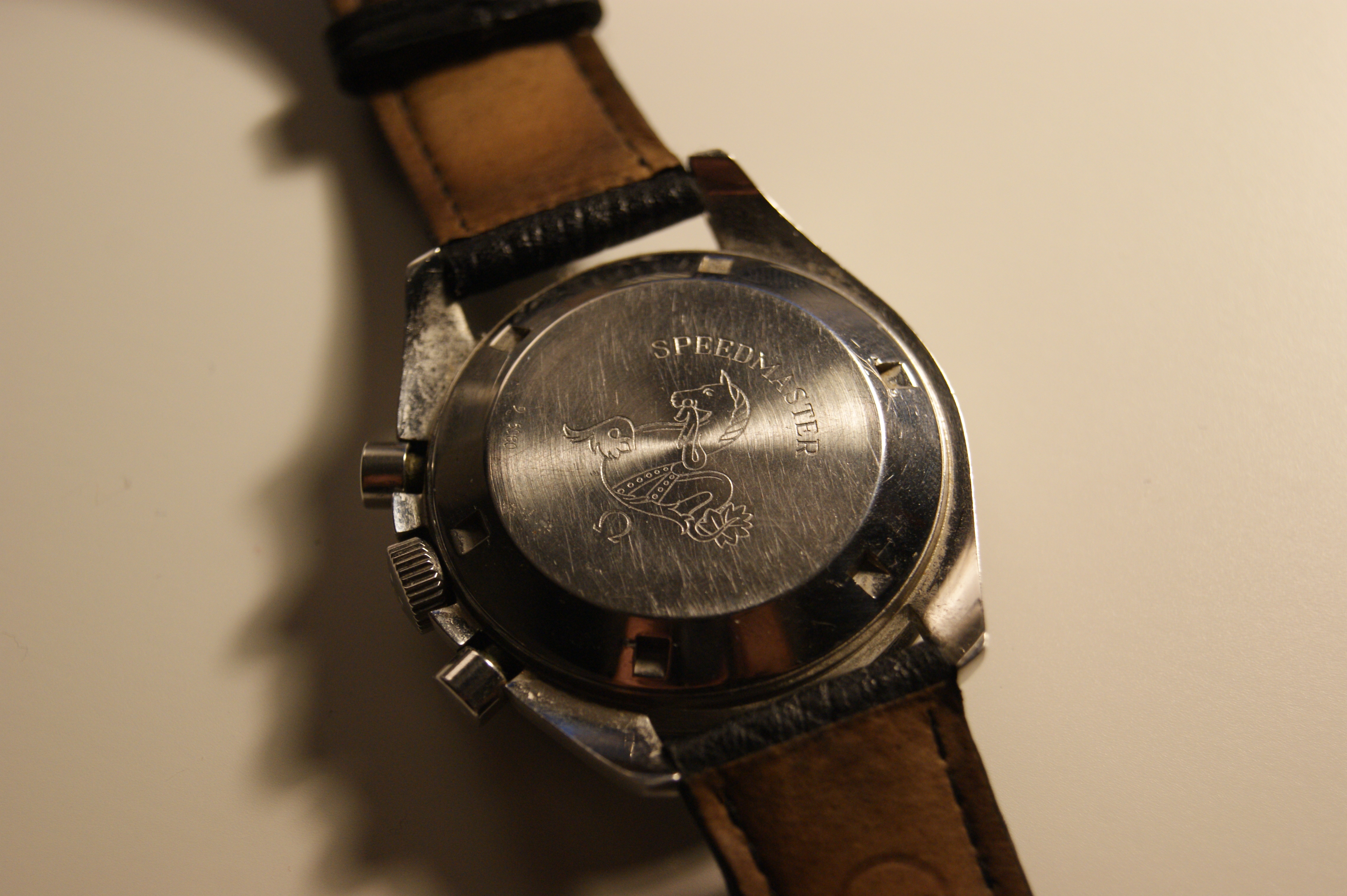

The back has the classic Omega SeaHorse, and no mention of the "First watch on the moon".

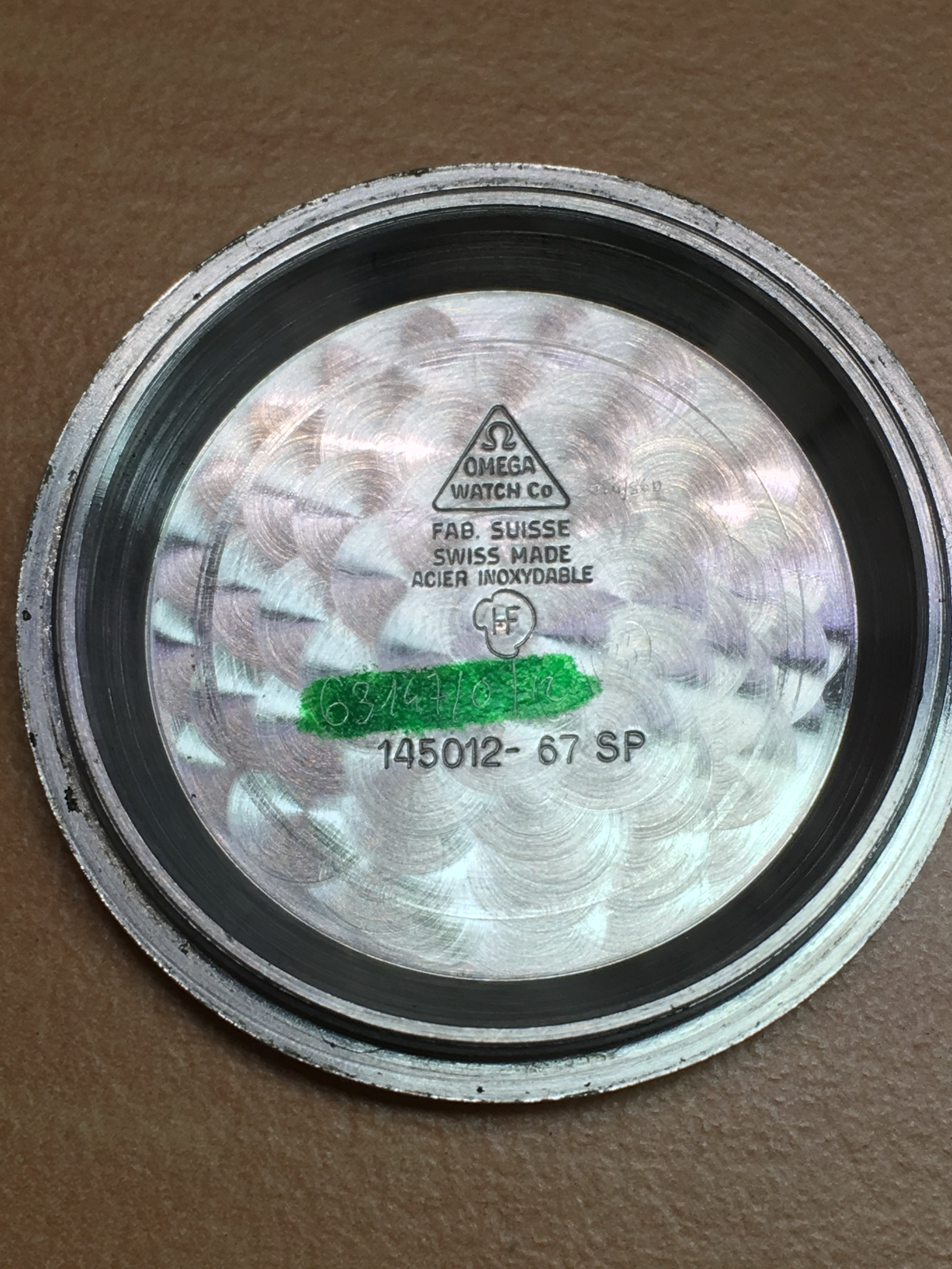

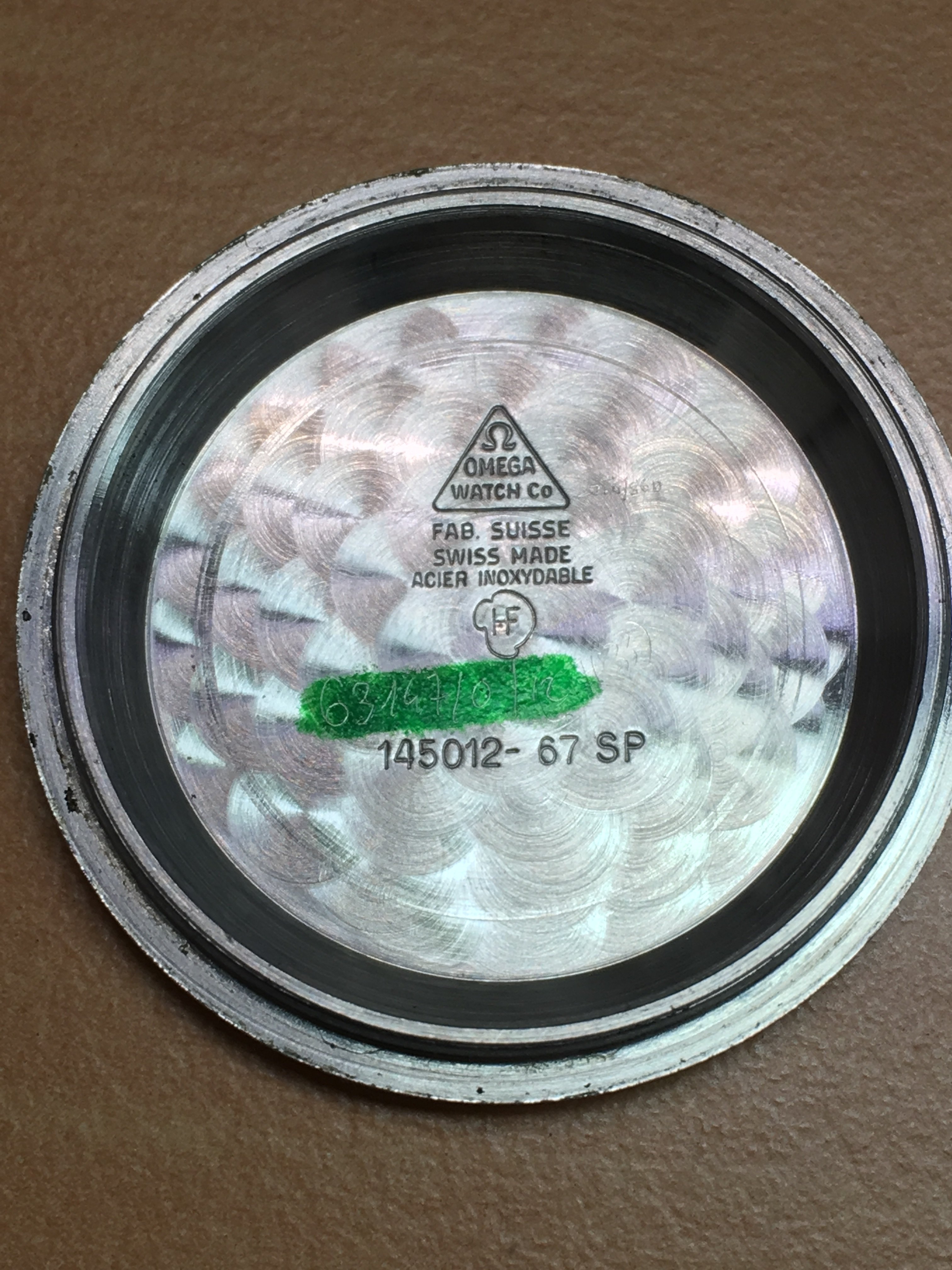

First, the inside of the box, which was very surprising (remember: I have a strong feeling that the watch is a 145.022-69), it says 145.012-67 SP. That's not exactly what I was expecting...

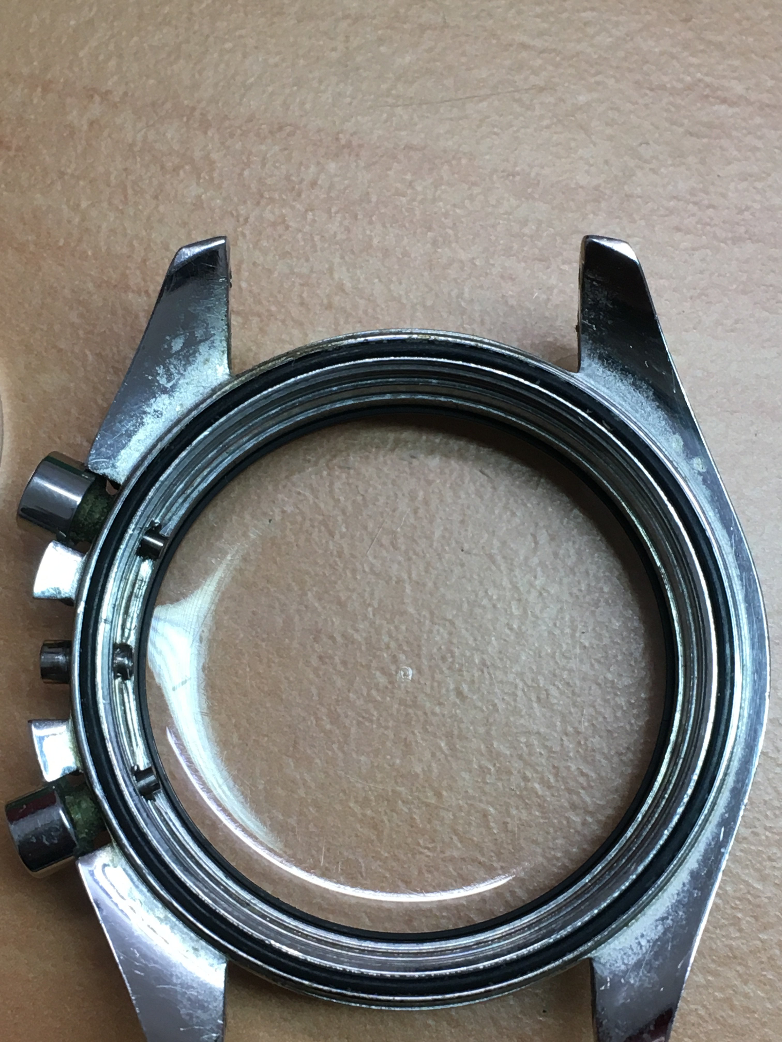

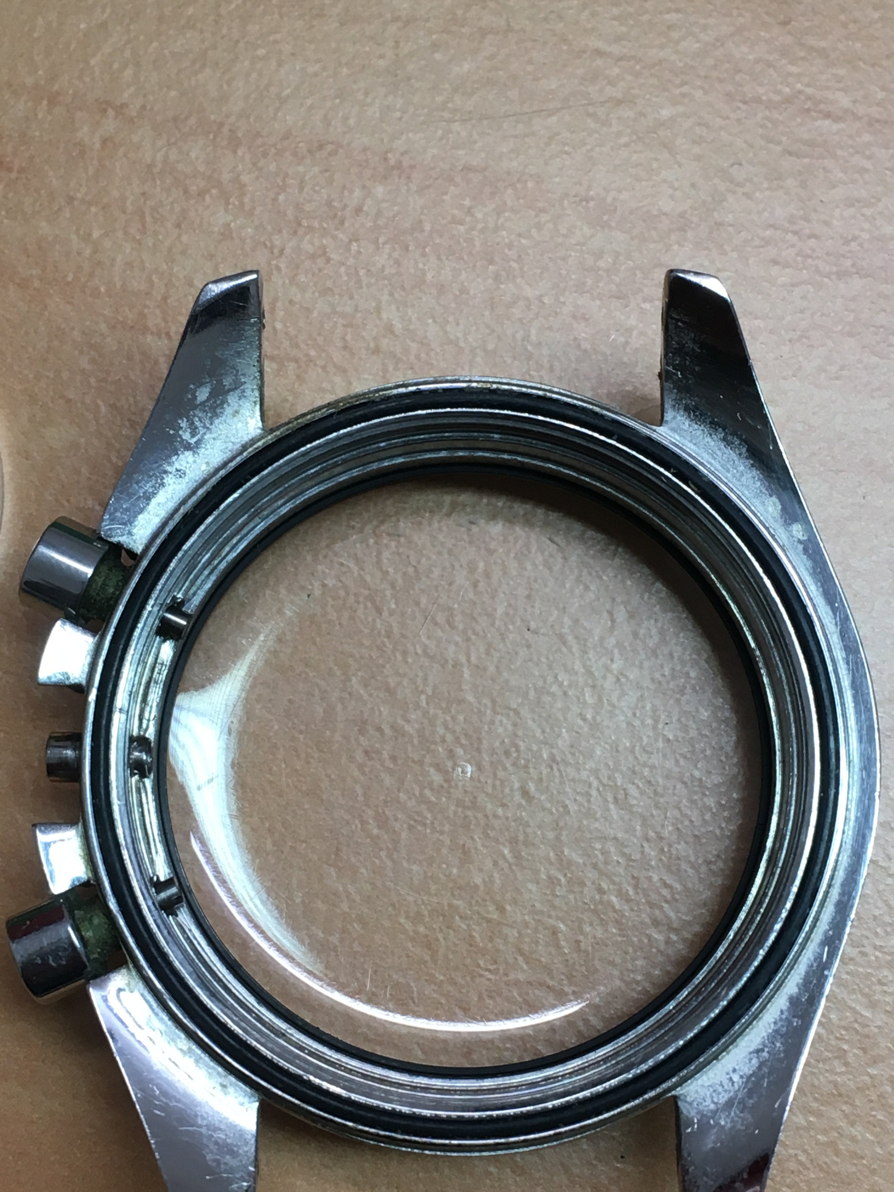

Here is a picture of the glass, with the very small Omega logo engraved in the middle...But I dont think this would be of much help to ID the watch...

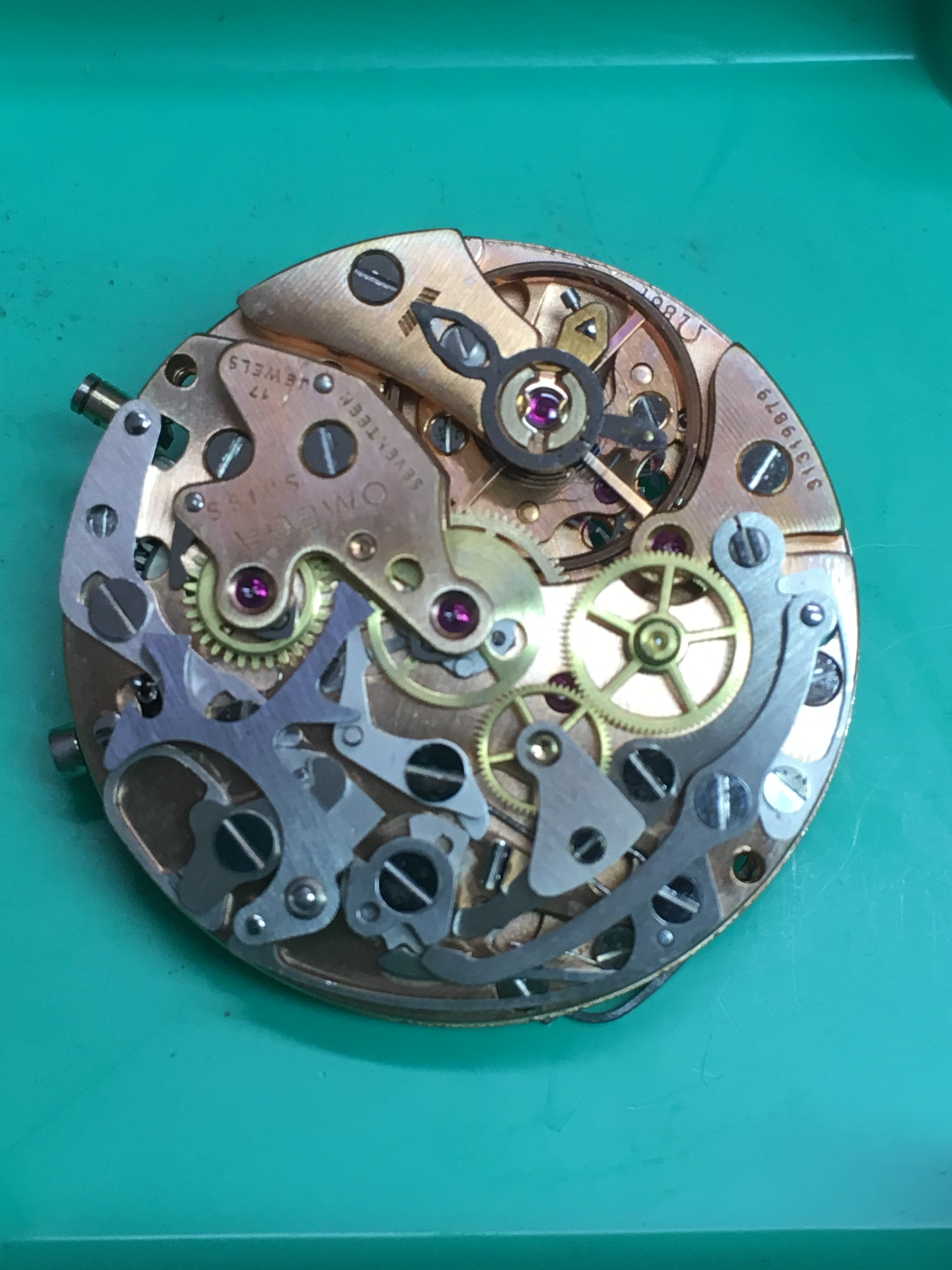

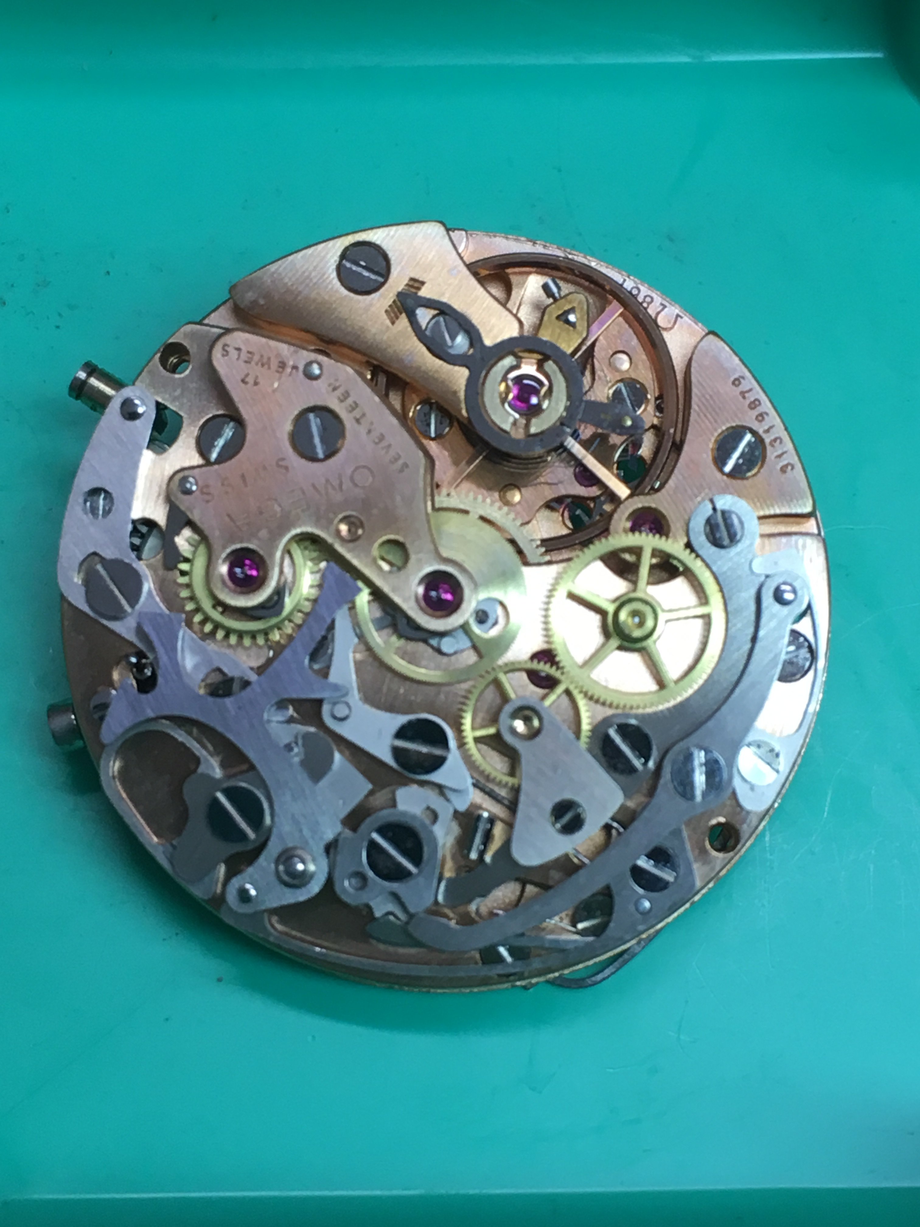

The caliber...well it's a 861, as expected on a 69 model year...but the serial number "313xxx" is another mystery...from what I saw online, this would match with a MY 1970 ?

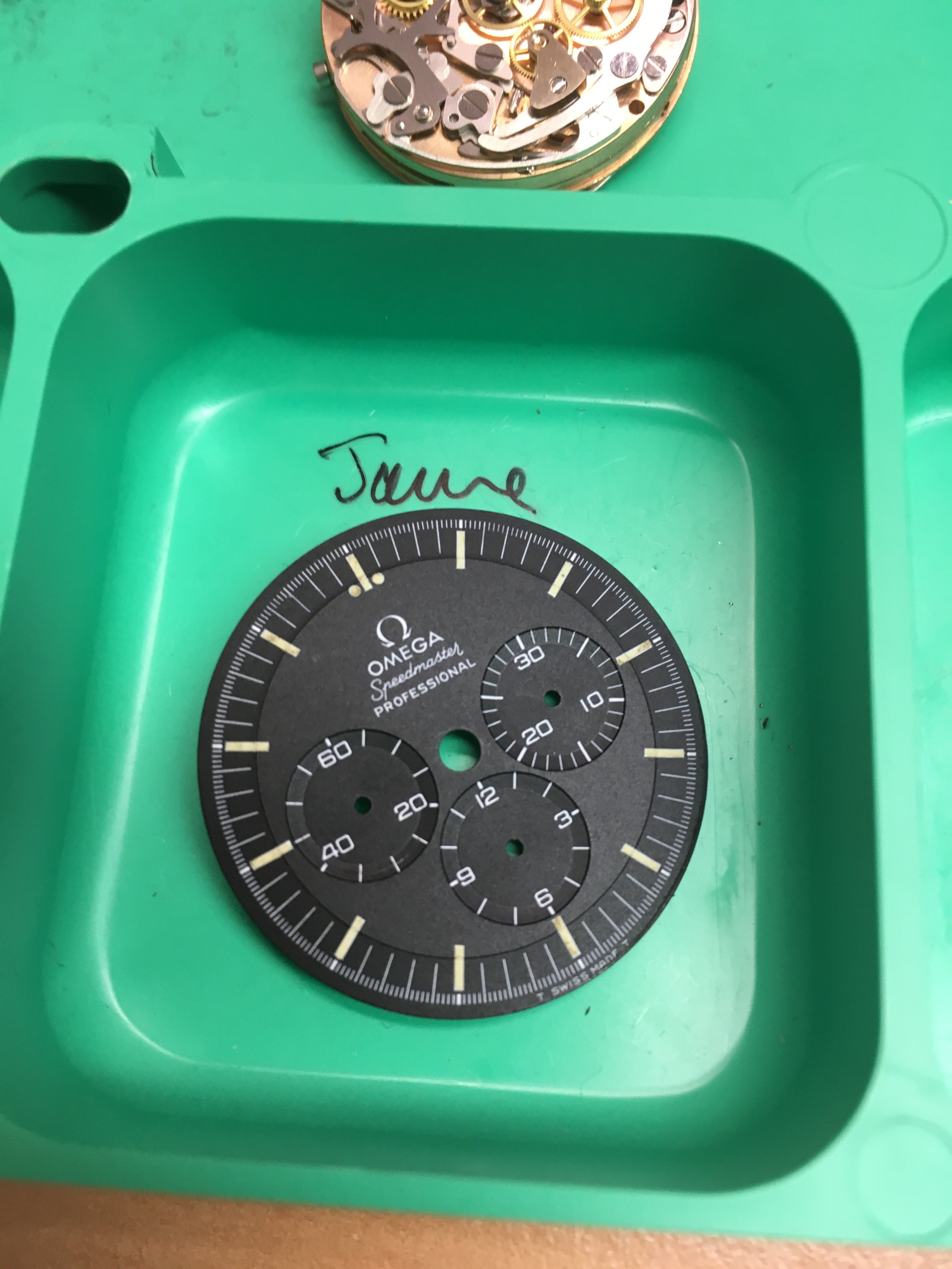

Last picture, from the dial (nothing to see here ?):
So that must be all I know about this watch...I hope someone can help me identify its year of production.

Very clean dial, earlier case back, perhaps it's more correct a DNN bezel??
However, congratulations!!!!

Here's a neat story:
20 years ago your grandpa and another guy send their Speedmasters for service to the same watchmaker...
Your grandpa's 145.022-69, and the other guy's 145.012-67...
The guy with the 145.012-67 gets his watch back with a 145.022-69 caseback and a DNN bezel.
And the other watch... Well, @Carlito93 it's yours now...馃槈 (Oh, and with service Luminova hands & service crown).
24,850
55,292
Congrats on a very nice heirloom. As noted, 145.022-69 with earlier bezel and caseback and probably service hands.

Interesting that back in the 1970s or 1980s when the watch could have been serviced for the first time, we don't know the exact date, many watchmakers didn't pay much attention to casebacks or inserts... did they even talk about DON or DNN bezel inserts? The caseback should have been a straight writing, correct? The luminova service hands would have had to have been done at a later service, maybe in the late 90s.
In time, if the OP wishes to, he could restore the watch to it's original condition, might even make a few dollars in the sell of the DON for the DNN. Still a very nice heirloom as Dan S stated.

So if I understand correctly, mine is not supposed to have the DON bezel, but this (and the caseback) would have been mistakenly inverted ?
Correct. The serial number is already out of DON range.
This is an early 1970 production.
Someone obviously mistakenly swapped out those parts with another watch.
The hands are Luminova, so if they were replaced during that same service it could have happened even 20 years ago.. Back then almost no one knew to tell the difference between a DON and DNN, even the casebacks look identical on the outside... No one cared...

So, my watch would be one of the last 145.022-69, and thus one of the first of them to get a DNN bezel if I understand correctly.
Your watch is from early 1971 according to the serial.
DNN bezels started around 31.00X.XXX serial. Somewhere in Feb-March 1971.
